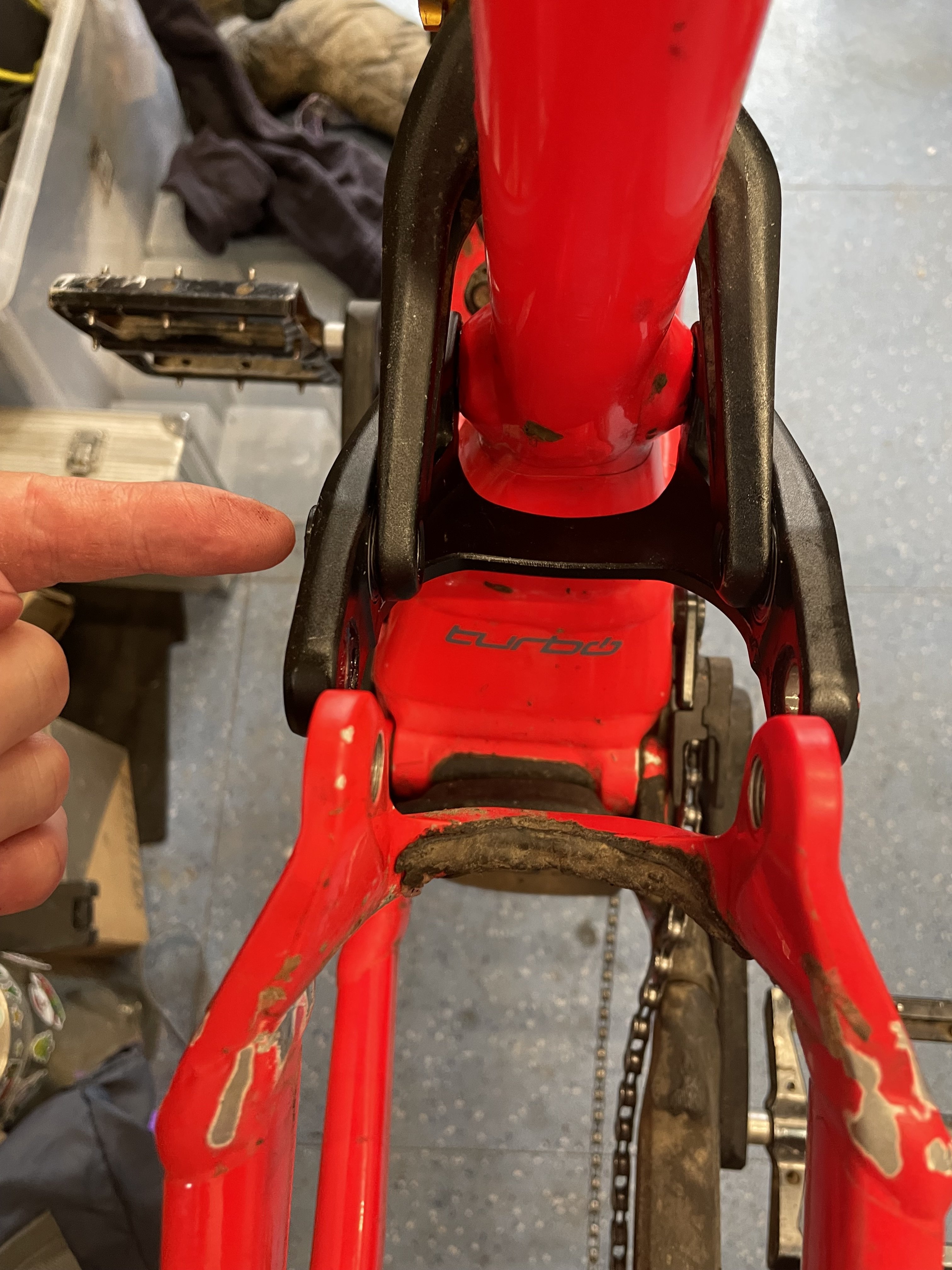

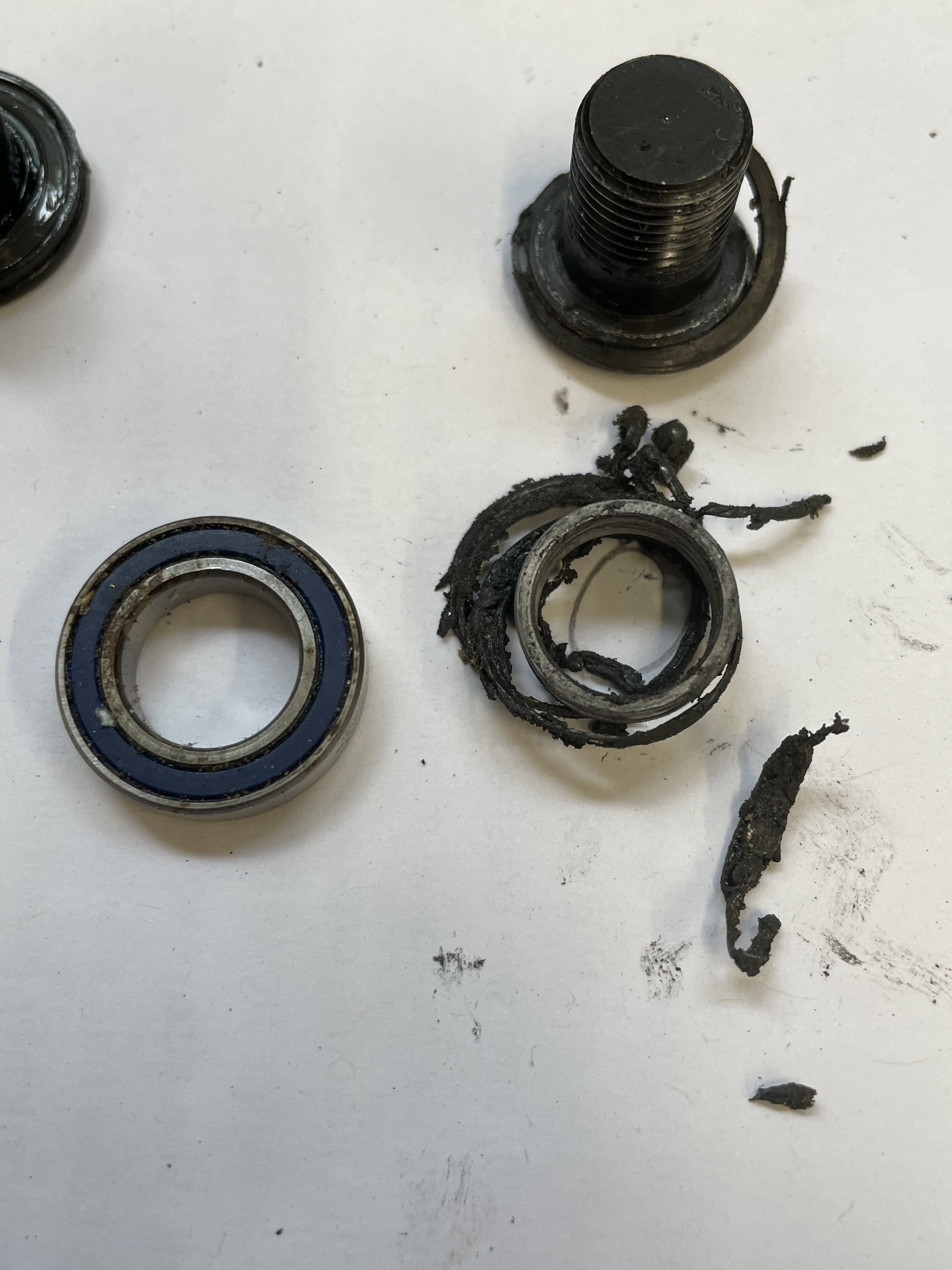

This bearing is one of the middle Horst link ones. I’ve never had a bearing fail like this, completely in pieces all the balls missing and the bolt chewing up the Horst link!! They were all changed about 3 months ago. Around the time a ttx coil was fitted. Tbh I only noticed because the rubber seal was being pushed out a bit.
Should I be worried? Something to do with the coil perhaps? It’s had a few heavy bottom outs. Perhaps I need a harder spring. Currently 607.

Looks like a a new bearing kit is needed. Hopefully the threads are not stripped (finger bolt). Maybe the correct torque wasn’t applied when the Ohlins coil/shock was installed. 🤷‍♂️
Either way …hopefully it can be reassembled .

Bolt is wrecked. Side worn off it! I think it had become the bearing surface once the balls had disappeared! Luckily I have a bolt kit already. The bolts were torqued and also periodically checked for tightness.

My Levo developed a creak (don't they all!) that I traced to the bearing behind the one you are pointing at. I bought a Spesh replacement bearing kit and did all of the rear suspension bearings at the same time. The creak turned out to be the cartridge bearing rotating in it's seat. After removal, it became obvious that the bearing was almost completely locked up. This may be what caused your bearing to self destruct.

If you are hard bottoming then yes you need a firmer spring.
If that bearing only lasted 3 months something is wrong. Are they full complement bearings or aftermarket standard caged bearings?
If not full complement then you need to change the rest of the bearings out that you replaced 3 months ago with the right bearings

Bearings in use :
Turbo Levo Pivot Bearing Kit | Blueseal MAX Full Complement™​
1 review
  • Complete Pivot Kit - Blueseal MAX Bearing™
  • Premium Bicycle Bearing - ABEC 3
  • Maximum Grease Fill
  • Close Contact LLU 2RS Seals
I have now replaced all 6 with the same brand as I had spares. 5 were a little gritty. Its not really been used in wet conditions either.
I'm going to have to start taking the horst link off monthly or something to inspect it.

It looks like it’s been over torqued due to the state of the rubber seal. Acknowledge that you said it was torqued. To what nm?

Whats all that other wear from? Looks like the tyre has eaten through the front?
20, as per the manual. The rubber seal is because the bearing lost its balls and the bolt started wearing through the horst link and wore the bolt down and shoved out the seal.
