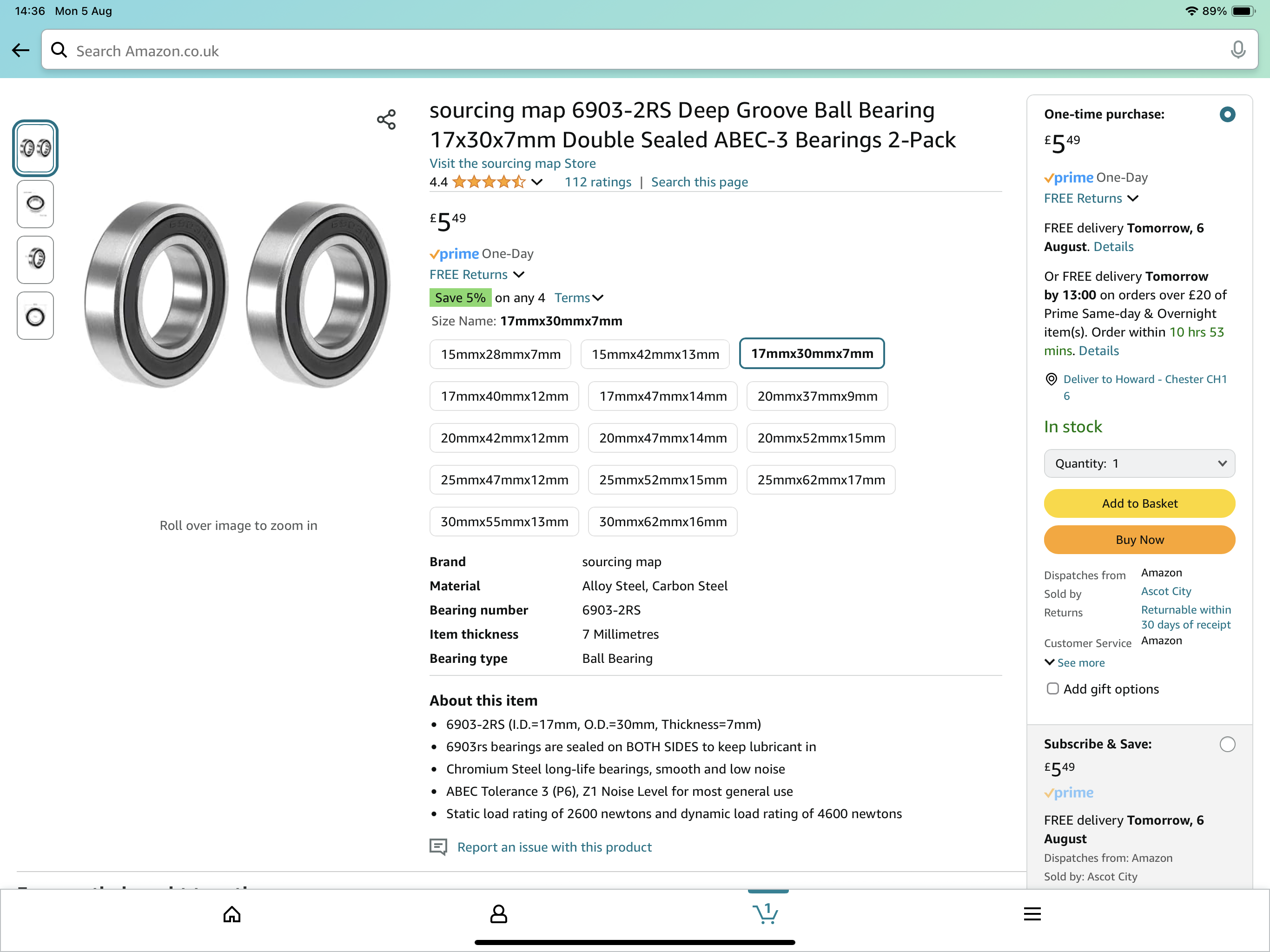

get the wheel off and have the bearing covers off, get your finger in the middle of the bearing and move it around to check the state of them.. its very very likely given the age that the bearings are knackered, mine usually last a few months before I have to replace them so you've done well.
IIRC the front bearings are 2x 6902 and the rear are 2x 6903 AND 2x6903
check this info cos its from my memory and I changed my wheelset so its a while since I did it.
Mikerb
May 16, 2019
6,145
4,676
Weymouth
Changing the bearings is simple......they are 6903LBLU. Reference to the finger test above is not Im afraid definitive. They can feel fine just rotating them with your finger but you are testing them with no load on them. I changed rear wheel bearings once a year on my 19 Levo Comp.
Removal is done by tapping them out , preferably with a long nail punch ( you can buy a set of 6 quite cheap). It is worth buying the Rapid Racer press tools to do the pressing in job. You do not need the extraction/press tool itself since you can make your own with a length of threaded bar and some washers and a couple of nuts, but get the press kit ( No 14 for 6903 2RS bearings).
