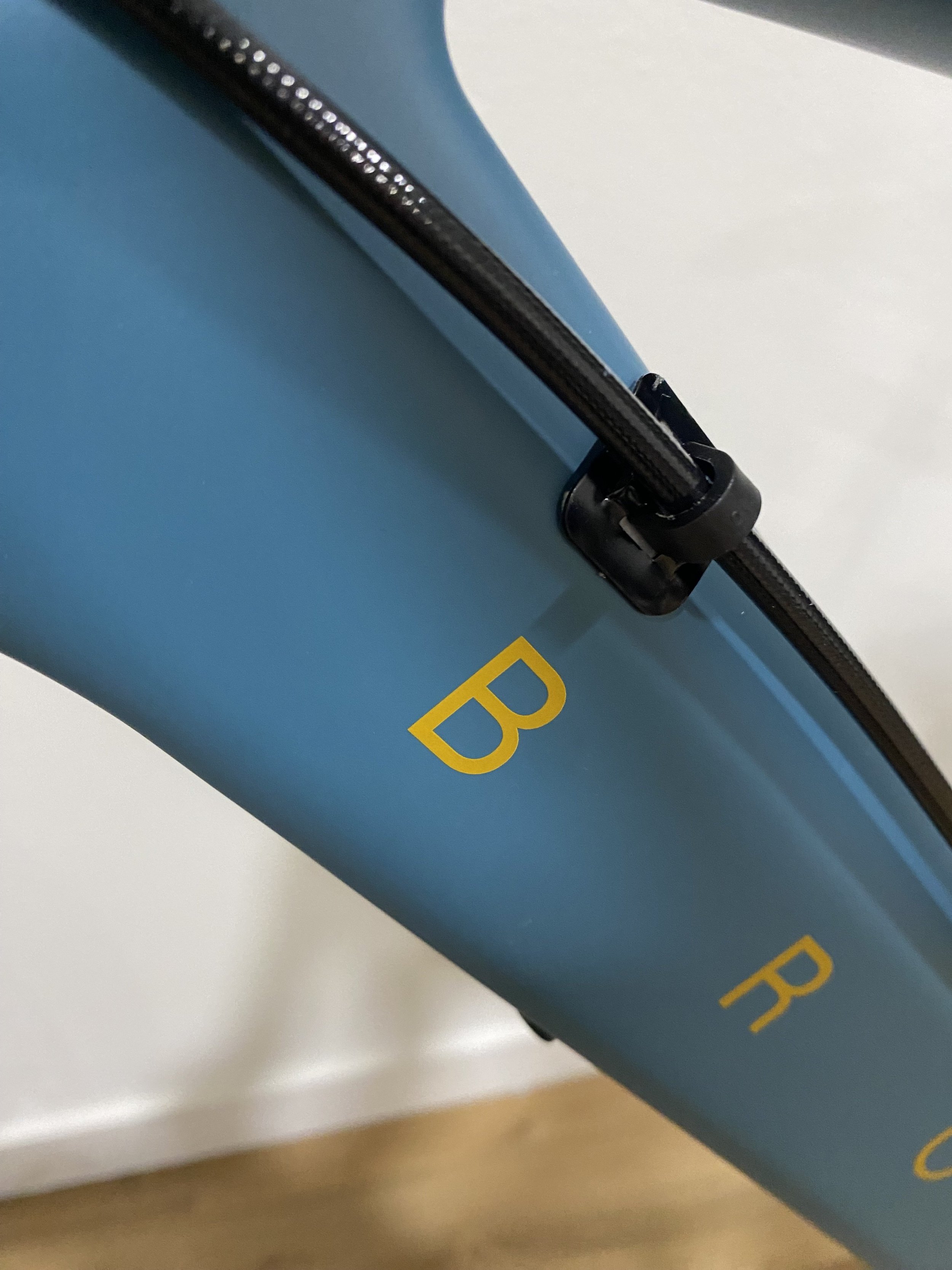

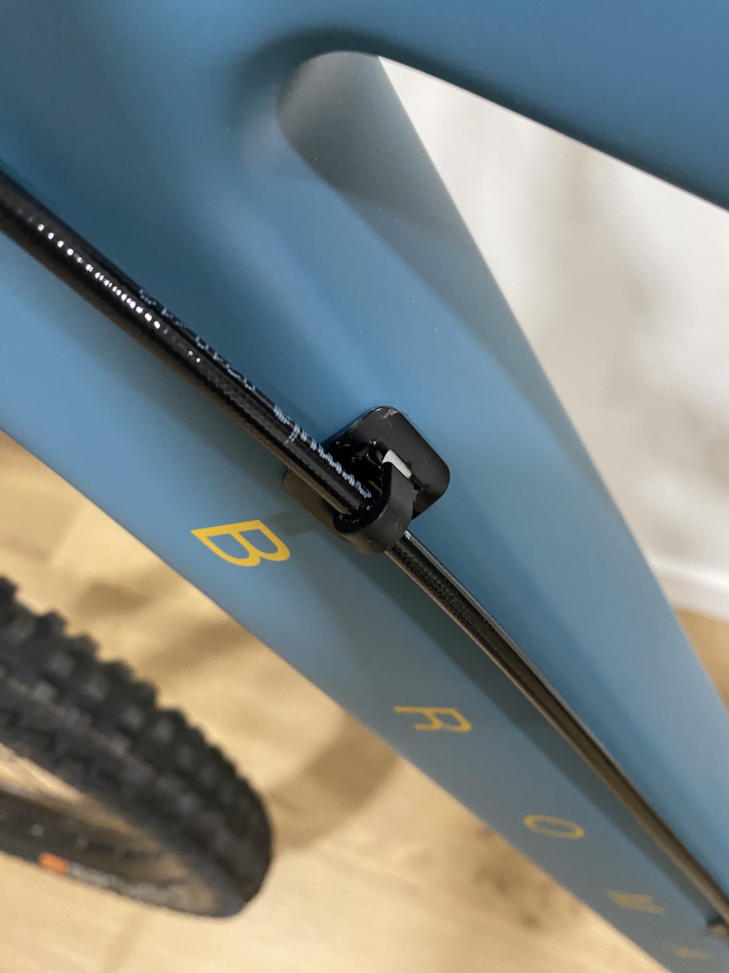

I didn't explain myself, I apologize for my English but I meant the passage of the front brake hose to the caliper
Good to know about the run, I think I’ll insulate my cables that run inside. For the rear brake I’m going to try to run the rear brake on the outside, I bought some adhesive cable guides from Amazon. I’m not sure how it will perform but I’ll give them a try.

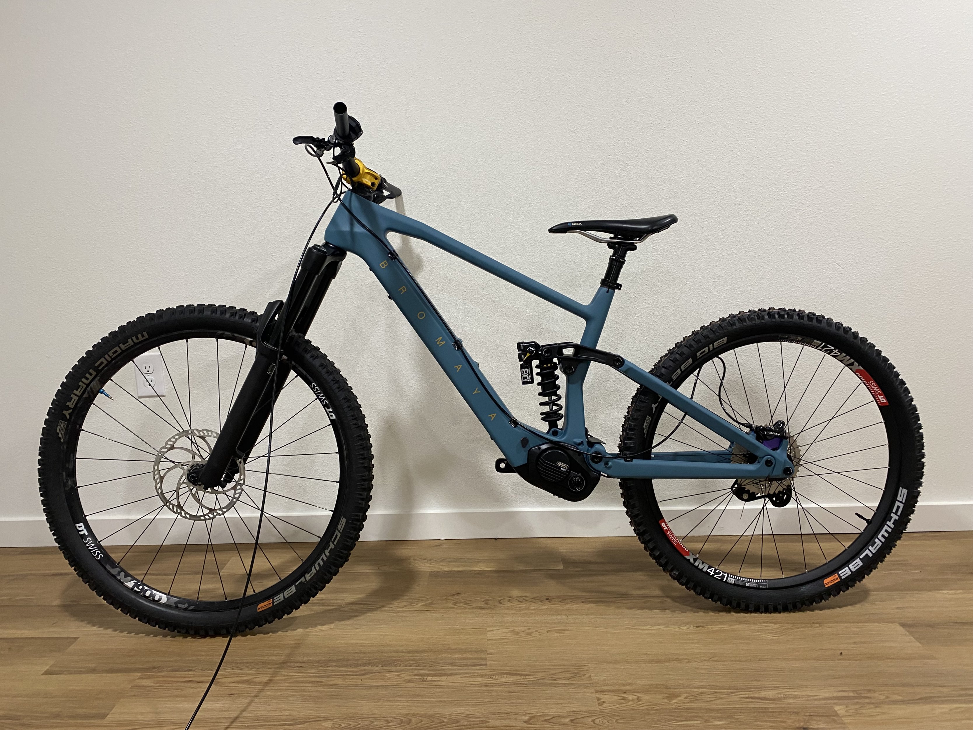

I finally had an opportunity for a short trail ride. Unfortunately the ground was soft so I had to take it easy. The trail I took is a steady, rocky climb with switchbacks.
Powerwise it's about what I expected. It helped me out a lot but I was winded at the top of the climb. It likes a higher cadence than I am used to. My full power emtb has a lot more power overall but especially at a lower cadence.
It feels very very similar but noticeably slacker than my Specialized enduro carbon.
I am looking forward to drier trails so that I can wring it out a bit more.
