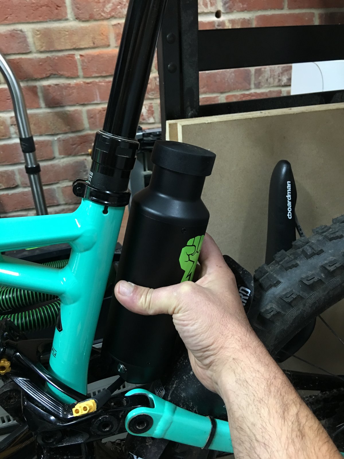

Me and Danny exchanged some photo's with measurements and both agree that the small Levo bottle extender will 9/10 fit my Large Kenevo. I'm going to test fit it and if it doesn't, I will return to him for a refund.

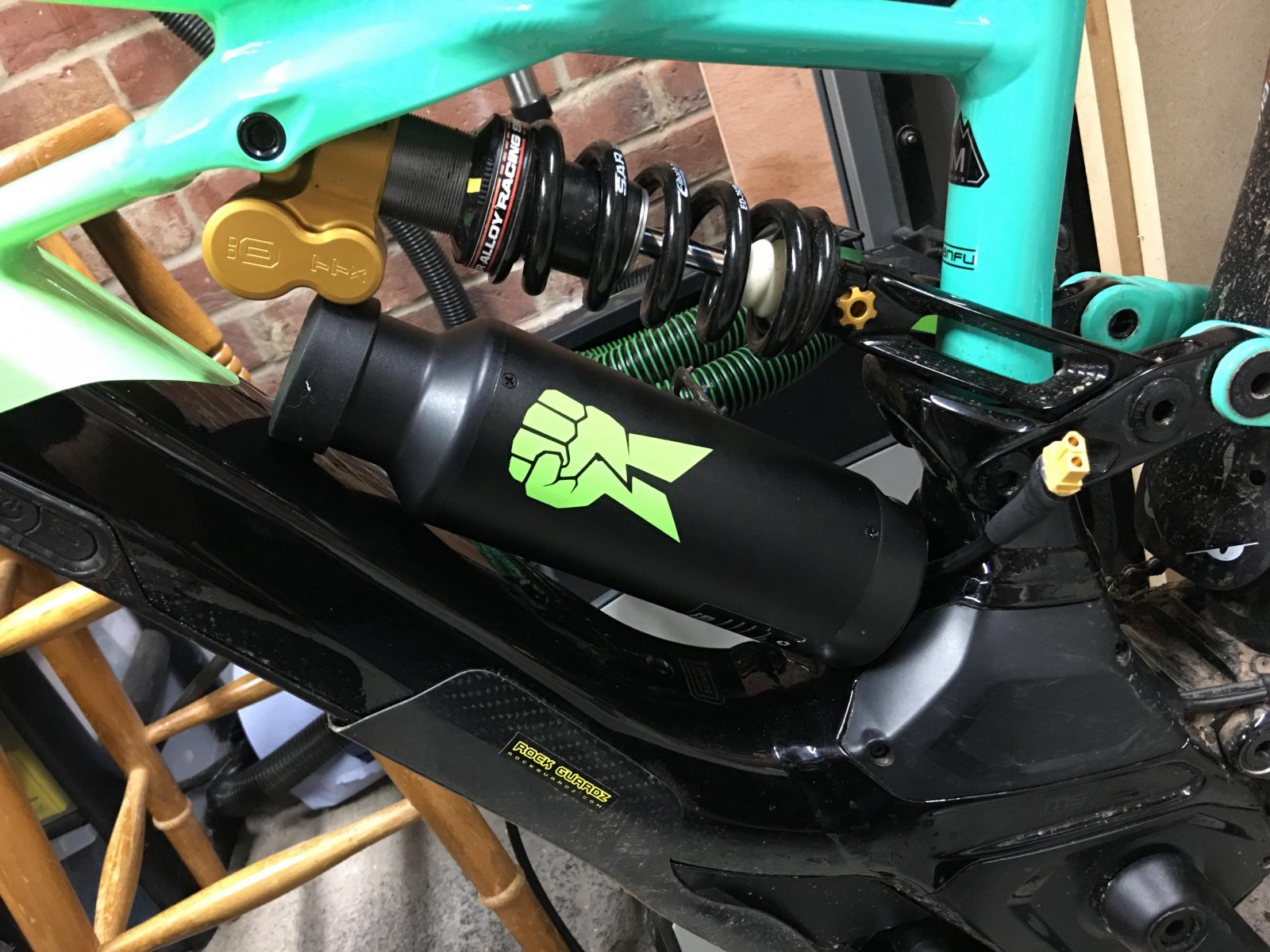

So mine turned up and unfortunately it wont fit where the bottle gauge is due to ohlins shock . Kinda I knew that would be the case, so looking another way to mount it. One way is at the seat post with some made up brackets.
Another way is to change the shock to something else more slimline and as good or better than the Ohlins 22m shock :unsure::unsure:
Another way is to change the shock to something else more slimline and as good or better than the Ohlins 22m shock :unsure::unsure:View attachment 6162View attachment 6163View attachment 6164

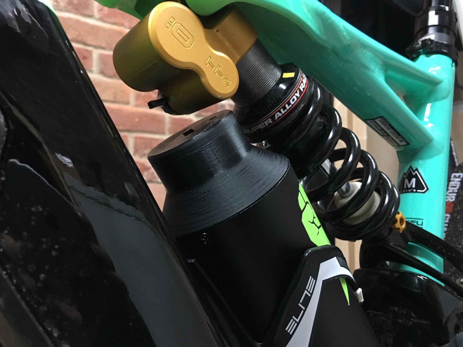

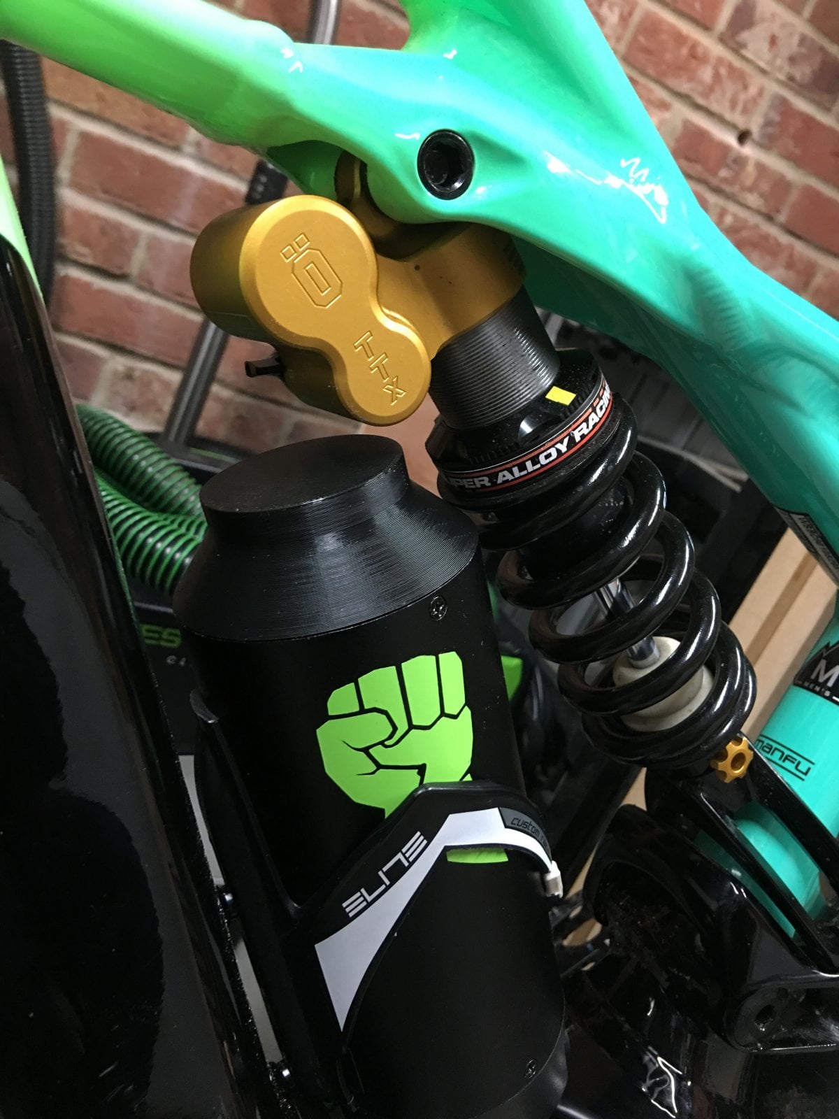

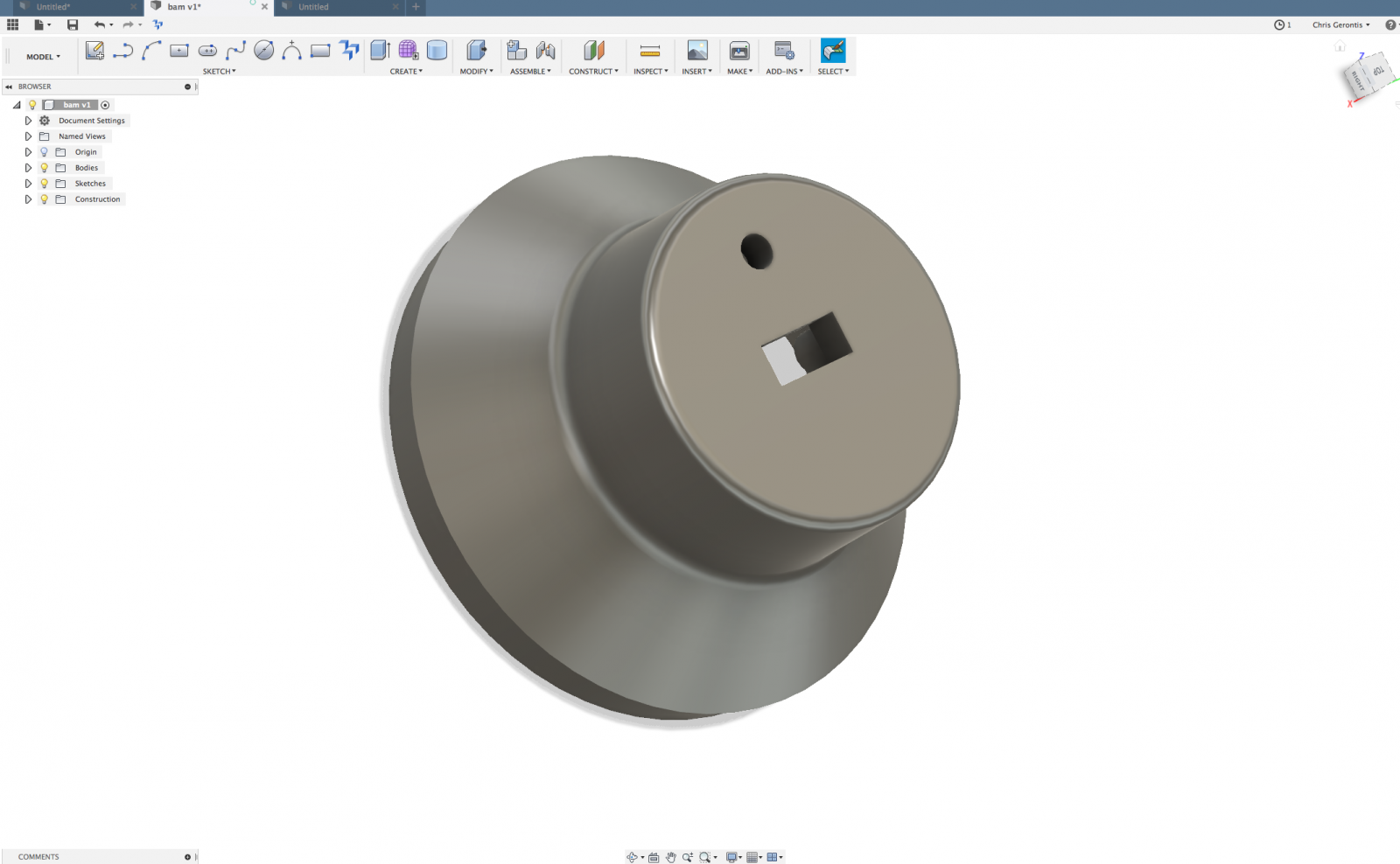

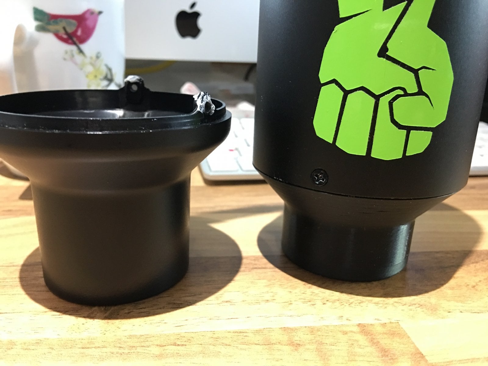

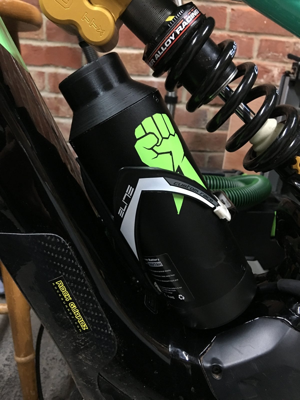

So after allot of measurement and allot of head scratching, I desided this can be fitted to the Kenevo with a bit of work. Removed the top cap from the extender and fitted the extender to the bottle gauge and got some more measurements.
I decided that the cap comes with the extender is too long and there is unused space in there and could be allot shorter.

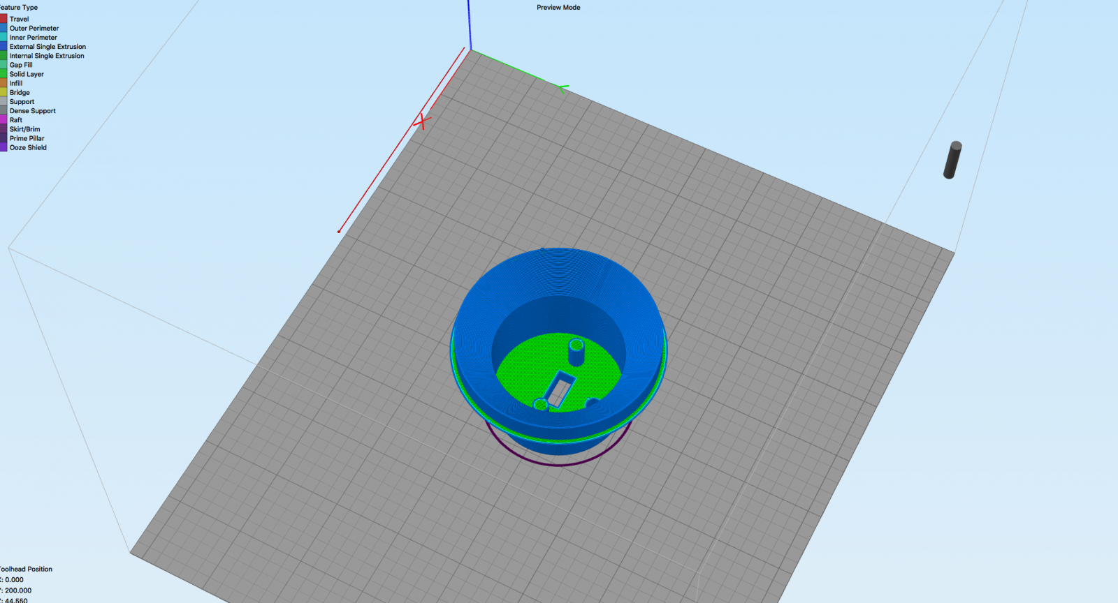

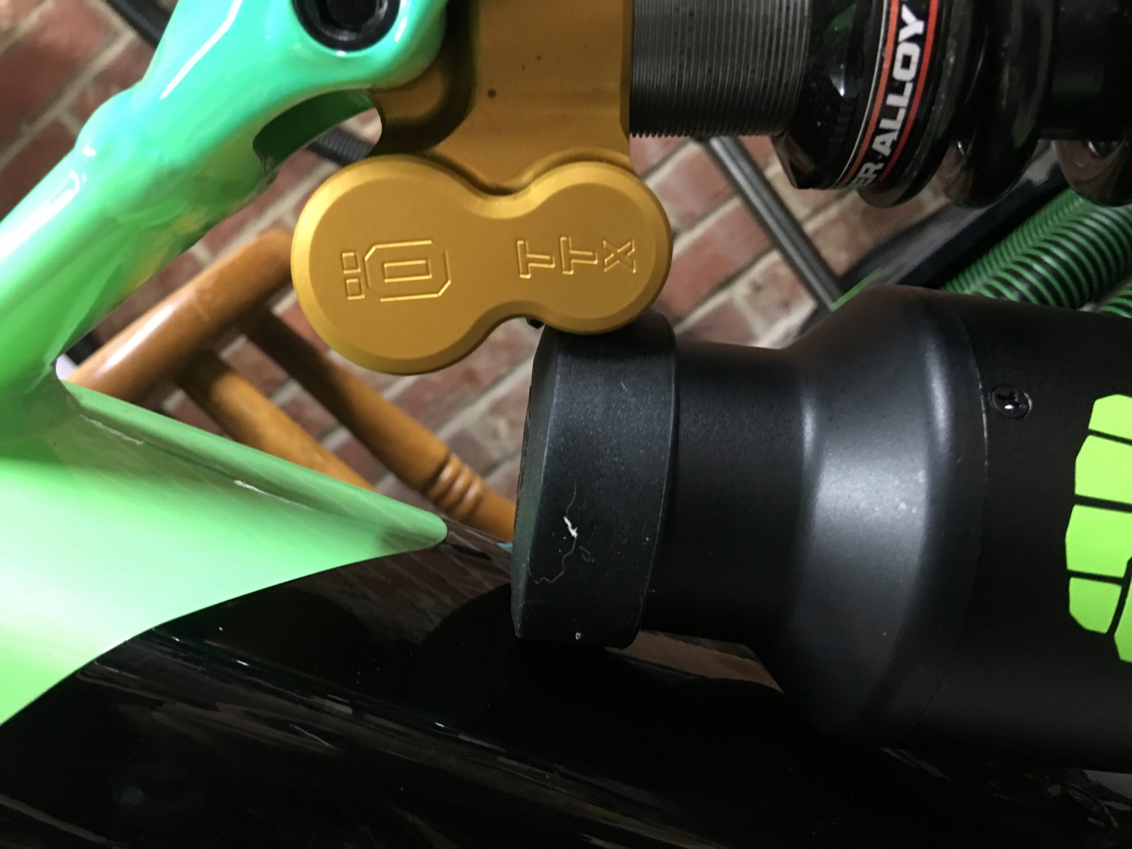

I put on my new E-Powha T-shirt :p and fired up Fusion 360 to designed my own cap with the right dimensions so it can clear the shock. Hour twenty to cook on the printer and....well, it worked, the extender fit's with plenty of clearance to the shock. There is a small gap left intentionally for an o ring that I have coming on the post.
Next the wiring :D
P.S I might print the cap again in a nice Kenevo green colour ;)

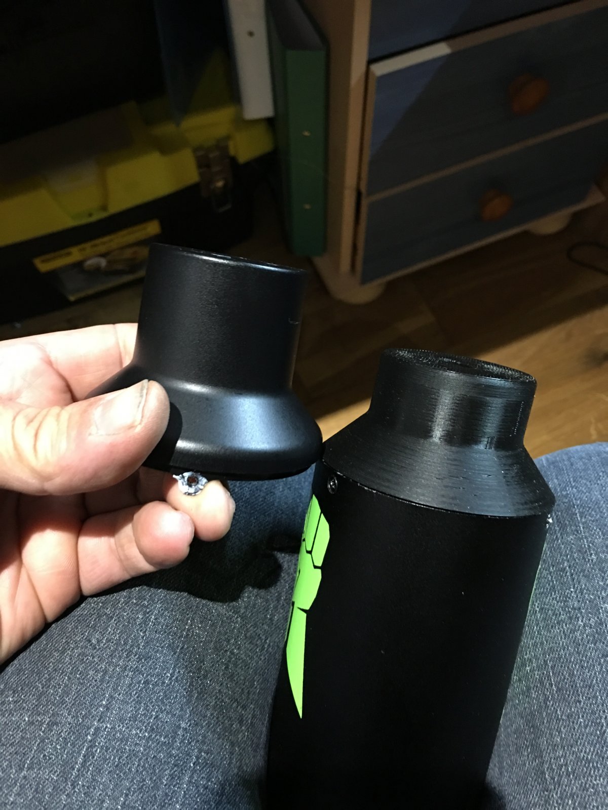

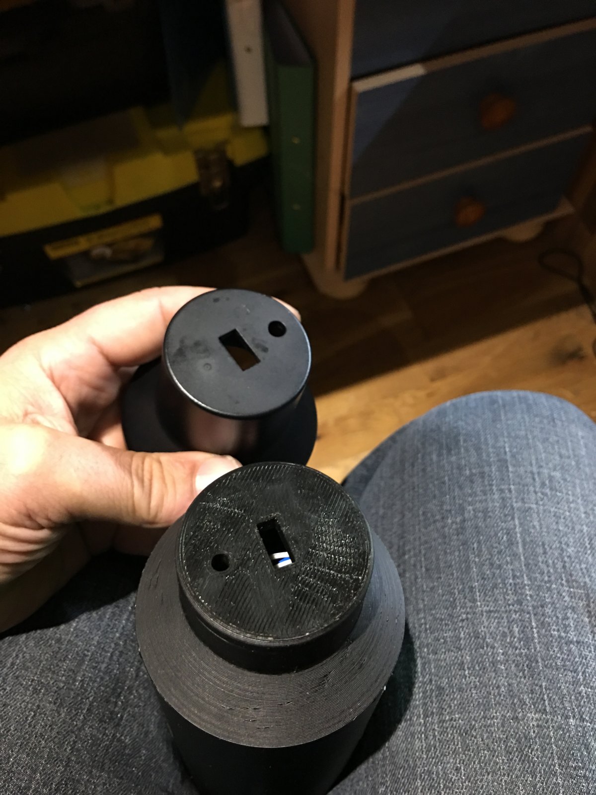

So I decided to redesign the top cap. After speaking with Danny I made it shorter so it can also fit a small size Kenevo. Also got rid the USB port for two reasons. One for been completely water proof with out it and second, I don't really need it. I always carry a small power bank in my back pack. Kenevo 756wh :eek::love:
