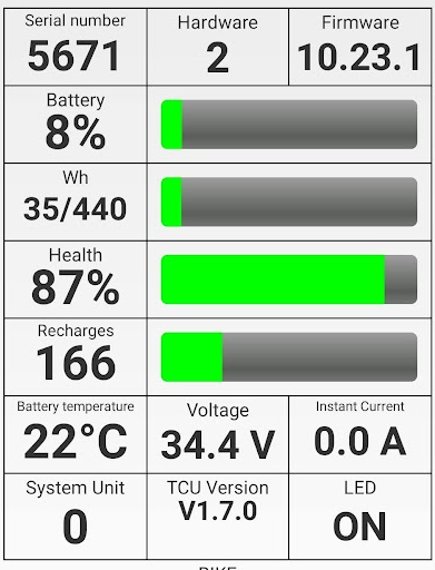

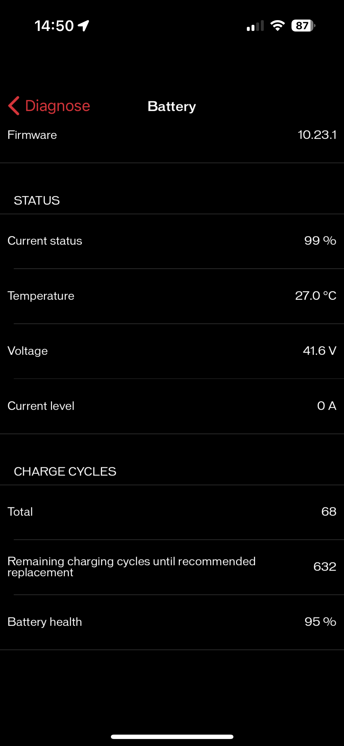

Do you know how your 504wh battery has held up ? Mine says 90% in Mission Control and 87% in Blevo, but then Mission Control has always been optimistic with battery healths. I lost 10% in the first few weeks (I was concerned !) , since then it's been about 1% a year. Presumably it was 90% when I got it, from being stored and it took the BMS a few charge cycles to work that out.

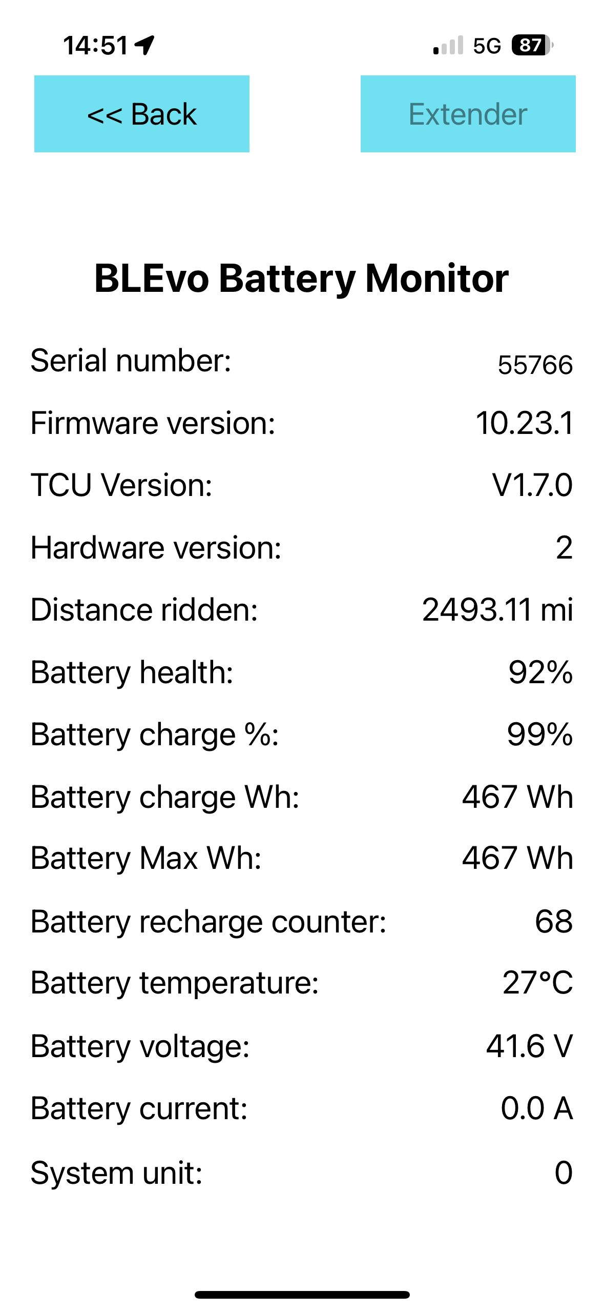

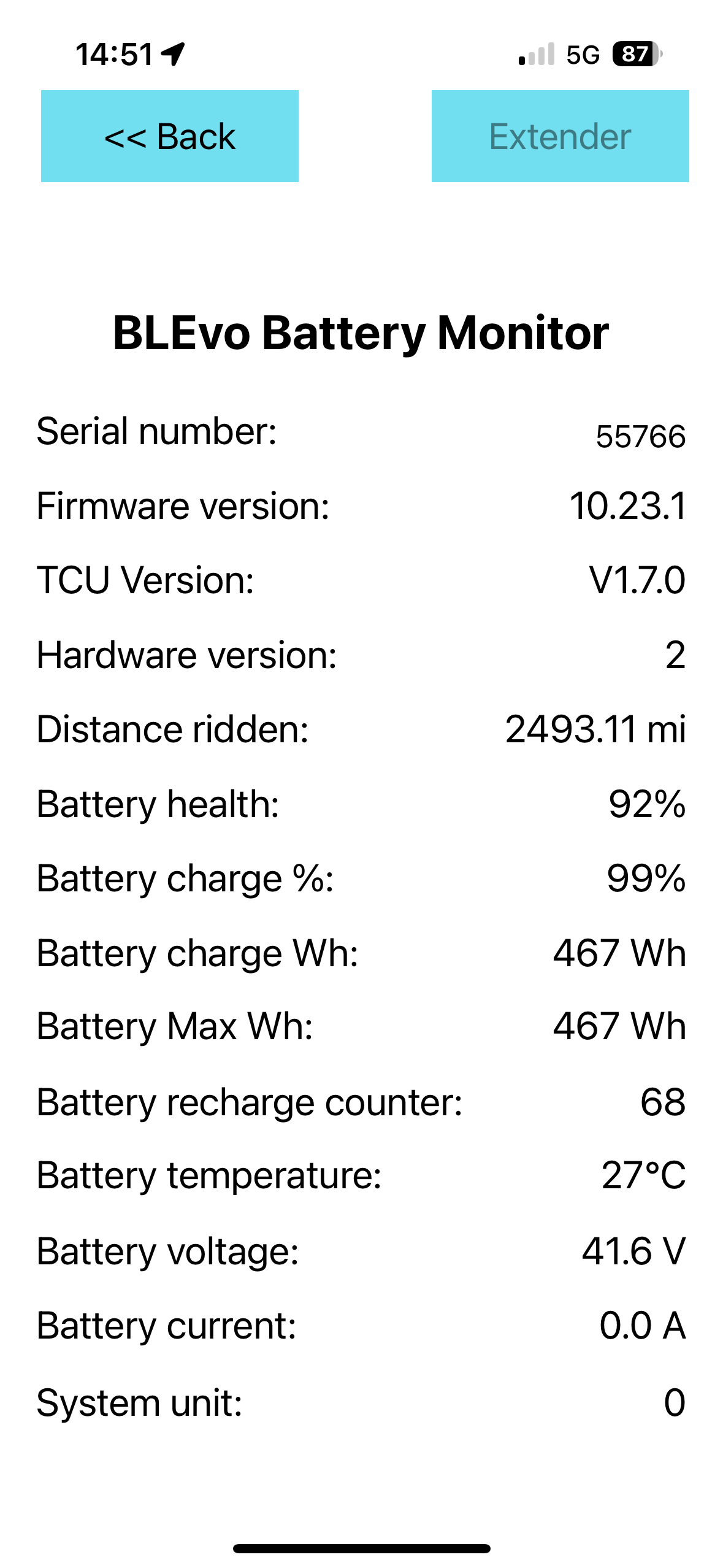

I've still got old and new Mission control, unsurprisingly they don't agree :ROFLMAO: BLEvo is less optimistic on mine too.....
Your battery is still in remarkable condition ! (y) I think Blevo's probably the most realistic.
That's not my original battery....

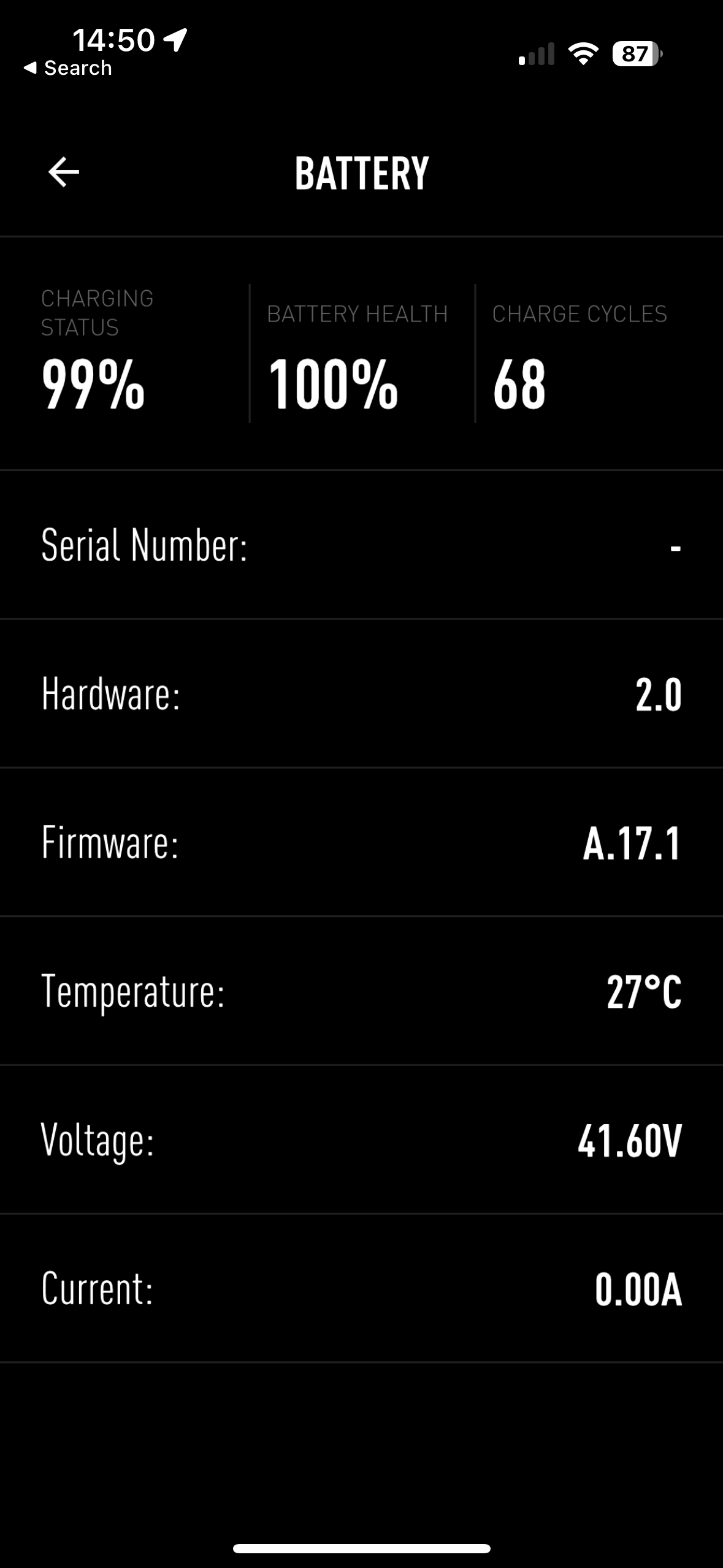

I think we are on par... You've had 166 cycles and are 87%, I've had (on this battery) 68 cycles and are 92%

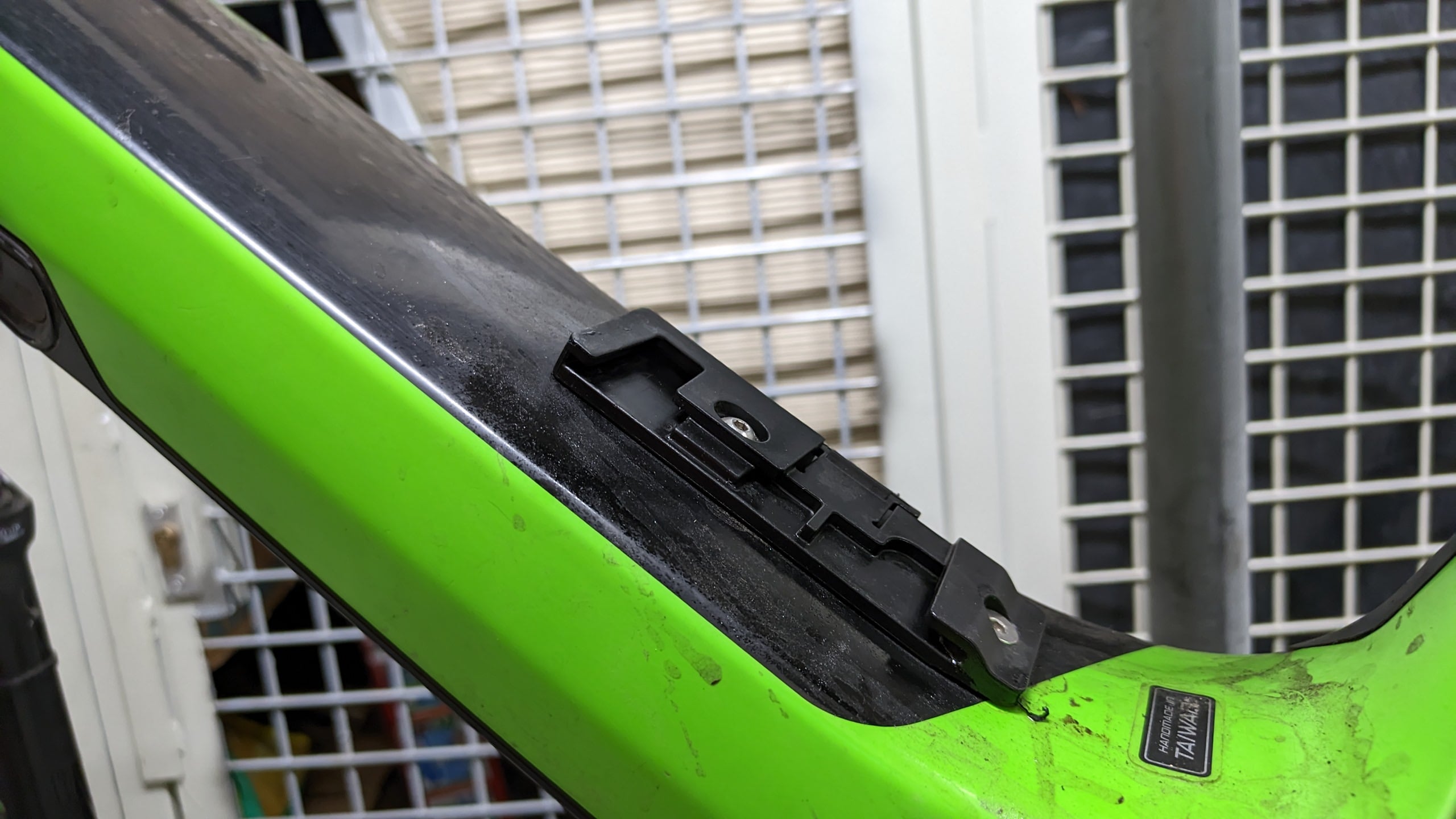

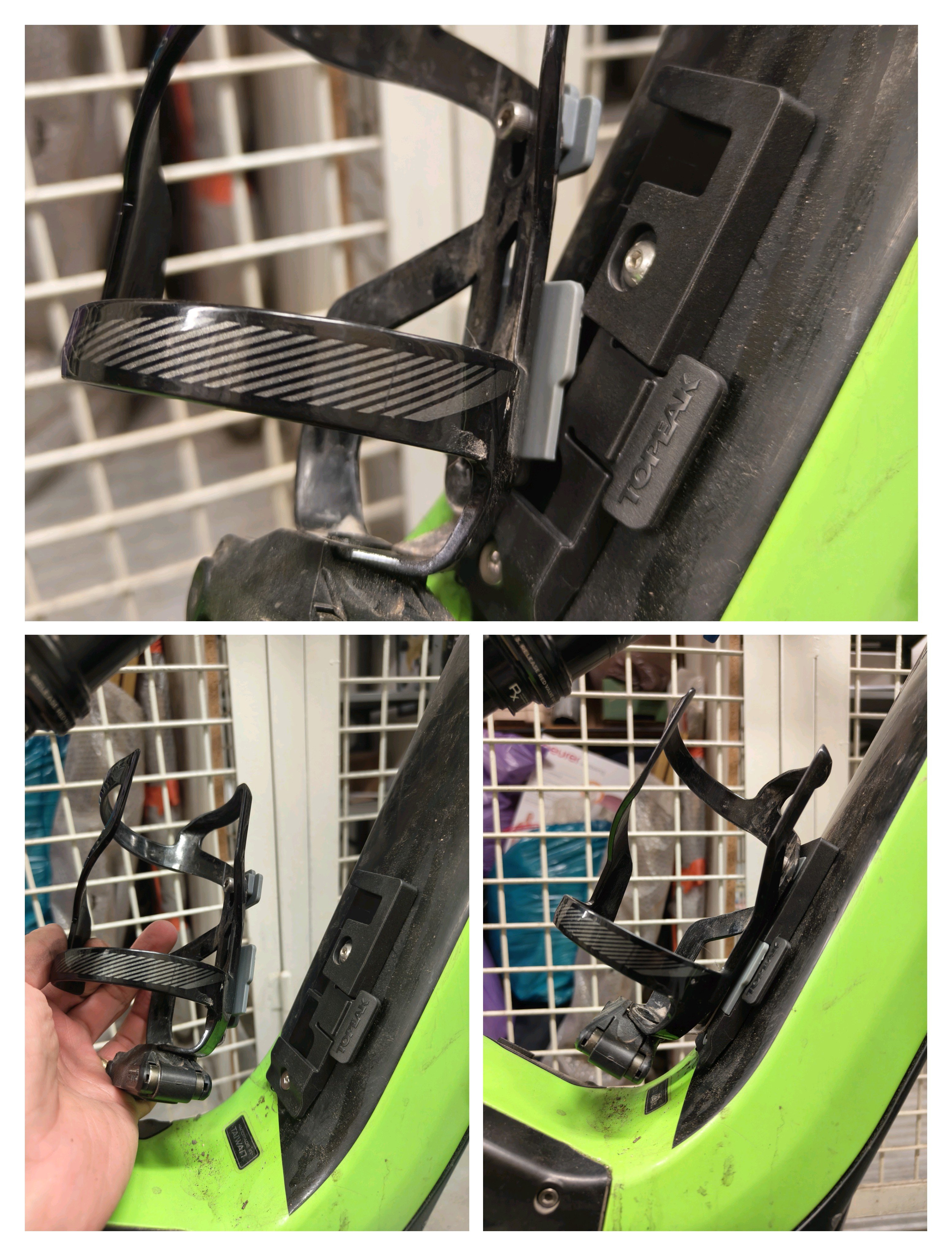

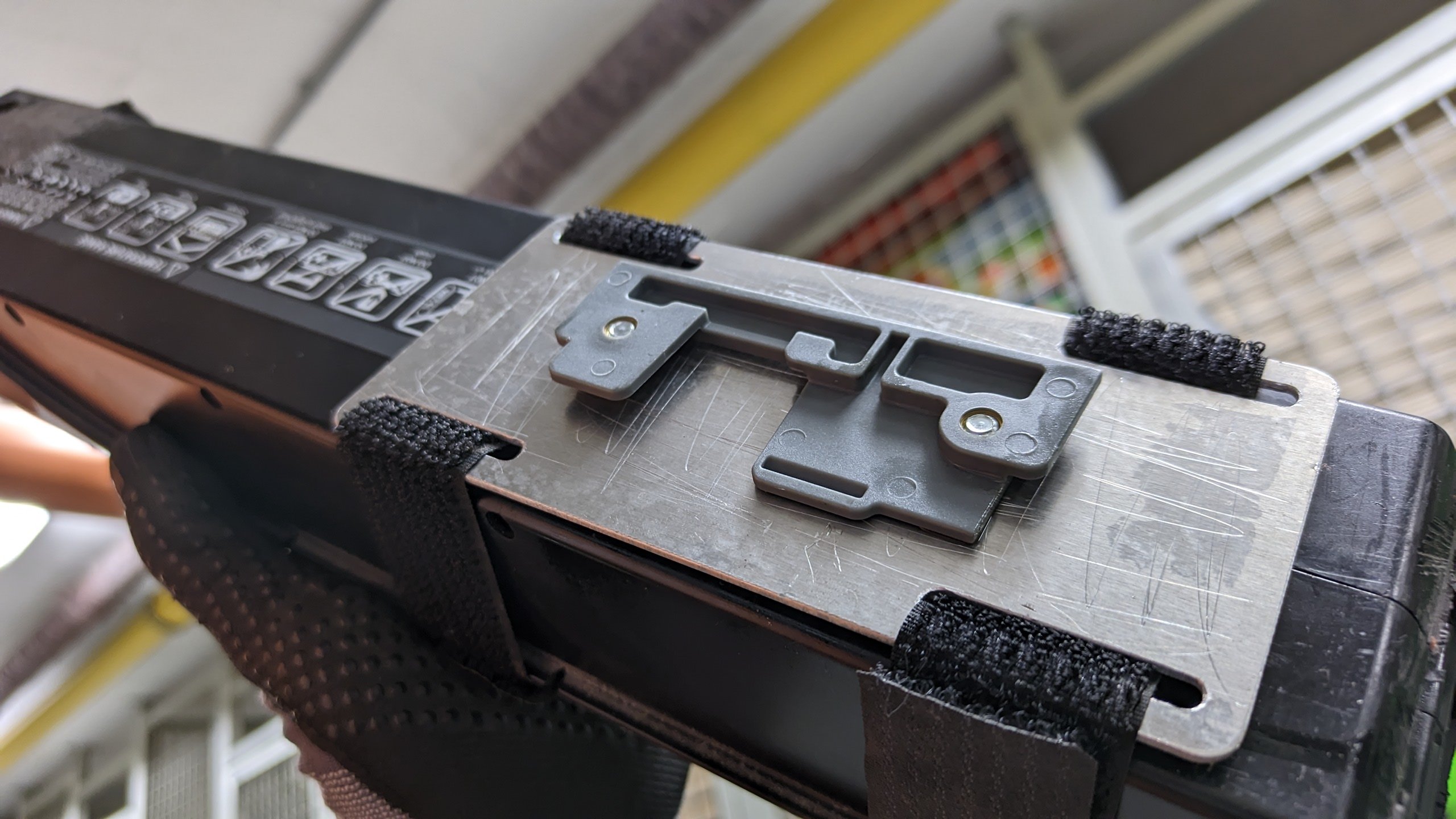

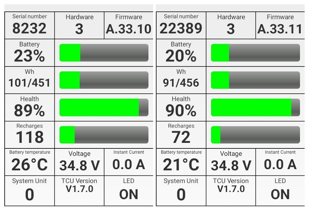

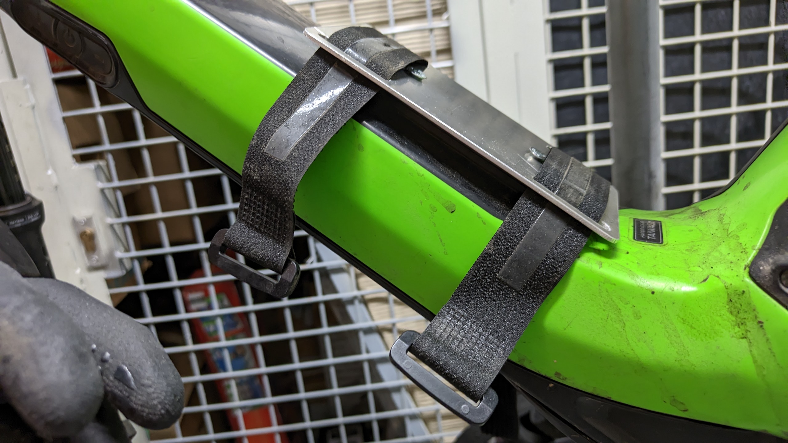

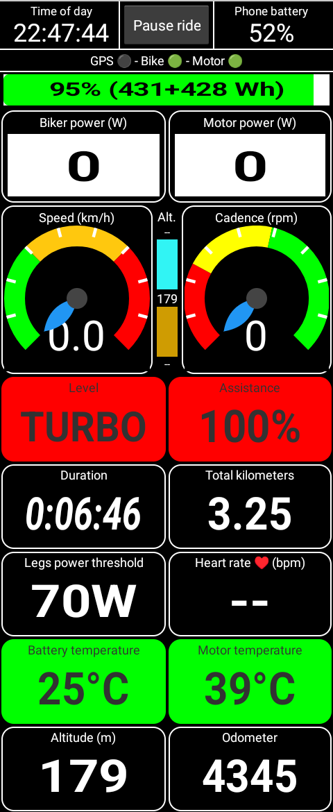

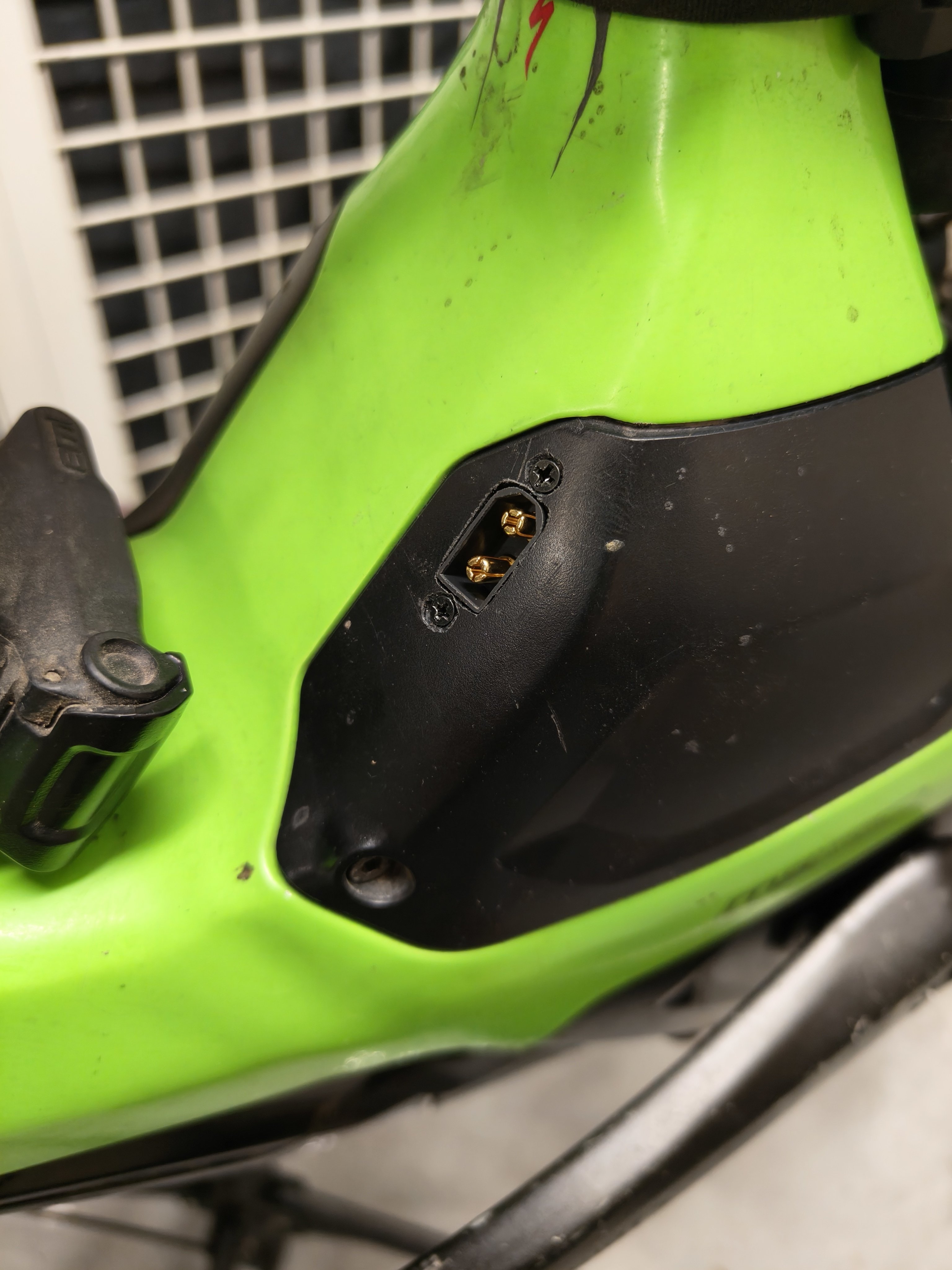

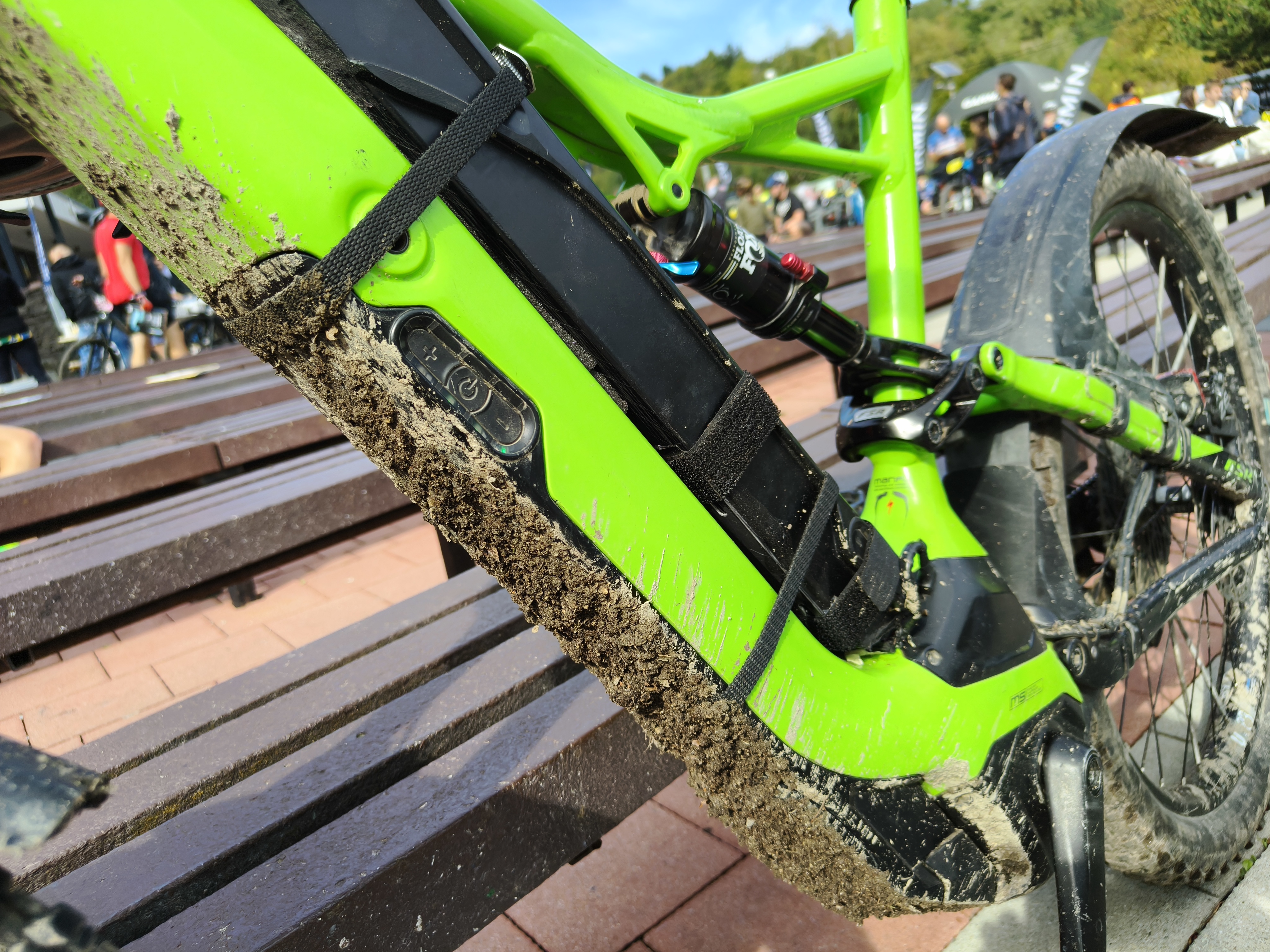

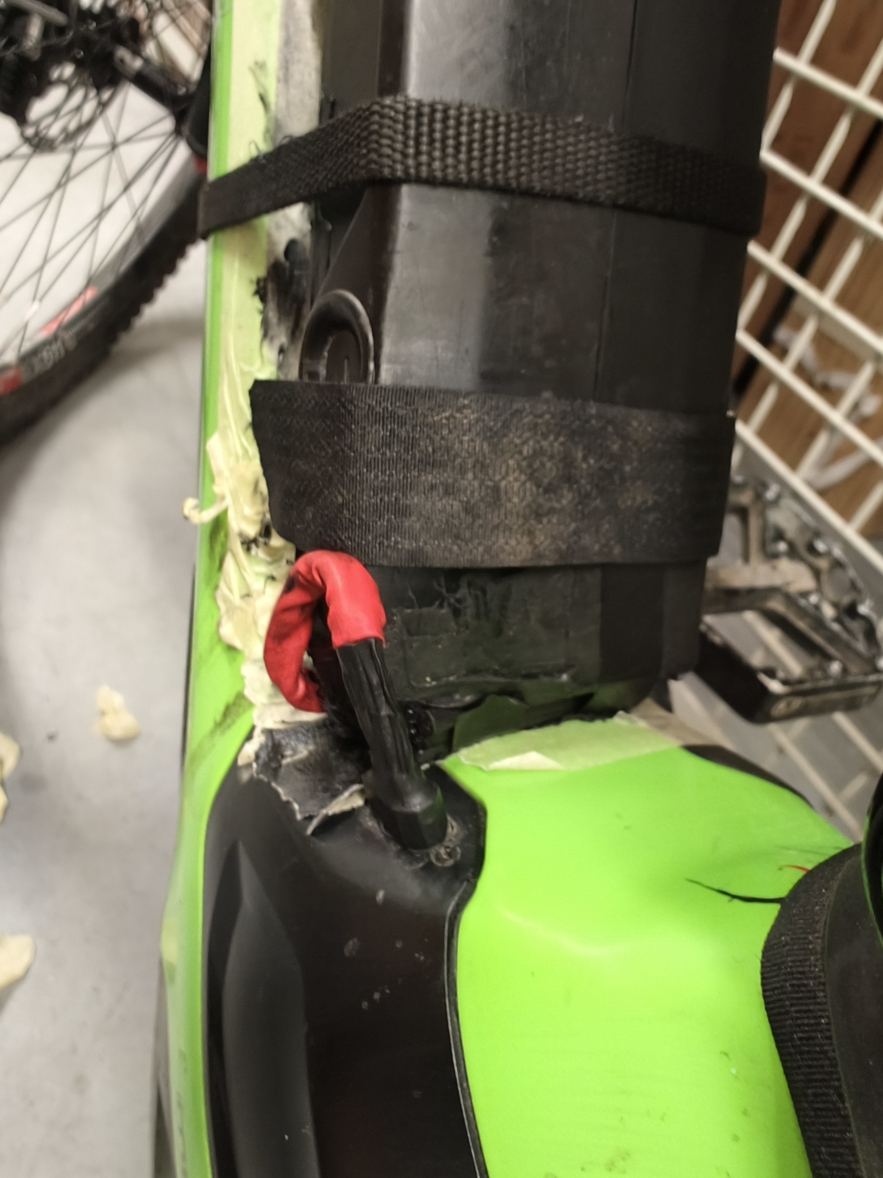

Hello friends. This site and forum posts inspired me to make a battery range extender. I used an older original battery for this bike. This older battery originally had a capacity of 504Wh, but now that it is in poor health at 89%, it only has 451Wh. I modified it a bit and attached it to the frame. The electronics with diodes are connected to the cable to the motor from the motor side. Yesterday I had my first ride. Just a half marathon of 52km 1250m in 2h and 12min and in the record from the Blevo application the peak motor power was over 800W. This is how the Blevo application shows me the status of both batteries. The battery is attached to the frame using a bottle holder. The inspiration for the holder is here from the forum. The battery can be disconnected and replaced with a bottle. The bike can have an original 500Wh battery in the frame or a similar one on the holder. I still have to fine-tune the fit, but in principle the solution is ready and I'm happy with it. And I didn't have to pay anything extra.
