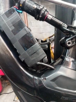

I've almost finished my 10s2p range extender. It has light sockets built into the case. Its slow going as i'm super busy at present.
When i have finished it ill post up some picks...I have two weeks off over x-mass, I aim to get a couple of working prototypes out to friends then hopefully.
I reckon can do them for about £230, if you want more capacity it will literally be the extra cost of the cells and a bit more 3D print time
A 10s2p extender would allow me a full day at most bike parks on a single charge, plus its small and light.
Main issue I can see at the moment is one pack trying to charge the other if the potential is different. just need to figure out whats going on with the spesh bms.

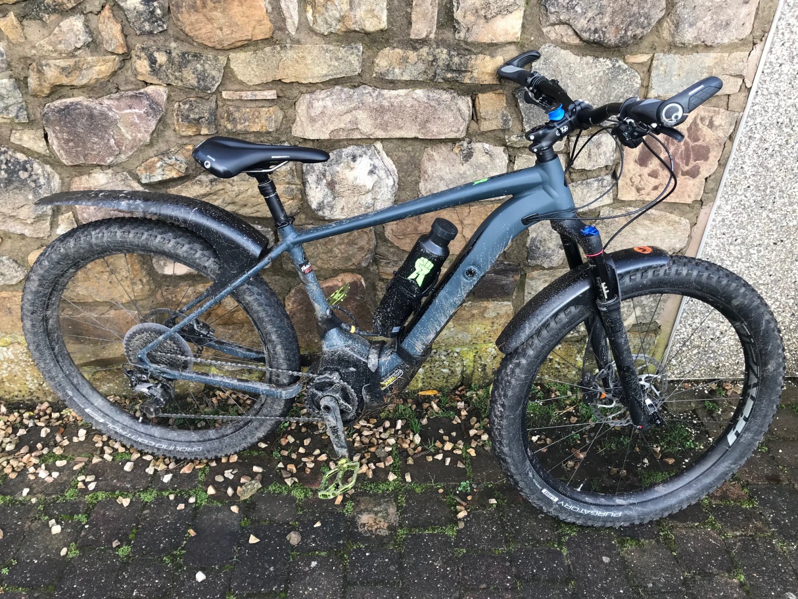

Very true, we need them as small and neat, I have bought one that fits into the bottle holder, as pictured in this thread.
