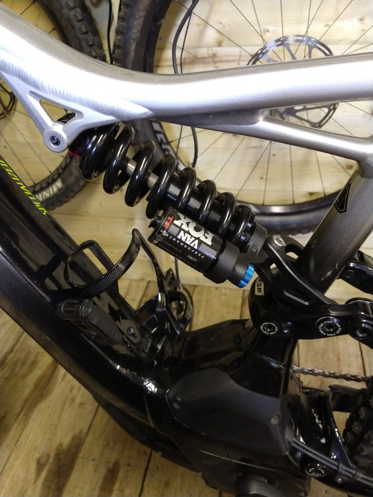

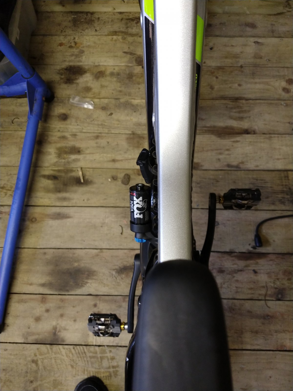

I’ll getting my Fox Van RC fromTFtuned next week and considering to mount it upside down. I know the piggyback part will stick out to one side due to the bikeyoke but I’m not sure if that will interfere with my legs when peddling.
By doing so I can still carry a bottle or an extender.

Ah now thats a good idea i going to try it

During todays ride I paid close attention to the movements of my leg/space up against the bikeyoke and there are loads of space for the piggyback so I'm sure the mounting it with the piggyback up agains the bikeyoke is no problem at all.

I did just talk to Danny and said he can make custom housing but it takes two to three months, i had something in mind a bit more flatter that half wrapped around the down tube ( imagine a tunnel shaped housing) but im going to try @khorn @khorn idea first, if it works prob solved. I will do it tomorow and report

Brilliant Dave, as a matter of fact I think that there is now more space that with the stock shock as there is no climb switch now.

That shock reservoir/comp adjuster would definitely catch on my leg. I had to put gaffertape over the schraeder valve on my Capra's shock as it catches my shorts in the air (especially whipping/tabling) and it sticks out nowhere near that much. (similar shock arrangement/position to a spesh - without the stupid yoke tho so the piggy back sits above the shock where it should be
As they say though. YMMV
Hope it works for you.
I have only had a quick ride so far and it seems fine, the bike has a wide qf and the cranks i have fitted make it a little wider so no snagging.
If they had designed the bike yoke with the hole in the horizontal plane it would have been simple but it is what it is
