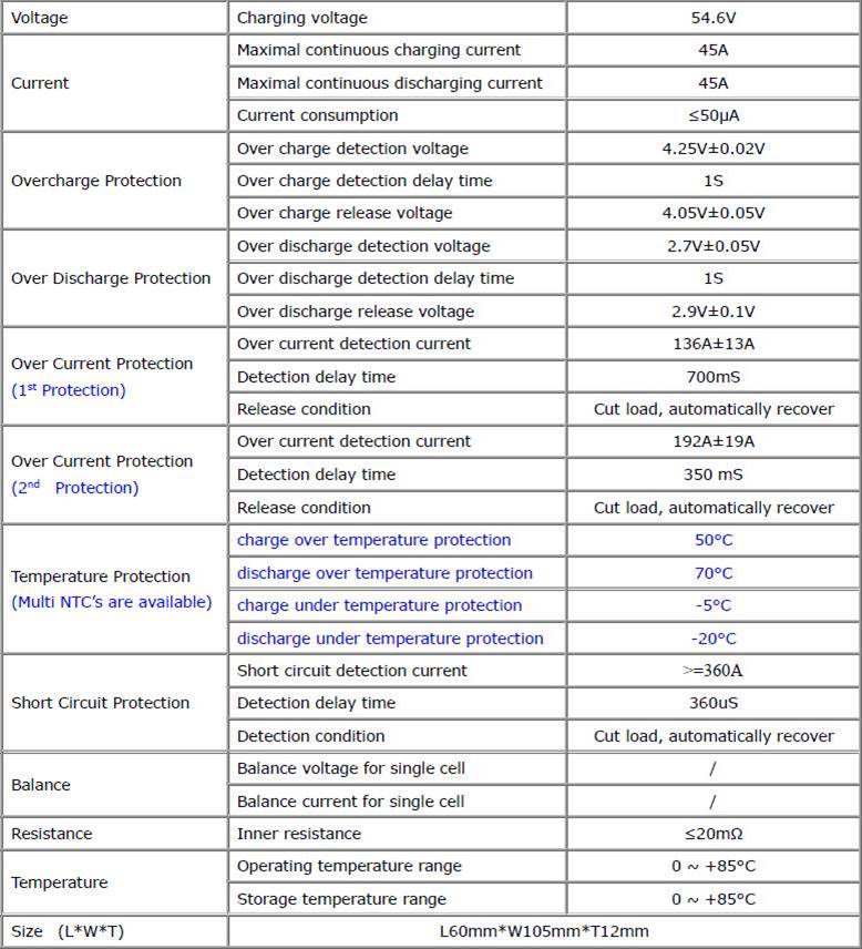

Just in case here are the BMS spec's for a 48v 5A battery:
I would check this against the spec's for a Levo BMS, which is 36v granted but the parameters should be the same in regards to charging/discharging. The Levo BMS is set for a 18650 cell and I don't think that they would be compatible.
Batteries are available for sure. Just be careful building a pack as it is not rocket science but will go off like a rocket if not done just right.

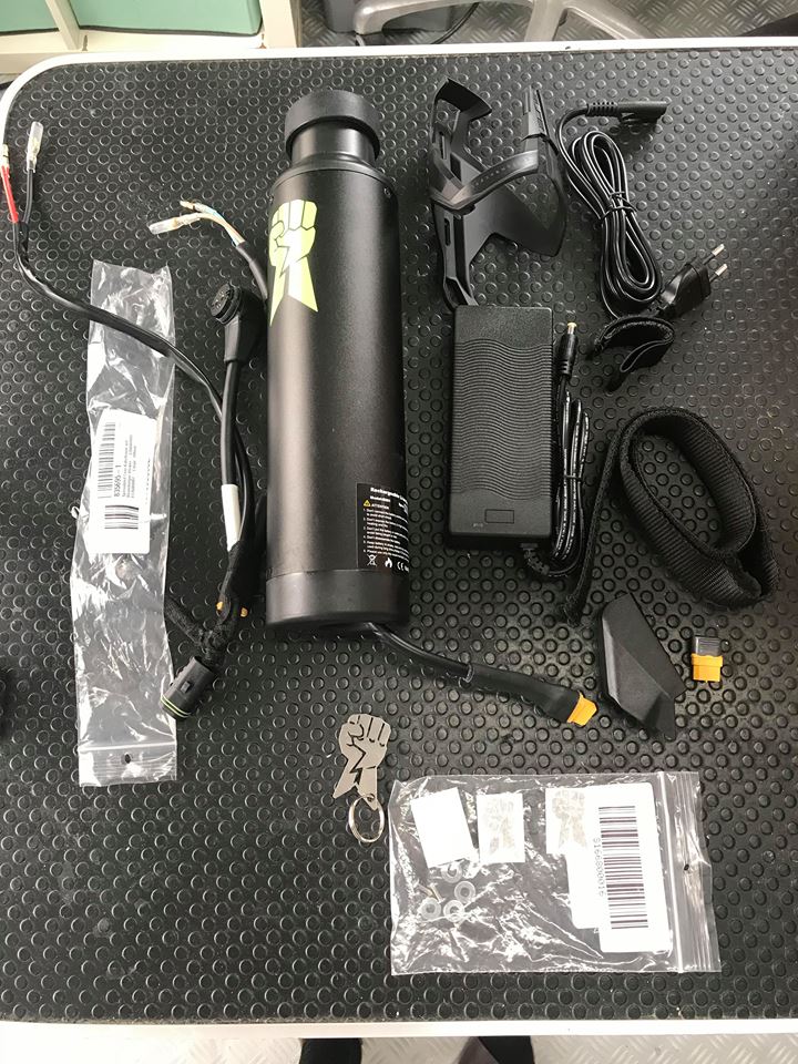

Looks good! Great to see alternative solutions for carrying the Levo battery. It's great having a 2nd battery hey :)
Yes it is very nice having a second battery! It comes in very handy when I go on extended rides! 35kms+
