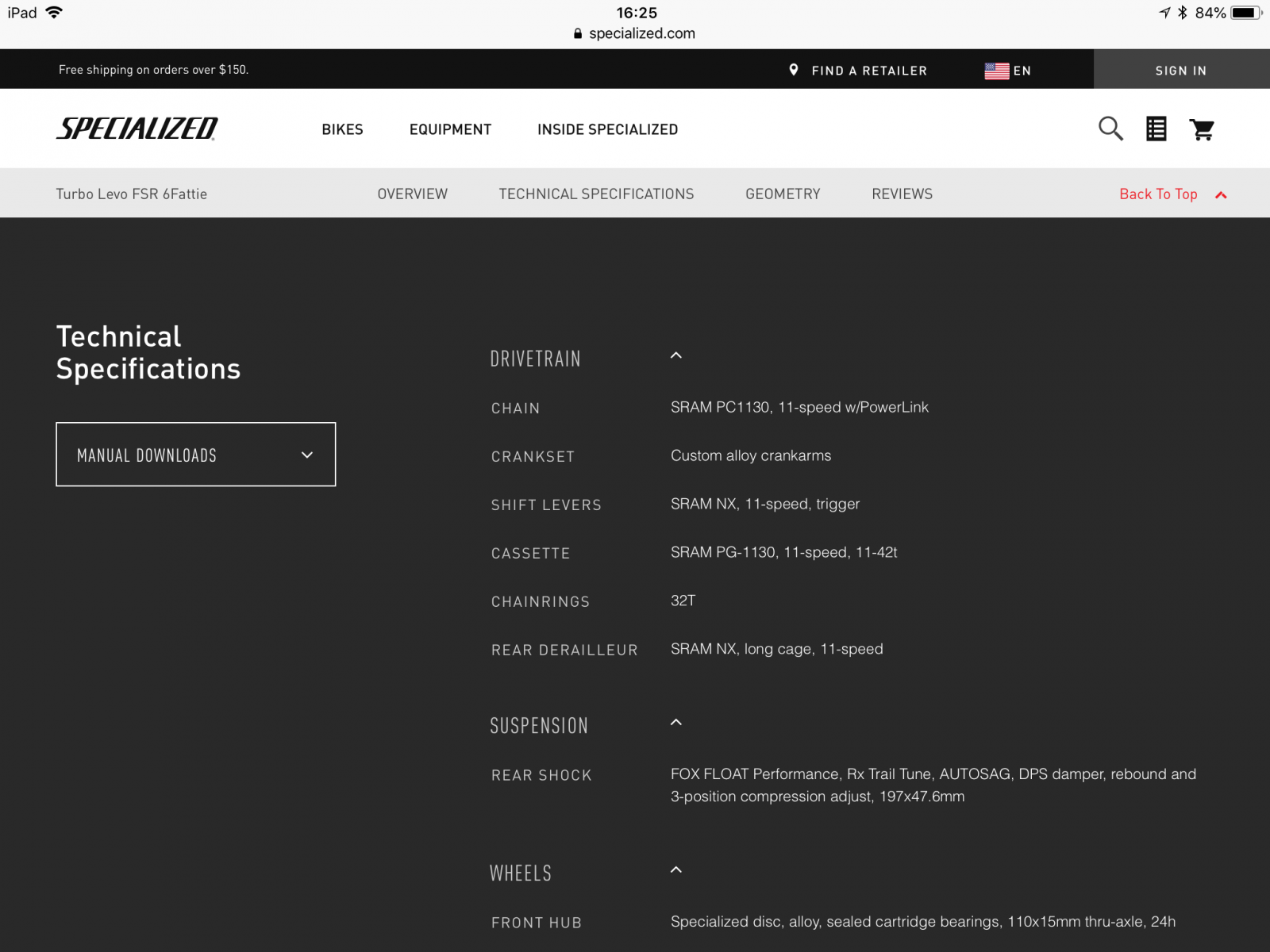

The information on the website is wrong for the Levo 2017. It states 47.6mm of stroke. It is actually 45mm as I physically measured it yesterday. My Fox shock was off the bike so I let all of the air out and compressed the shock fully until I felt it bottom out. I measured from the shock body to the beginning of the rubber ring and it was 45mm.
Maybe the info for the 2018 is also wrong? If you try the same procedure as above it will give you the correct measurement and then you will know for sure ?

I've just checked my rear shock, and it's marked 197x48. That would make it 144mm, rather than the 135mm advertised. However, there are two posts above where the stroke has been measured. One that confirms a stroke of 48, and the other that suggests 45 after measuring. 45 would make more sense, because that would make it 135mm as advertised. I don't know what to make of it!
