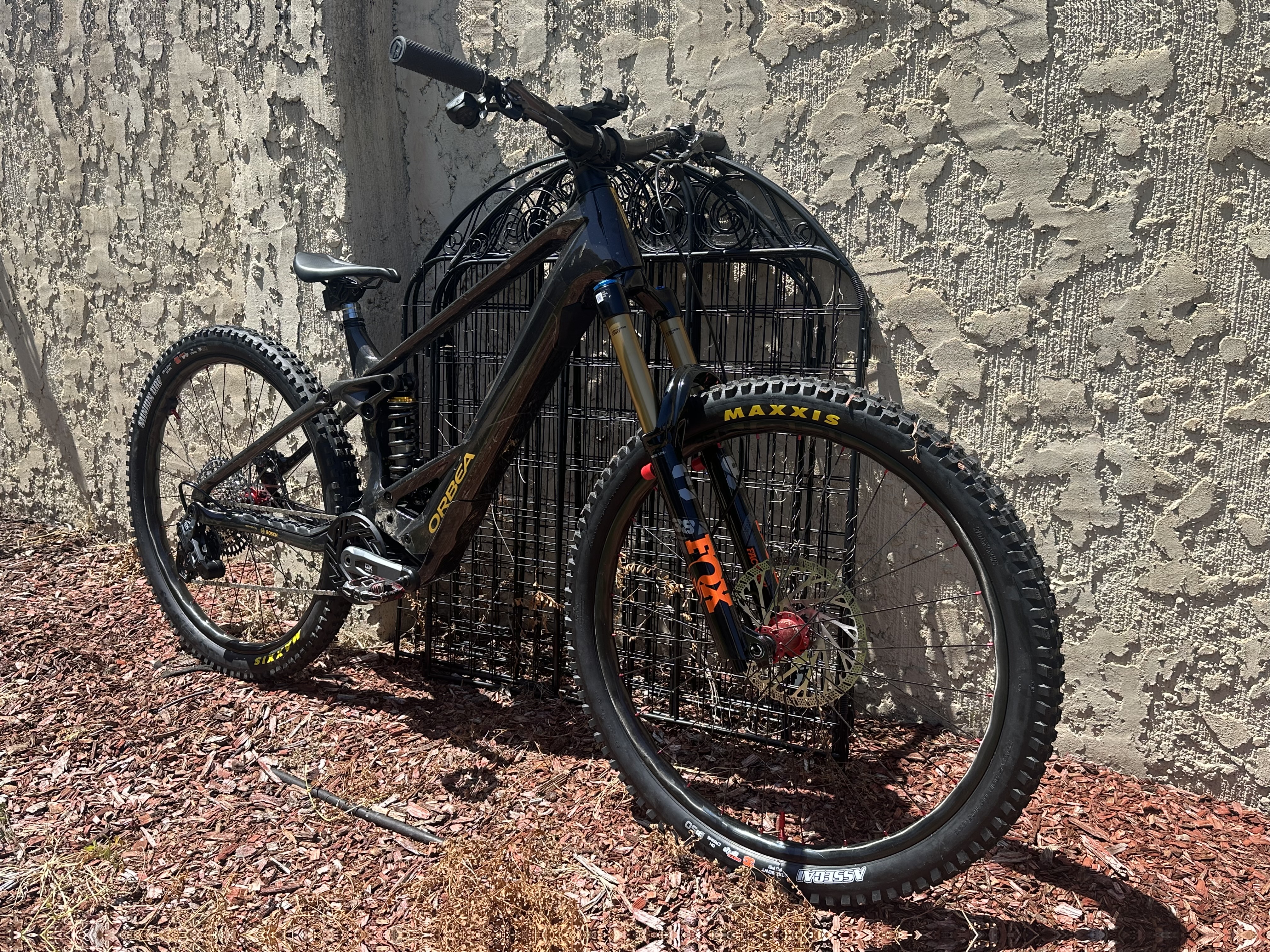

I ran my 2022 Rise H with a 180mm Fox 38, Cascade Link and a 8.5" x 2.5" FoX DHX2 with 1 offset bushing. Travel was 180mm F/177 R. I just bought a 2024 Wild and my "Enduro" Rise was more plush than my Wild but Wild has a much more stable frame, especially on the rear end.
