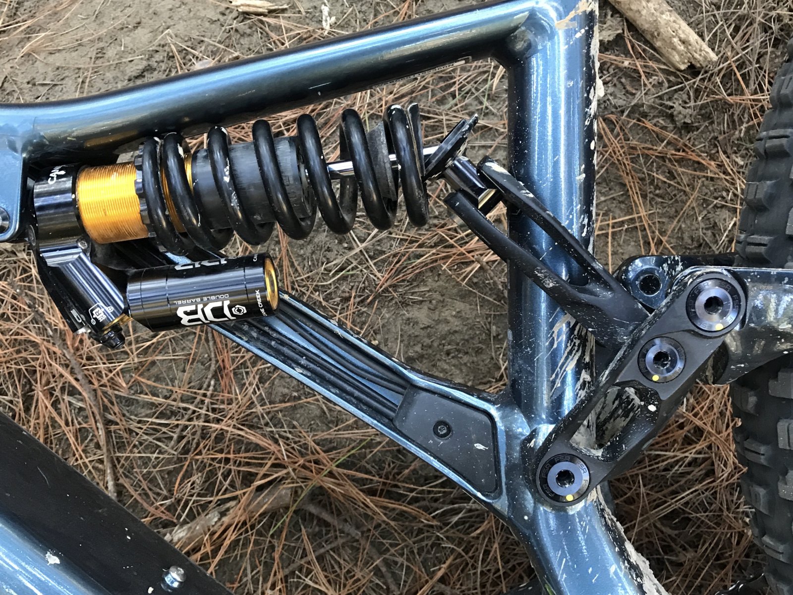

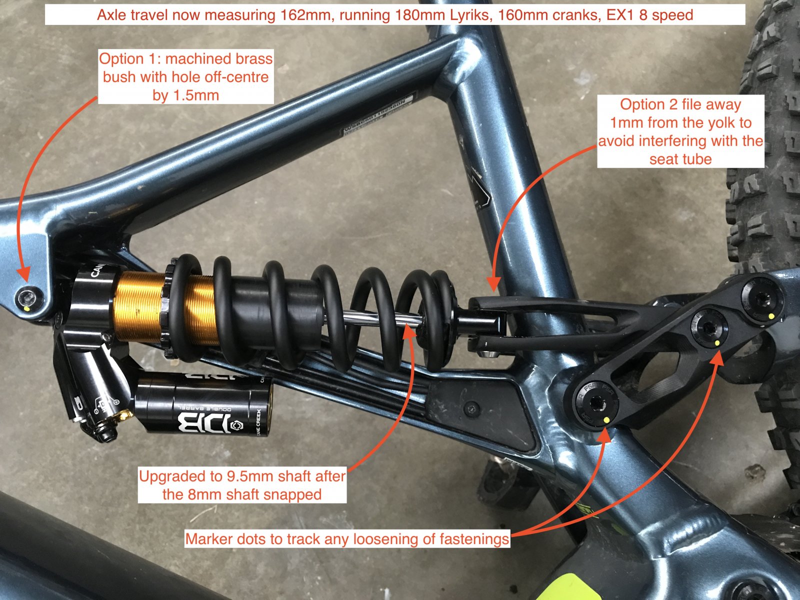

Careful with the Cane Creek, I was warned and today snapped the shaft off at the eye, replacing the existing 8mm shaft with an 8.5mm solves it apparently. I was getting about 162mm travel at axle and running a 180mm Lyrik forks.

Hi, is it possible to change the shaft from 8 to 8,5?
I would be really interested if this is possible for the IL version
I fancied the cane creek, but after reading the potential problems I went for the Ohlins

Not a good idea to use the Cane Creek Inline Coil shock on your Levo as it only has the 8mm shaft and there is no upgrade path to the 9.5mm shaft for the Cane Creek Inline.

So even if there is a 8,5 upgrade it is still a no go?
I have the cc dbair il mounted now but would prefer a coil version
The only upgrade I am aware of is the 9.5mm one. I just measured my Cane Creek shaft again to check with a digital measuring calliper and it is 9.5mm

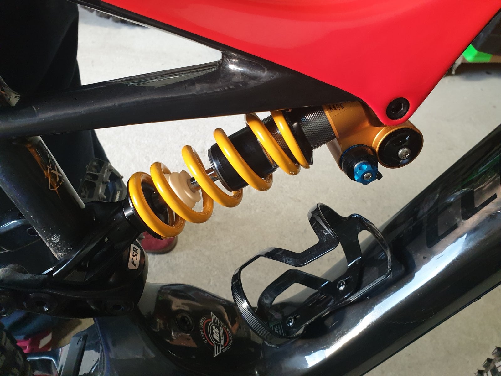

I have a ‘17 Levo with BikeYoke running the 7.5x2 DPX2. I’m wanting to experiment and have another bike here with a DHX2 coil that’s 7.875x2.25. Has anyone run a 2.25 shock to have experience with geo changes? I’m a heavy guy and like the feel of coil but know the Levo leverage curve isn’t the most ideal for coil, but what the hell. I can track down a 650-700lb coil to experiment. Before I spend money on a coil spring or two, I was hoping for feedback. FYI, I’m about 240lbs geared up.

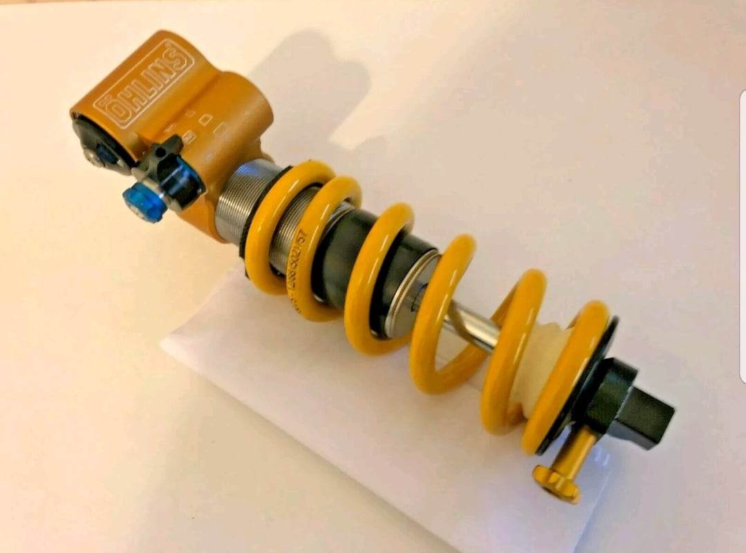

i upgraded my levo2019 expert with a rs monarch plus 3rt 210x60 , and works really better.
what is the best oil for this sock?
Monarch plus rc3 210x60 on levo 2019 , flip chip high , eccentric bearing.
160mm front fork + 0.5° spacer.
27.5 2.8 wheels
. Give me your opinion.
