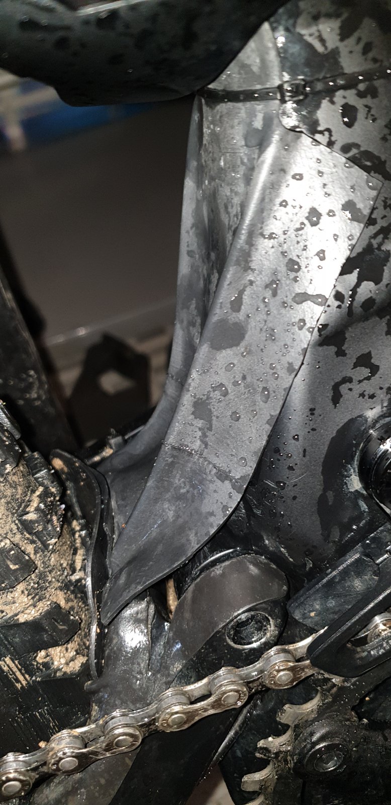

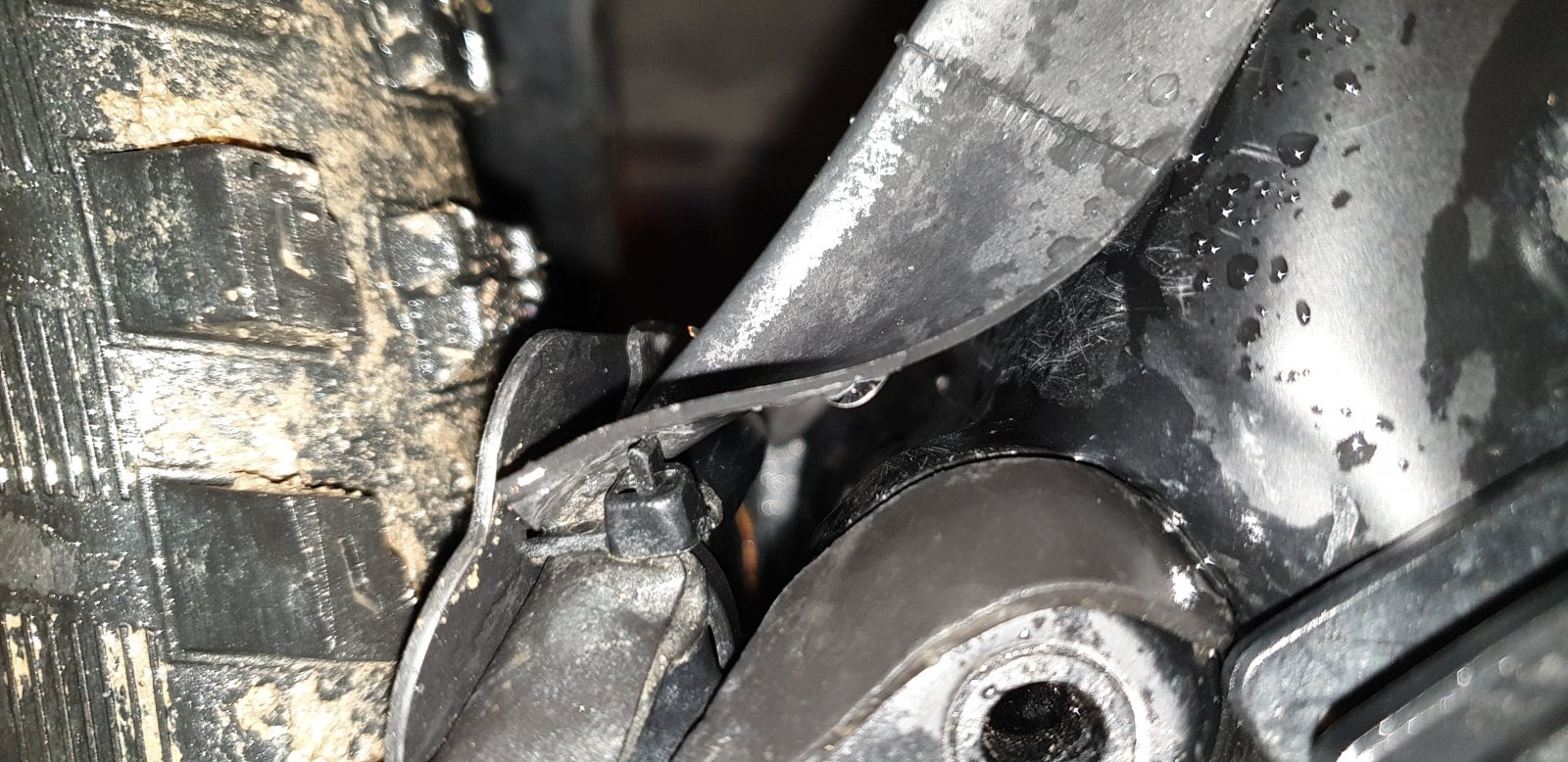

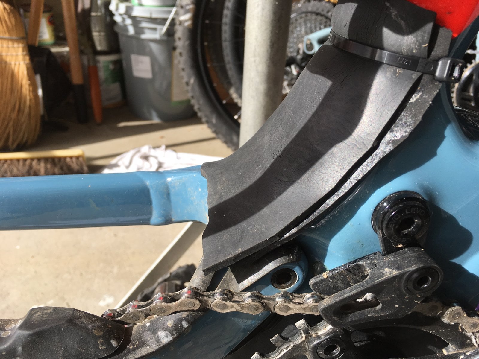

Here's my solution, old piece of inner tube, plastic rod to keep it rigid and a single cable tie to hold it in place. I have put a piece of clear paint protection film on the frame where the rubber touches it and might scratch it. I've also put air filter foam inside the motor housing as a belt and braces approach.

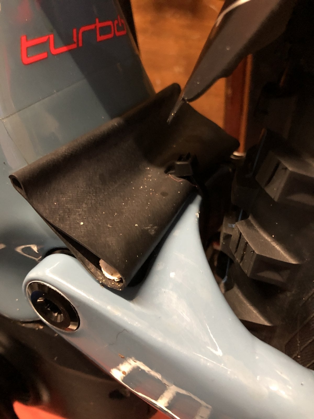

Is it just me I am running a cut front mudguard on the rear of my carbon 2019 to stop the majority, but don’t want to stick anything ugly to the frame !
I am hoping that if any damage occurs that it will be covered until spesh come up with a neat professional looking fix !
Thoughts ???? ............

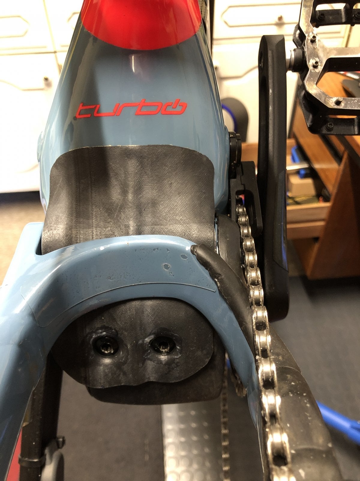

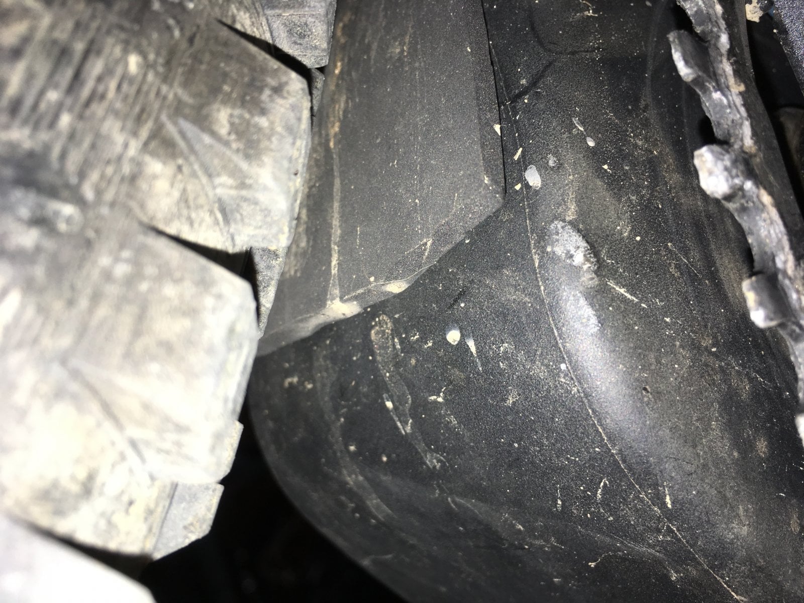

I was thinking about this a bit more and came up with this slightly better solution:
Cut a piece of old inner tube and shape to fit, punch two holes in for the two motor case screws and apply to the frame at the top using double-sided tape (I put grease around the case screws to stop them gripping the tube and twisting it.

Hi Estoril,
I have just copied your inner-tube solution, but instead of double sided tape, I've used heavy duty Velcro.
How has your fix been performing? Does the constant movement of the rear pull on the inner tube at all and spoil the performance?
I only did mine last night so not tried out the effectiveness yet
Cheers
Stevo

No, no pull at all since the inner tube goes down the back of the suspension arm!
It's been working well, took the cover off the other day and hardly any crap in there, few bits of grit and wet of course but quite clean.
I've just improved mine a bit as well, instead of using the motor case bolts to screw through the inner tube I have cut an old piece of mudguard to fit over the two holes and then have put a cable tie through the motor case bolts, through the tube and then through the mudguard piece (the bolts are hollow).

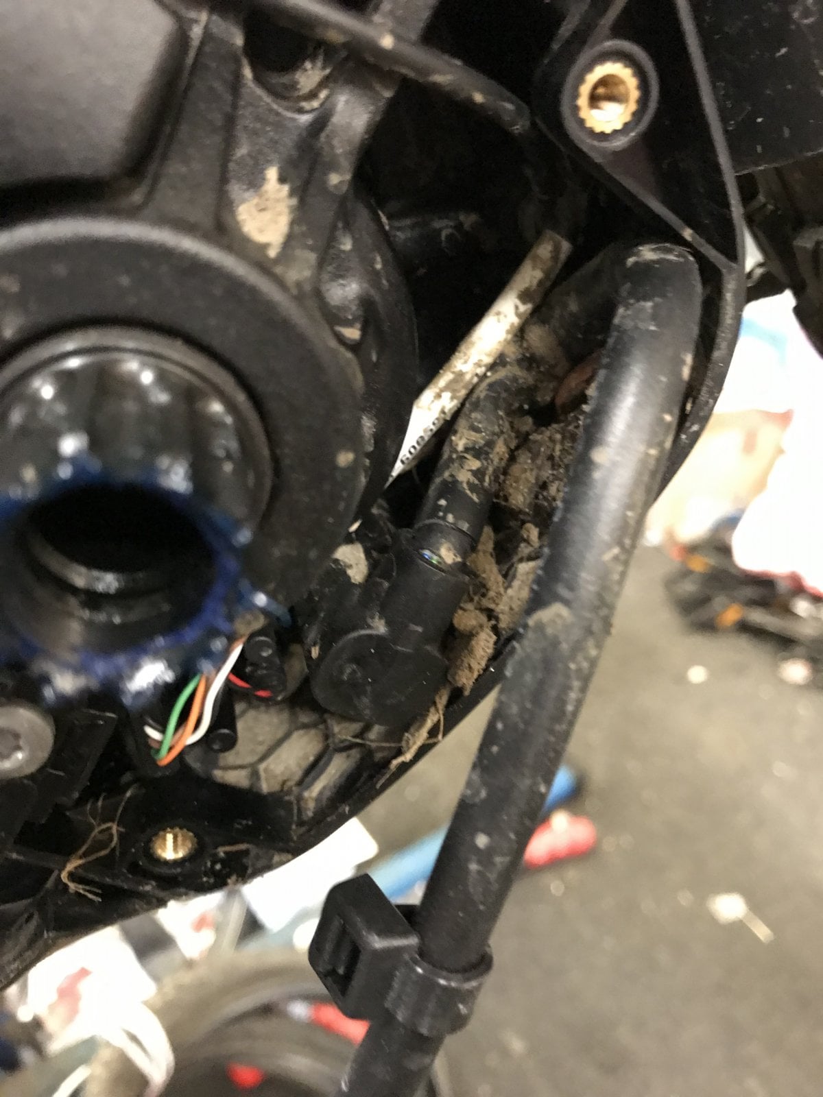

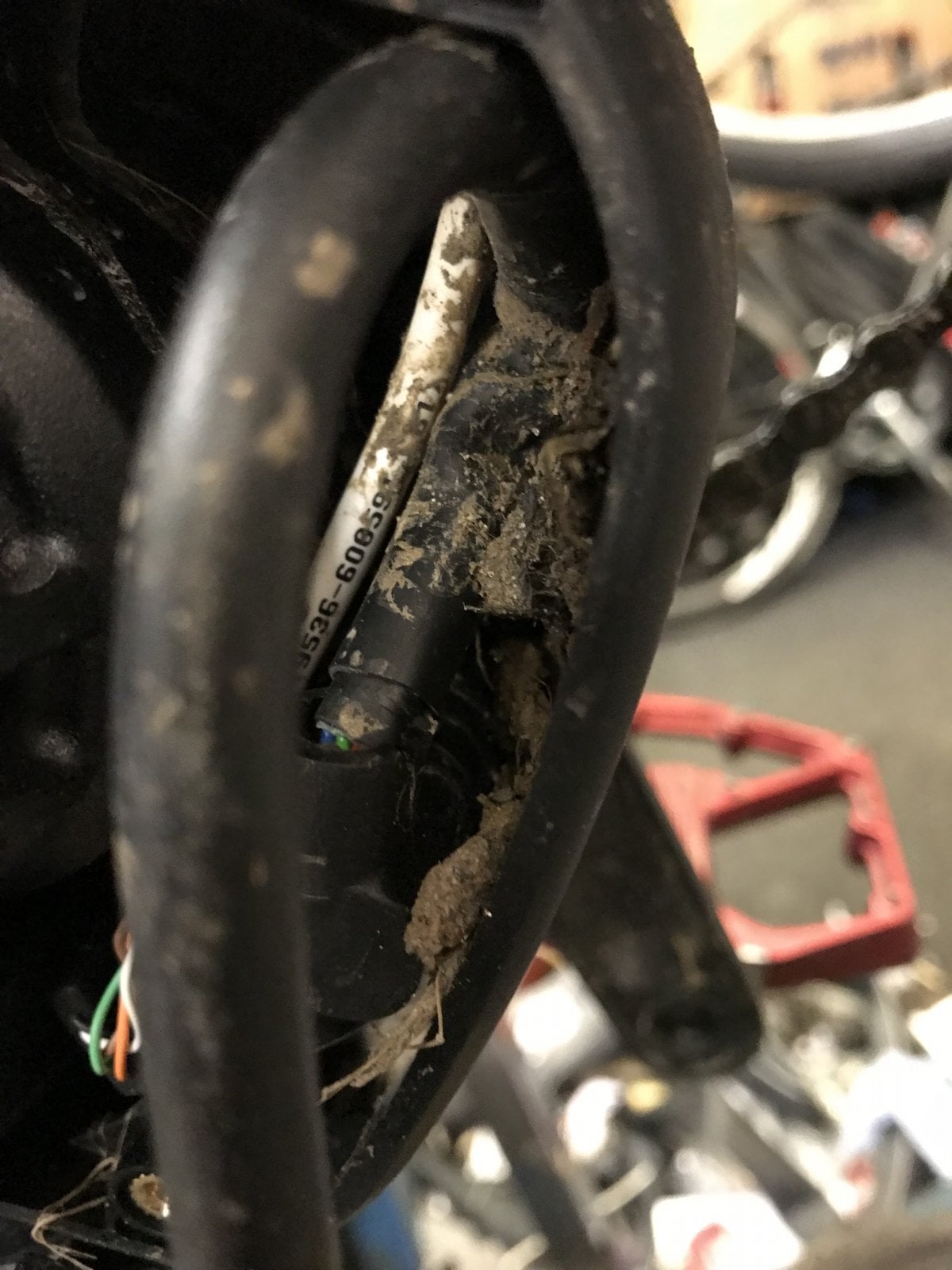

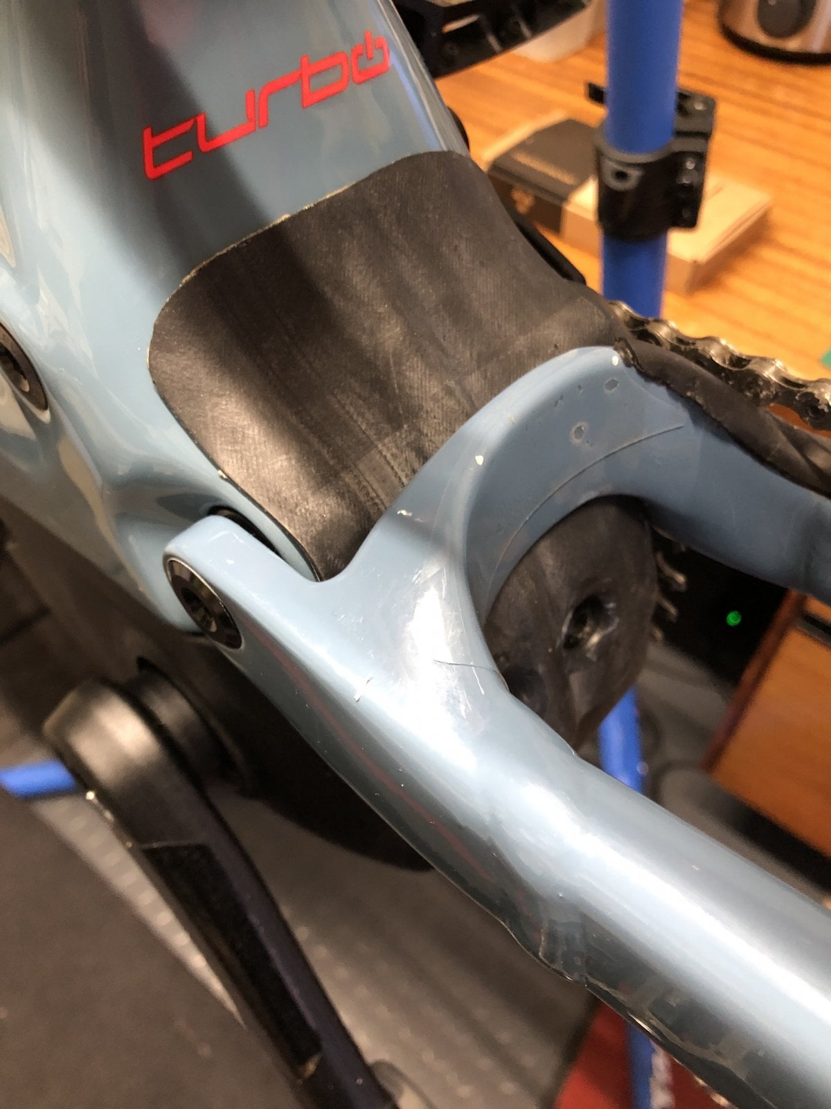

Had the foam fix put in at my LBS today picture of the motor case when opened .
I have done just over 200 miles but have had a cut up old front crud catch mudguard on the rear down near the motor case gap since day one !

Wow, I wonder how long the motors and cables will last with all the dirt inside. I ride my bikes normally for more than 10 years. Will that be possible with these bikes, and how much additional costs will there be fixing the issues over time? It seems that soon with e-bikes people will also start discussing the follow on costs similar to cars and we will have guaranties from the brands also like in the car industry.
