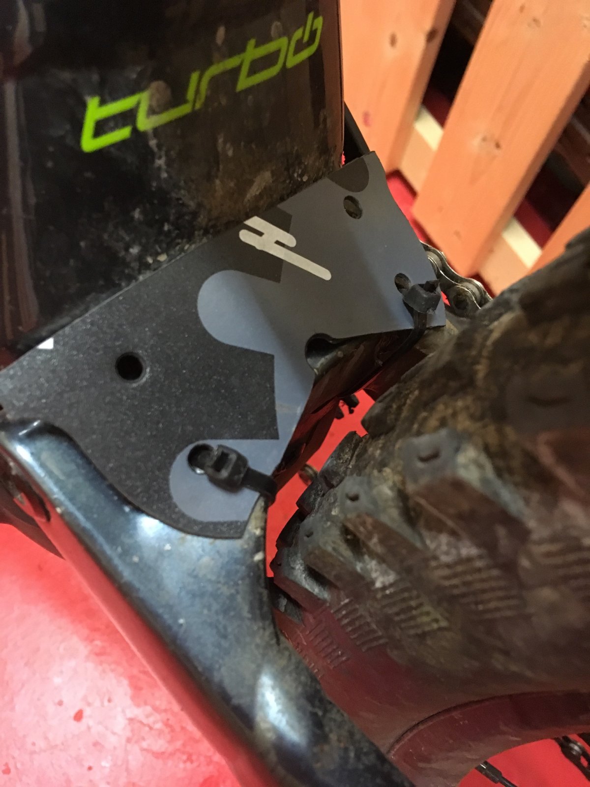

So I tried some homemade fenders and ended up using a piece of duct tape across the gap as the best solution. Anything else either caused tire clearance problems or still allowed pebbles to get in between the frame and the rear end.
My bodge job. Should keep most of it out... had to put tape underneath the casing aswell as that seems to have separated slightly
