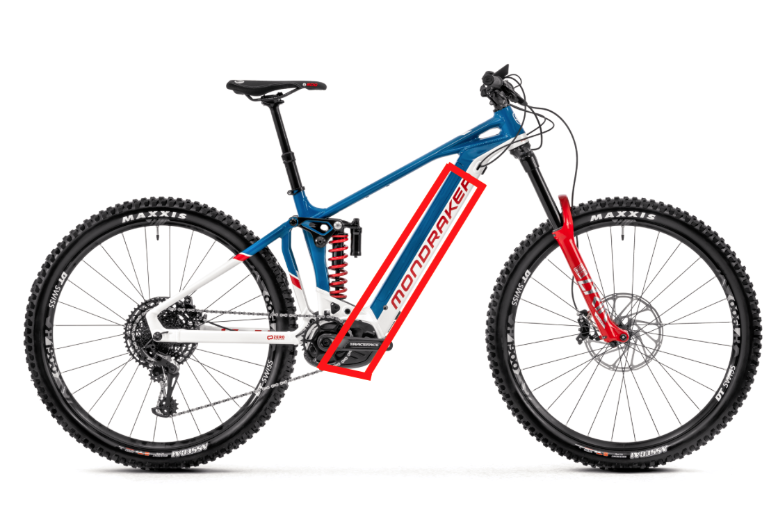

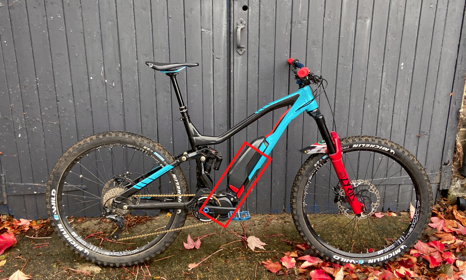

Regardless of overall weight, weight placement is the most critical element of EMTB design, as this is what effects the riding characteristics, the suspensions performance, and handling of the bike.
Too many EMTB's have sacrificed this at the alter of designers trying to make the bikes look like normal bikes, which is a waste of time IMO as no EMTB looks anything like a normal bike.
Putting a load of weight further up the down tube is about the most stupid thing you can do on any bike, it makes it harder to pop up, flop into turns, and makes the front suspension behave like it shouldn't, particularly in terms of diving into the mid stroke too quickly.
In many frame designs, it also means the head tube grows to accommodate the fisted downtube, meaning compromises have to be made that knock on to other areas of frame design.Look at the new Meridas for example, and how high the top of the head tube is as a result of the frame design, meaning its harder to weight the front end when riding.
In an ideal world you want all the weight on the bike as low down and centralised as possible, and that includes the suspension components.
On my E-Sommett for example all the weight is below the half way point of the downtube, which is one of the main reasons it rides so well, whereas take the Mondraker Level for example, and see where the weight is.
Only Specilized and Whyte have really though about this with integrated batteries, but tilting the motors and allowing the bottom of the batteries to sit in front of the motors and as low as possible, but even then due to the extra length of the batteries compared to the external ones the weight still sits higher up than ideal.
All I care about is how the bike rides, not how it looks, seems silly to spend 5k on something that is better to look at than ride to me.
9,185
I agree, its not about handling like a normal bike, they won't, its about having a good handling EMTB, and as lots of us have found the extra weight (within reason) isn't necessarily a bad thing if its been though about in the design process as to be made use of rather than to be mitigated.
Whyte are the best example of going with the weight and making use of it in a beneficial way that I have tried of the latest crop of bikes

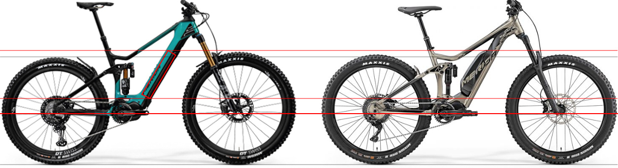

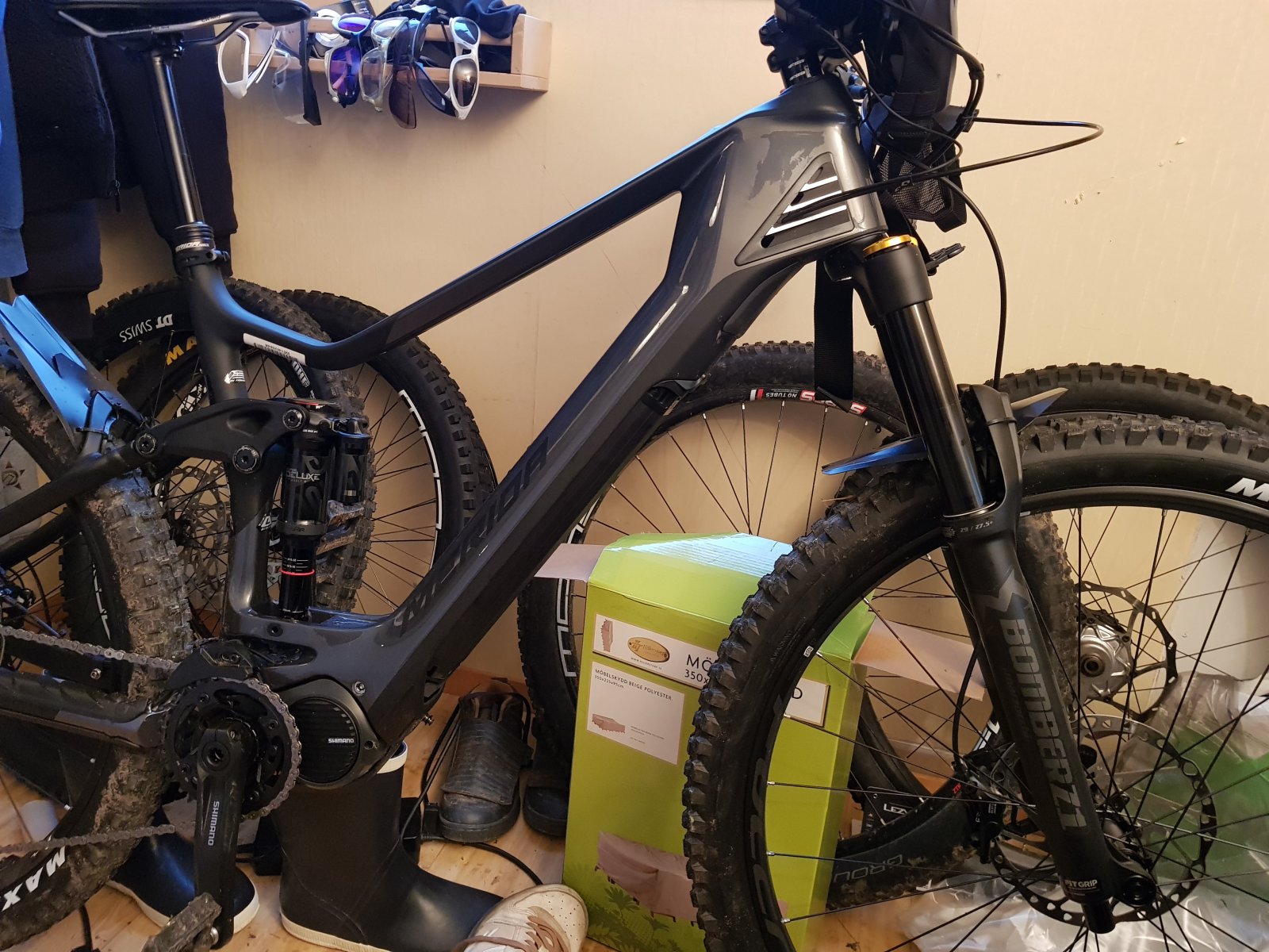

Here's a comparison between Shimano 500Wh integrated vs external. It's not much of a difference in how high the weight is sitting. The internal design doesn't look any worse.
Regarding the tall front end. I too assumed it was taller than ideal and it was a result of a compromise. But I'm not so sure any more, it seems there is room for a ower front end on the frame. The guys developing the bike at Merida said they wanted the front end tall to make it better suited for descending, making it easier lifting the front wheel on the descents. Fabien Barell has said in an EMBN episode that he is lifting the handlebars on his Spectral:eek:n to make it a better descender.
Having ridden the new eOne-Sixty on familiar trails, I believe they're right. I noticed the tall front end at the release event, but not any more. I guess it was down to fork tuning and the really loose trail surface.

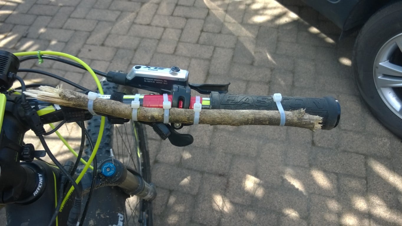

On a similar ride I crashed hard breaking my bars - was able to ride 60km with the broken bars to finish the ride.

That handle bar repair job is awesome!
