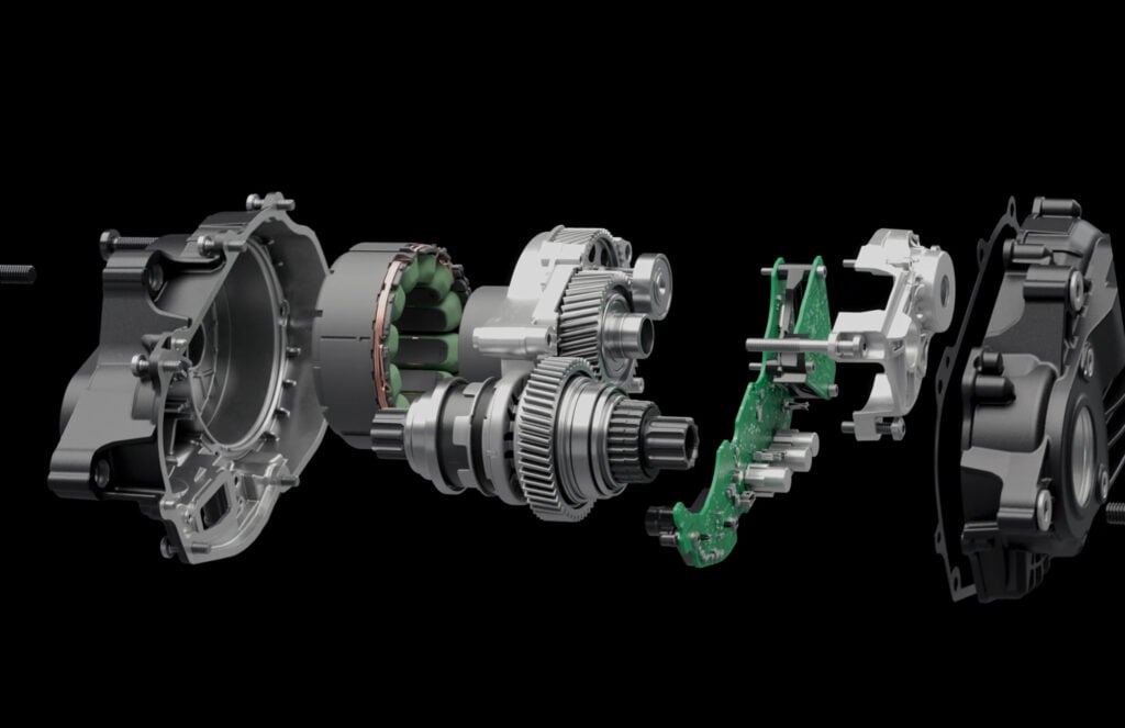

Thanks Rob, it perfectly adds up to my theory and makes sense as the small straight cut gear is directly connected to the planet carrier that then also moves the planets back and forth meshing the smaller metallic gears inside the ring gear.
One question as you have seen the internals, I would assume metal gearing parts on the planets and ring gear are also straight cut(not realy clear from pics and video) that would also suggest to increased possiblity of rattle.
Possible solutions:
1. Full polymer planet gears or a polymer ring gear, so the meshing would be polymer on metal, although it would most probably affect durability and longevity of the motor.

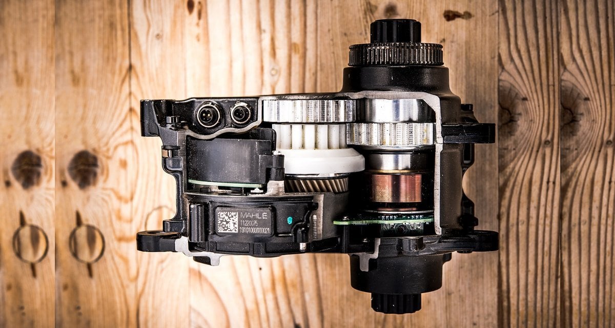

If you look at the pics of the Mahle M40 motor I posted in a previous post I mentioned that it's design seems similar to the Avinox also using a planetary reduction gearset although the difference being on the Mahle it seems like the whole planetary reduction gearset is polymer based that should drastically reduce rattling sounds.

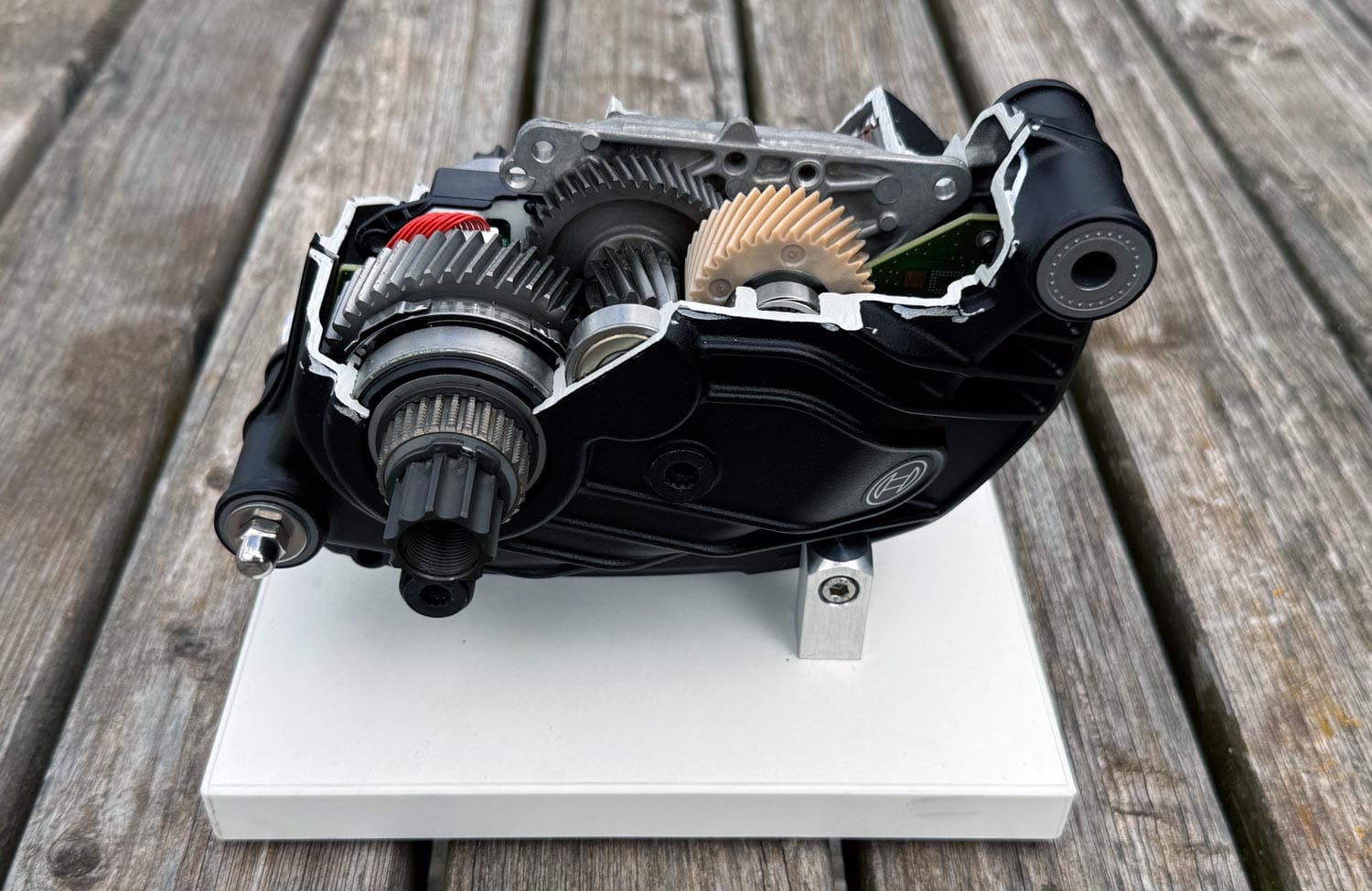

3. Decoupling the internal drivetrain from the external the way Bosch did it, I wonder what kind of mechanical part exactly they used for this, does it have a patent on it, maybe someone with extensive knowledge can elaborate furthermore.

The new Bosch CX Gen5 is one of those with an additional solution of decoupling the external and internal systems on the crankshaft. Probably the most silent near fullpower motor out there.

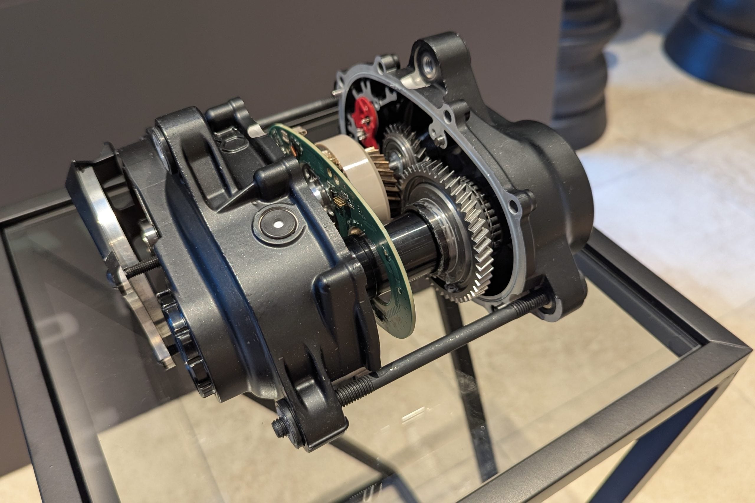

The new Specialized 3.1 motor also uses helical gears, although it did have some slight gear backlash when I tried a cut open model at the Riva del Garda festival.
The case of your SL 1.2 motor is interesting, as it does have mostlt straight cut gears that isn't ideal for gear backlash, although the way they mesh is that there is always a metal gear meshing with a polymer gear, or a polymer on polymer, so even if there is gear backlash happening it does not produce the metal on metal sound. The use of polymer gears here is possible due to lower torque figures so less strain on gear teeth.
As the SL is made by Mahle I would place my bet on the new Mahle M40 motor also, looking at the first pics of the internals it looks as a Dji similar design although with helical gears and a more polymer gears than the Avinox.
