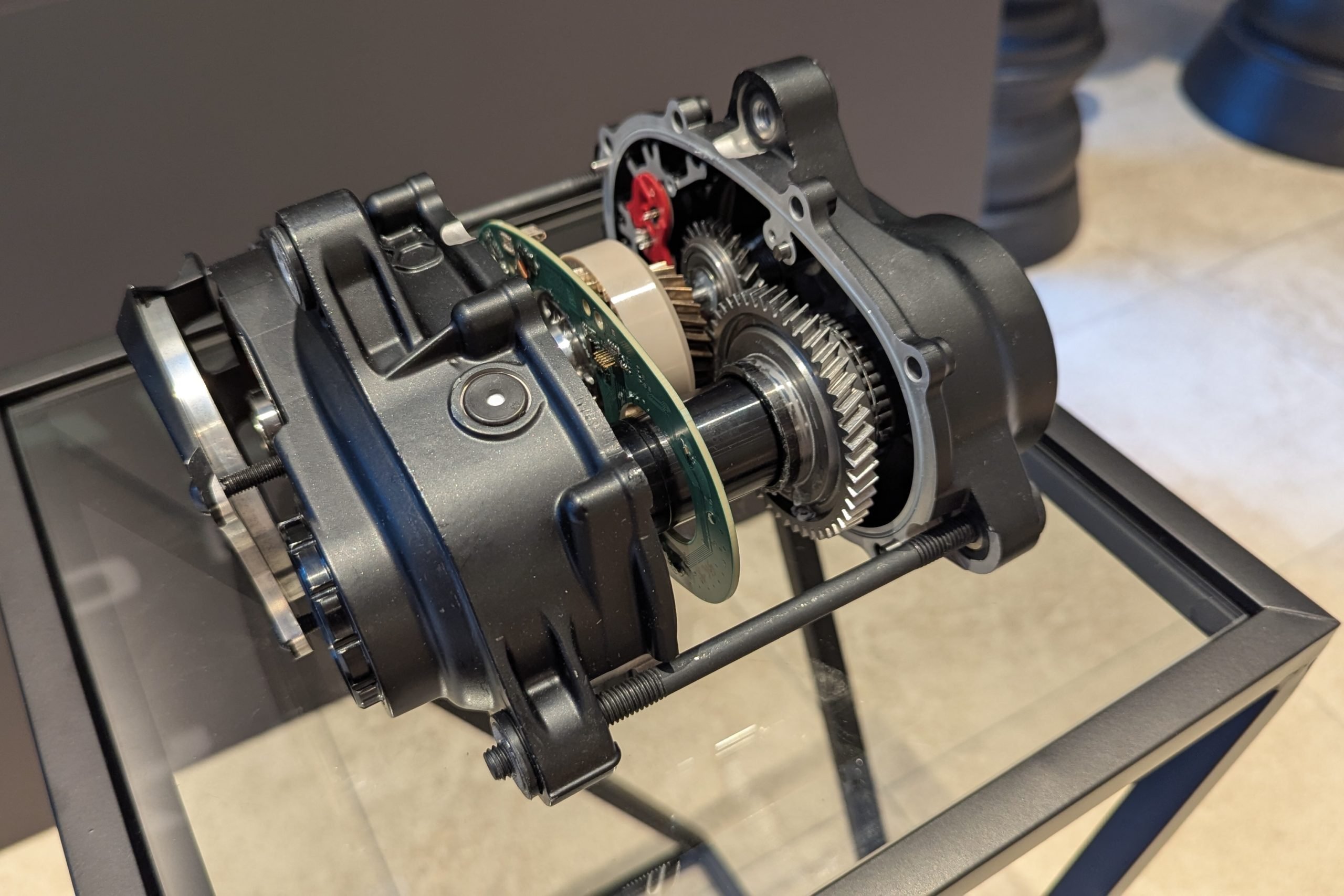

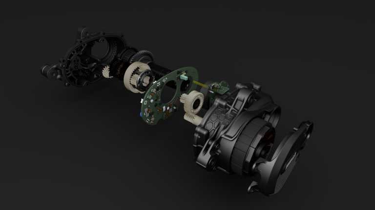

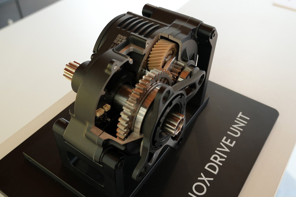

The Avinox motor has two main straight cut gears, one bigger on the drive shaft that also houses the steeples clutch and a smaller that is then connected to the planetary reduction gearset which uses polymer helical sun gears for noise reduction and better load distribution.
As you can see in the picture here the 2 main metal straight cut geras, IMO these two are most probably the ones creating the rattle due to the factors already described in my previous posts. One factor that I didn't mention also is the steeples clutch mechanism, this type of clutch has nearly instant engagement, which is good in technical terrain climbing where you need that for better over obstacles control.
Although that instant engagement can also bee a downside when going downhill as every single thug and pull on the chainring either by pedals or chain pulling due to suspension working also pulls on the clutch that engages the two main straight cut gears as they are loose when going downhill.

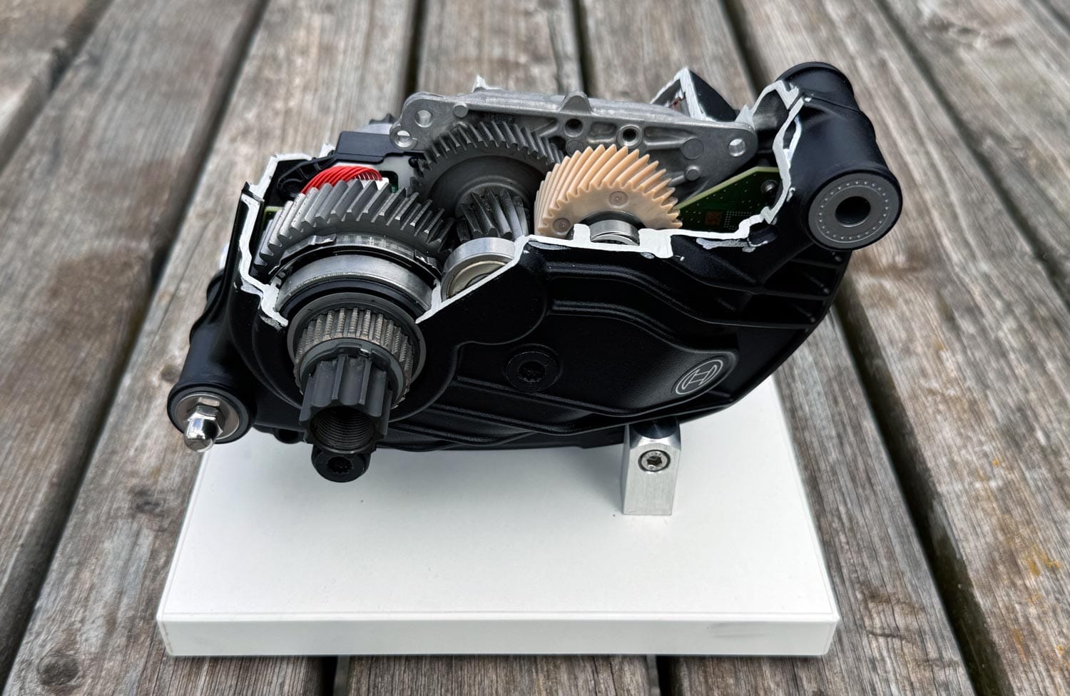

To anwser the second part of your question, you are probably good off with motors that have predominantly helical gears.

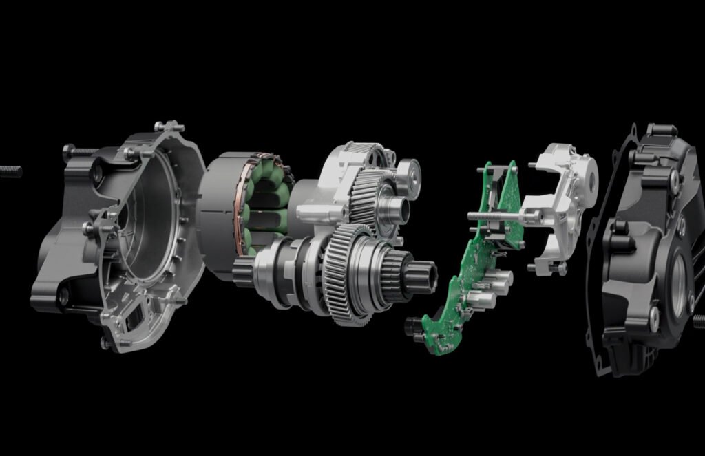

The new Bosch CX Gen5 is one of those with an additional solution of decoupling the external and internal systems on the crankshaft. Probably the most silent full power motor out there.

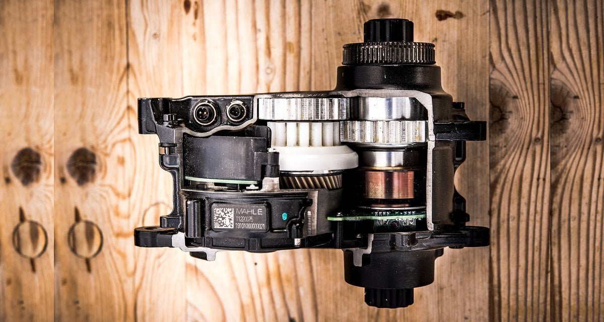

The case of your SL 1.2 motor is interesting, as it does have most straight cut gears that isn't ideal for gear backlash, although the way they mesh is that there is always a metal gear meshing with a polymer gear, or a polymer on polymer, so even if there is gear backlash happening it does not produce the metal on metal sound. The use of polymer gears here is possible due to lower torque figures so less strain on gear teeth.
aHR0cHM6Ly93d3cuZW10Yi1uZXdzLmRlL25ld3Mvd3AtY29udGVudC91cGxvYWRzLzIwMjEvMDUvc3BlY2lhbGl6ZWQtc2...jpg
As the SL is made by Mahle I would place my bet on the new Mahle M40 motor also, looking at the first pics of the internals it looks as a Dji similar design with a planetary reduction gearset although with helical gears and a more polymer gears than the Avinox.
