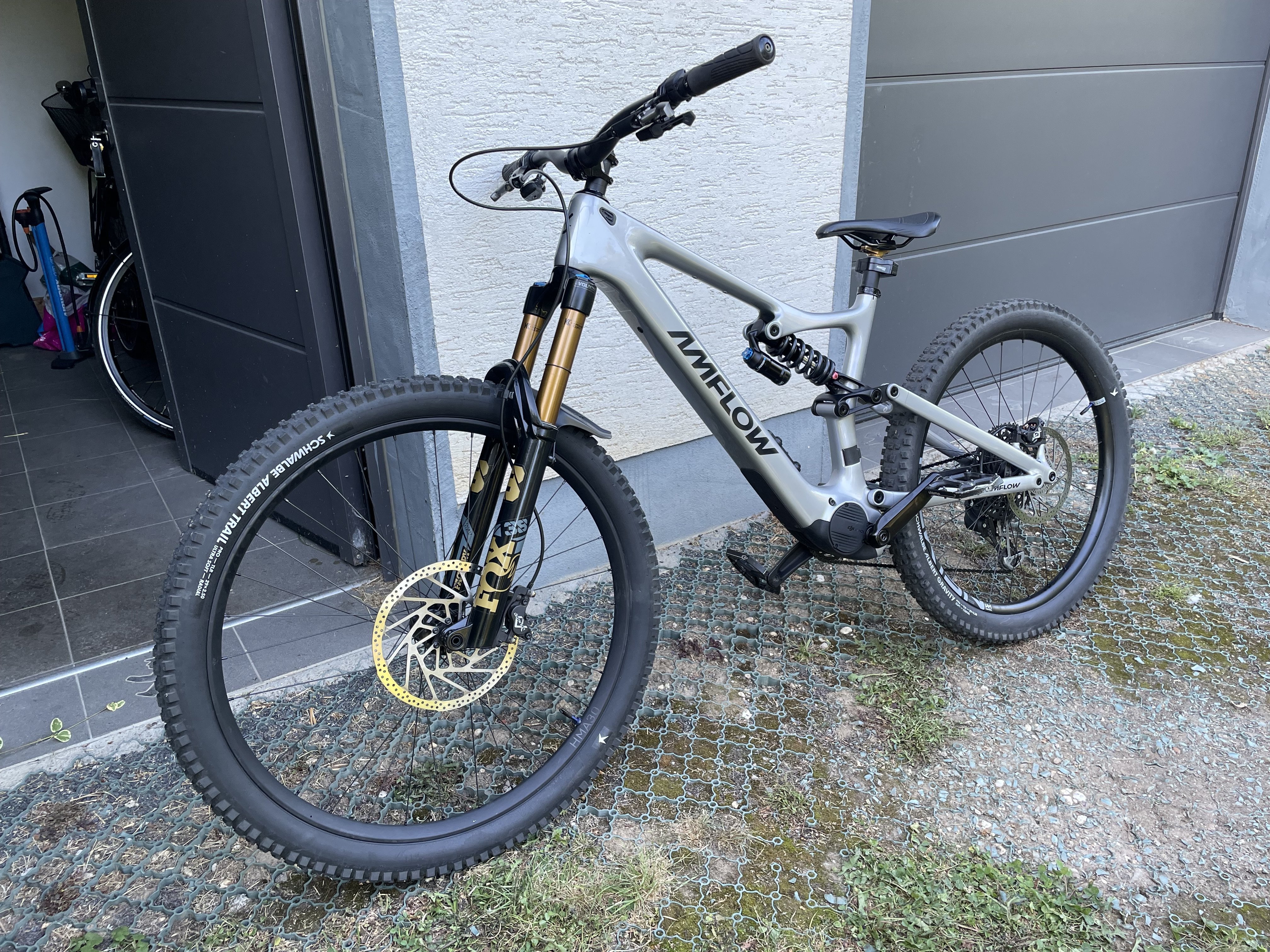

OT: Out of the box, the bike wasn’t really “enduro.” To change that, I slapped my Fox 38 (170mm) from my previous Canyon Spectral on it, along with a Suntour Voro Coil with a progressive spring (MBR 600–750 lbs, I’m ~88 kg with gear + motor + battery).
I also threw on a cheap Newmen 27.5 rear wheel with a silent Hydra hub, but left the flip chip in the “29” setting to slack it out even more. Paired with a higher-rise carbon OneUp bar, I now sit in the bike and can throw anything at it.
I also own a Canyon Sender, so I know what a confidence-inspiring bike feels like. A small part of the story here might also be the Albert radials, a minisuspension on its own. Hope that helps.
