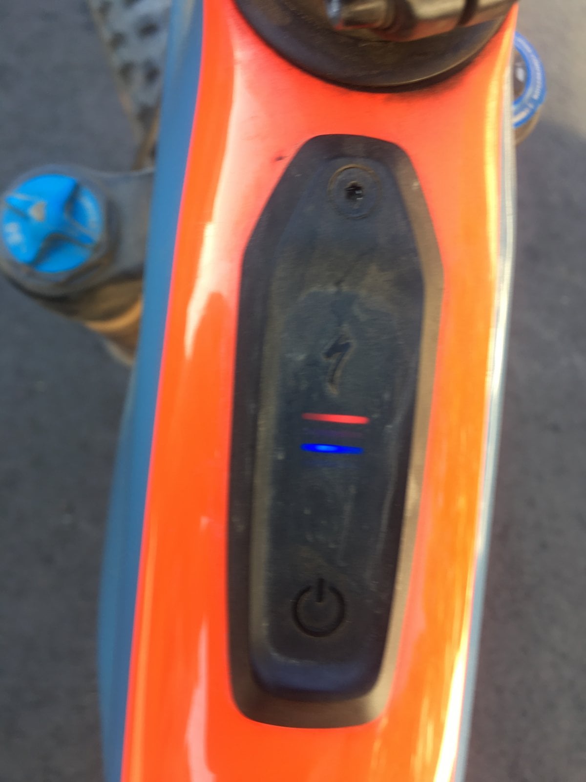

I recently had a failing motor warrantied (about 200 miles ago) and now have just started intermittently getting the "Motor Error" (see pic) on my '19 Levo during riding - the error will just pop-up and the assist cuts out & when I keep pedaling it will usually kick back in - I recall getting this error when I 1st got my bike and wanted to try a 27.5+ tire on the rear and didn't install the magnet so it seems logical that it has something to do with the sensor not picking up the magnet? This is also supported by the fact that it only seems to happen at slow speed / low cadence
I tried turning it off and on, checked Mission Control but says everything is fine (the manual recommends "rebooting" - I assume this is just turning off and on or is there more to it?) - I also tried cleaning off the sensor and magnet, but didn't fix it - I'm guessing a bad/weak connection of some sort? - before posting I did a search and found a thread where @All Mountain Coaching had this problem and @Specialized Rider Care apparently helped him fix it but I couldn't find out exactly what was done from the thread - hoping it is a simple fix I can do rather than having to wait weeks for the shop to fix it.
Any ideas or help is appreciated!

that error code is "motor not found" so more likely a bad motor to battery connection......and more likely to appear if intermittent when current is low. Factory reset via the TCU is on page 11 of the manual.
Thanks for the response - according to my user manual, the error code is "Motor Error" - the "Motor Not Found" is listed as when the red light and blue light directly below it light up with no space - the error code I am getting has one space

Ah...I could not see that on the photo. Could well be the speed sensor then since it will cut motor power if it reads zero (or max assist speed).

I got this error recently and it was a magnet alignment issue on the rear wheel.
As an FYI a reboot is turning the bike on then immediately holding down the mode button for 15 seconds. This will do a complete reboot including installing new firmware if it is downloaded.

I realized that I never reported back what the solution to my issue was. It turned out the cable that connect the sensor to the motor was faulty - replaced it and have not received the error since

Update: speed sensor & cable replaced. Continue to get same error as yours. Shop has checked all connections or replaced all motor to battery related cables & connections along with software updates to batteries & TCU. Been in shop 4 times still not fixed. This particular error code info is way too vague to tell any one anything of value.

The main brain of the Levo and the item most likely to get damaged is the TCU. With everything lese that has been checked or replaced I would think trying another TCU would be in order.
