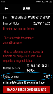

I highly recommend using version 2.2.0 Build 50 of Mission Control. This declares the number of the error that is occurring (at the moment it is of little use until information is obtained about the correspondence of the error number with its description).
Does anyone know if the soft they use in the dealerships (Turbo Studio) gives them this correspondence between the error number and its description?
Or are they just as lost as other mortals, substituting parts blindly?
