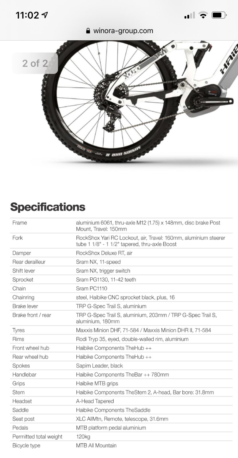

Hi all! Been getting more miles on my Rail 7 and really enjoying it! I “upgraded” from a Haibike xduro that was honestly very similar but had the older Bosch motor and I wanted more power and better clearance from the trek. I hit too many rocks and my wife was kicking my butt up hills lol.

Im thinking it might have to do with the difference in tires-the Haibike was a 27.5 x 2.8 60 tpi with tubes. This is (obviously) 29x 2.6 120 tpi tubeless

hi! Thanks! I’ll research changing the damper. Is it tough to do yourself? Do you mind sharing the cost? Is the wiper part of the same change?
What’s strange to me is that my old Haibike has the same front fork and rear combination. I’ll attach the specs. Why would it be the suspension that’s causing the different feeling if they are the same?

Awesome. I will check out your post and your point makes a lot of sense about the difference in suspension due to geometry changes.
What is news to me is the change in the Yari from the 2020 to the 2021 model. I knew they looked different (the stickers are all black on my new one and were white on the old one). I'm curious why they changed if the new version isn't as compliant on small bumps. That could be exactly the issue I'm experiencing.
If that is the case, what do you think the best option would be to improve the small bump performance? I certainly do not notice any issue on bigger drops, slower moves, etc. Just the rocks and gravel and stability at higher speed.

When I started upgrading my Rail 7 I was having trouble with my wrists & hands & was keen to get better small bump compliance (our local tracks are pretty raw & don't lend themselves to too much speed :-0 )
I started with better tyres- maxxis DHFs -run at lower pressures with cushcores in. That was good - the bontragers are very average compared in every way that's why our local for sale page has plenty taken off new bikes. I was running at around 18 PSI. In hindsight maybe DD tyres without the cushcores would have been cheaper but we'll get to that later.
I then upgraded the airspring to gain the extra 6-10mms of travel Gary was mentioning. - Mmmmm cheap enough - $50 or so- ok it did sit higher but actually maybe more of a PITA for tight cornering while climbing - not that noticeable on the downhills to me.
Bit the bullet & got the RC2 damper for around $650NZ ($480US ish) as well as the SKF seals to bring the yaris up to Lyrik ultimate spec. The damper change over is easy if you follow the various youtube vids. Note the new damper has the oil contained within it - the old motion control (moco) has the oil seperate & will spray out all over your clothes & garage when you take out the lowers if you aren't aware of it. I got the local bike shop to seat the wiper seals as you really need the appropriate tool- cheap easy job for them. Well don't start me raving about how good they feel again :) It was at this point I realised this should have been my starting point as the small bumps disappeared & the control over rough ground was amazing. However they soon showed up the rear end was definitely lacking in comparison.
I bought a JadeX rear coil after a rocky start with it, the rear end now keeps up with the forks. I feel far more stable, faster & in control with the bike even though I thought it was bloody good to begin with.
I'd recommend you run your local trail on a friends bike with a good fork & shock see if that makes a difference.

Is this the right one? I see ones that are $250 that seem like the same and then this one:

Set up the fork you have properly first.
Why have you suddenly jumped to the conclusion it's your damper at fault?
I have 2 lyriks but have ridden Yari's on other bikes on big local rides with long rough EWS Enduro stages and even with their more basic damper the Yari's were fine.
Hi Gary,
I did read the full PDF and watched the two videos you had posted. Everything mentioned there has been done correctly, just as I had previously done on the Haibike. All of that information was really applicable to all full suspension bikes and I had done it previously. It is always great to learn as much as possible. Thank you for pointing me towards those resources.
EDIT- Also, as you mention, the setup is fine. I'm not trying to imply it is "broken"- It simply isn't as planted and stable feeling as my last bike which had, though a year older version, the same shock and fork. This was really me trying to understand why it would be that way and what steps I could take to enhance the ride quality to match what I had experienced on that. Thanks again!
I wasn't implying his (or my damper) was at fault. I also thought the yaris were good until I upgraded. I spent a lot of time setting mine up with the basic adjustments there were to get it as best I could. I even used a shockwiz that told me it though the yari was fine except for a bit of HSC. My point was really to try the same tracks on a Rail with better suspension before spending money on anything else like cushcores really to see if there is much difference.
I guess I've kind of veered off from the original query why the bikes felt different though & that I find interesting. I would have assumed the Rail would be all over the Haibike as it has won many shootouts & comparisons due to its downhill performance. I find the Rail incredibly nimble in tight stuff & stable downhill so I'm wondering if the Haibike was maybe just a bit sluggish?
Yes I got that one because it has low & high speed compression adjustment. You may not require the HSC but it gives you more tunability
Awesome. Thanks, Doug! I’ll ride a couple more months before going this way but it’s good to know what options there are. The cushcores seemed like a cheaper way to add some small bump compliance but maybe it’s better to just wait and go this route.
