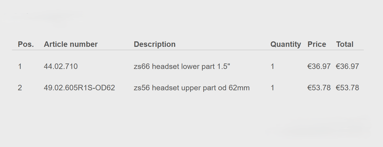

I’m a bit confused about factory data’s and your experience: they do specify numbers from 52 to 62 or 52 to 66. Since I will defo upgrade this critical component, I wanna make sure with you guys what do I need to order prior to receiving the frame!
The confusion comes from measuring the bearing size or the inside diameter of the headtubes.
The correct size is ZS56/ZS66 using the standard industry nomenclature.
The correct information is in the specifications thread.
These (both top and bottom) are exactly what I ordered last summer for my CEF50 and they work perfectly though I did gently tap out the stock bottom bearing cup to use the one that came from Acros. The nomenclature is confusing.
