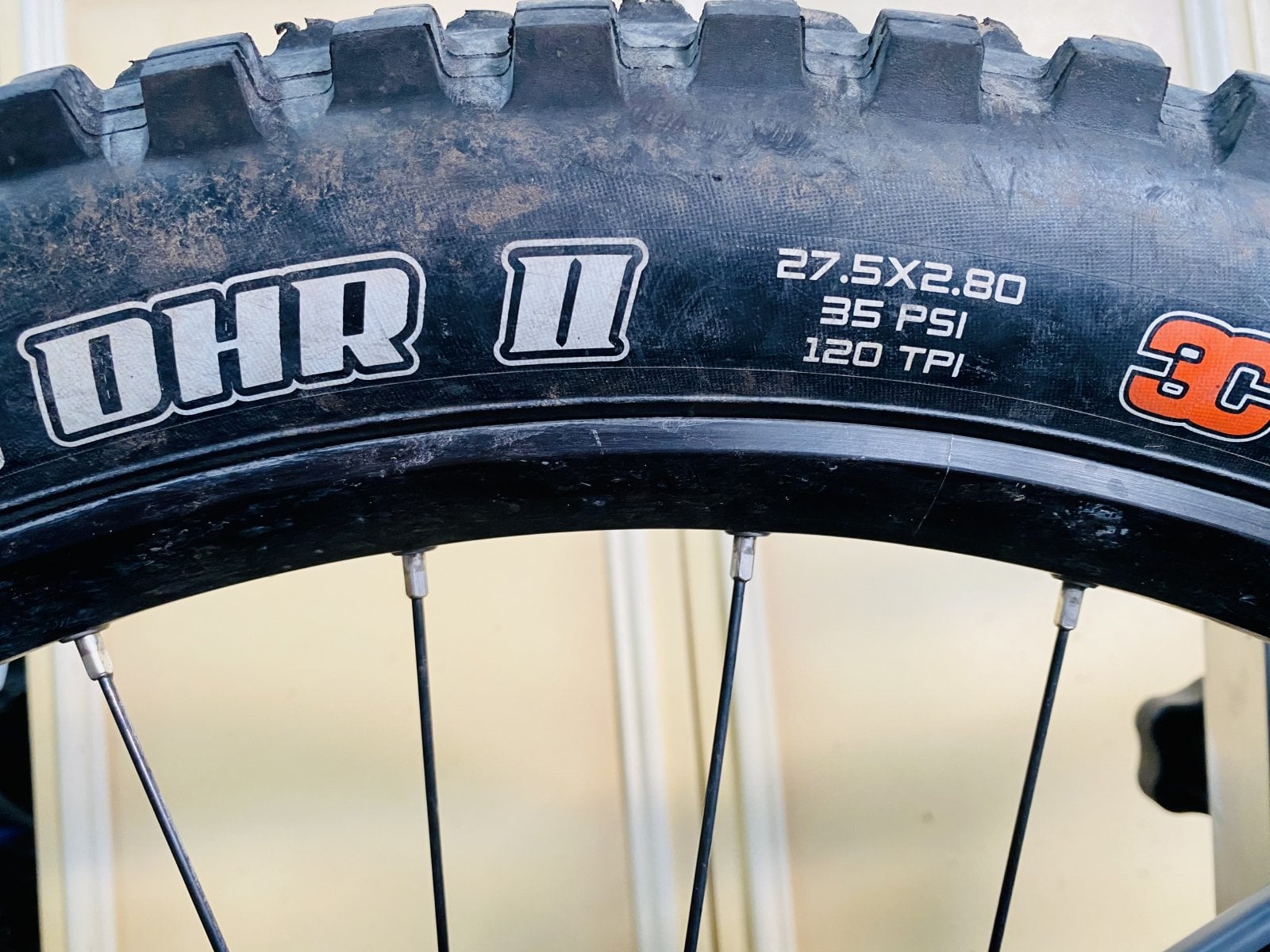

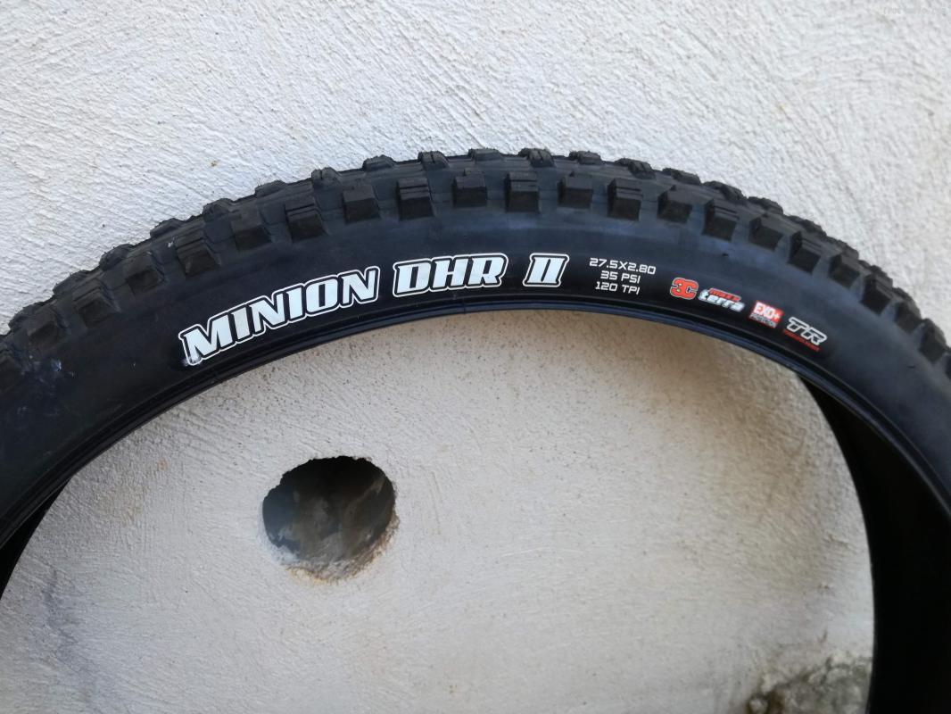

Thought this was strange so I had a look at the 2.8 DHRII hanging on my garage wall. At 40 psi you have a chance of blowing the tyre and hurting yourself as it's actually rated at 17-35 psi. The 35 near the logo printed is the MAXIMUM. The range is stamped into the rubber in small font on each side.

I’ll put my hand up if I’m wrong, but I’m sure my 27.5 x 2.8 Exo DHR’s state 35-60 psi. I’ll check when I’m home later this evening / tomorrow morning

No modern tubeless ready mountain bike tyre has a MINIMUM of 35psi. Not a single one.

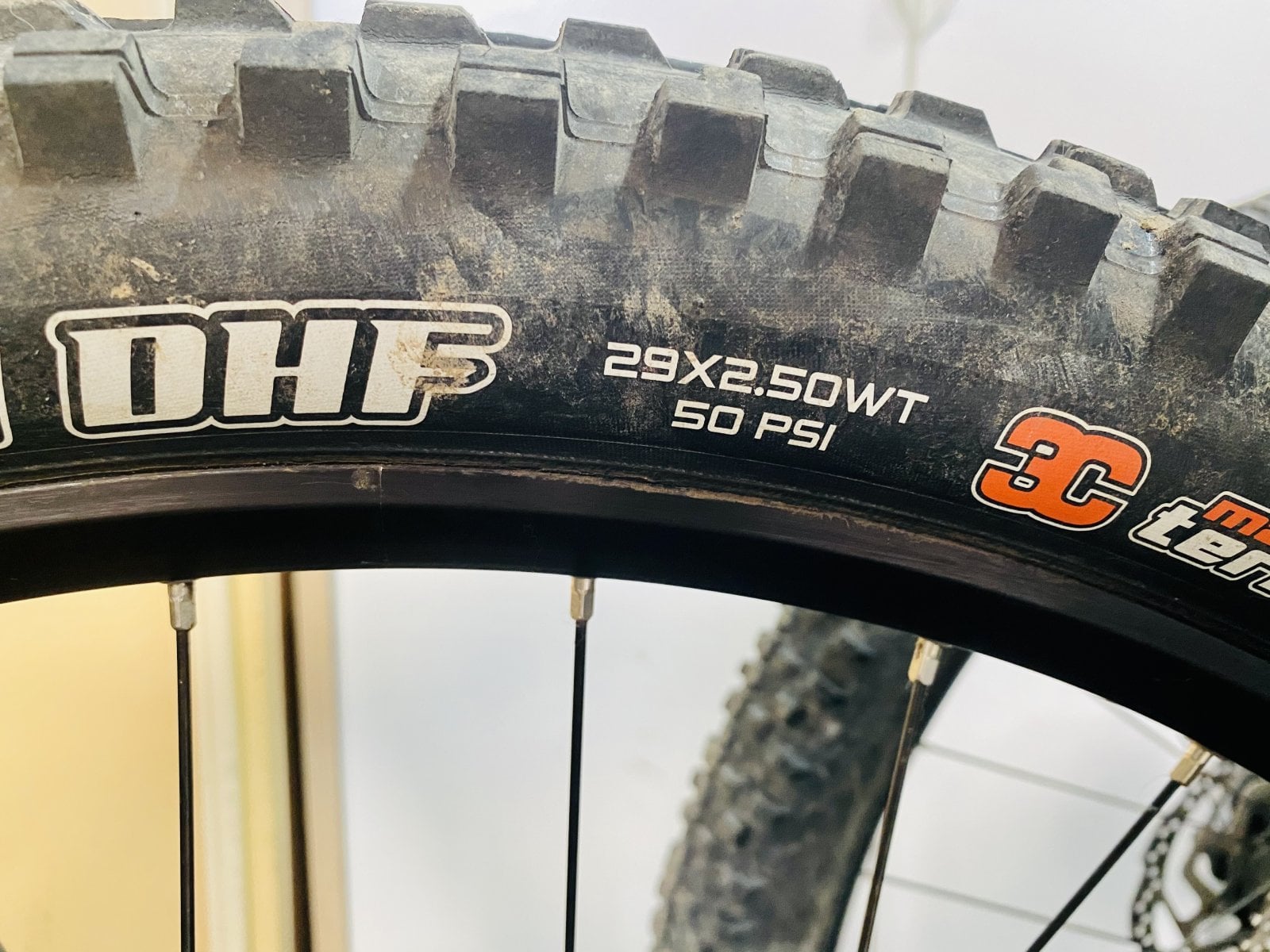

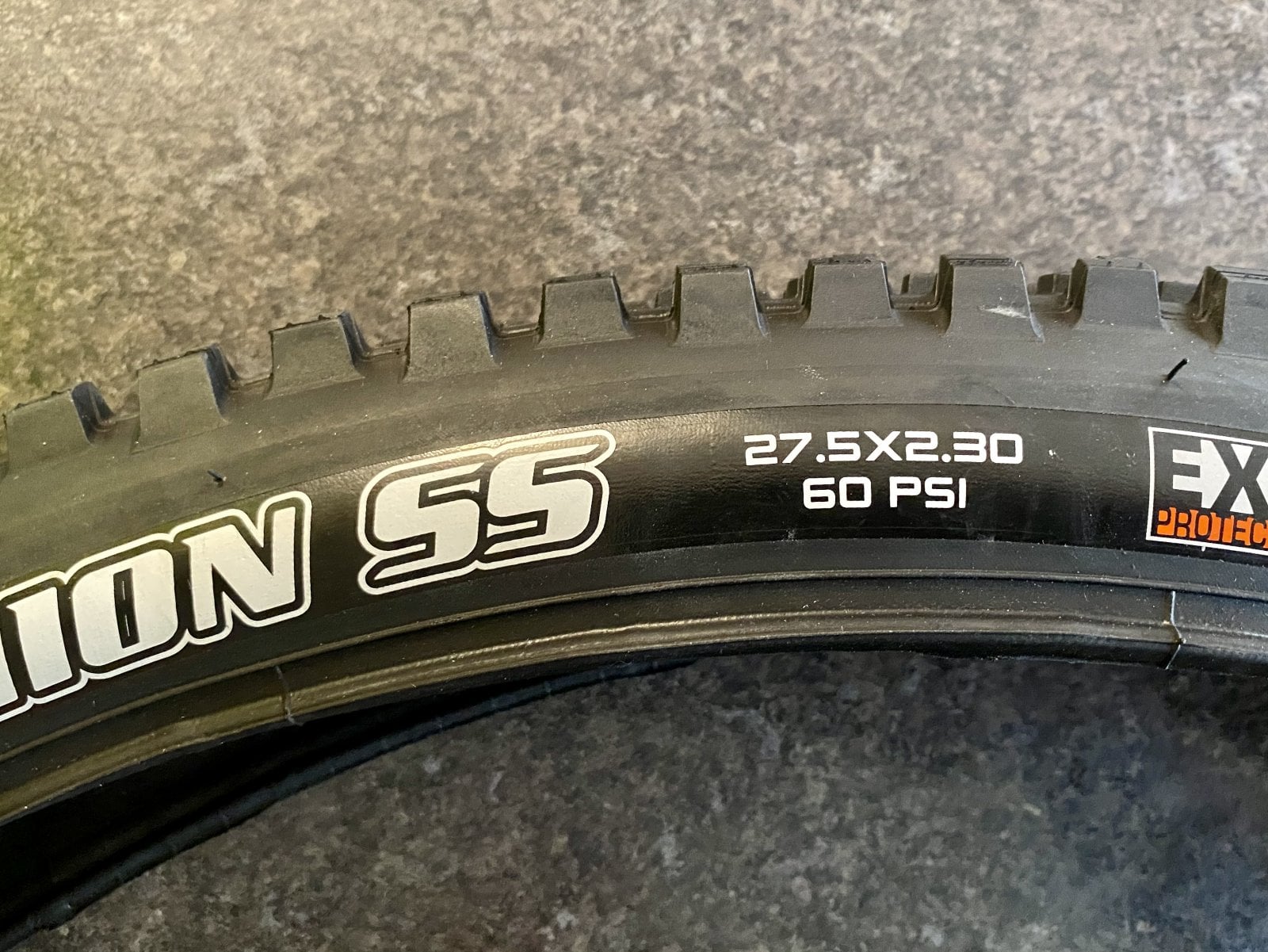

Well I said I’d put my hand up and admit the error of my ways once I’m home and checked my tyres. Yes 35psi max on the DHR
it’s no wonder I’m confused though, the DHF is 50 psi, and the SS I’ve bought to replace the fat 2.8 is 60 psi
35 psi just sounds such low pressure. It’s my first 2.8 tyre and I’ll be whipping it off for a 2.3, and pumping up that one hard. In my mind the higher the psi the faster the tyre rolls, and speed is surely a priority over grip. No doubt someone will come along and tell me I’m completely wrong though!
