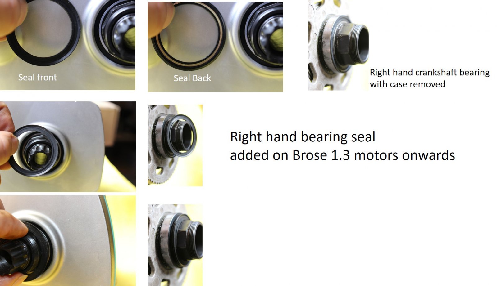

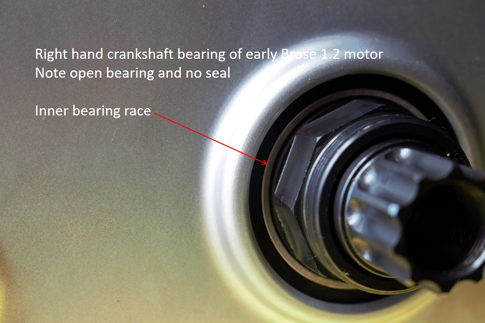

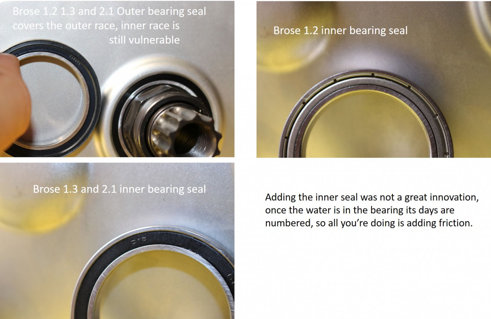

The Brose right hand crankshaft bearing cover seal was introduced on the 1.3, the earlier motors didn't have this part.
To be honest, this seal coupled with the internal seal upgrade work well, but like the Bosch motor, there is still no fix for the left-hand bearing.
Hopefully, like we have for the Bosch motors, we will make or come across a solution and implement it.

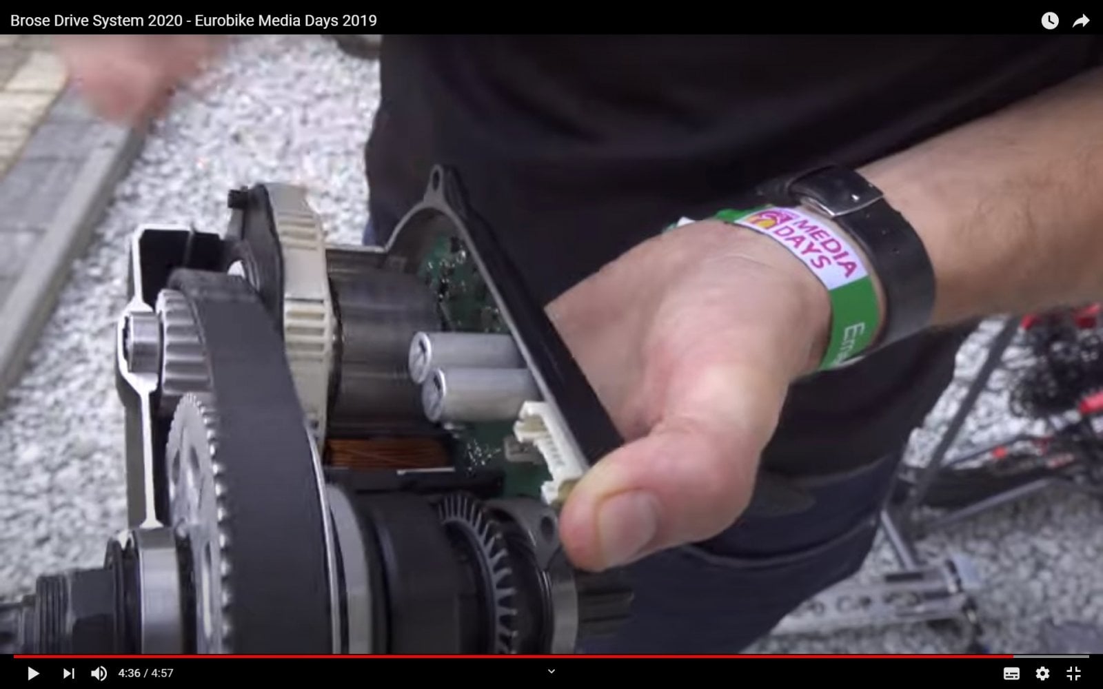

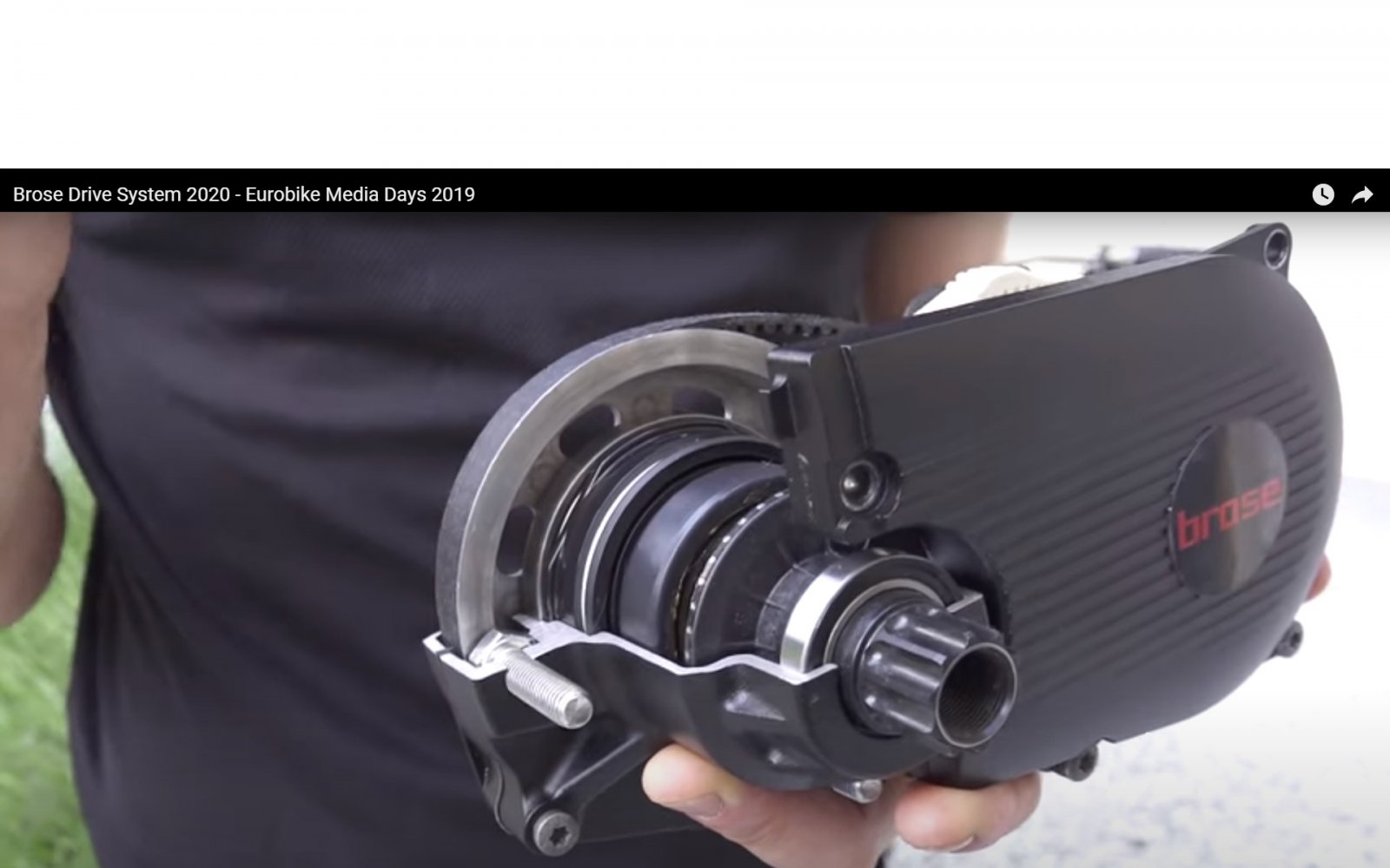

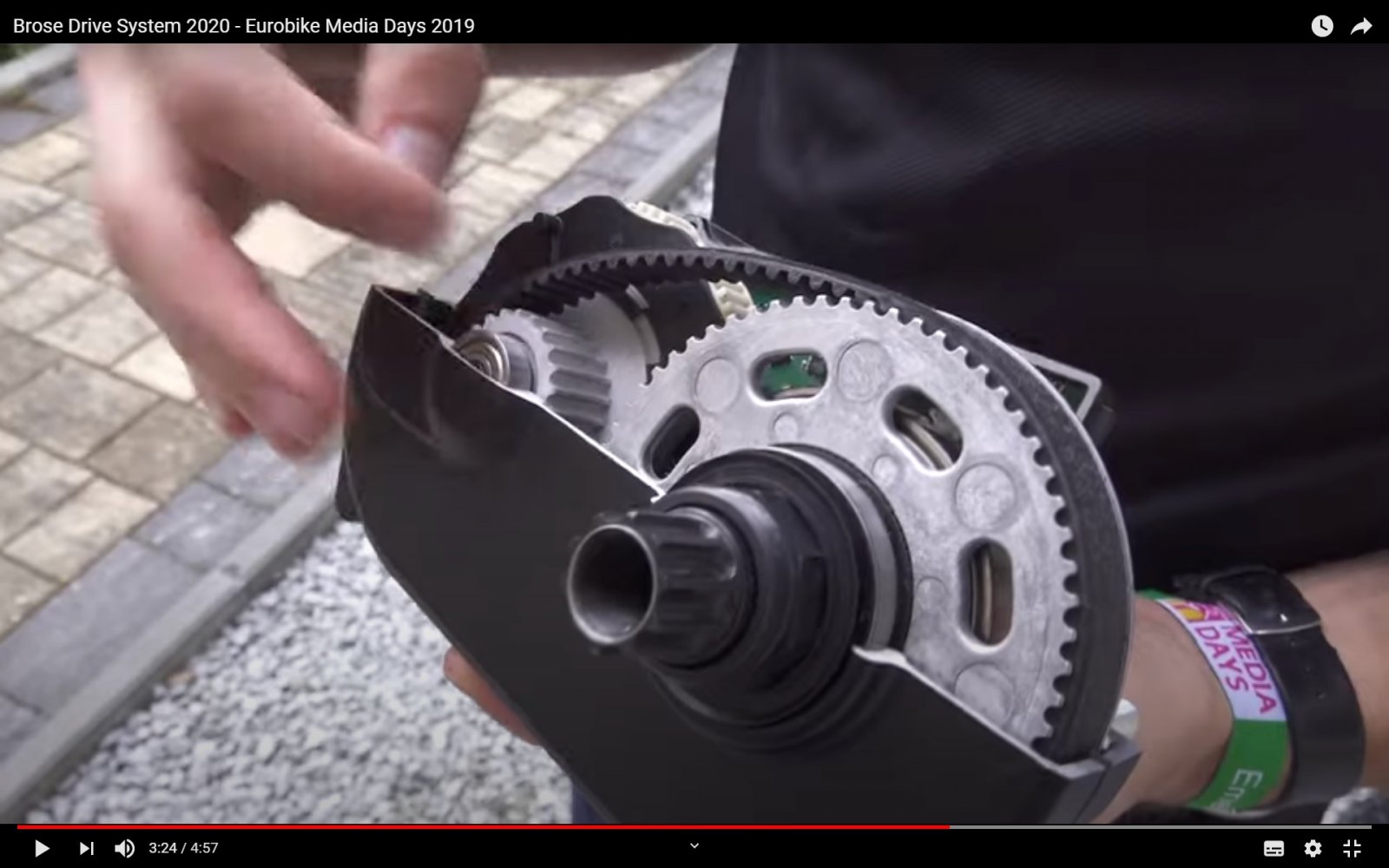

For anyone interested these are some pictures of a Brose S Mag motor which I assume is very similar to the 2.1 motor used in the Specialised. The rubber seal can be seen on the drive side although it's not clear from the photo how or whether it sits in the casing to effectively seal the gap between crankshaft and casing. The non-drive side is presumably just a normal RS bearing, as it is on other motors like Bosch and definitely a weak point eventually, even if not power washed

Sorry for the delay, we are still a bit busy at the moment. I did find a little time to take some pictures for you to help explain the progress so far.
