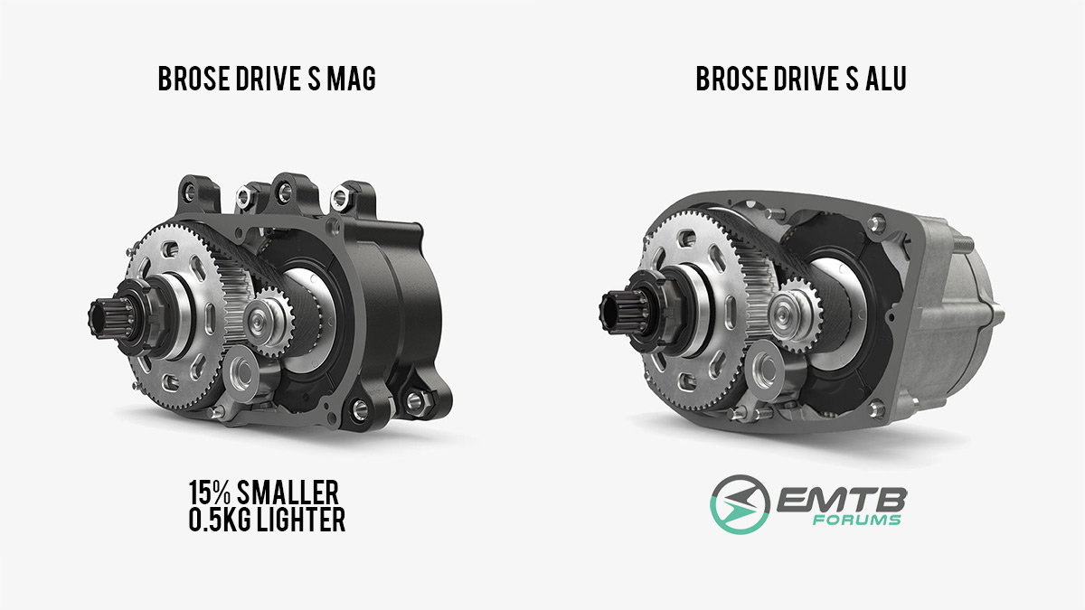

With all the motor warranty claims I have been reading about with the mag s brose could this be a cause of the smaller mag case? They basically took the same internals and put them in a case 15% smaller. If you pull up a side by side pic of the 1.3 vs 2.1 mag there seems to be far less clearance for the belt to the case. Could this cause the motors to be far more sensitive to belt tension etc?

With all the motor warranty claims I have been reading about with the mag s brose could this be a cause of the smaller mag case? They basically took the same internals and put them in a case 15% smaller. If you pull up a side by side pic of the 1.3 vs 2.1 mag there seems to be far less clearance for the belt to the case. Could this cause the motors to be far more sensitive to belt tension etc? View attachment 17862
If it is true (and we don’t know for sure yet) that reliability of the Brose S Mag is less compared to Brose S Alu then I guess it’s more related to the increased torque of the new motor rather than the housing.
There are movies of faulty motors where you clearly hear the belt slipping over the teeth of the internal drivetrain. Again all is speculation!
I must say too that in case we all get simular failures outside warranty Specialized should also react on that. Belt should be changed at 15.000km. If we all only reach 5.000km then I am almost sure Specialized will solve the issue. (warranty or not)
