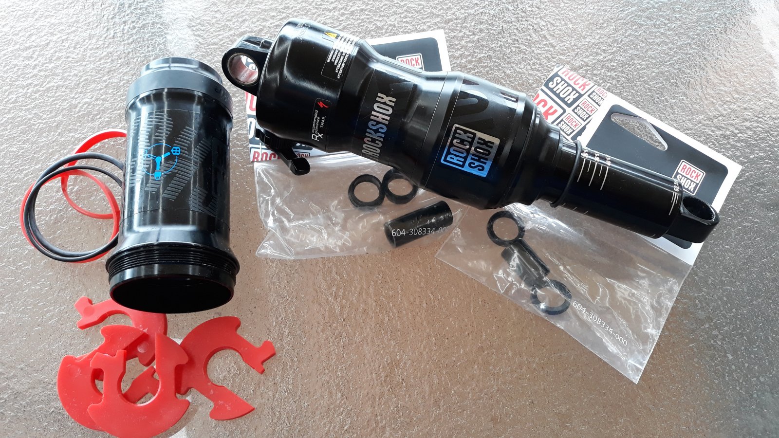

Mine came with the gnardog and 2 tokens and I was blowing through the travel, put a megneg air can on with the gnardog left in and 2 bands in the negative air problem solve plus a lot more adjustment to fiddle with.

Mine came with the gnardog and 2 tokens and I was blowing through the travel, put a megneg air can on with the gnardog left in and 2 bands in the negative air problem solve plus a lot more adjustment to fiddle with. View attachment 35018
Hi, how much do you weight?
I have ordered Levo 2021 (basic alu model) with Deluxe shock. I Weight 120 kg with gear, so I'm wondering if I can install MegNeg. It seems like I'll be around 260 PSI, so MegNeg will put me somewhere near PSI limit (325 PSI), and it's a bit scary )))
