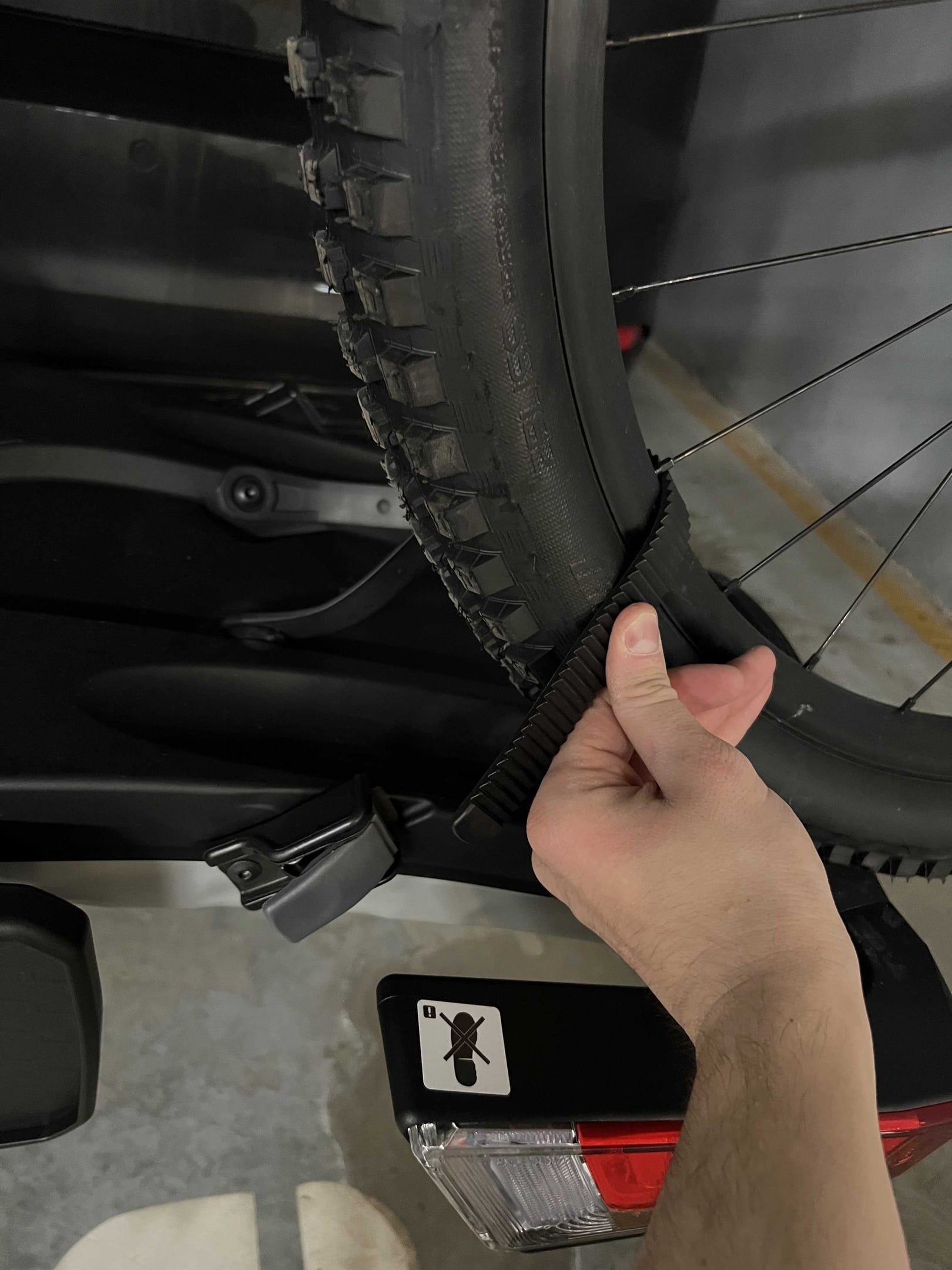

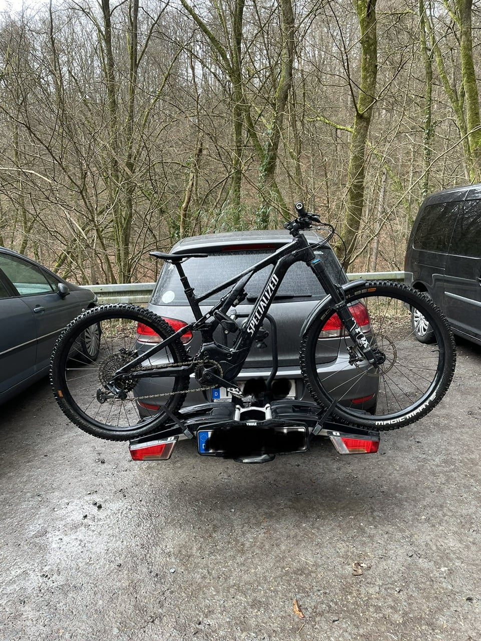

Hello ! I bought Thule Easyfold. I was happy until i tried to install my Turbo Levo 2022 on this bike rack... It is almost impossible. How you do it ?
I googled, then watched youtube videos and i put my Levo on the second place for second bike in Thule Easyfold6 but i cant fix my front wheel in straps... so help me please

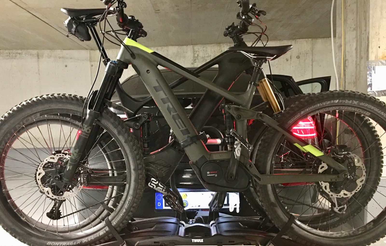

I have an older version of Thule EasyFold XT 2 with long straps and sadly it fits only one Levo ebike.
Perfect when I want to go biking alone.
However, if I need to take two Levo ebikes, I use another bike rack: Inter Pack Spider 2E.
Here's the comparison of those two bike racks:

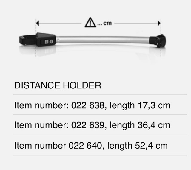

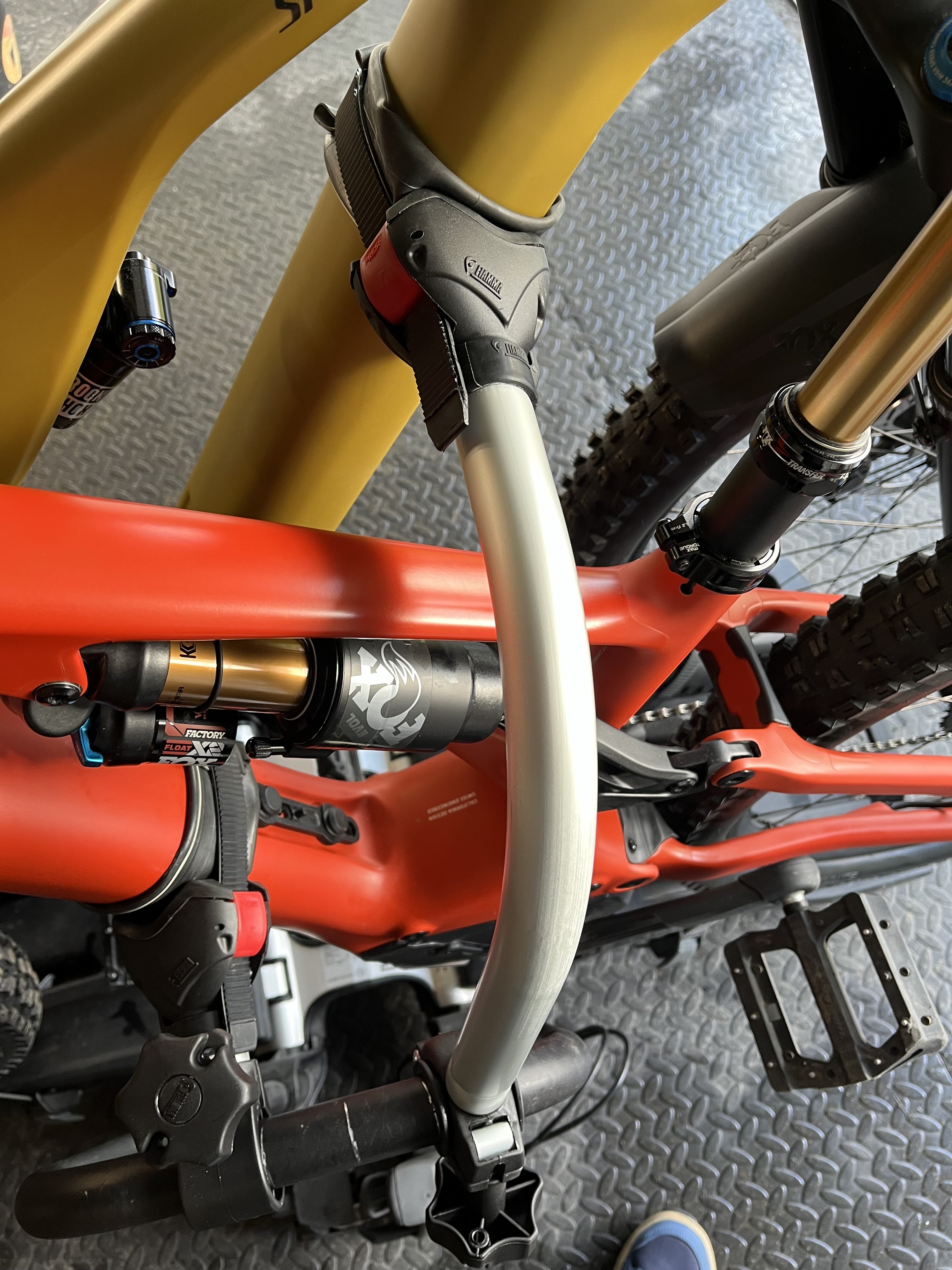

we use a Thule XT rack to carry two Spesh Carbon Levos.
Thule make a specific adjustable bar designed to be fitted between seatpost and headtube, to avoid clamping around carbon frames. Costs abt £25 on Amazon. Then also fit 2 pairs of thule long straps and everything is easy peasy - plus no risk of damage to carbon frames

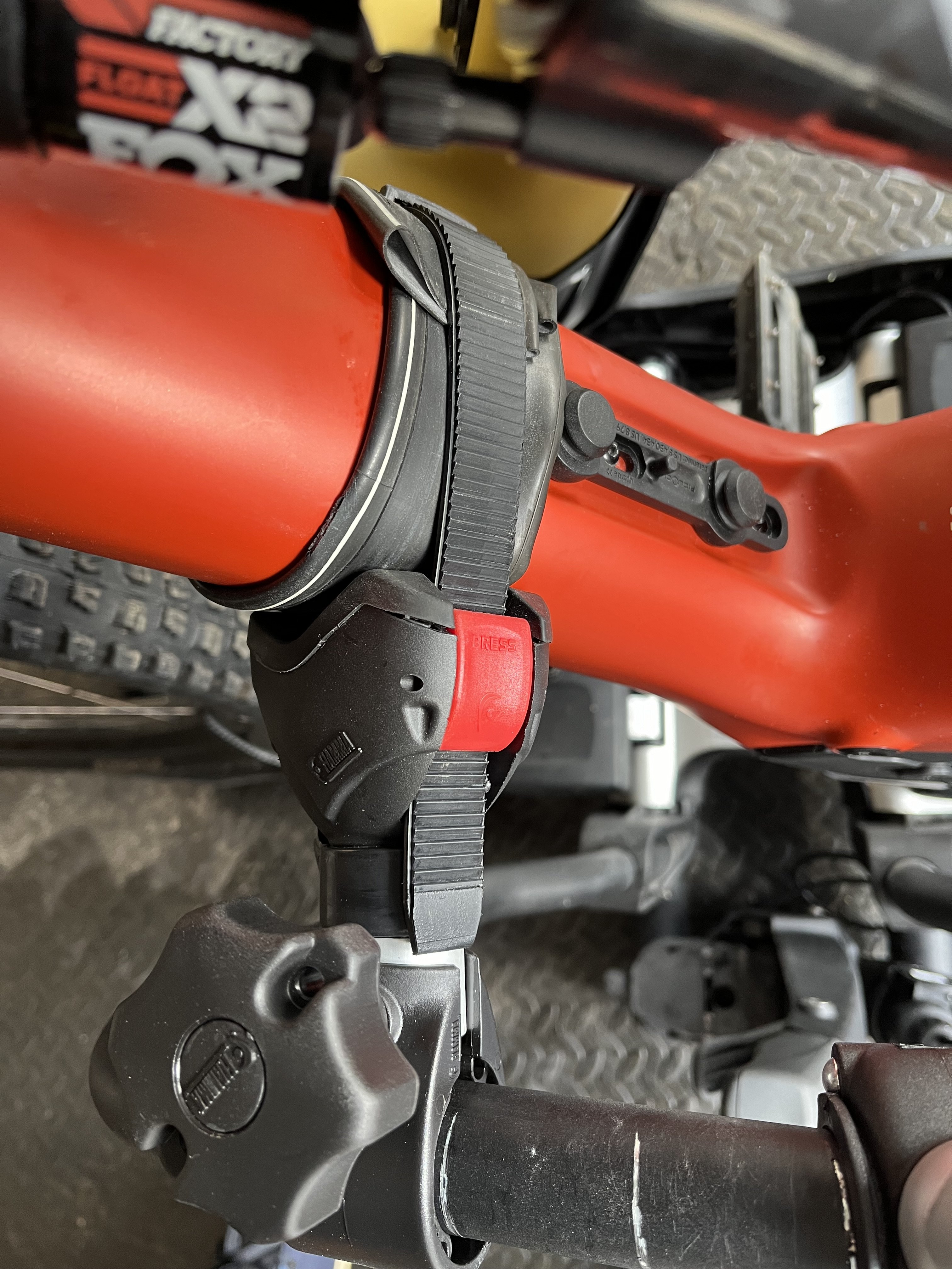

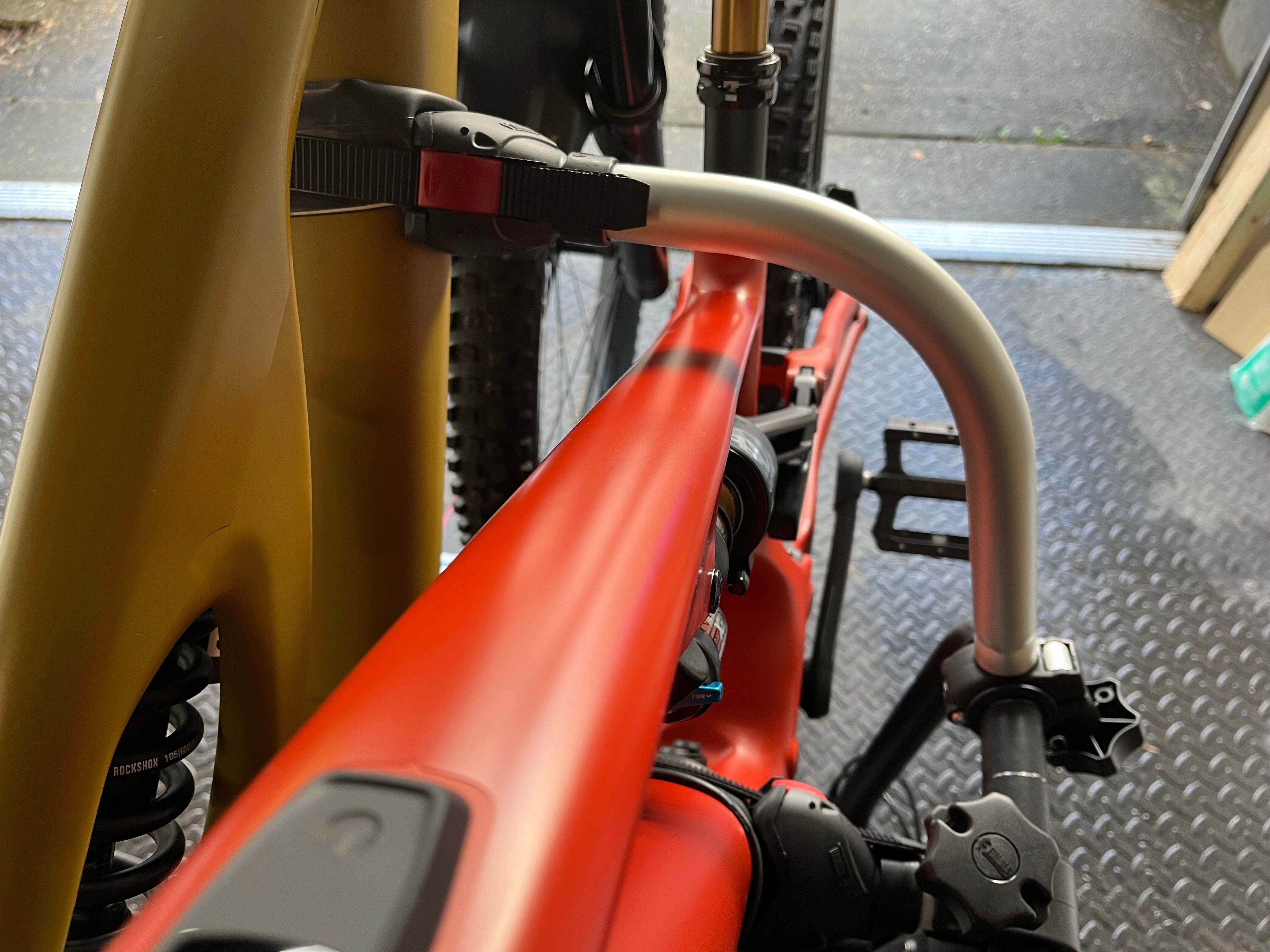

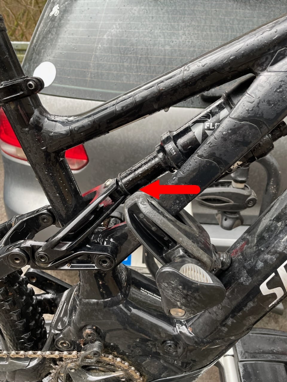

View attachment 108112 View attachment 108113 View attachment 108114

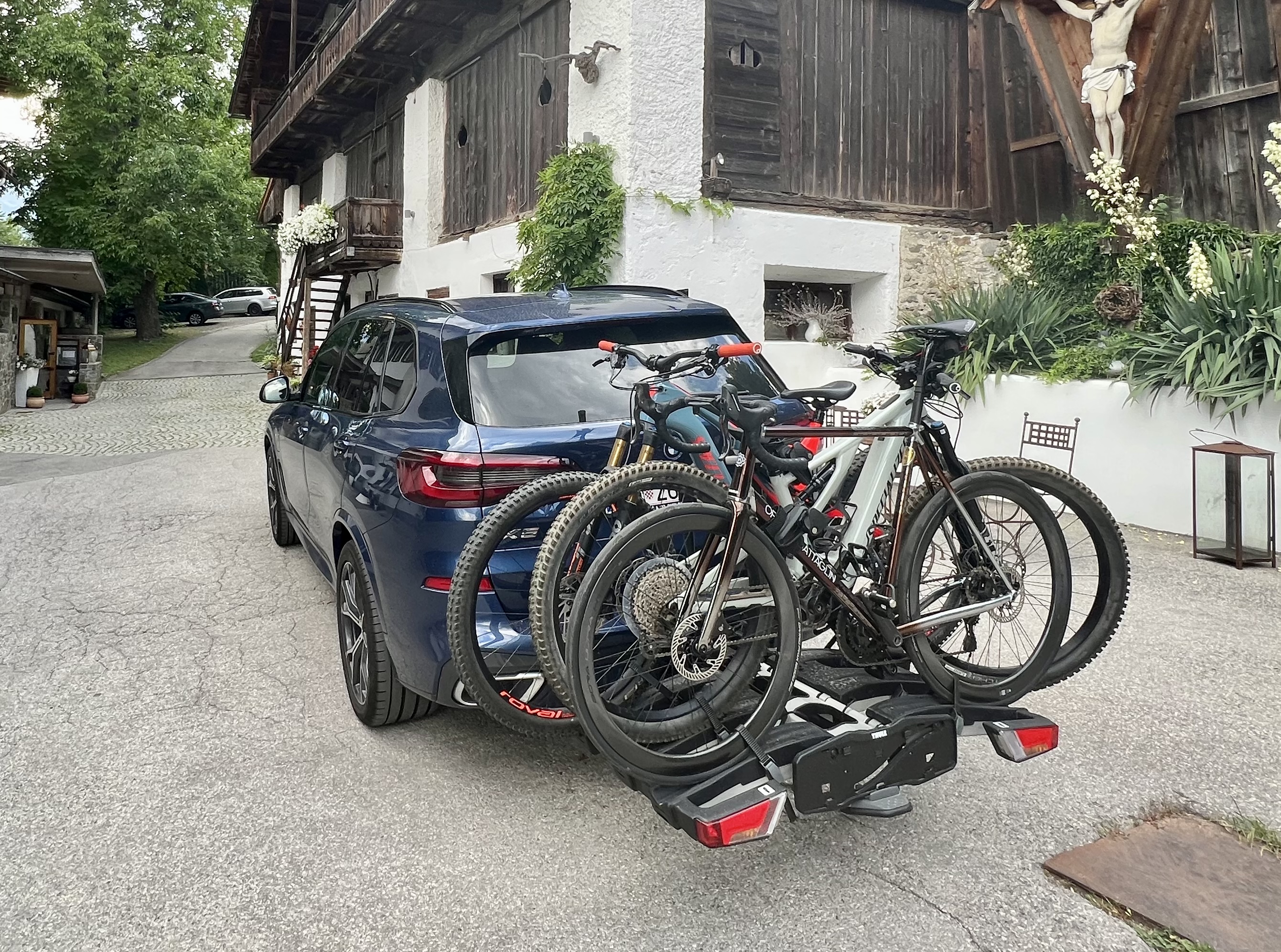

Hi, I transport two Levos and a road bike on this rack (version for three bikes). I take batteries out to save weight. You need to fiddle s bit with three arms, but it’s doable without problems - and without rubbing on the frames. To fit tires, just deflate them a bit. Then I turn Levos one to left other to right - my XL is a bit longer so I adjust everything and then finally fasten all straps and arms.

Hi @veryoldfart would you mind sharing a picture of the adjustable bar, or a like to it? Many thanks.
Hello & welcome,
I can‘t believe it and first thought the bike is to large for the rack. I changed to a new rack since the old one was not wide enough to safely hold the new 29er eMTB - for those there are not to many tow ball ike racks that are wide enough.
Having checked specs/dimensions of your rack on Thule website and finding your bike dimensions on Species website there should be no problem to fix it on the rack. 🤔
Not seeing the second tyre in your pictures I could imagine it is to close to the center of the rack what would not allow to correctly strap the second tyre as being pushed to far out of rack center. Hmmmmmm…….
BTW, the Thule Epos is expensive but the frame clamp/strap system is sweet.

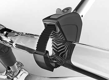

PS:
Regarding clamps some people replace the Thule ones by Ateras strap holders of the Strada:

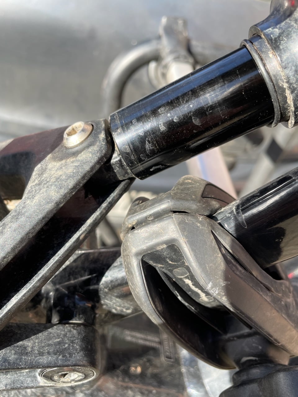

Looking forward to hear from this, I also have easyfold. Great rack, but only annoying thing about it are the clamps.

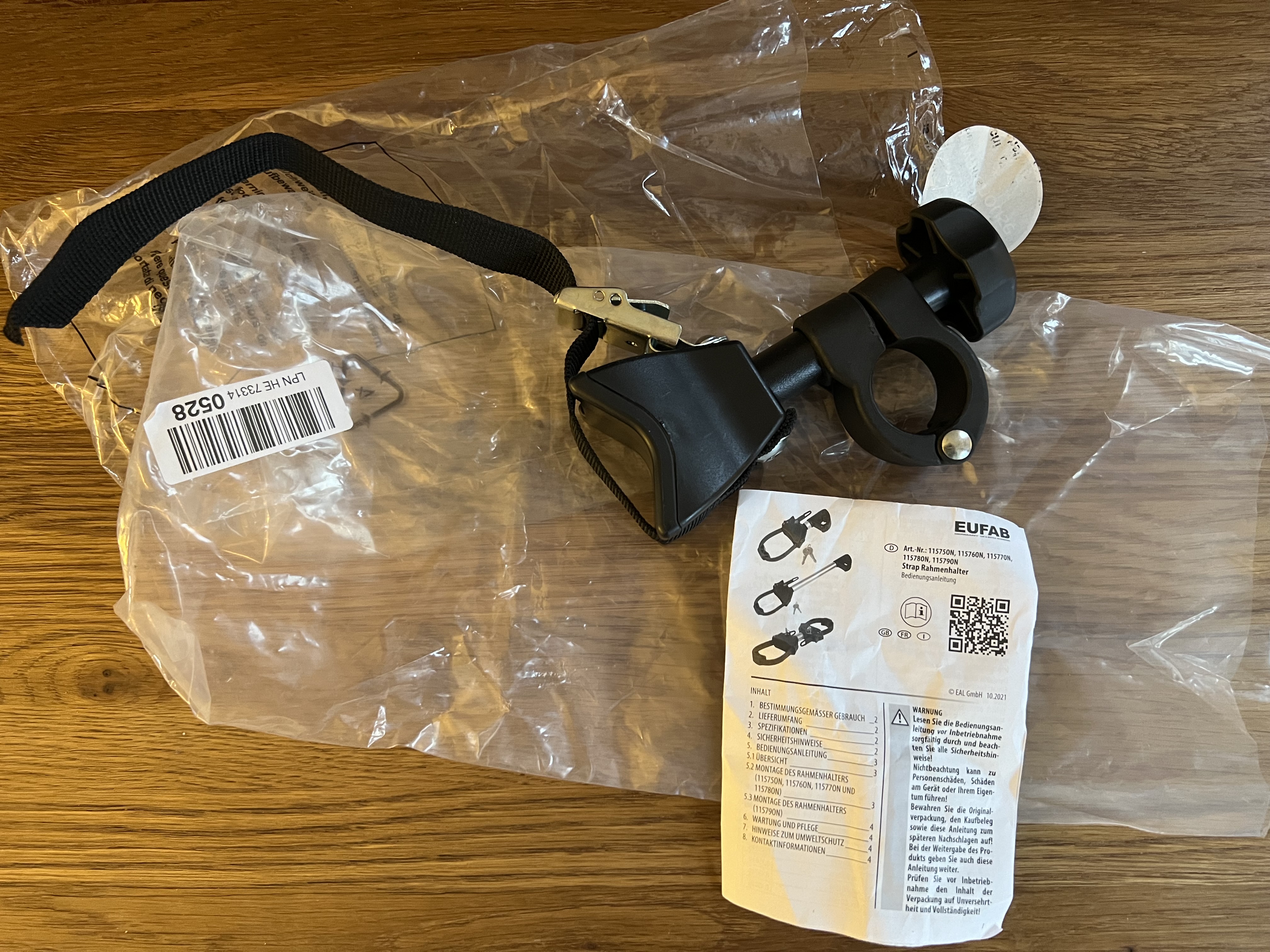

I tried to save some money by ordering with one of the “Used - Like New” options in Amazon for half the price but this monstrosity turned up 😂
I’ve sent this back and ordered it again at full price. If I don’t report back by the end of the week message me here again and it’ll send me a notification 👍

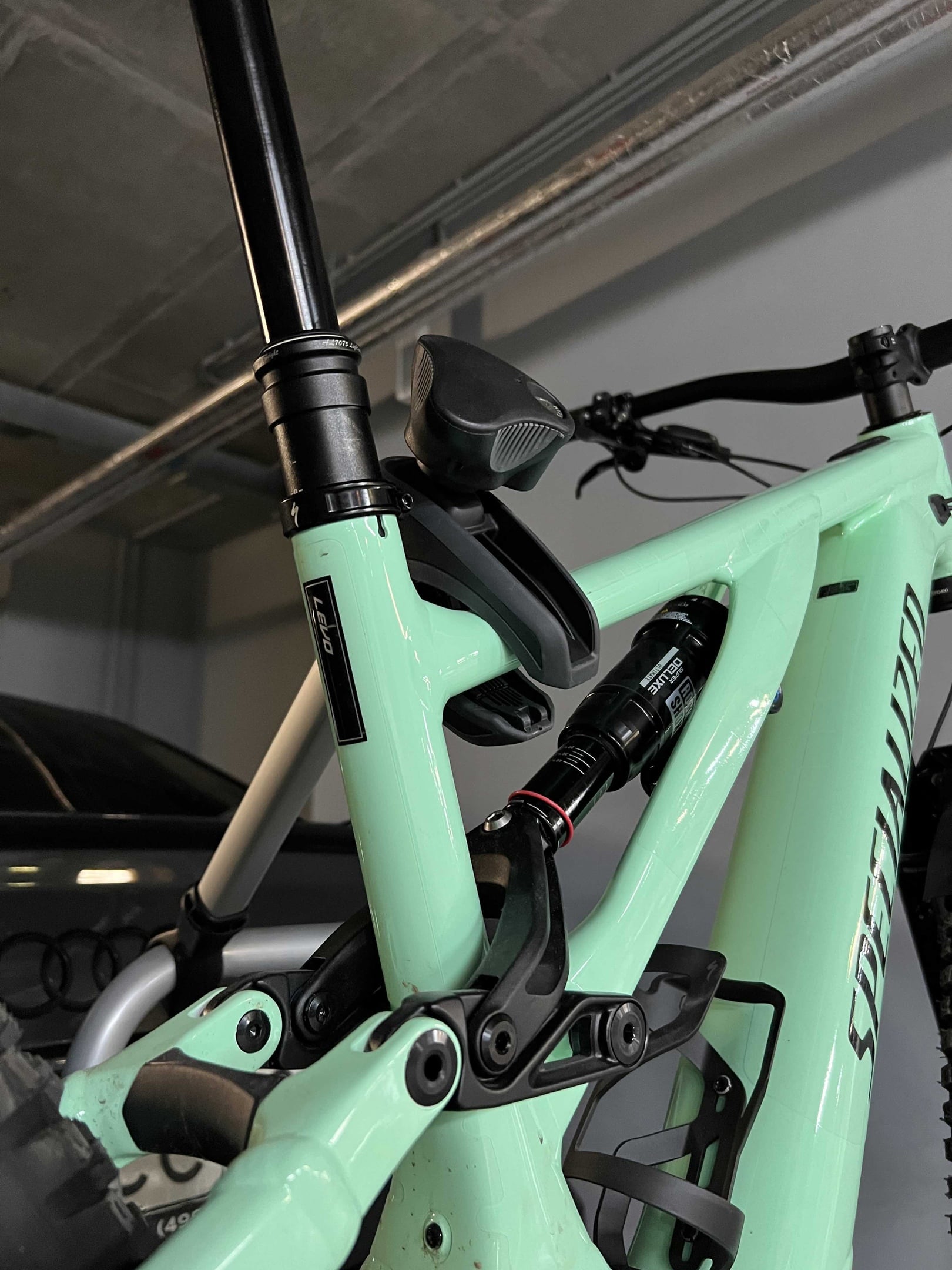

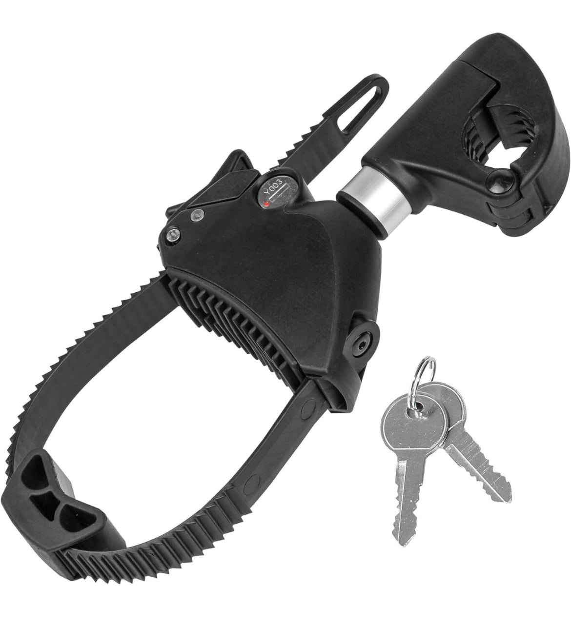

We have to transport 2 Levo’s on our easyfold xt and found these Fiamma bike holders to do the job, they are not lockable but we put separate locks on anyway.
