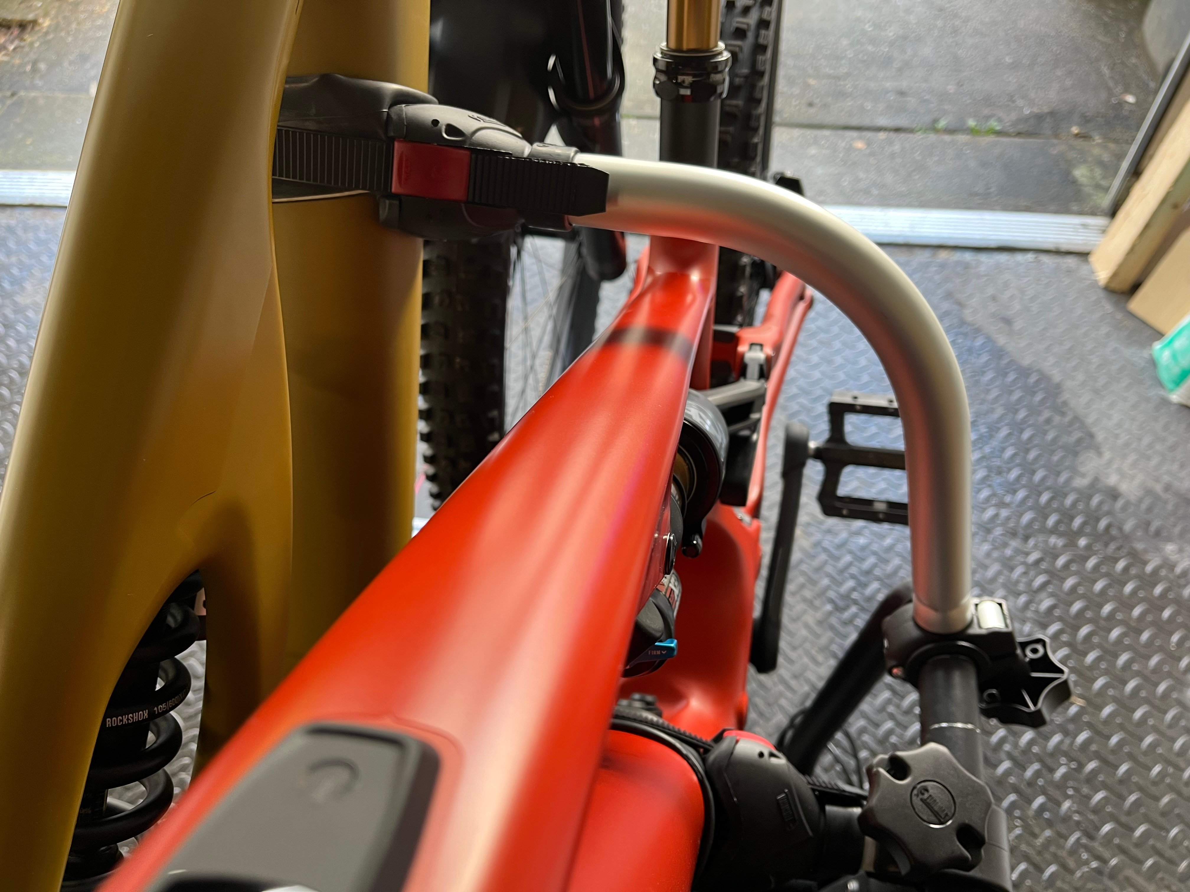

Does anyone use any thing to protect the deraillieur when usign the racks, Im talking about for the second bike so that it doesnt get bashed into

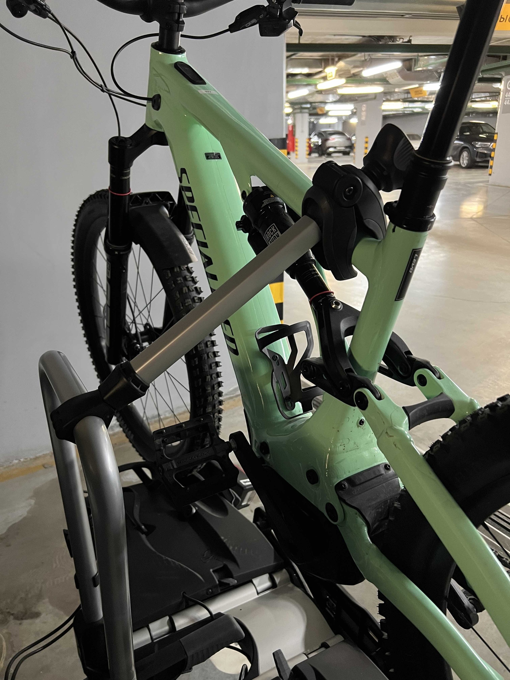

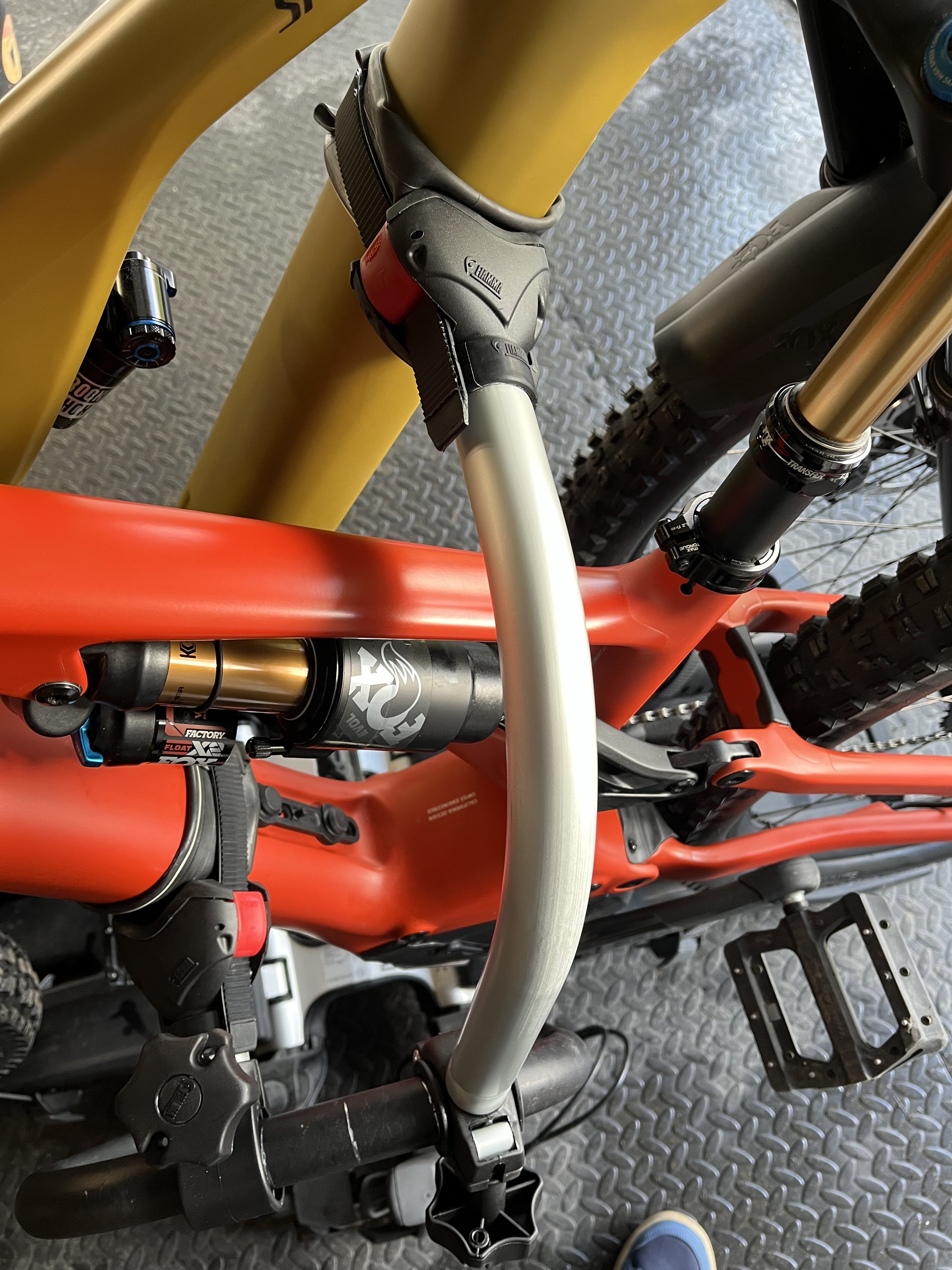

Hi ! This looks like a perfect fit / solution for me.
Could you let me know the size Fiamma you used for the longer top arm ? Eg is it a Fiamma Bike Block Pro 4, 3 or 2 ?
Hi, it is the Bike Block Pro 3 I use for the second bike, the ends are tight but they do rotate for you to get the correct angle. Bought from Towsure about £23.
Thanks so much for the advice. I have some on order. Now just wandering the best way to add a lock…

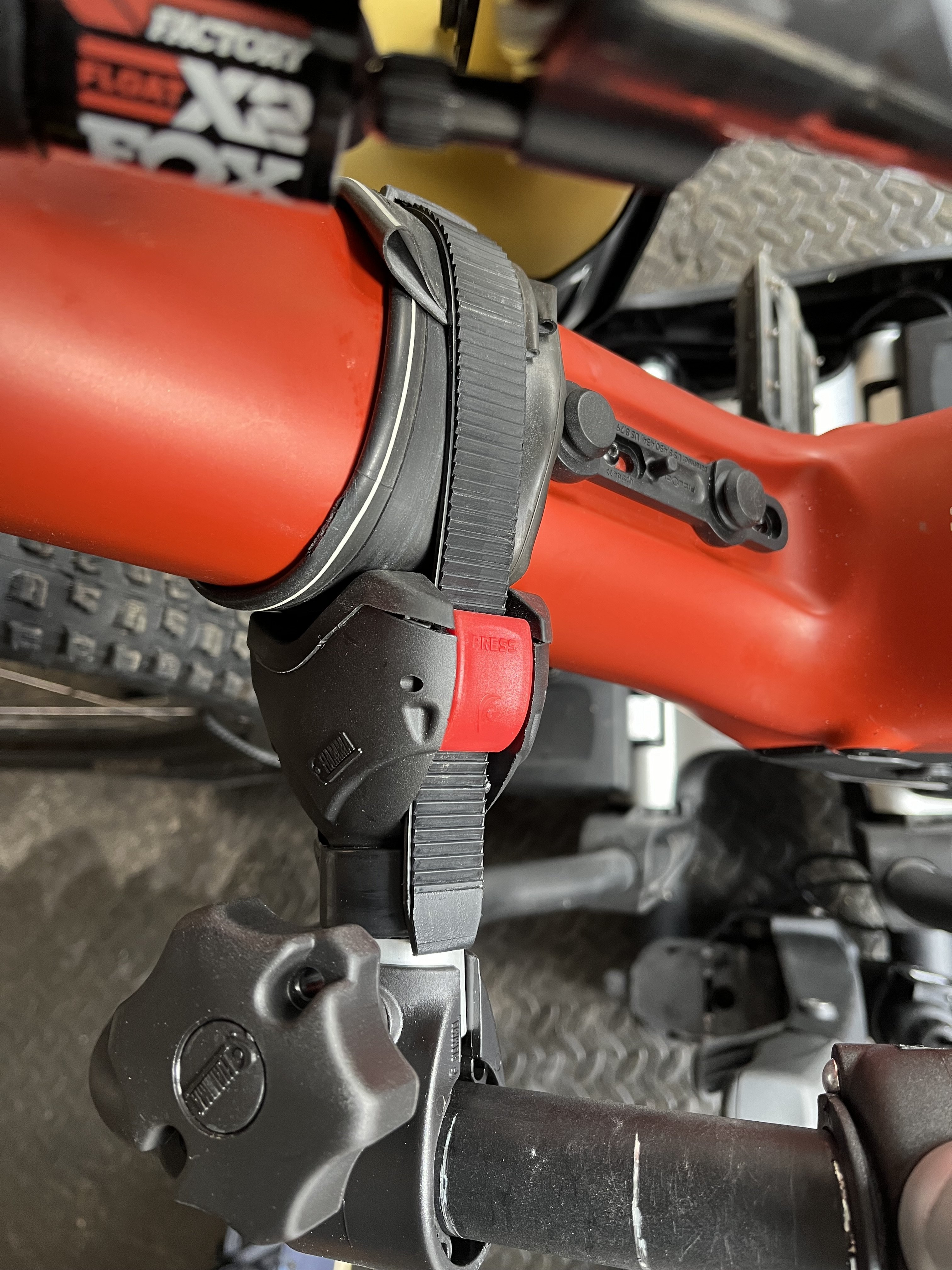

Looking forward to hear from this, I also have easyfold. Great rack, but only annoying thing about it are the clamps.

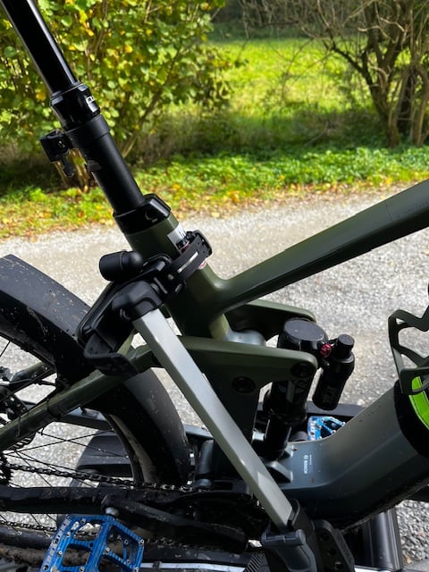

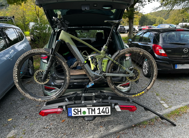

Hello ! I bought Thule Easyfold. I was happy until i tried to install my Turbo Levo 2022 on this bike rack... It is almost impossible. How you do it ?
I googled, then watched youtube videos and i put my Levo on the second place for second bike in Thule Easyfold6 but i cant fix my front wheel in straps... so help me please
View attachment 108112View attachment 108113View attachment 108114
Hey! I have a similar setup with Thule EasyFold. Turbo Levo 2022 is quite big, so it's good you're using second bike spot. For the front wheel issue, try to extend the straps, sometimes lowering the bike slightly helps too.
As a side note, you could try adding extra mounts or mix straps. Also, check if Thule has any accessories for bigger e-bikes. Look it up on their website.:)
