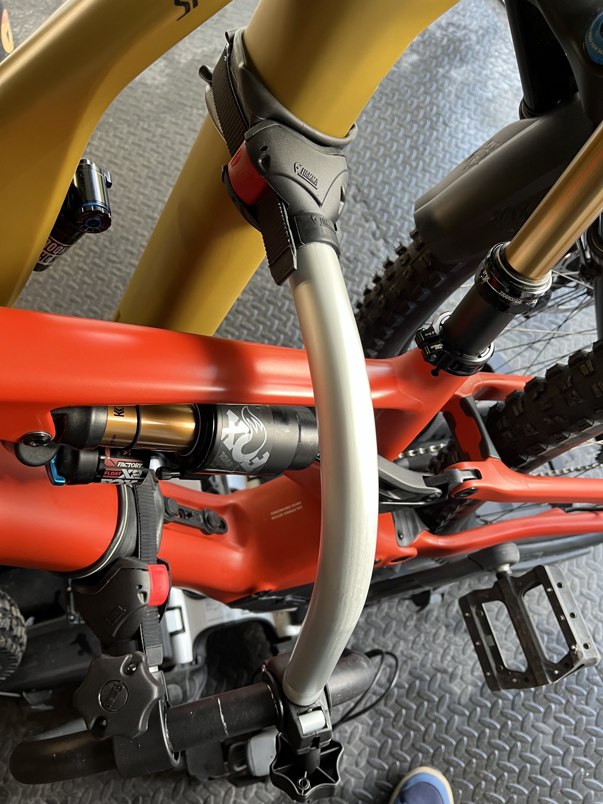

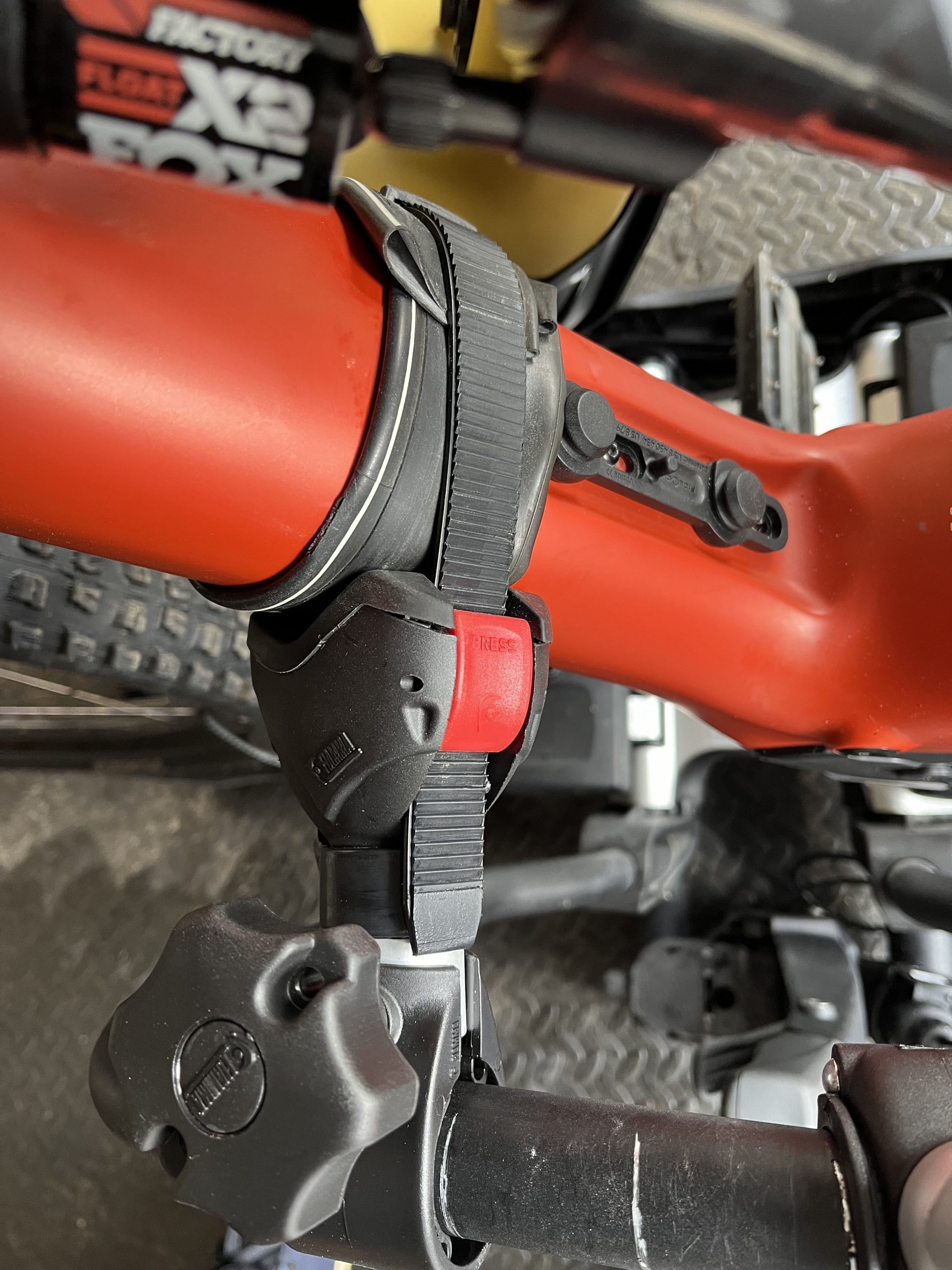

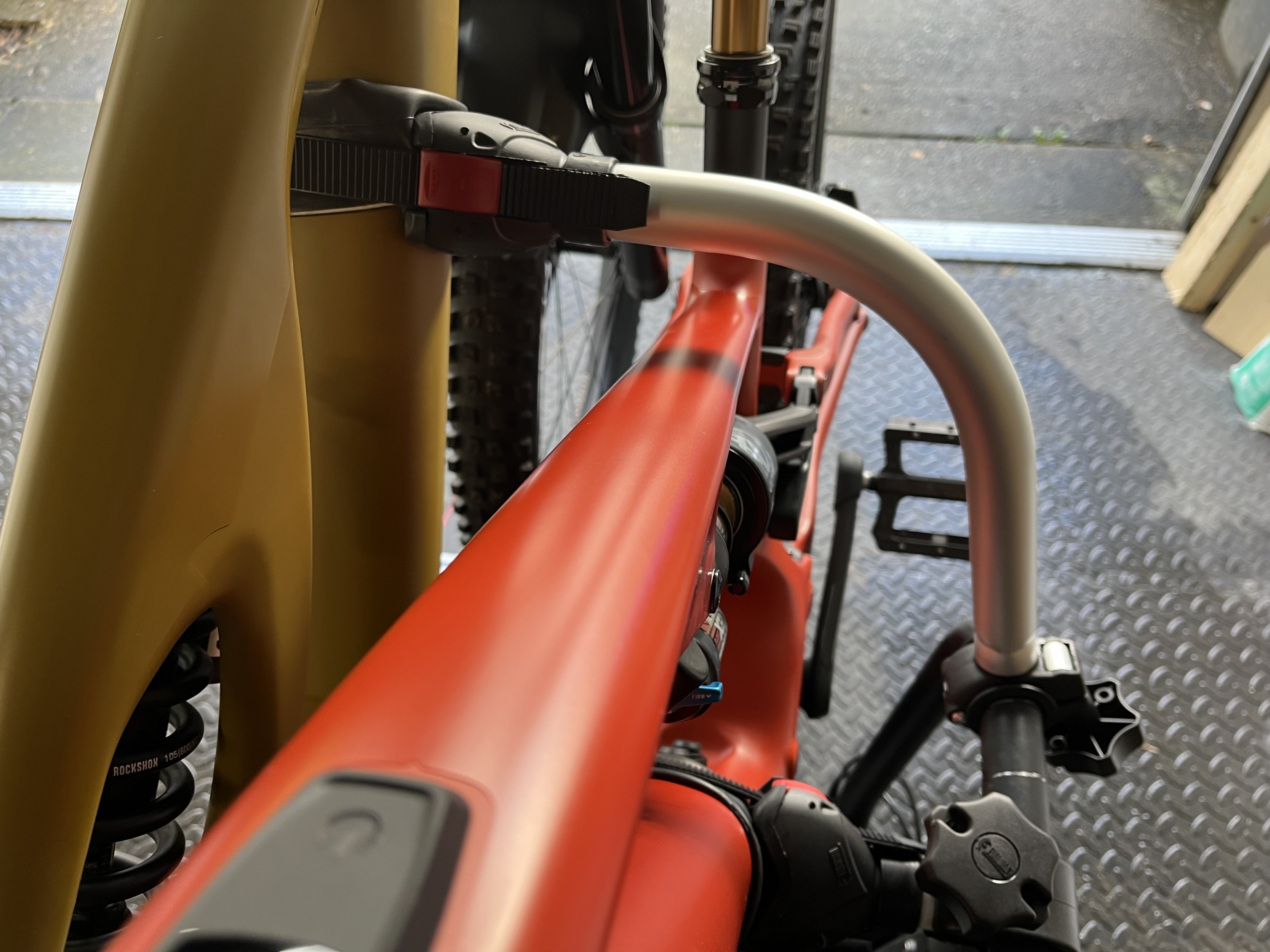

we use a Thule XT rack to carry two Spesh Carbon Levos.
Thule make a specific adjustable bar designed to be fitted between seatpost and headtube, to avoid clamping around carbon frames. Costs abt £25 on Amazon. Then also fit 2 pairs of thule long straps and everything is easy peasy - plus no risk of damage to carbon frames
voila

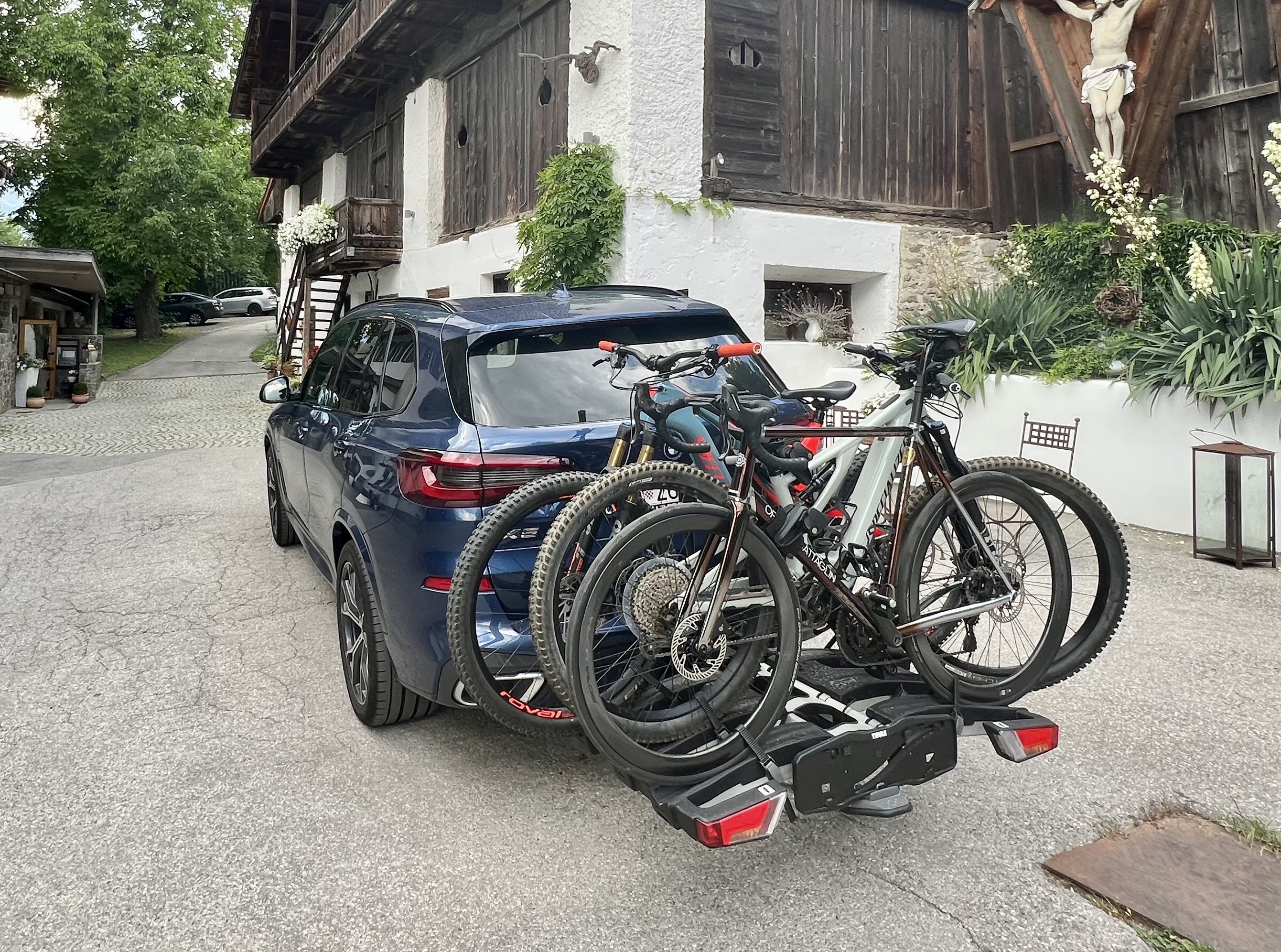

Hello ! I bought Thule Easyfold. I was happy until i tried to install my Turbo Levo 2022 on this bike rack... It is almost impossible. How you do it ?
I googled, then watched youtube videos and i put my Levo on the second place for second bike in Thule Easyfold6 but i cant fix my front wheel in straps... so help me please
View attachment 108112View attachment 108113View attachment 108114
Hi, I transport two Levos and a road bike on this rack (version for three bikes). I take batteries out to save weight. You need to fiddle s bit with three arms, but it’s doable without problems - and without rubbing on the frames. To fit tires, just deflate them a bit. Then I turn Levos one to left other to right - my XL is a bit longer so I adjust everything and then finally fasten all straps and arms.
On the photo it looks narrow, but there ist plenty of space and definitely no rubbing. Bad camera angle.
voila
Hi @veryoldfart would you mind sharing a picture of the adjustable bar, or a like to it? Many thanks.

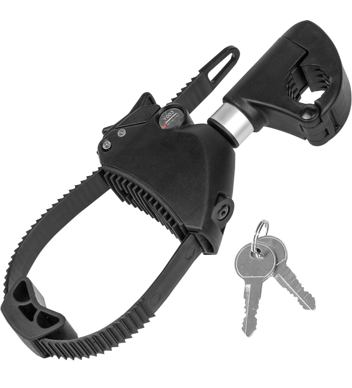

Regarding clamps some people replace the Thule ones by Ateras strap holders of the Strada:
I’ve ordered the Eufab one for my Thule EasyFold XT and Trek Rail. Will report back.
Looking forward to hear from this, I also have easyfold. Great rack, but only annoying thing about it are the clamps.
I tried to save some money by ordering with one of the “Used - Like New” options in Amazon for half the price but this monstrosity turned up 😂
I’ve sent this back and ordered it again at full price. If I don’t report back by the end of the week message me here again and it’ll send me a notification 👍
