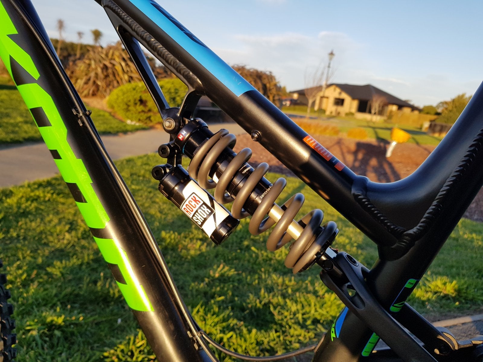

Shane(NZ)
Sep 4, 2019
179
140
NewZealand
On my previous non e-bike I had a 650lbs spring at that time I was about 118kg ready to ride.
You would need 750+ lbs , biggest spring I have seen is 700lbs.
Try going to your local and see what they can do.
Best of luck ?‍♂️
Best of luck ?‍♂️
