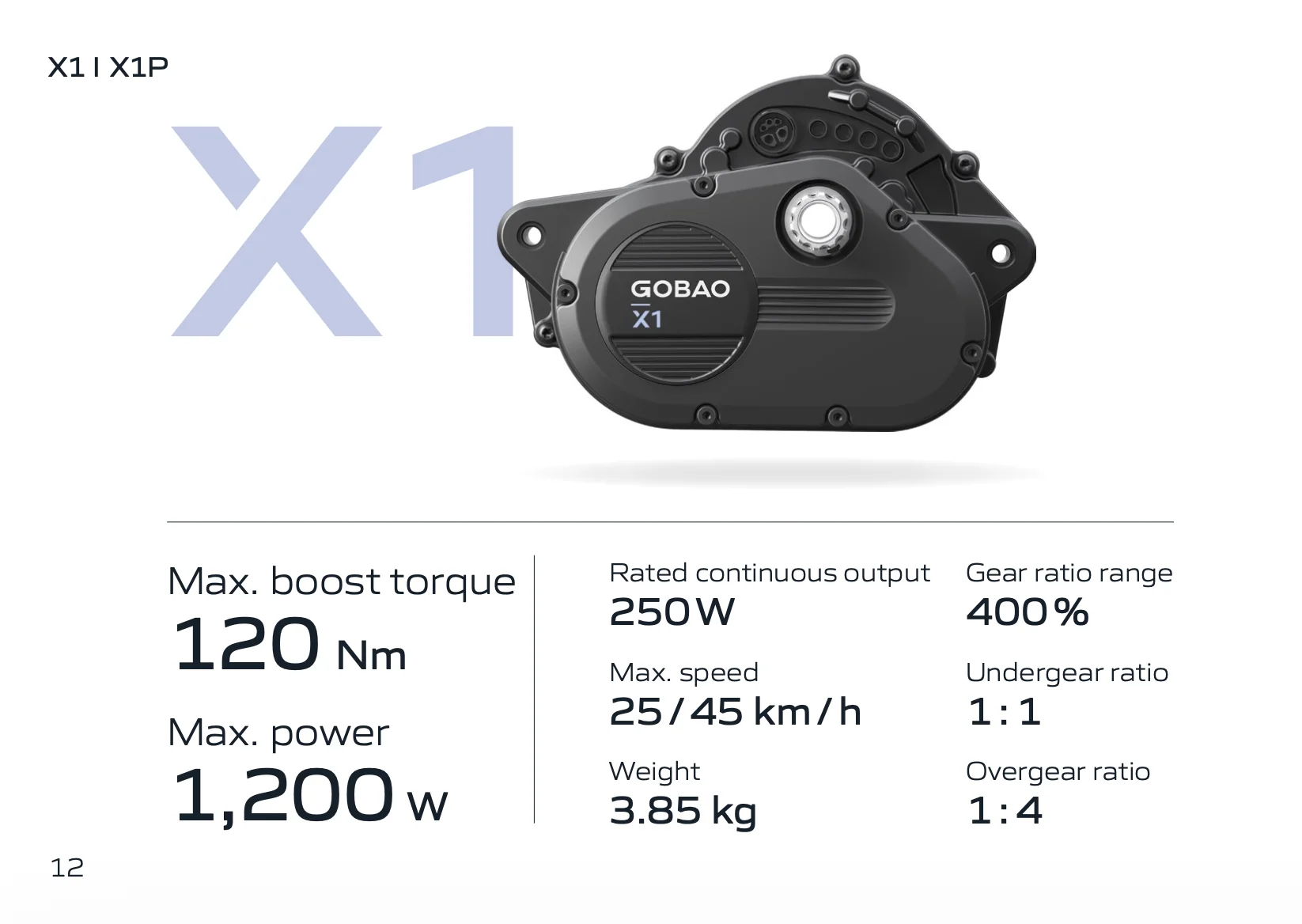

The rumours are that the Levo G5 will come with a gobao system.
This would be profound if true! And would make total sense for likes of Specialized. Gobao could easily become the new Brose for them. This is exactly what we want. Competition in the ebike motor space again, not to mention and instant validation of the Motor-Transmission-Unit MTU space (need to stop calling it MGU).
Heard this a few months ago, in Spesh bikeshop from another country than mine (France). I thought it was a joke , and still think it is one (US company buying chinese motor ? Especially in the actual context. But heh, if Spesh wakes up and delivers a proper new Levo, and not a fridge on wheels, they can have my money).

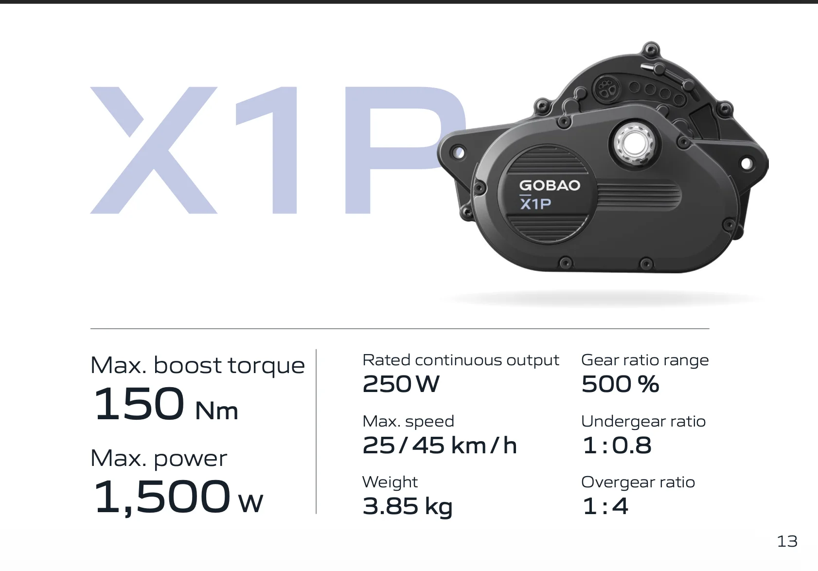

What if the motor is blocked in one rotational direction? That way it can amplify the ratio, but if it is dead, it will be stuck at its lowest ratio. And there won’t be pedal assistance. But it could work.
I've looked into planetary gearing a bit. It's very flexible and you can configure it in a number of ways. The sun gear is sentral here, as is the possibility to lock it with an electromagnetic brake (no current = locked) or a sprag clutch.
1) Sun gear is only allowed to go forward: When stationary, you are in the hardest gear. When spinning faster, the gear becomes progressively easier
2) Sun gear is only allowed to go backwards: When stationary, you are in the easiest gear. When spinning faster, the gear becomes progressively harder
3) Sun gear can go both ways: When stationary, you are in a middle-ish gear
So you are right, it is possible to lock the sun gear when the battery is dead. What gear you're in when this happens is determined by how the planetary gear is configured.
Planetary gears are very clever!
