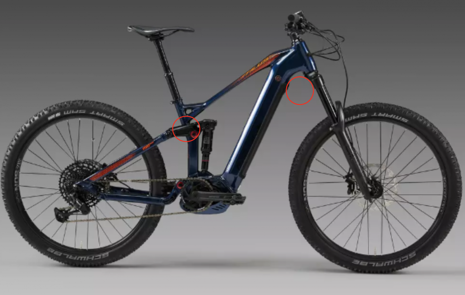

Rather than lifting using your hands try this little trick.
At the front of the bike put your arm under the headstock/downtube area so that its in the crock of your arm. With the other arm reach over the bike so that are able to get hold of something in or around the seat tube link area. With the knees bent I find it a simple lift onto the work stand as its now close to the body and I'm not ever reaching. Just watch out for where the pedal might end up! ?
Ouch!!! I can see what you mean. I don't think the family jewels would appreciate being crushed by a pedal!!!
