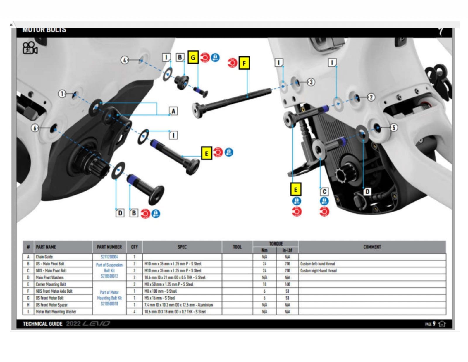

I have discussed this issue with Bear Valley Bicycle in Arnold California, they pointed out the motor bolts have to tightened exactly to the specs, if not it may VOID the warranty. In my case the motor noise was vibrating thru the frame and oscillating. In the owners manual this page shows the bolts that are involved, but I discovered the call out lettering was incorrectly marked ( in yellow) is now correctly marked. Also new thread lock maybe needed as bolt "G" can re-tighten ( I discovered ) if thread lock is not applied.

Interesting I checked the torque settings and mine were a little loose. Sure would be nice if it helps with the progressive noise.
It did go for me, yesterday I pulled over and checked to see if the bolts had tightened and they did, so now I need to go back and Locktit it.
Is the correct torque for the DS Front Motor Bolt (G) and the NDS Front Motor Axle Bolt (F) 6Nm as shown in your image above? I see in the 2022 Levo owners manual that it states the torque should be 9Nm for both motor Mount front bolts. See the photo of owners manual;

I asked Specialized Rider Care for what is right.
They told me it is 9 NM and sended me this torque chart. I've checked the screws and they were massive under torqued.
They told me it is 9 NM and sended me this torque chart. I've checked the screws and they were massive undertorqued.
My front motor mount bolts were also under torqued. I adjusted to 9Nm. All others were at spec.

SanDiego
My motor was quiet from factory, but I did notice additional reduced noise when I torques the front motor bolts to spec.
