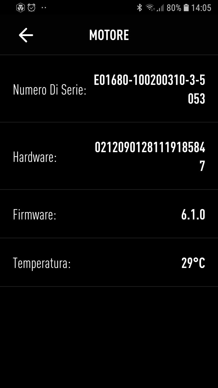

Is this motor the last series? Is it updated?
I have a similar noise
I have a similar noise View attachment 35141
How is the date of manufacture determined from the above? it’s the numbers after 100xxyyzz?
Where xx = year, yy= day, zz=month ?
if so then this motor was built on the 10th day of March 2020.....and it’s gone rogue with apparently the same symptoms as the earlier pre-modified motors.
This is a worry indeed, I know I know one motor isn’t statistically significant but here’s fairly solid proof of a newer motor giving up. Wait I’ve just realised, the video was blebo but the March build is chocs bike. I’ve made the assumption that chocs motor is faulty, albeit he’s saying his motor is making the same noise. Be good of both to keep us updated and the op report on their date of motor manufacture.

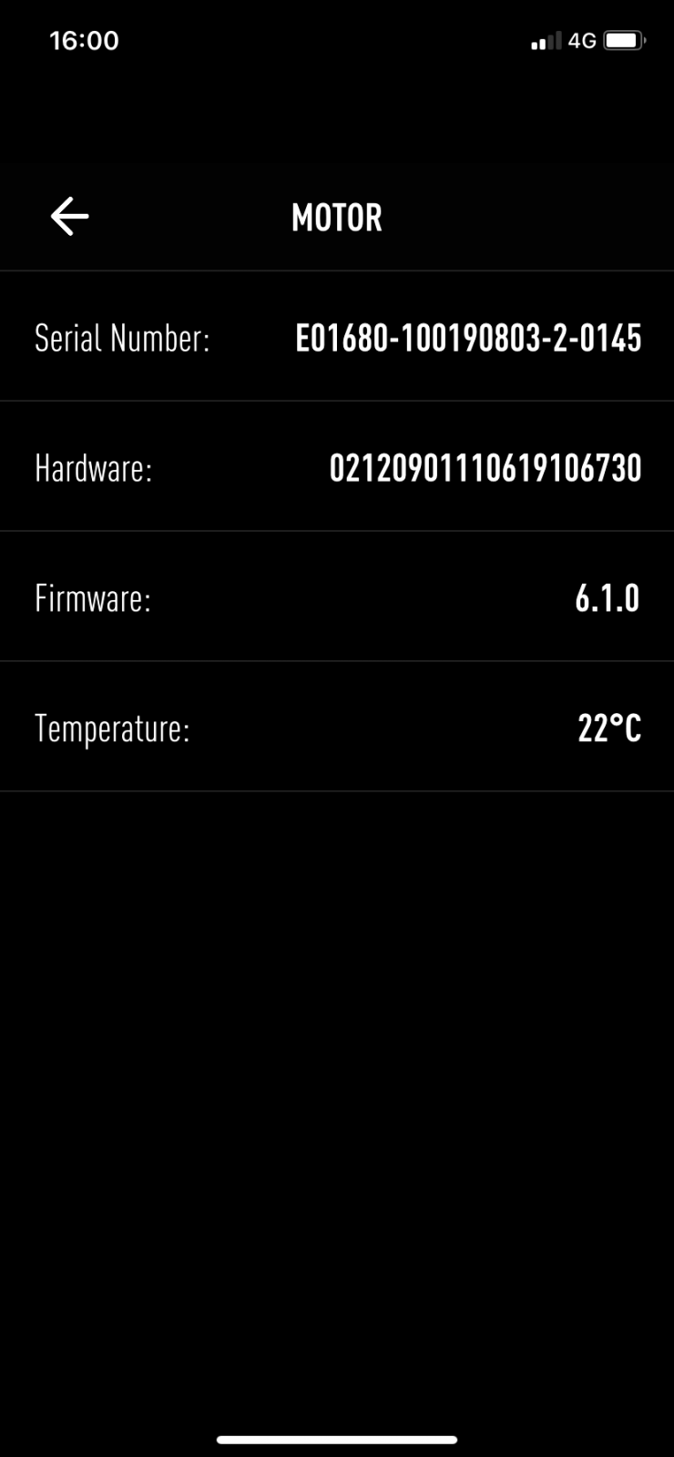

Here is my motor serial number no idea when it was built but following J200George logic and if I understood correctly then my motor will be a 2019 model. This is a 2020 model bike bought end of February could it have a motor from 19/08/03?
Choc3
Apr 10, 2020
73
46
Yes of course. 2020 models came out in 2019
On the subject on motor, yes you are correct forgot that the new models come out year before. So basically I have a motor that is more than a year old since manufactured and what I have read there has been changes done to the motor from January 2020 onwards for all the problems it has had before. Hope for the best that this motor does not fail and I know is under warranty but is all the extra hassle of sending the bike, not able to ride etc.
