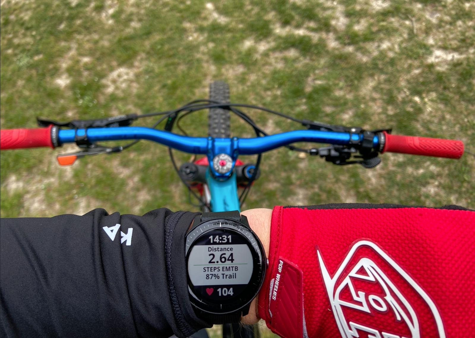

Garmin watch data field for Shimano STEPS EMTBs
Which watch is that?
It is the Vivoactive 3 Music. On sale for under $200 on the garmin website. Does everything my Apple Watch and Garmin 520 did before I believe. Only concern is battery life while using the gps mode, but we shall see how that goes once I get more time with it.
Got the watch and it appears to be connected and showing my battery percentage as intended. Awesome!

Figured it out just after I posted, and been out for a quick blast, connected straight away to the bike - this has been the final step in creating my ultimate set up, I can now see the mode and battery life on my watch, and nothing on the handlebars! Great work, super stoked on it, even if it took me buying 2 watches to get it to work!
