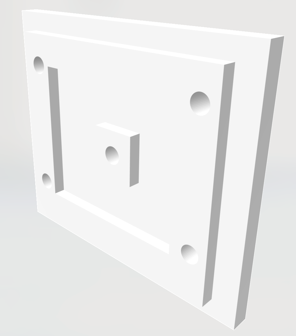

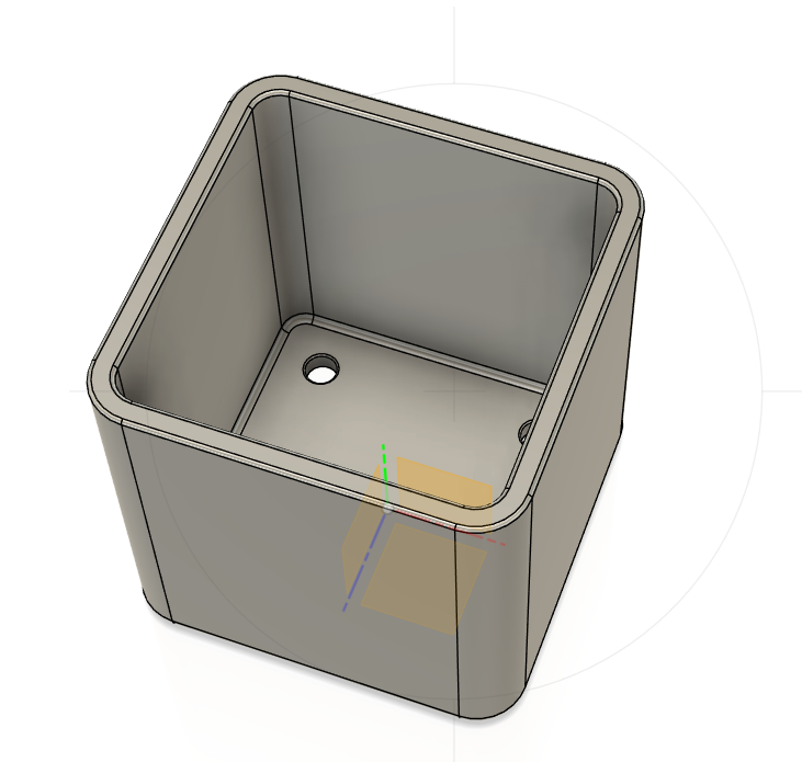

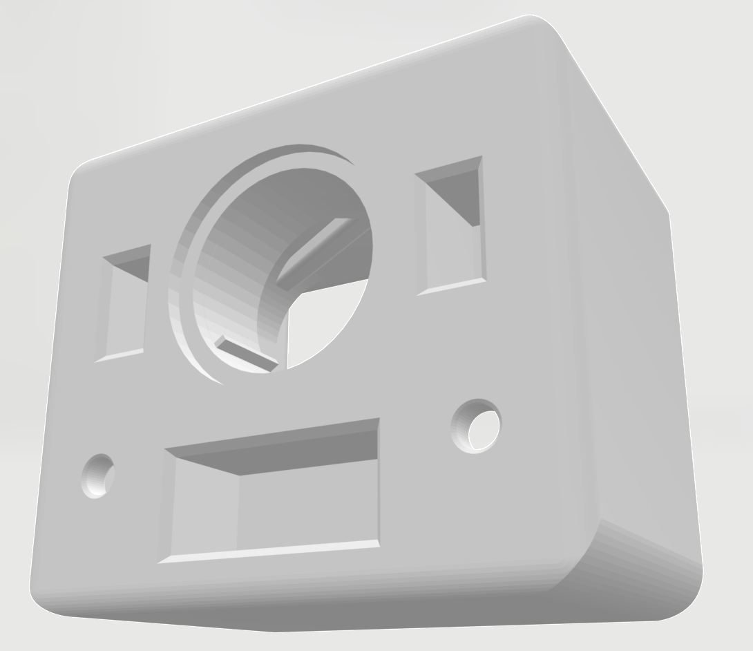

I have started looking at glue and it is not easy to find a good glue for nylon / high heat, so I am going to insert a nut and bolt to hold the boxes together. First draft of the top mount...
View attachment 168520 View attachment 168521
Looking good. From a design improvement perspective get in there with the radius tool on your your cad program and slap some nice radii on there. Square edges can chip and break and hang up on stuff. Also a slight taper to the mating parts so the can be a firm but easy fit. Tolerance is everything when designing. The magic tolerance allows the part to fit together without binding up or being too sloppy.

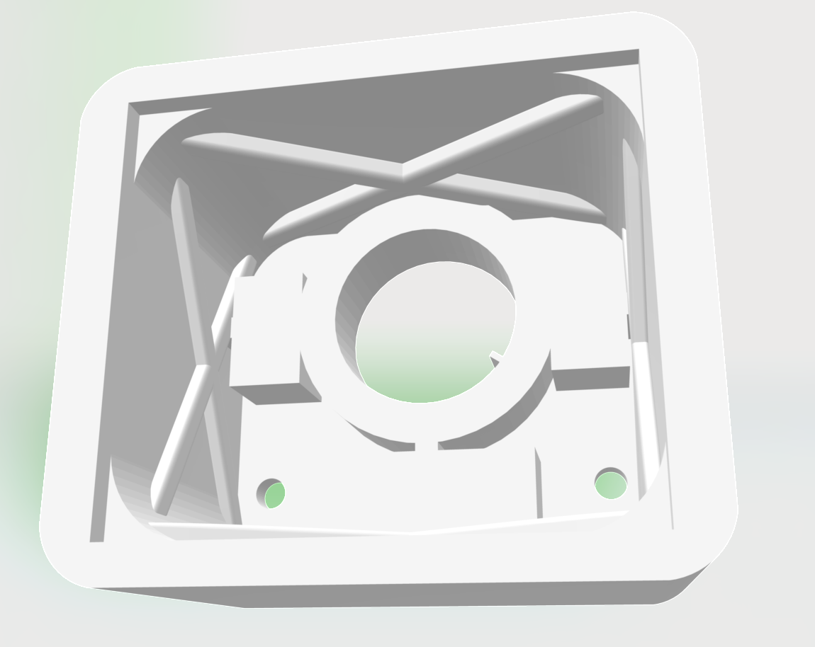

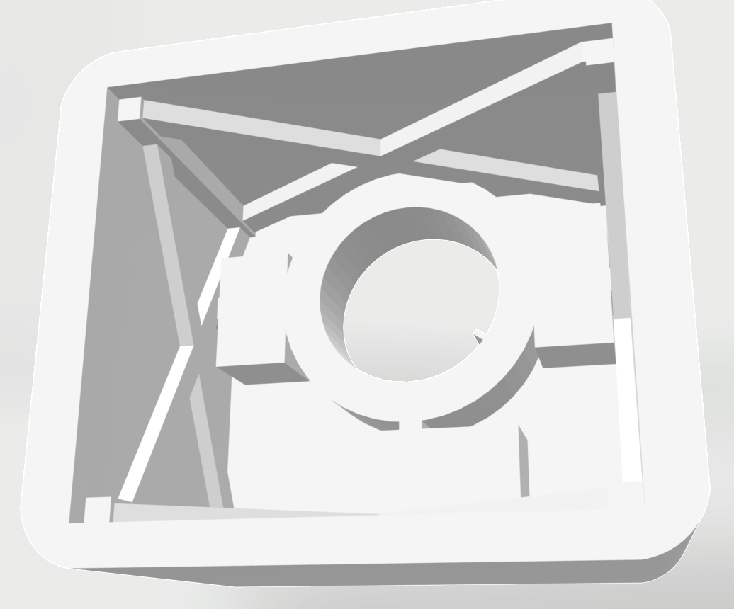

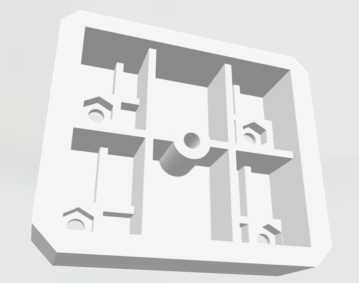

Lower mount, which is still missing the holes for the battery cover. I need the Trek battery cover to position the holes, so not finalised despite the names.
If anybody has any ideas on how to stengthen it internally, I am open to ideas. I am thinking the strenghening could also help hold the top power connection in place.
The cables need to go between the power connections as per the screenshot below.

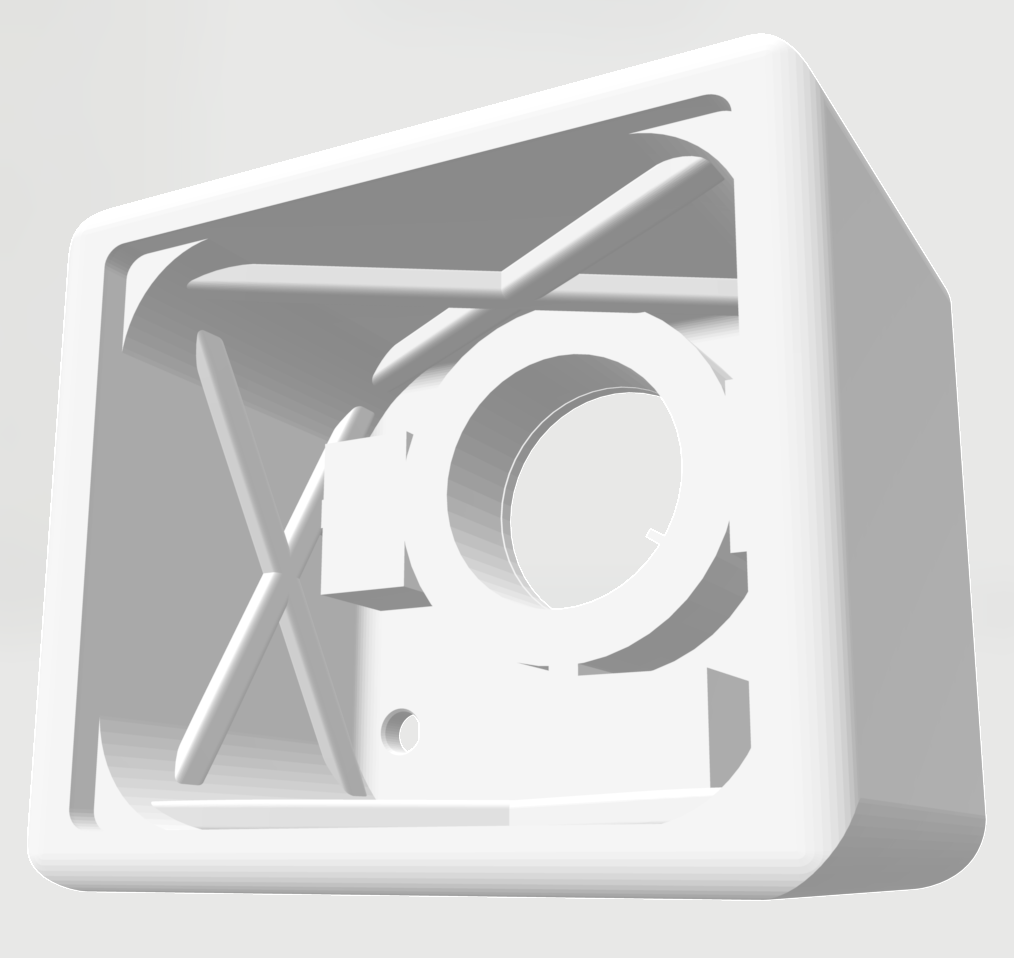

Managed to make it a bit stronger with some internal cross bracing.
Now I just have to figure out how to screw the two parts together.
Is this likely to be sufficient, or keeping going ?
Like to put a small fillet on every corner and hole. That way you reduce stress risers, parts more easily mate and there's less chance of chipping and damage of the parts.

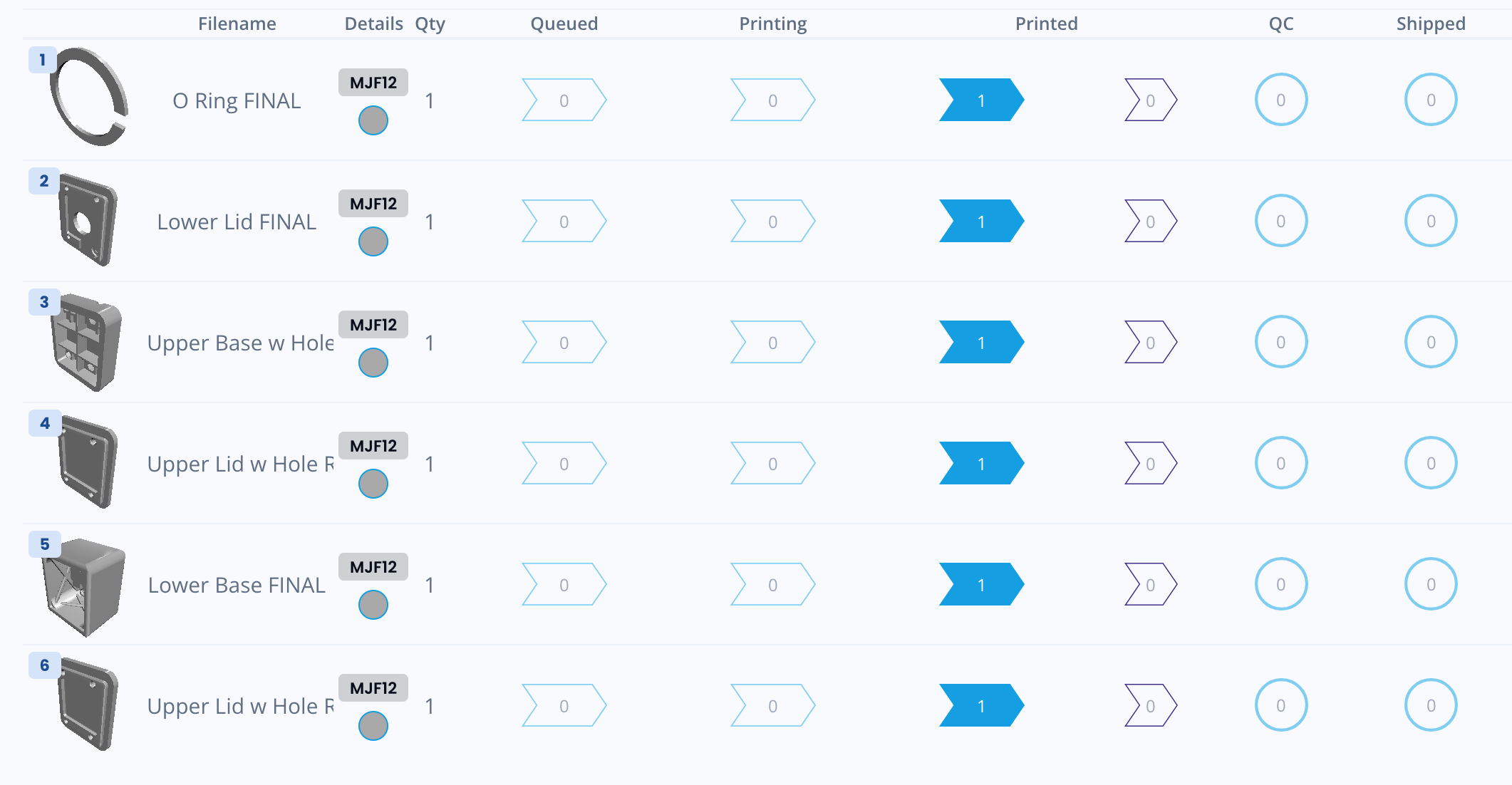

Latest thinking is to print with PA12 using MJF, as it is strong in all dimensions and has a reasonable price to print - around £50

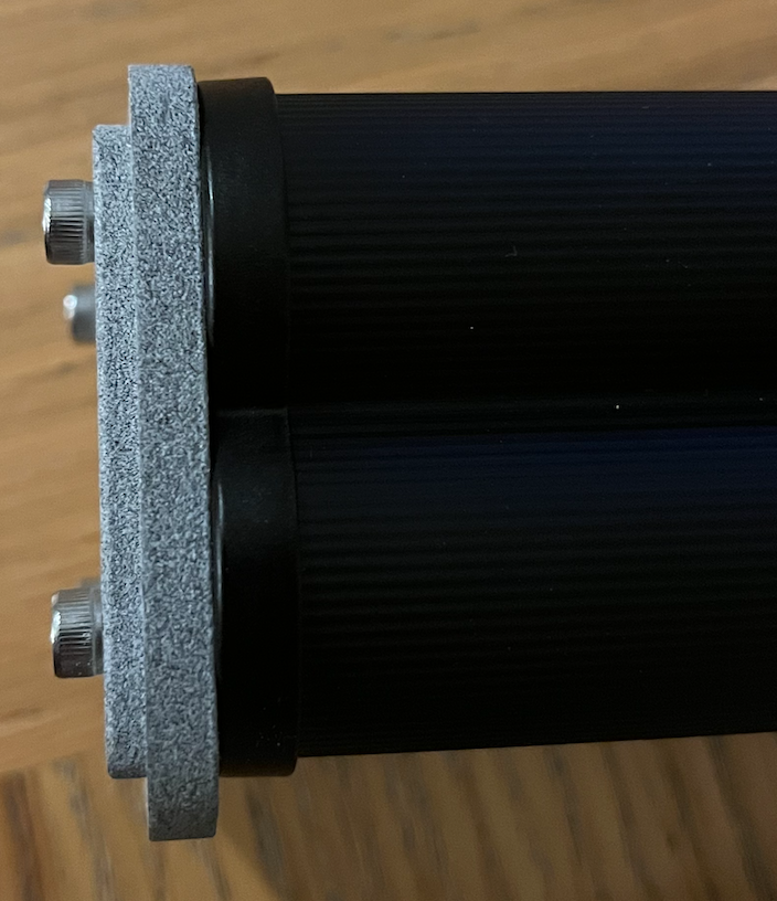

Printed and it all fits together :)
I need to make some small tweaks now that I have put it all together for the first time.

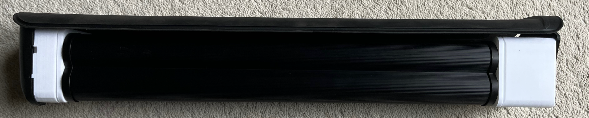

I have printed in PLA which is a fair bit lighter than PA12, so weight now would not be a fair measurment. I will try to weigh the mounts, bosch parts, nuts and bolts before I assemble.

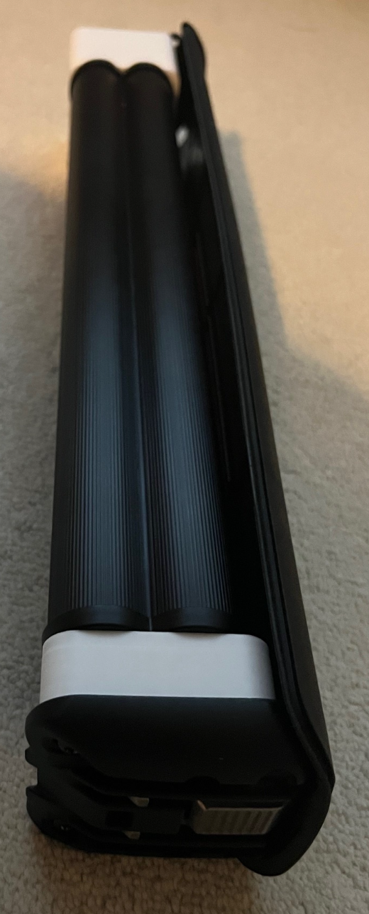

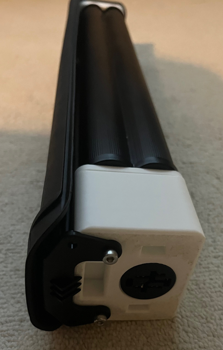

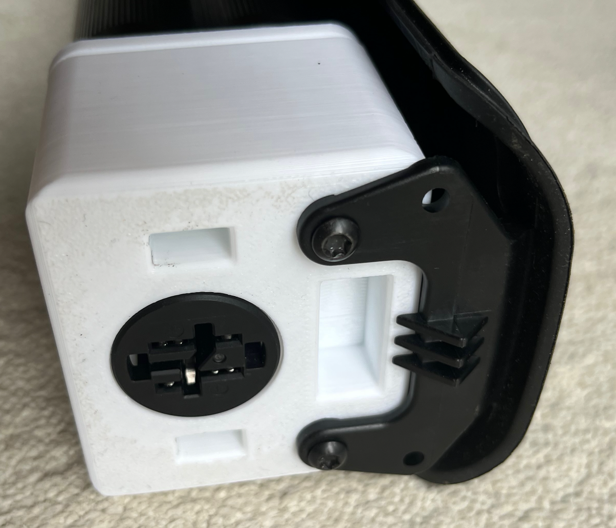

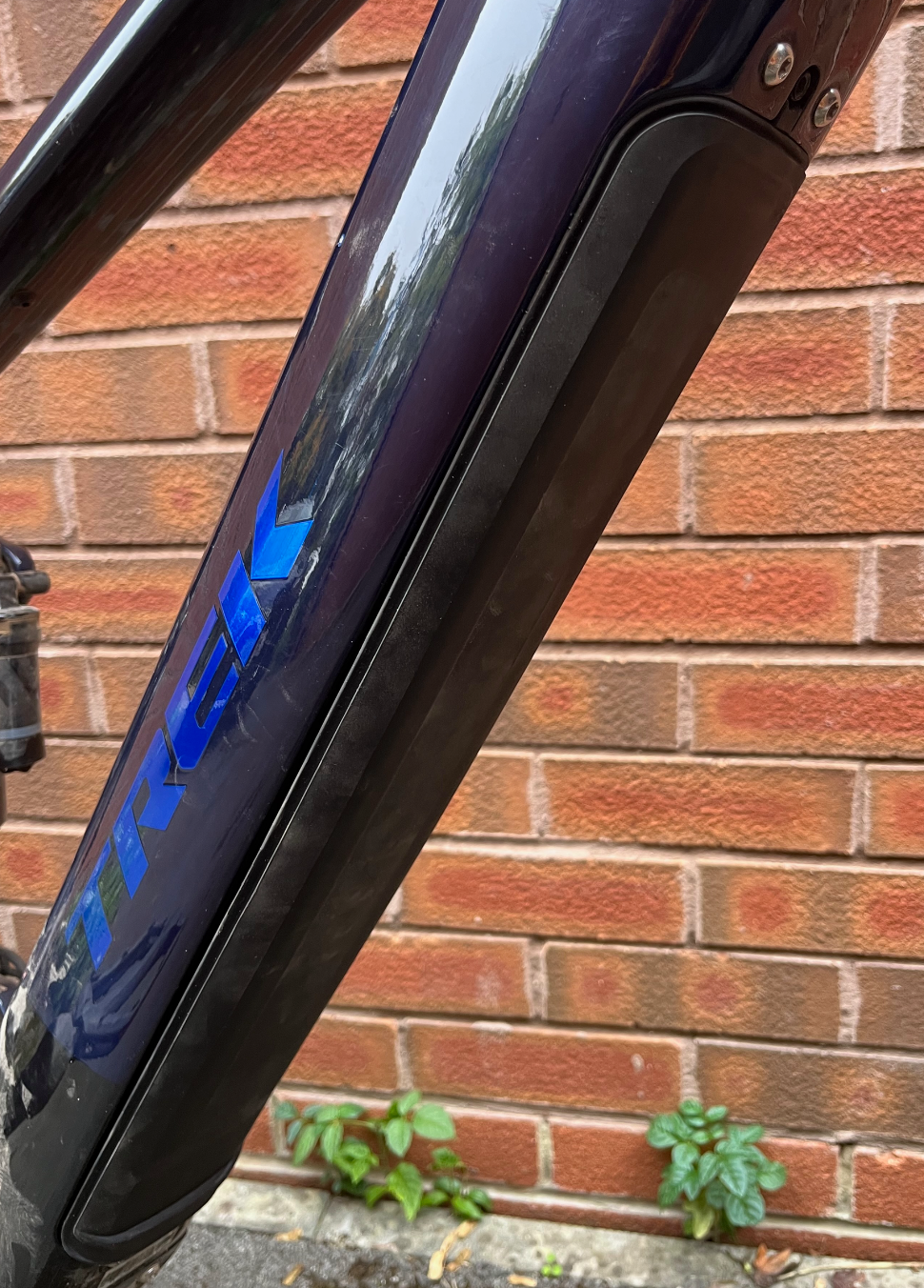

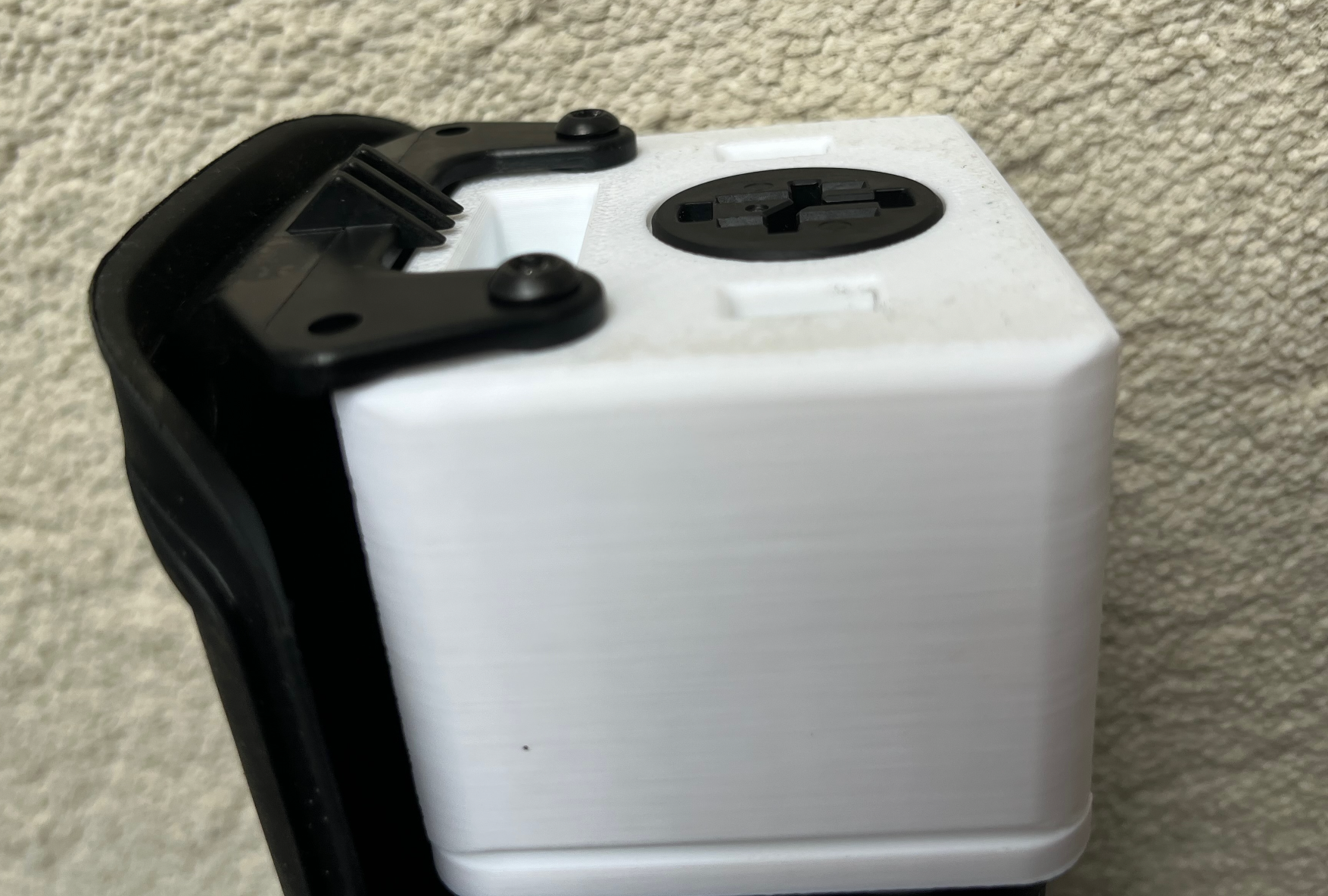

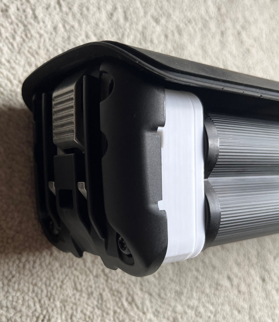

Some more photos...

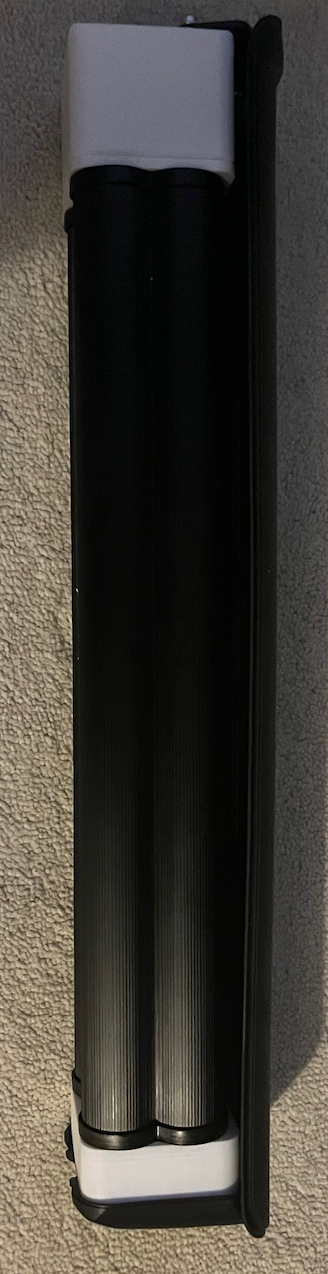

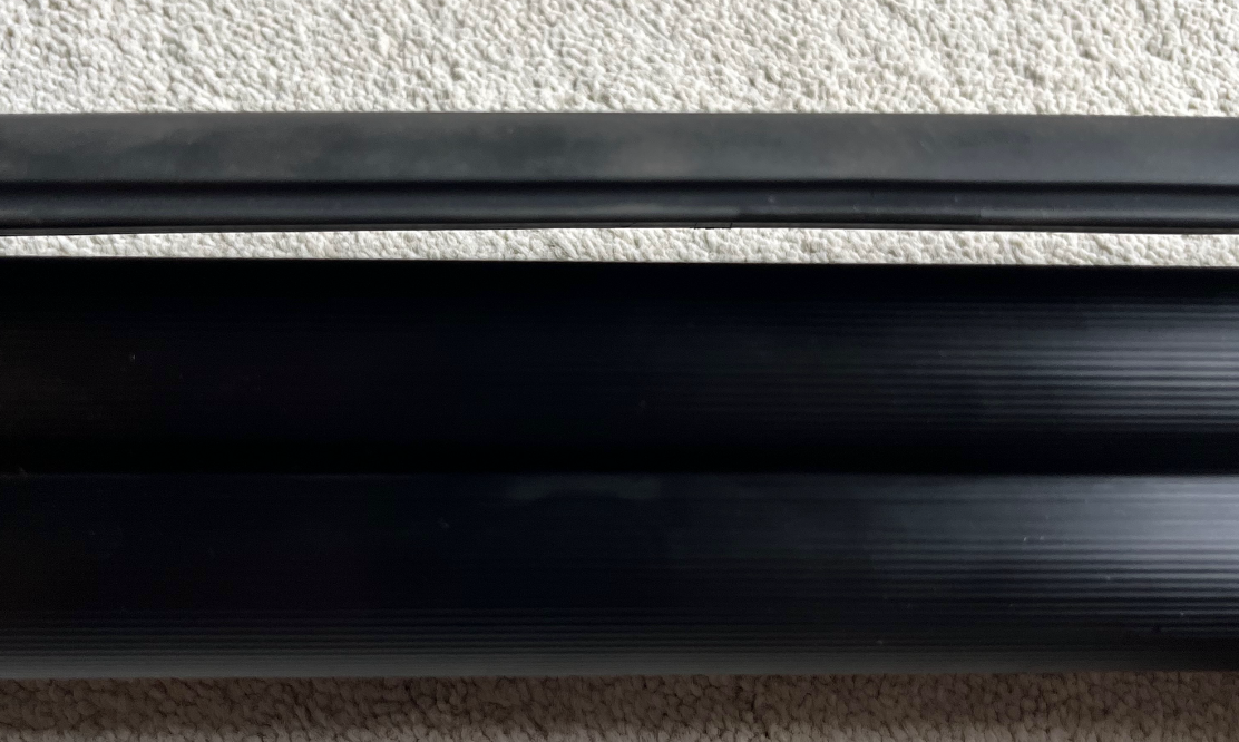

The battery mount sticks out a little bit in the middle section when on the bike, which can be solved one of two ways.
1. Make one of the mounts about 1mm longer. However, they are 72mm in total, so should be the right size.
2. Make the mount glue to the battery, via some foam between the battery and the mount. This is what Trek does with the 600wh and 800wh battery, so I think this is what I am going to do.
Screenshot 2025-10-15 at 11.12.09.png Screenshot 2025-10-15 at 11.11.55.png Screenshot 2025-10-15 at 11.11.49.png Screenshot 2025-10-15 at 11.11.43.png Screenshot 2025-10-15 at 11.11.34.png Screenshot 2025-10-15 at 11.11.27.png
There is a 3rd option, which is to make two versions of one of the mounts. One being 1mm longer - I will do this.

I have ordered the parts in MJF PA12 - they should arrive next week.

Printing - MJF PA11
MJF PA11 - make use of the discount vouchers, and select the $1.50 shipping option at the checkout.
I do not know if this will be strong enough. If I get anxious using it, I will be printing with SLS PA6-CF/GF which is more expensive. I decided not to use FDM printing, as it is weak in the Z axis. I went with PA11 instead of PA12 as higher impact resistance.

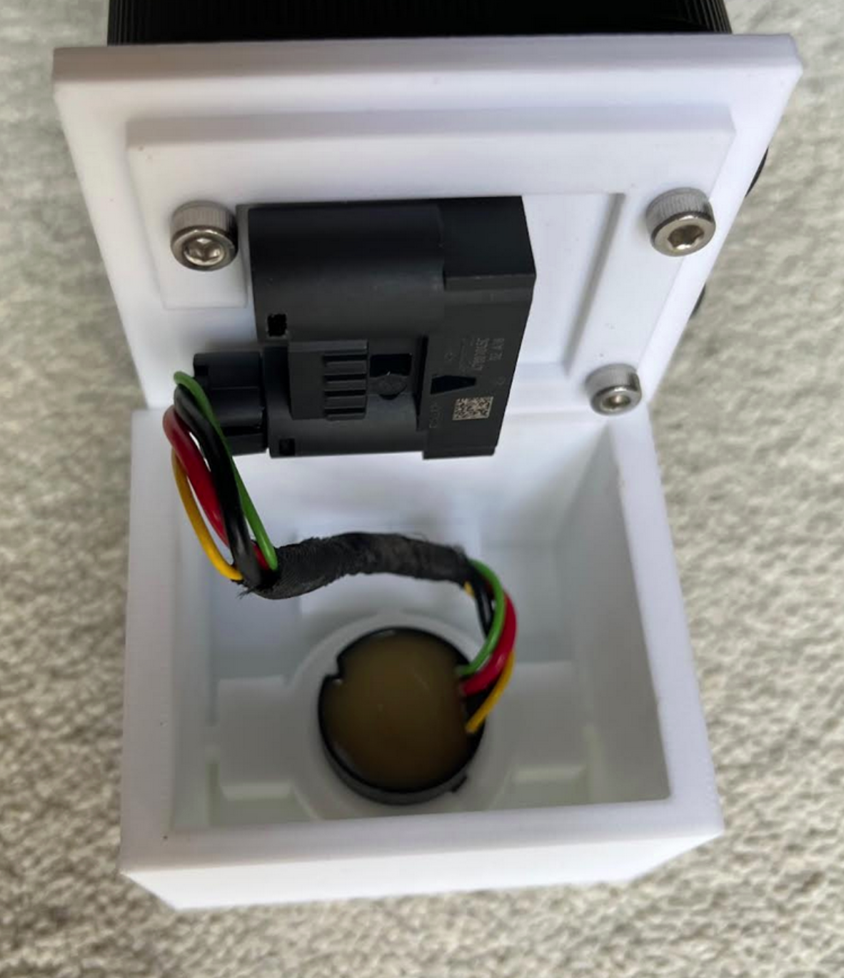

Step 1 - attach the lids to the 400 wh battery at both ends, using the M4 12mm bolts and one screw from the mount that came with the 400wh battery (which lid and hole requires this screw will be obvious, hint: the hole you can't see in the photo below). I recommend using threadlocker because the bases will be glued together, so you will not be able to retighten them at a later date.
P.S. The lids are not symmetrical, so orientate them correctly when attached to the battery cover.

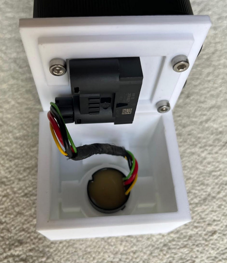

Step 2 - slot the cable of the BCH3901 through the big hole in the solid end of the lower base, and hold it in place with the printed o ring. (you could add a dab of glue to hold it in place to stop it rattling) (The o ring is optional as the BCH3901 will need to be glued in place to prevent rattling)
Step 3 - glue the bosch adaptor to the lower lid, as per the 2nd screenshot below.
Step 4 - put the nuts into the lower and upper bases, and attach to the external fittings - in my situation, with the Trek W1052364 screws, attach the Trek W5318794 and Trek W5322238.
Step 5 - place the battery with the lids already attached, into the battery cover with the bases attached, and glue the base and lids together.
