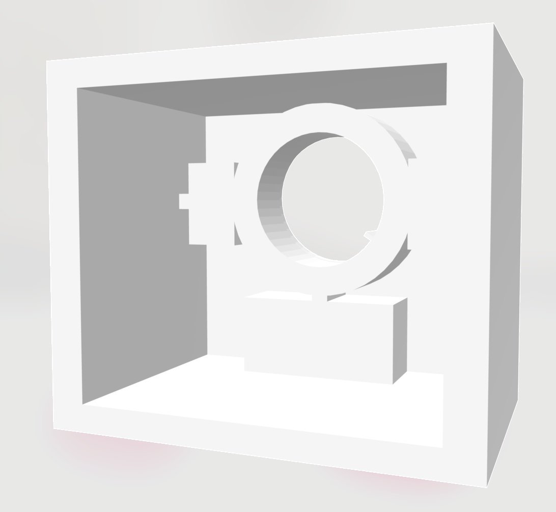

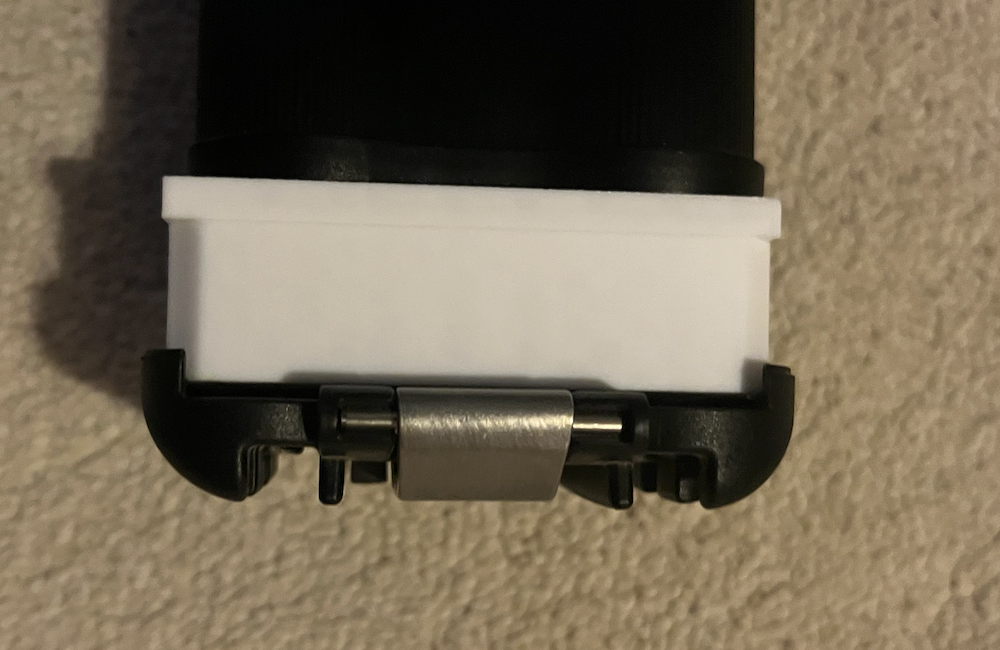

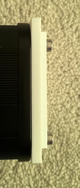

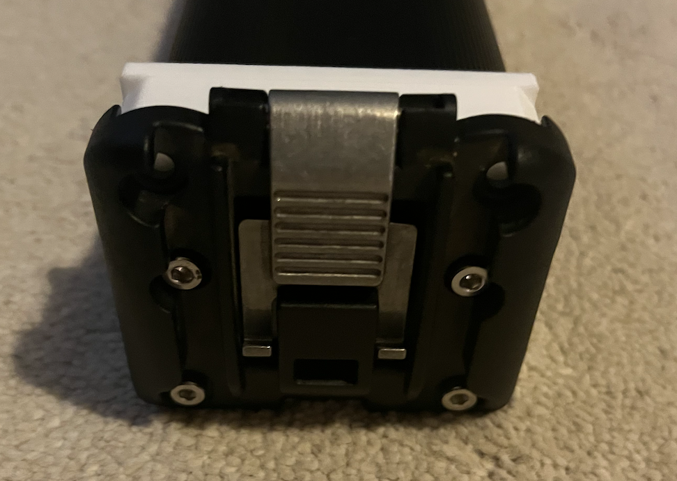

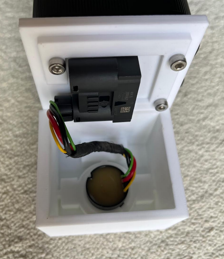

I just tested the 400wh battery with the connectors that I mentioned in this thread, and the bike powers on and off, and displays the battery charge.
I can't test ride it yet as I have not finished the mounts.
The 400wh battery has been used with the Crestline with a Bosch Gen 5

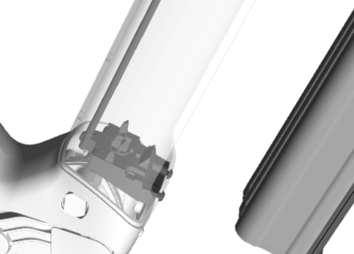

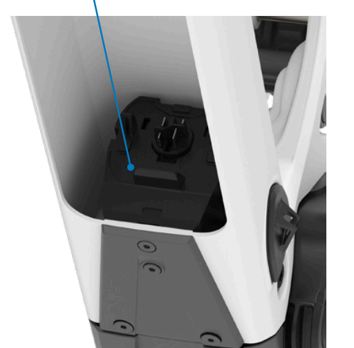

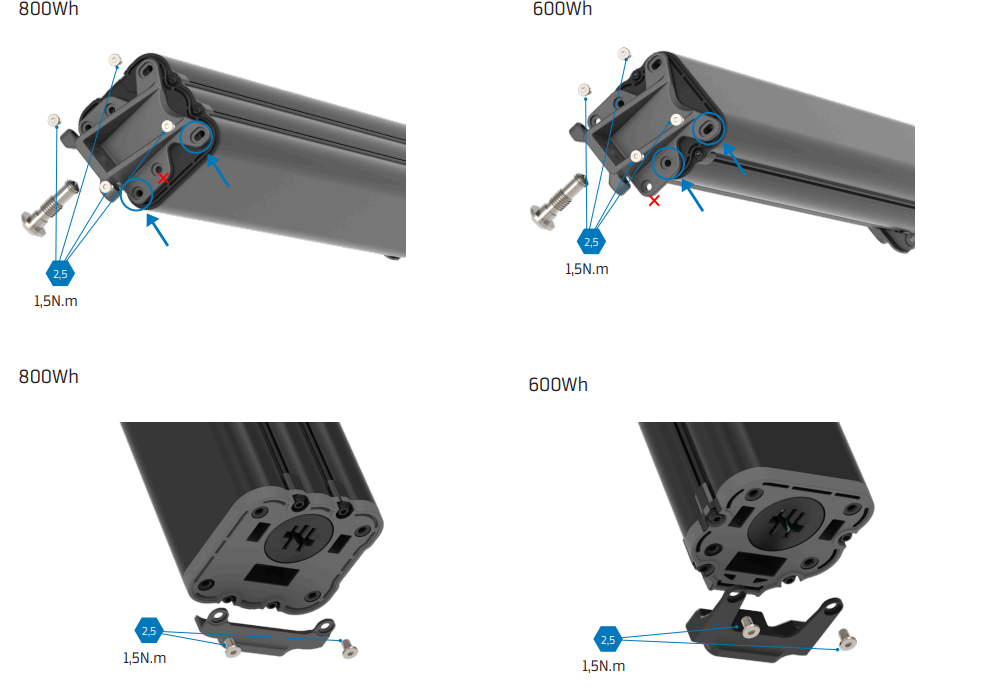

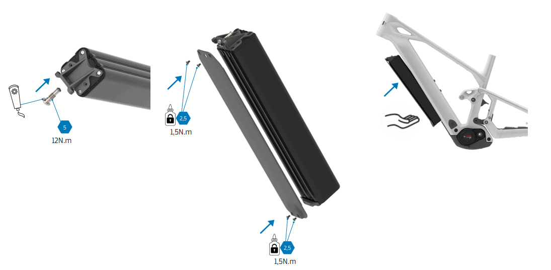

@ Davzell - are you able to use a 600wh battery with your bike - can you get a smaller mount ? The trek rail can use a 600wh battery, so I was going to make the top mount smaller by designing it for the holes of the 600wh battery, or does your top mount accept both 600wh and 800wh batteries ? To give you context, this is the top base mount, with the holes roughly in place for the 600wh battery.
yes my bike support 600 and 800wh battery. There is two different support
there is
fixed on the the cover
the connector to battery between Mondraker and treck seems to be similar
"The top of the battery does not attach the same way between Mondraker and Trek, but if the battery with the 3D part has the same length and the same holes as the 800 Wh battery, it will fit easily.

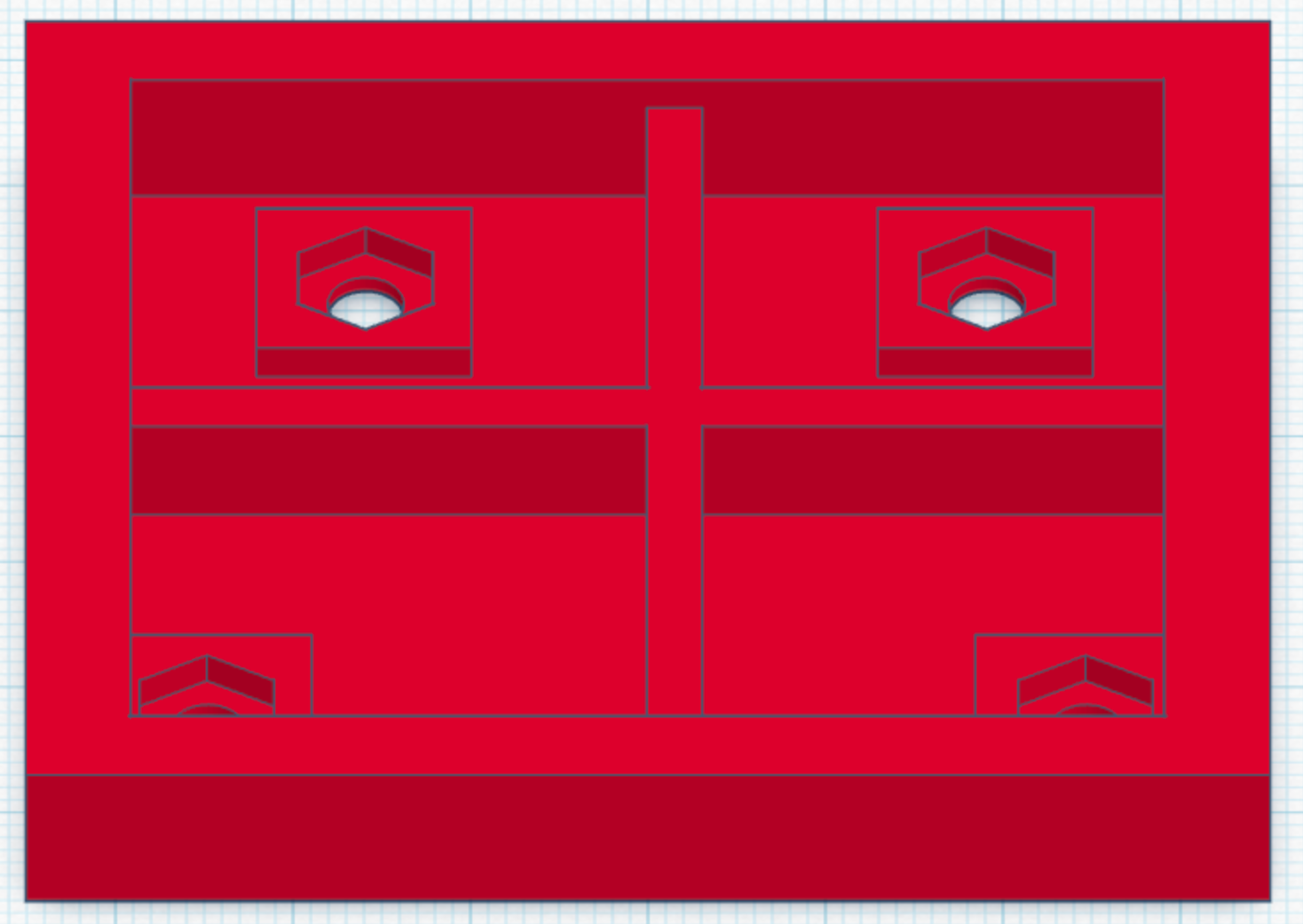

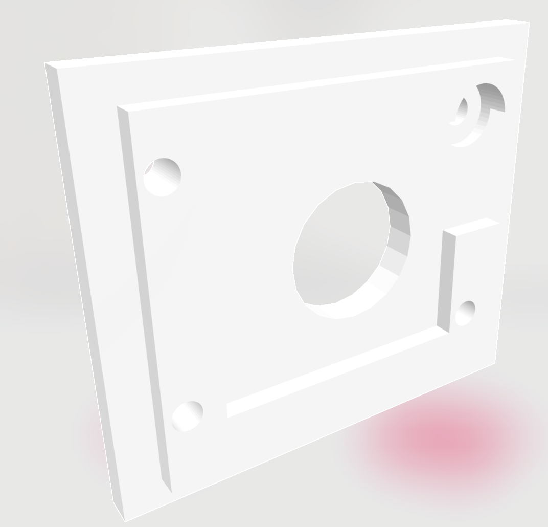

4th part completed.
It is too dark to safely test it so I will have to wait until tomorrow....

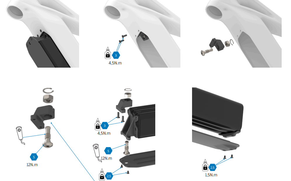

I have ordered a new battery cover which hopefully arrives later in the week, so once that arrives I can position the holes in the lower base, and it will be finished.

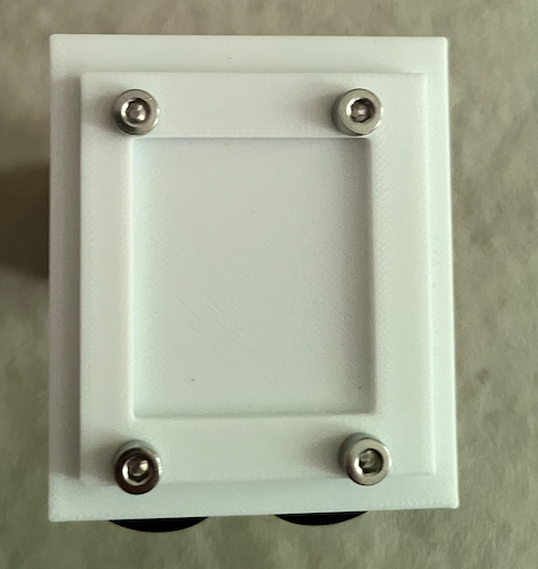

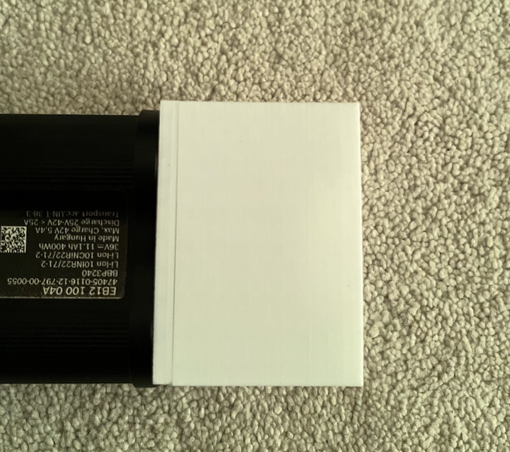

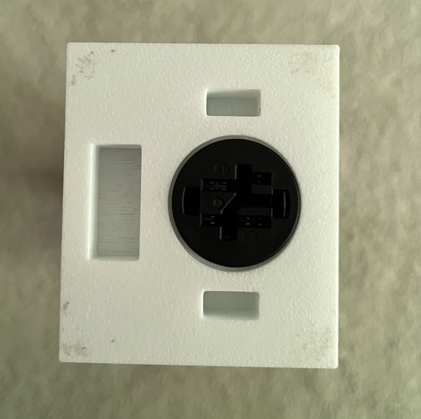

Test ride completed - battery works, and it fits well with no movement.
I need to wait for the battery cover to arrive and I can then accurately line up the holes on the lower base.

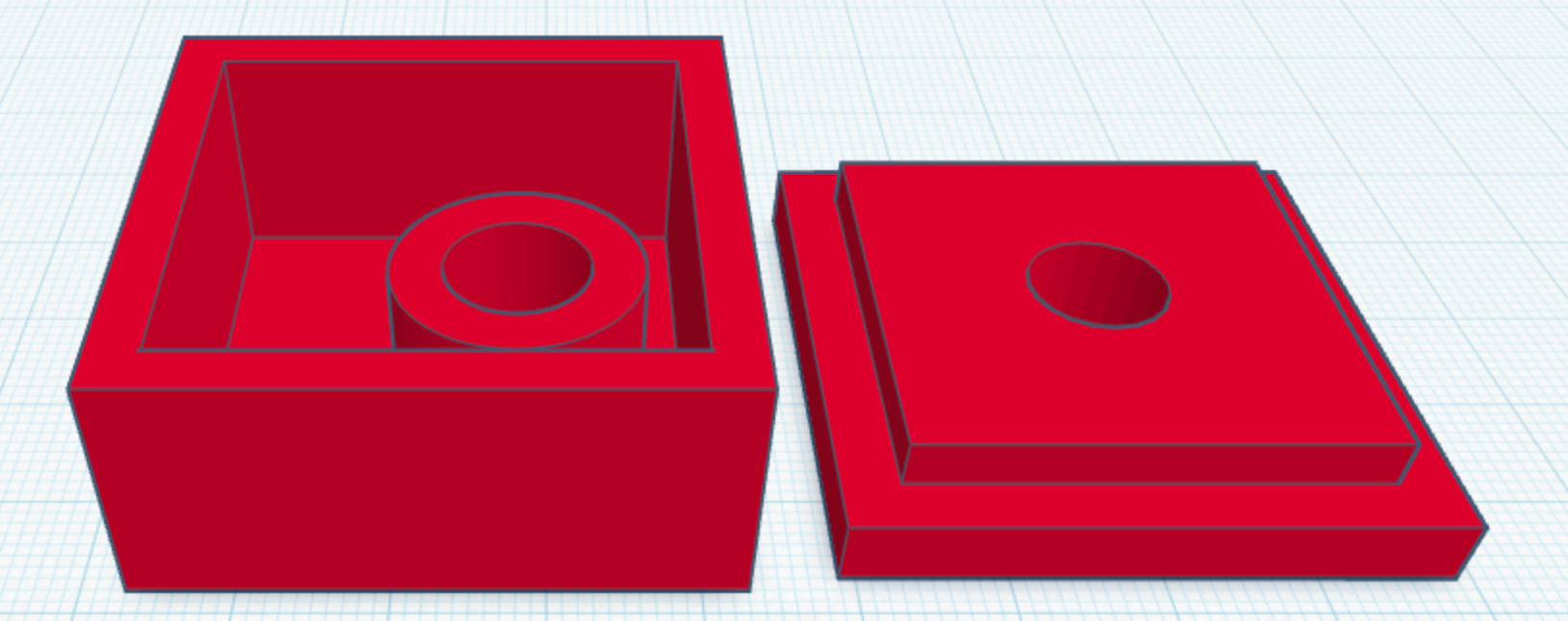

At the moment the boxes do not screw together - I will let people add this feature if they want it. I am planning to glue mine together as I see this as a permanent solution.
I will share the designs when finalised, so that people can print themselves, improve the design, adjust to their bike frames, etc.
I need to find out how to share the designs so that I am not responsible for injury / damage to bikes / etc.- If anybody know how I can do this, please let me know.

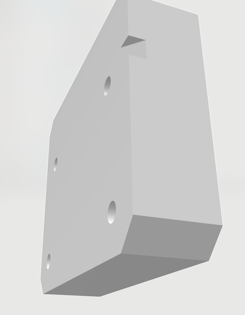

An example of a tweak for the Trek top bracket is the notch in the base of this part, and the shaping of the corners.

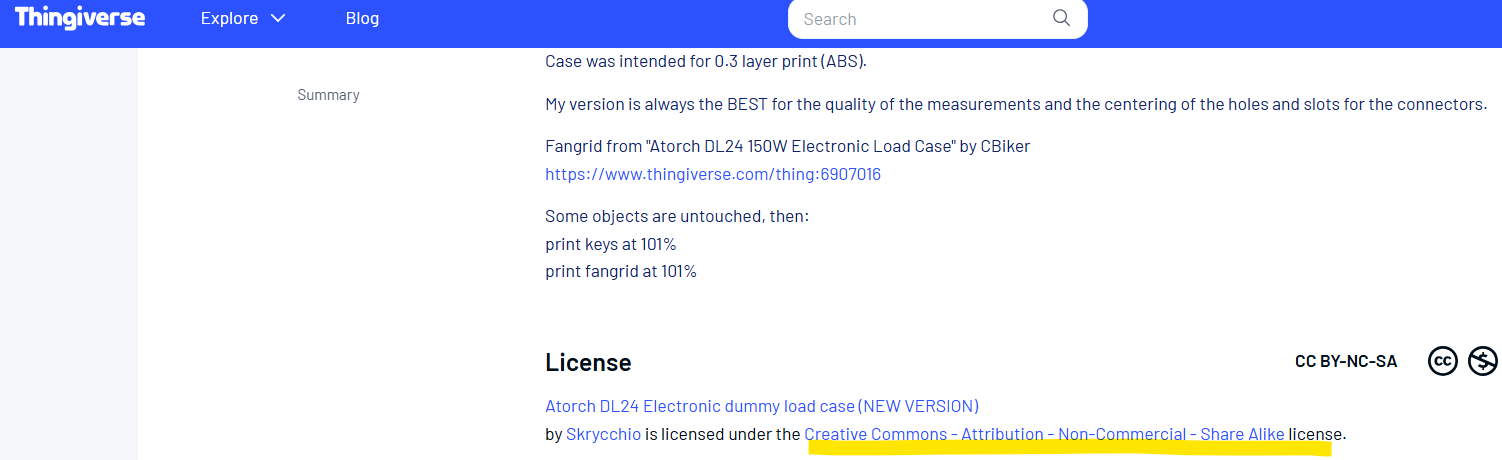

I see this on shared plan.
Add disclaimer to your sharing like this "
Disclaimer
This 3D model file is provided “as is,” without any warranties, express or implied, including but not limited to fitness for a particular purpose, safety, durability, or compliance with any technical or legal standards.
By downloading, printing, or using this file, you acknowledge and agree that:
  • You are solely responsible for verifying the suitability, safety, and performance of any printed object.
  • The creator of this file shall not be held liable for any damages, injuries, losses, or issues arising from the use, misuse, modification, or distribution of this file or any object produced from it.
  • This file is shared strictly for personal, educational, or experimental use, and not for critical, structural, medical, food-contact, or safety-related applications.
Use at your own risk."

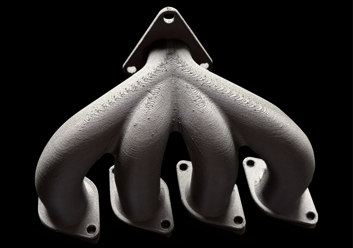

P.S I am now looking at printing with PA12-GF by SLS using this company:
SGD | Expert SLS Nylon 3D Printing Service - Fast Turnaround
Much more expensive - around £75 to print a set of mounts, but the strengh in all planes seems sensible.
