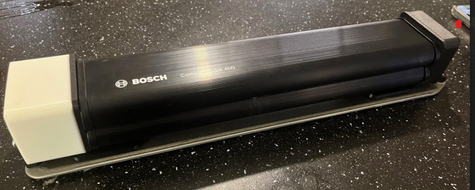

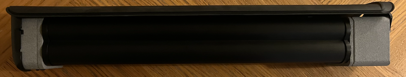

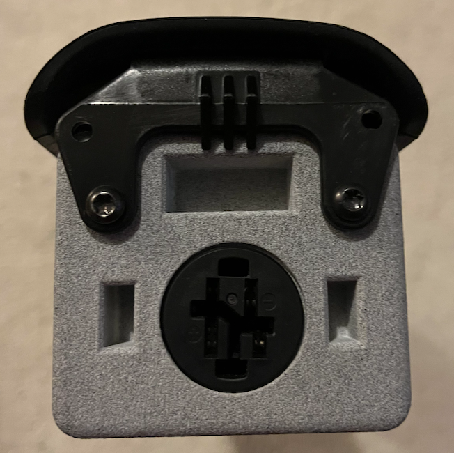

I can't wait to test all this, I'll receive the 3D parts tomorrow.

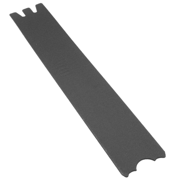

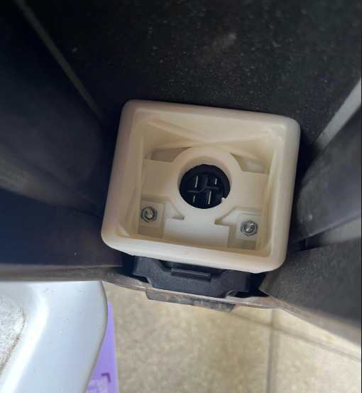

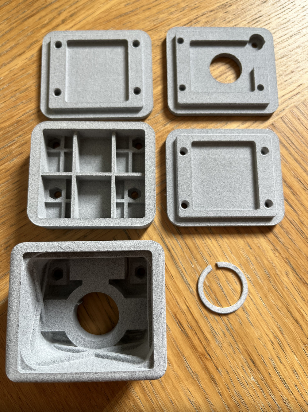

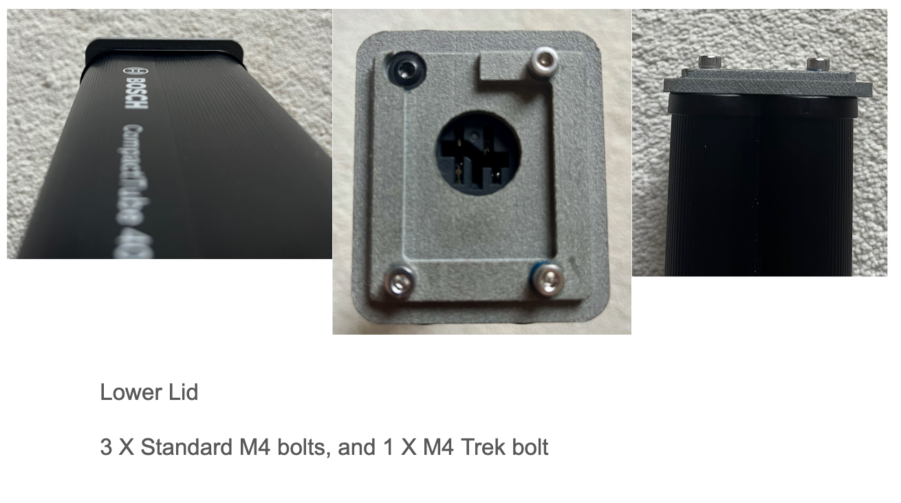

You will need to check the lower lid - I made a tweak that removed one of the holes by accident - now corrected. I need to reprint it myself, but waiting for the parts to arrive so I know they all fit together using this new printing process.
I had seen it on the plan, but I didn’t think to ask if it was normal… I’ll drill a hole if needed, just to check the assembly.

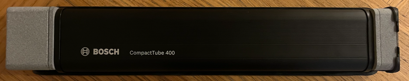

Mine also arrived today - now wish I got it dyed black. It all fits together very well. The o ring might be a bit thin in this material, so as I have to order another lid, I will make a thicker o ring at the same time - although the power adaptor and o ring will need to be glued to prevent rattling, which makes me wonder whether I need an o ring at all - I have updated the long post, and flagged that the o ring is optional, as one could simply glue the BCH3901 in place.

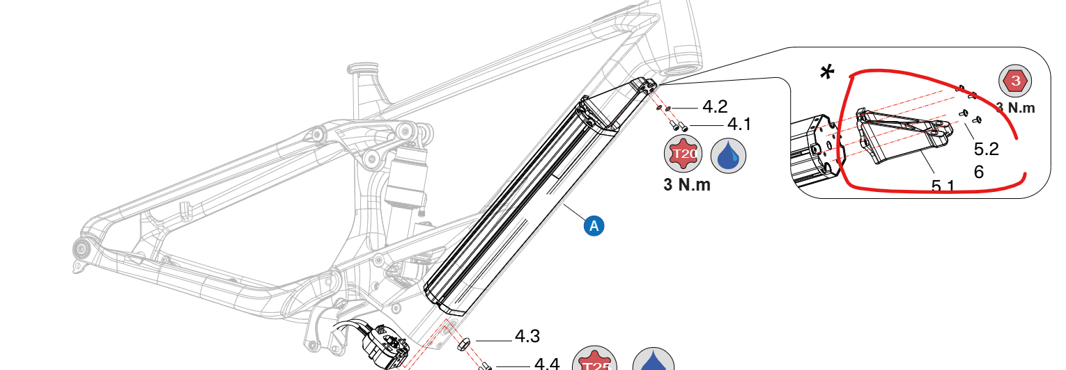

Wondering if this could be adapted to the Mondraker Crafty systems. But since I already bought the 600wh I'm a bit hesitant if I need the 3rd battery :ROFLMAO:
My hope is that it works on all bikes that are designed for the 600wh battery and the 800wh battery. My mounts are designed to match the 600wh battery, so if the bike comes with different mounts for the 600wh battery, those will need to purchased.
It might work on bikes that are only designed for the 600wh battery, for example the Vala, but probably not. The 600wh battery is 71mm wide, and it appears Santa Cruz have focused on making the frame as svelt as possible.
The 400wh battery is 75mm wide, and the mounts are 70mm wide.
It might work on bikes that are only designed for the 600wh battery, for example the Vala, but I have no way of testing.
I think it’s compatible with all electric bikes that can accommodate either a 600 Wh or 800 Wh PowerTube battery that can be removed via a cover.
Since the battery is mounted to the cover, the adapters should work in each case. However, you will indeed need the 600 Wh battery adapters if the cover doesn’t support both installations directly, like on your Trek.
For e-MTBs with an internal 600 Wh battery that cannot fit an 800 Wh battery (like the Vala and Orbea Wild), I think it could still work since the lengths of the 600 Wh and 800 Wh batteries are identical. I imagine it’s the width of the 800 Wh battery that causes the issue.
Looking at the integration on the Orbea Wild, it’s similar to my setup on the Mondraker on the upper part. You’d still need to check the alignment of the mounting holes.

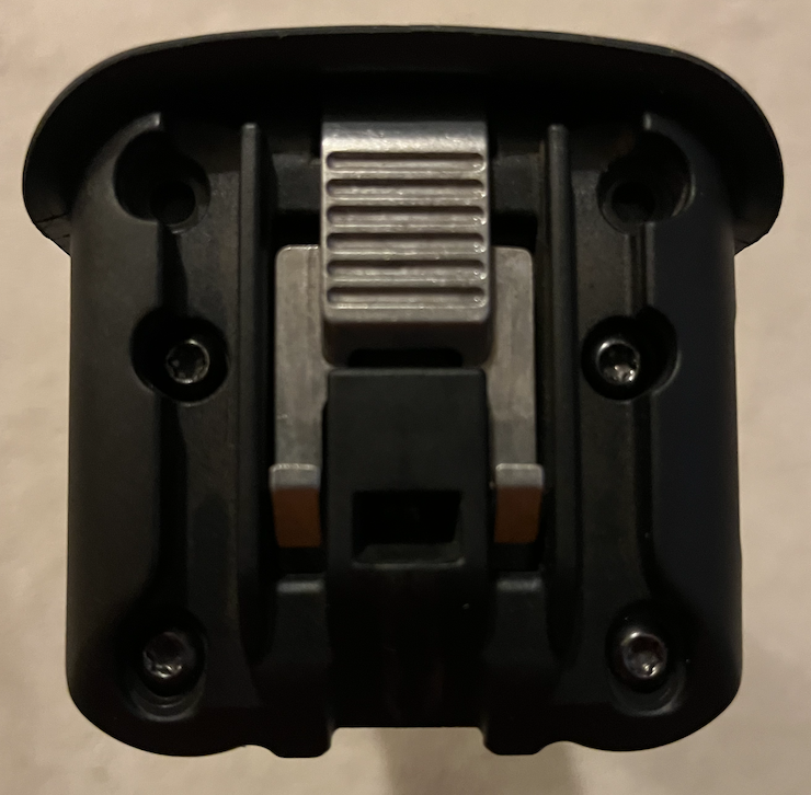

Where there might actually be a problem is with the locking mechanism at the bottom.

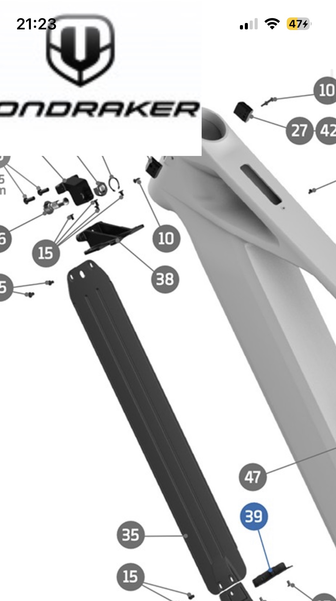

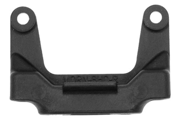

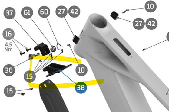

I also a second part number 38 for the front mount.
This way, I just need to unscrew 4 screws (number 15) to remove the entire battery + adapter assembly from the cover, if I want to swap batteries

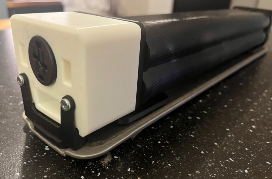

Photos of me putting each section together.

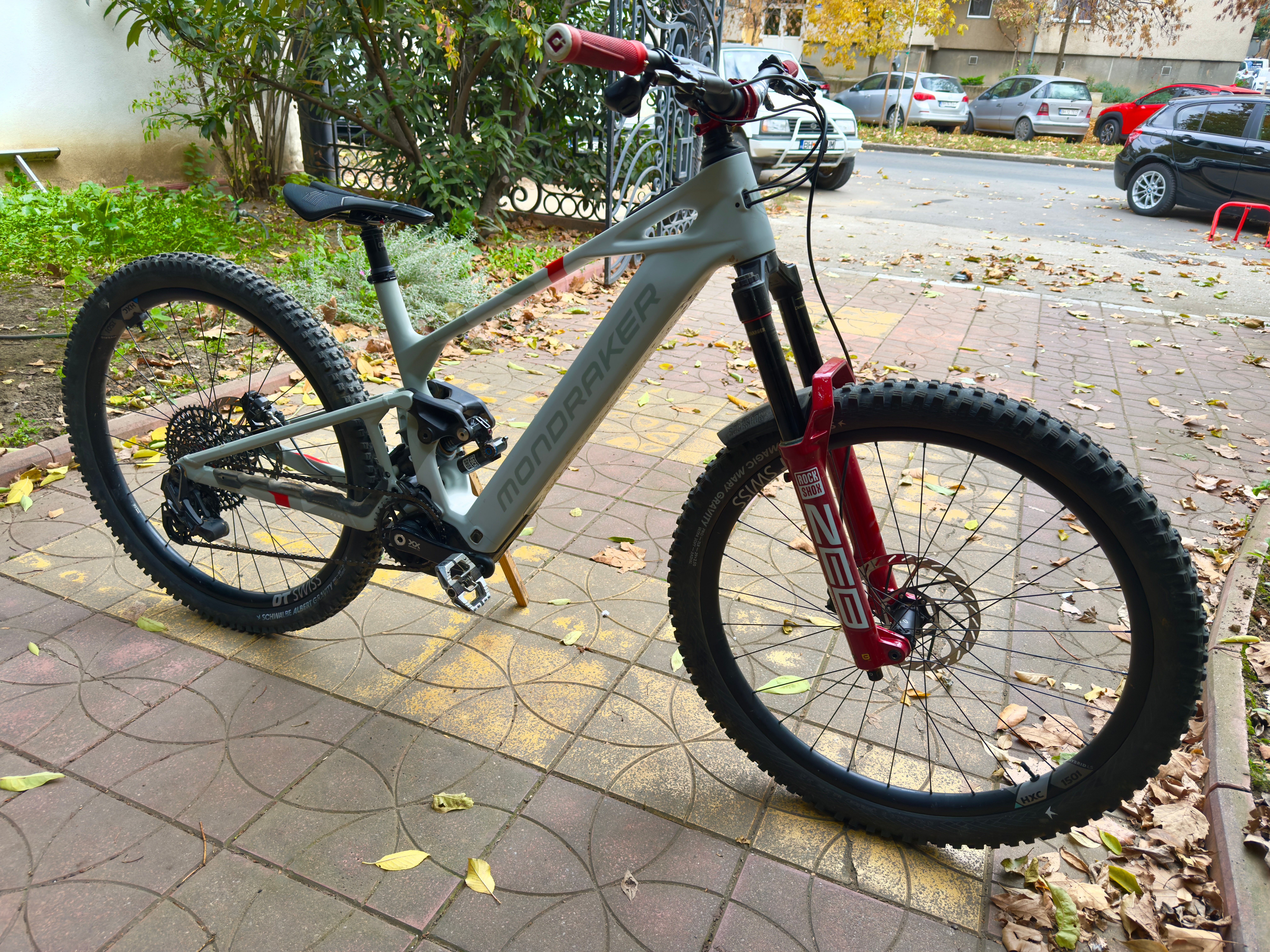

finaly finish to adapt the 400w battery to my Mondraker Crafty. First ride this afternoon to see if there are e difference :)
400w battery with cover, adater, screw,... = 2.5kg
800w battery with cover, adater, screw,... = 4.3kg
Weight total for bike with 400w battery = 23.5kg

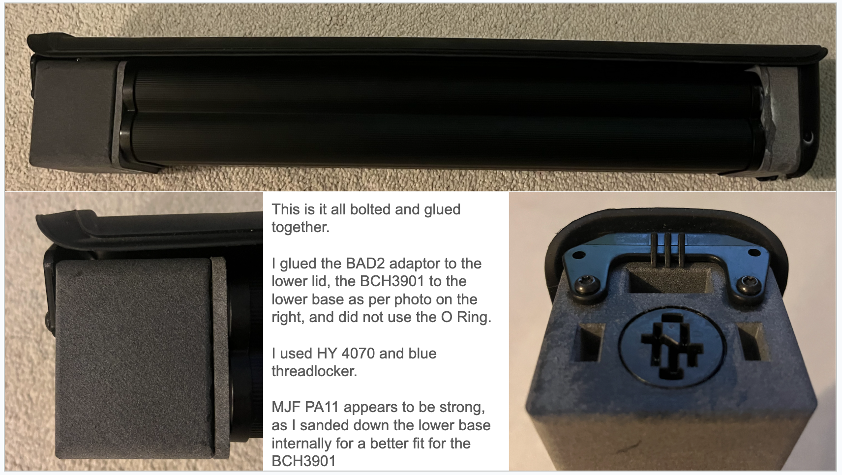

PLEASE NOTE THAT I HAVE YET TO ASSEMBLE THIS WITH MJF PA12 PARTS. WHEN I HAVE, I WILL MAKE ANY REQUIRED CHANGES TO THE BELOW POST AND DELETE THIS MESSAGE.
THE TESTING OF THE PARTS WITH A MOONDRAKER BIKE ARE HIGHLIGHTING SMALL DIFFERENCES IN DESIGN BETWEEN BIKES, SO I HAVE CREATED A TREK RAIL VERSION OF THE LOWER BASE AND A UNIVERSAL VERSION WITH SLOTS IN THE LOWER BASE.
Weight
Battery_______2,043 grams (Plummet above)
Mounts________161 grams (Scales)
Bosch BCH3901___ 25 grams (Manufacturer)
Bosch Adaptor____21 grams (Manufacturer)
Nuts and Bolts____20 grams (Scales)
Glue___________ 2 grams (ChatGBT)
Total_________2,272 grams

Upper Mount - please read the disclaimer
Lower Mount - please read the disclaimer

I highly recommend doing one or two practise assemblies without glue first, so that you understand how the components fit together, and how the new battery fits into your bike. Obviously do not cycle the bike at this point.

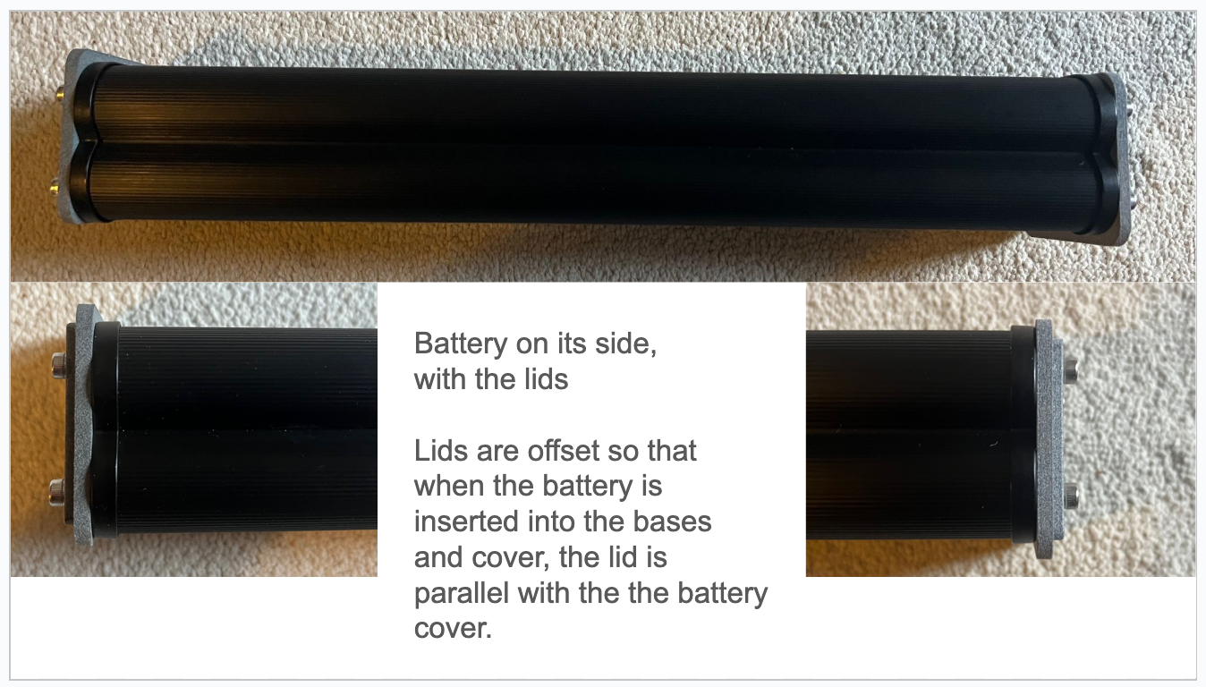

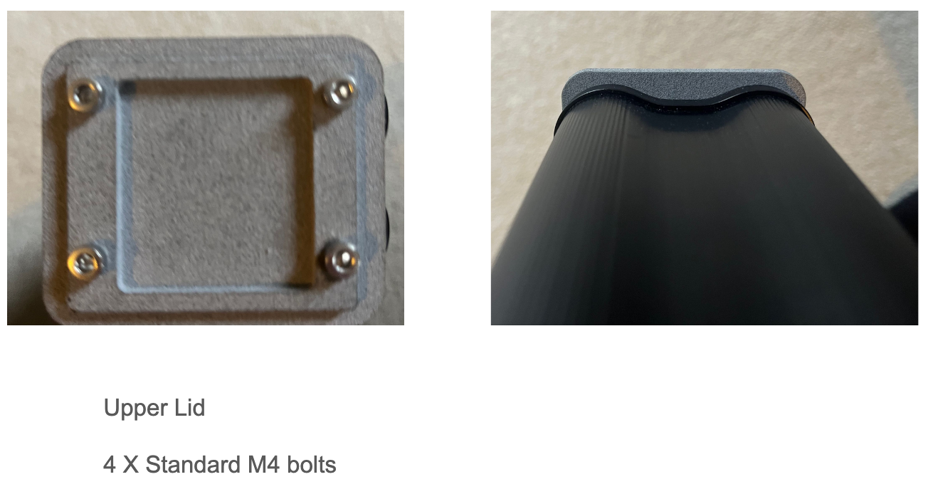

The screenshots below illustrates how the base and lid go together.

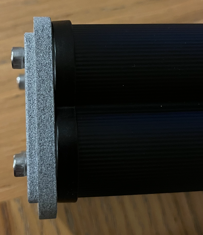

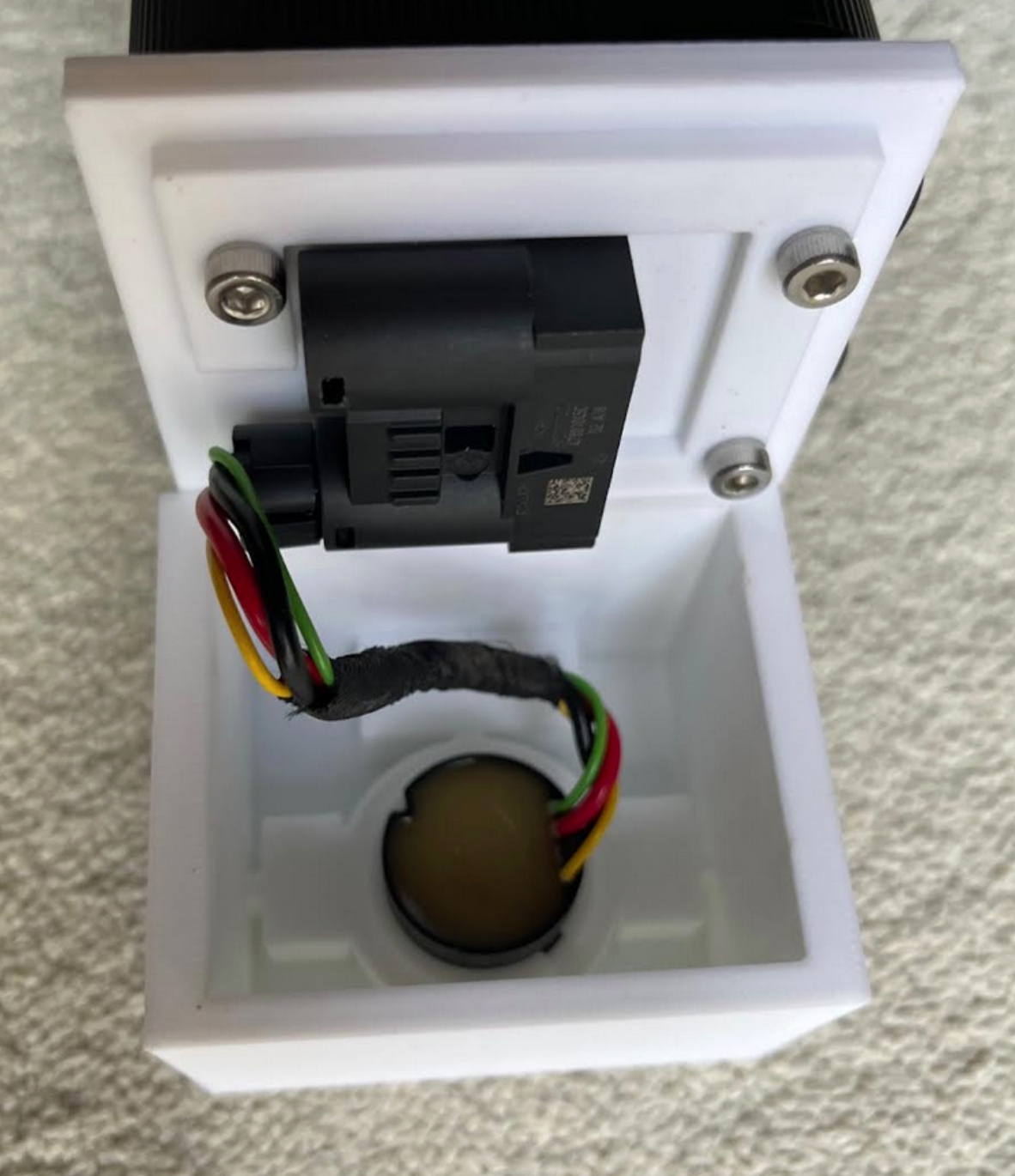

Step 1 - attach the lids to the 400 wh battery at both ends, using the M4 12mm bolts and one screw from the mount that came with the 400wh battery (which lid and hole requires this screw will be obvious, hint: the hole you can't see in the photo below). I recommend using threadlocker because the bases will be glued together, so you will not be able to retighten them at a later date.
P.S. The lids are not symmetrical, so orientate them correctly, so that the battery is horizontal when placed on a flat table. See screenshot 1, that shows how the lid is flush on one side of the battery, and protrodes on the other side of the battery. I have the lids protruding on the flat side of the battery.
Step 2 - slot the cable of the BCH3901 through the big hole in the solid end of the lower base, and hold it in place with the printed o ring. (you could add a dab of glue to hold it in place to stop it rattling) (The o ring is optional as the BCH3901 will need to be glued in place to prevent rattling)
Step 3 - glue the bosch adaptor to the lower lid, as per the 2nd screenshot below.

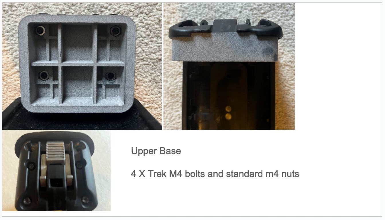

Step 4 - put the nuts into the lower and upper bases, and attach to the external fittings - in my situation, with the Trek W1052364 screws, attach the Trek W5318794 and Trek W5322238.
Step 5 - place the battery with the lids already attached, into the battery cover with the bases attached, and glue the base and lids together.
P.S Steps 4 & 5 are going to be a bit challenging, and will vary by battery cover design - I am not an engineer, but it should work if you're patient, and think about what you're doing.

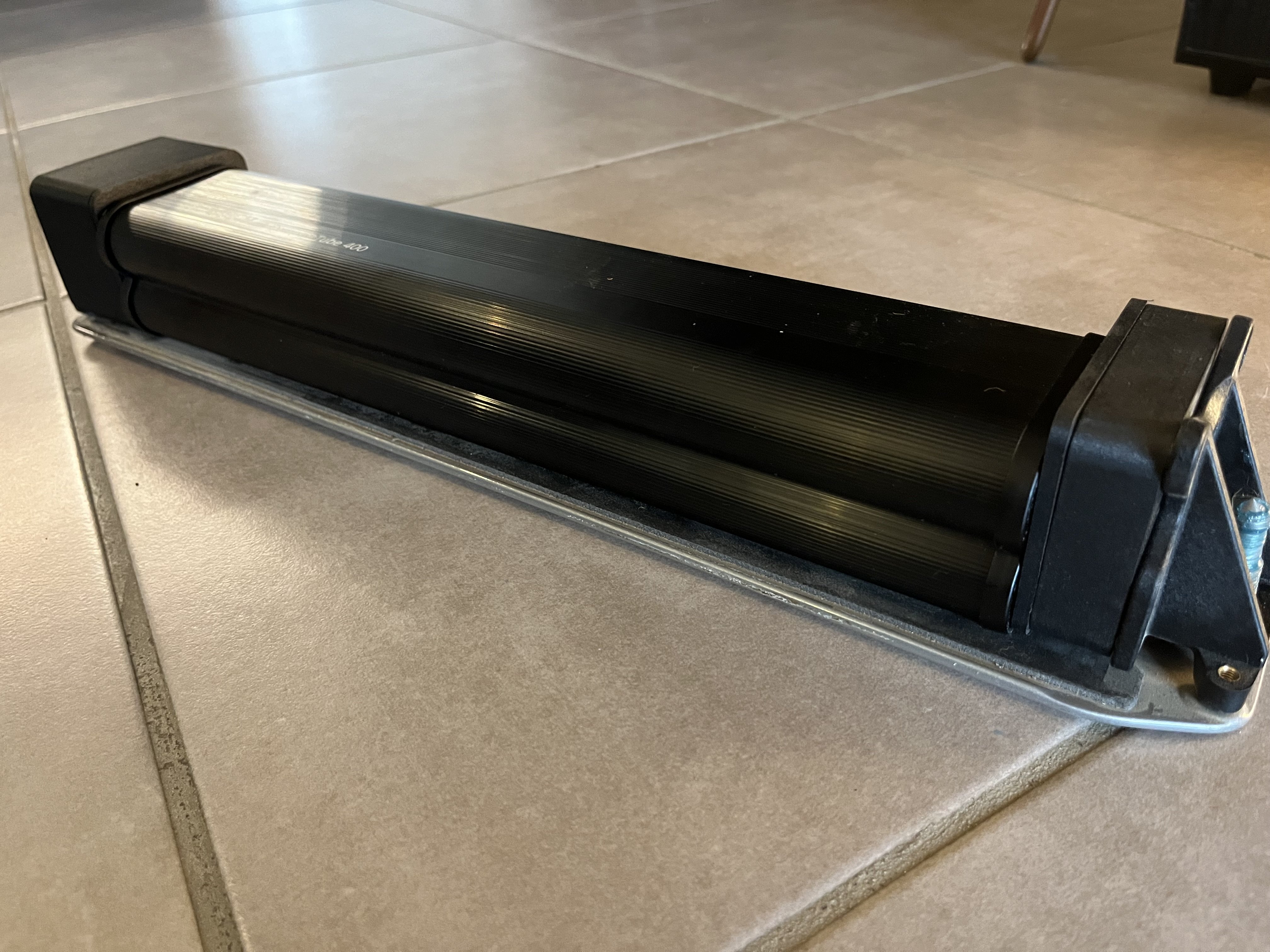

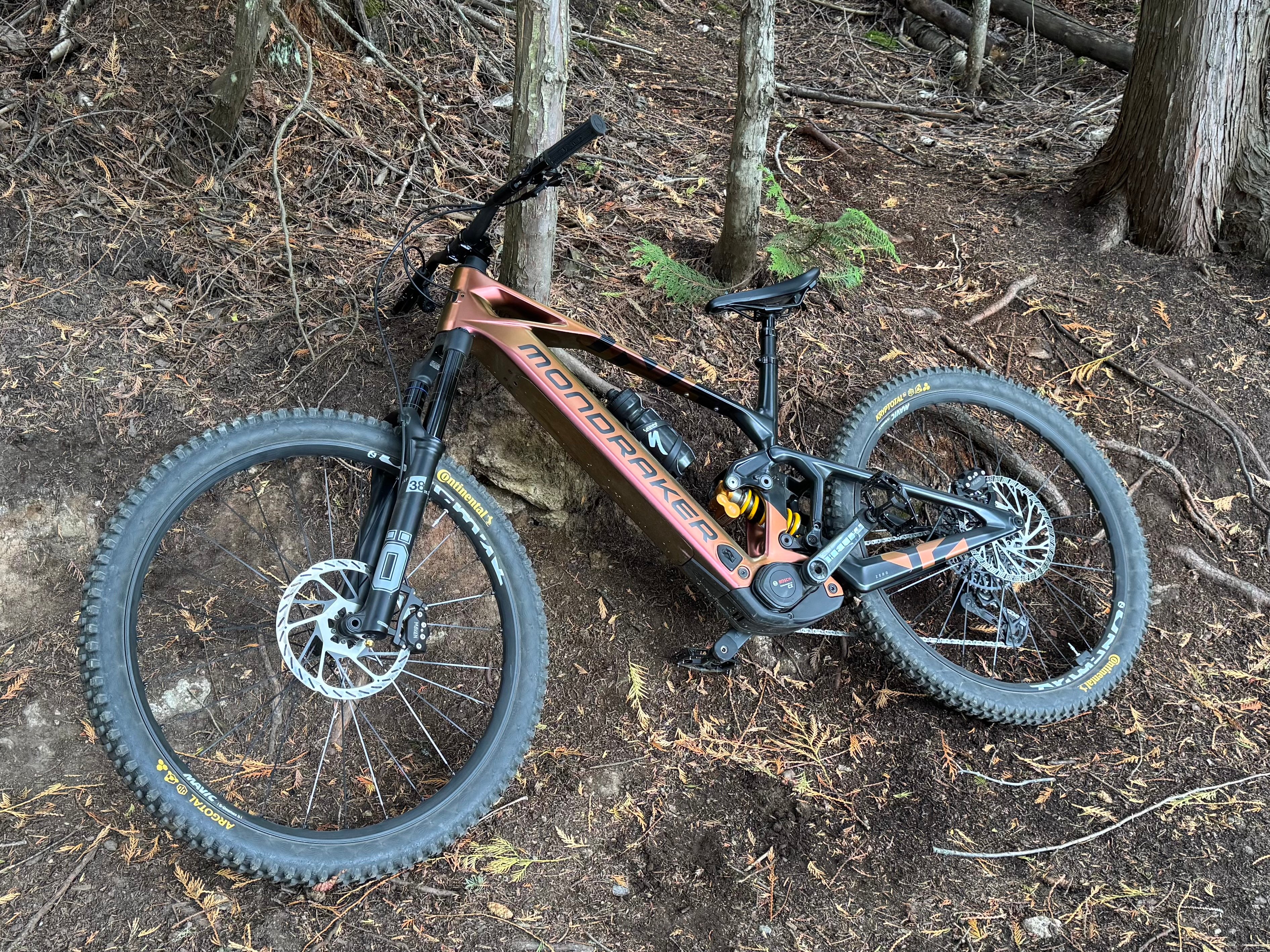

Odd, my size large crafty with a coil shock, dh tires, heavy alloy wheels, 223mm rotors, and a 600wh weighs 22.5 kg/49.5 pounds.
Odd, my size large crafty with a coil shock, dh tires, heavy alloy wheels, 223mm rotors, and a 600wh weighs 22.5 kg/49.5 pounds.View attachment 171238
Yes, strange. The weight announced by Mondraker is 24.4 for the RR 2025
Minus 1 kg because you’re using the 600 battery, so it should be 23.4
Maybe you changed other parts? And that: did you weigh it yourself?

Yup, calibrated luggage scale. It tracks with my other bikes, same weights as on friends scales.
Only thing I can think of is that the ohlins 38 is lighter than a fox or zeb, carbon cranks, carbon bars, wolf tooth dropper, etc.
As for the mondraker advertised weights, it is 22.9kg/50.5 pounds for a crafty xr with the heavy (and not so great) onoff dropper/stem/bars/grips.

My primary use of this crafty xr is bike park self shuttling, and I could have one battery charging at the van while I'm riding the other :unsure:.
Good price for a 2025 XR! I actually hadn’t thought about the rear triangle, but as soon as you switch to a carbon rear triangle, you lose 600–700g.
I guess 22.5 is without pedals right?
My R has been quite well on a diet ( Carbon bars & cranks, carbon wheels, full X0 trasmision light, One Up dropper & lightrr saddle, Alloy chainring) not with intention but still there.
With the 600wh, mine is 22.6 kg without pedals. The rear triangle and link is 550 grams acconding to Mondraker but unfortunately they cannot be purchased, but theoretically going full carbon with a few other small bits ( lighter discs?!?) I could reach 22 kg in full enduro setup.
