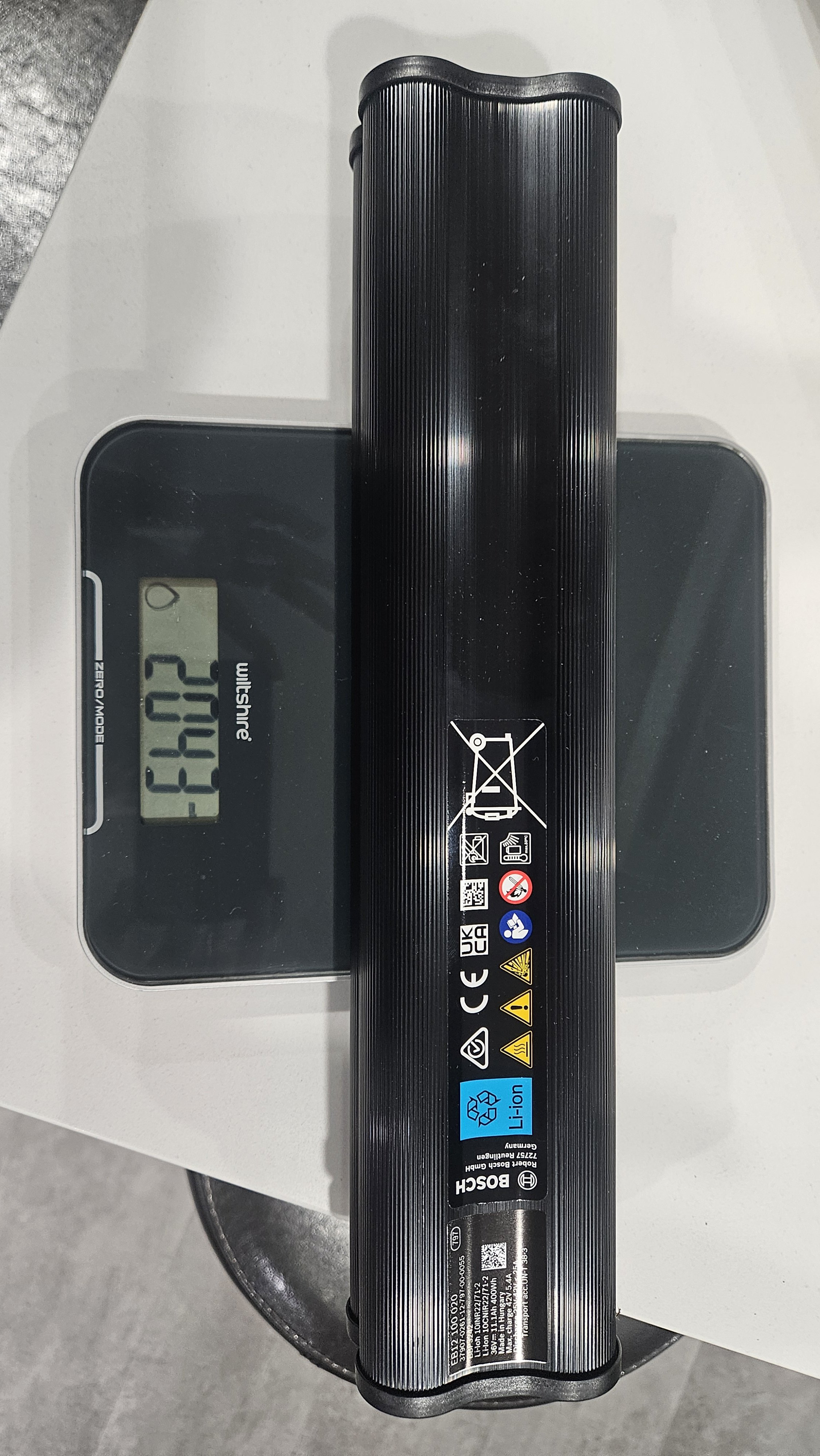

Do you have the weights of each battery?
I’ve been toying with doing this on my Gen 4 pivot, to try and bring the weight down a touch. I think I’ll be able to go 750-500.
600wh 1kg more.

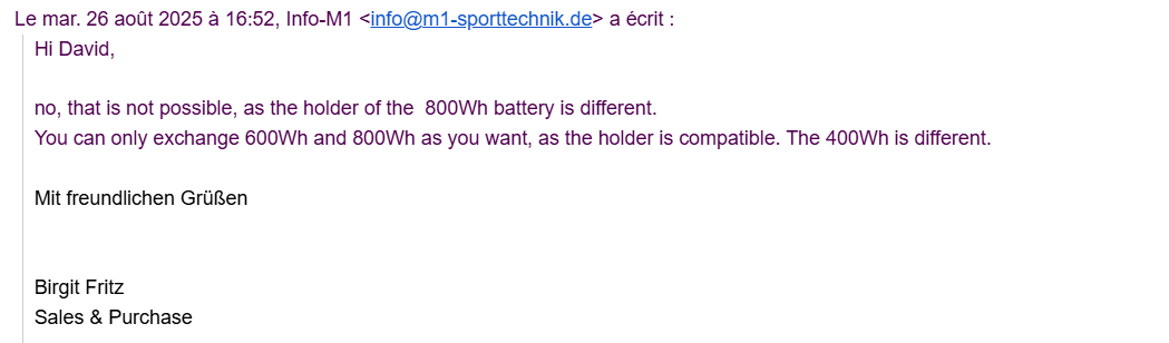

I think the only realistic solution is the 600wh or Powermore 250 until Bosch make a powertube 400wh, which may never happen. Crestline sold 10 adaptors with 100 bikes ( I think ) indicating reasonable demand, but perhaps not enough demand for Bosch to be interested.

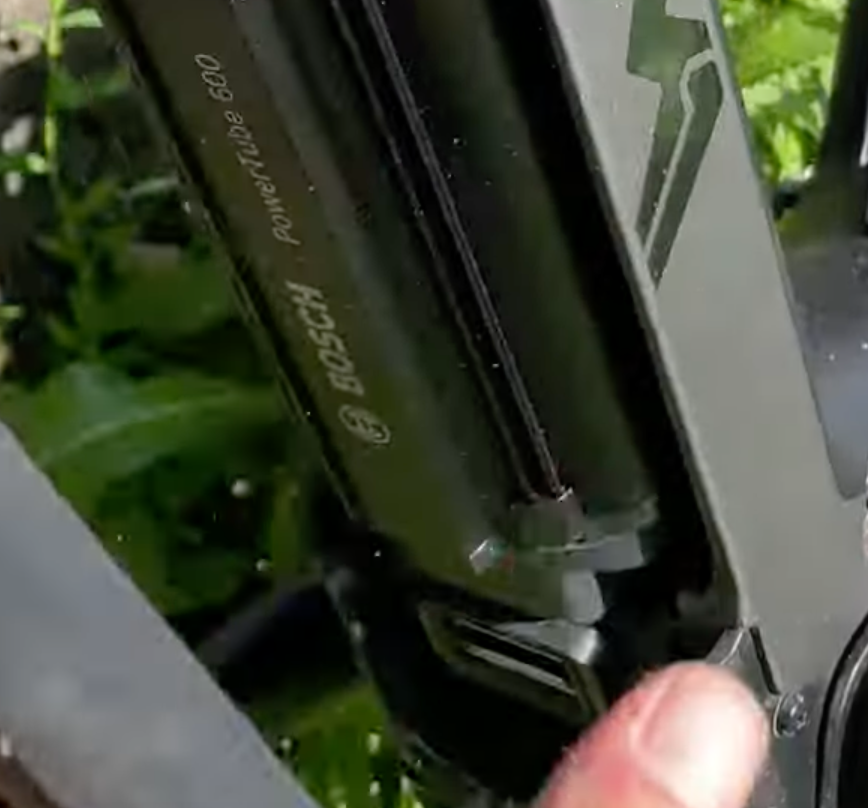

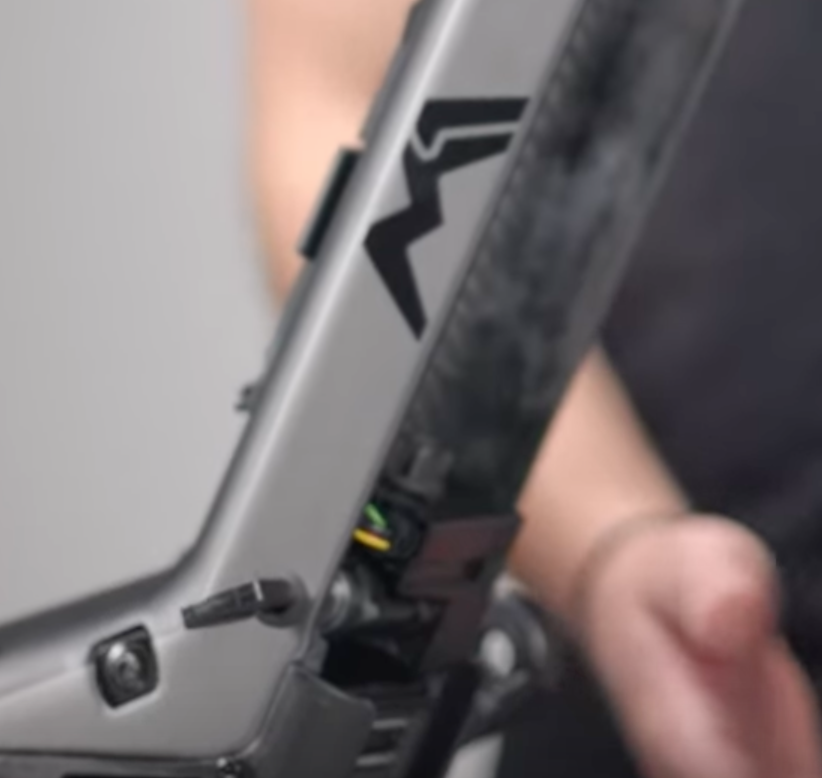

Thanks for the photos. So, where did you buy the aluminum mount? From Crestline directly? Because I don’t see it on their website.
For my bike, the battery is mounted directly on a cover that can be completely removed from the bike. It’s not the same system as Crestline.

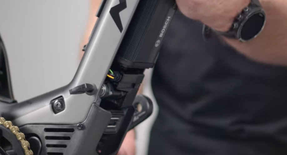

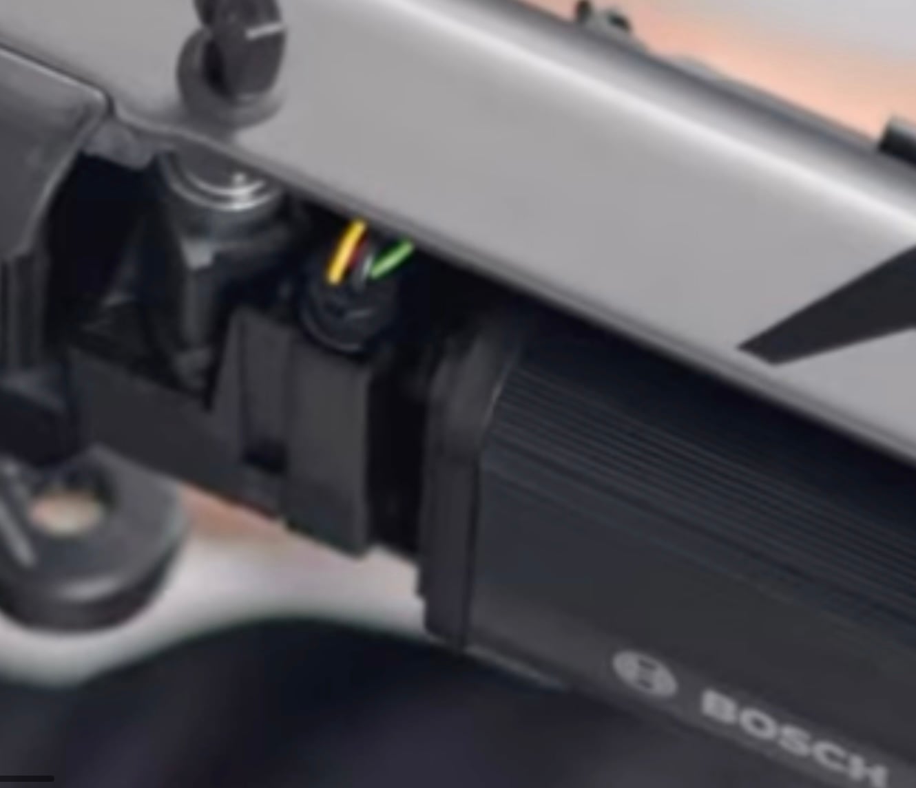

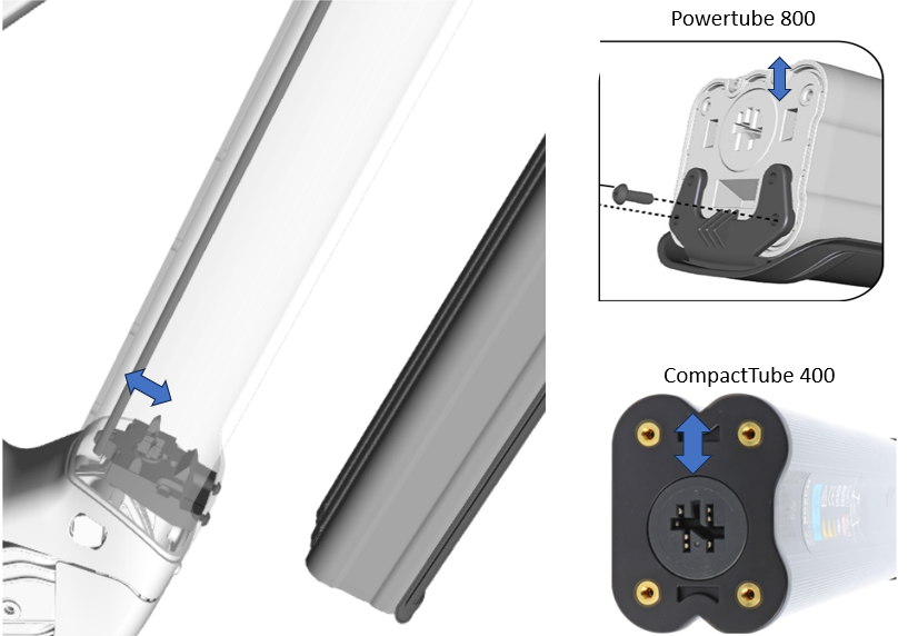

This could perhaps replace part 1 in the plan below, where a replacement piece would need to be created for that section.
I also see a second problem: on the Crestline, it seems that the battery connection to the bike is via a cable, which means it can move.
On the Mondraker, however, it’s a fixed connector.
Since the connector on the Compact 400 battery is not at the same position as on the 600/800 batteries, it won’t be possible to connect it without an intermediate cable.

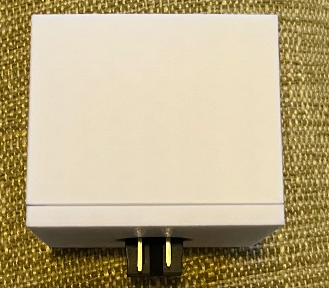

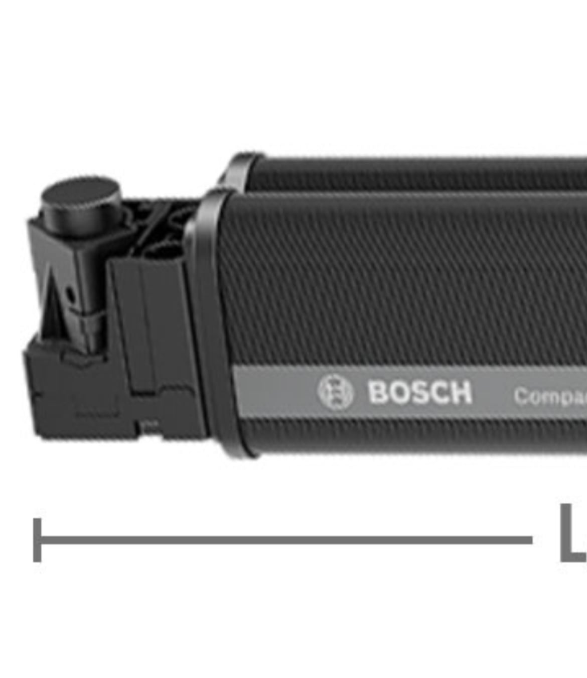

Plummet is possible to you to take a photo of the 2 batteries on Connector side ?​
Yeah plates are from Crestline. The plug is on a wire and plus in once the battery is installed.
here is a 800w, Compact tube400 and 600w.
i think the I think the socket is lower than 800/600 battery
In my case, this is a problem because on Mondraker, the connection to the battery is fixed. It's not a cable to connect like on Crestline bikes. So I think I'm stuck, as there doesn't seem to be a linking cable available from Bosch.
Yeah that would be a challenge.
The Pole has a similar set up. It was fast battery removal but limited adjustment for when the battery terminals get a nit worn and loose. I had battery connection issues on the Pole and it was always that damn fixed connector

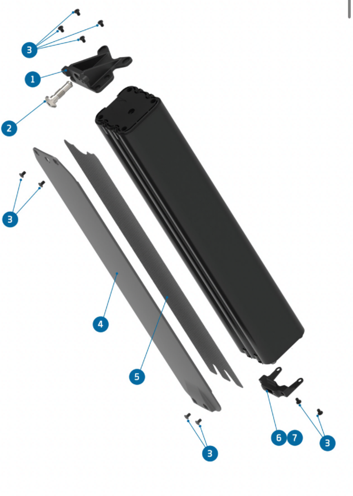

Thinking it would need some additional parts such as these...
I would be interested in buying 3D parts, but it would be helpful to understand what a high price is ?

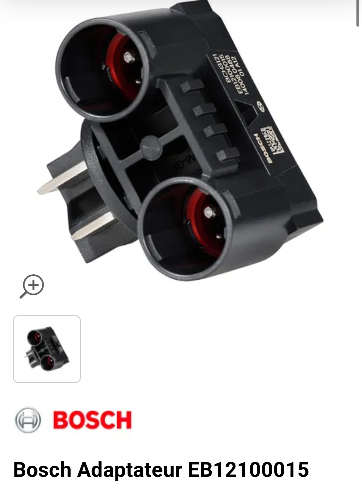

The battery has a female socket, and the fixed connector where the battery plugs in (at least on my bike) is a male socket. So this cable alone won’t work.
However, maybe by adding this adapter, there could be a way to make it work.
But honestly, I feel like it’s a bit too much of a ‘DIY hack’ just to get to the result
I have a Trek Rail Gen 5. which uses these attachments with the 600/800wh.
Hoping to create a power mount which is about 6cm long, and then the other end about 1cm.

Looking at your bike’s layout, it seems to be made the same way as mine. I think we’ll have an issue with the height of the battery connector. On the PowerTube 800/600, the connector is located at the very top of the battery’s front face. On the CompactTube 400, if we orient the battery the same way, the connector will be at the bottom. As a result, we can’t make a direct connection to the port on the bike.

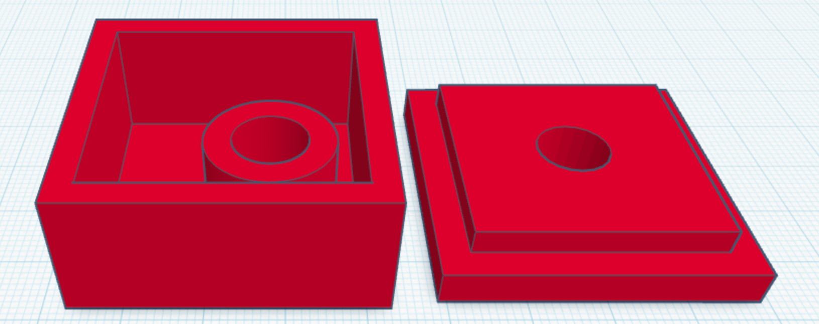

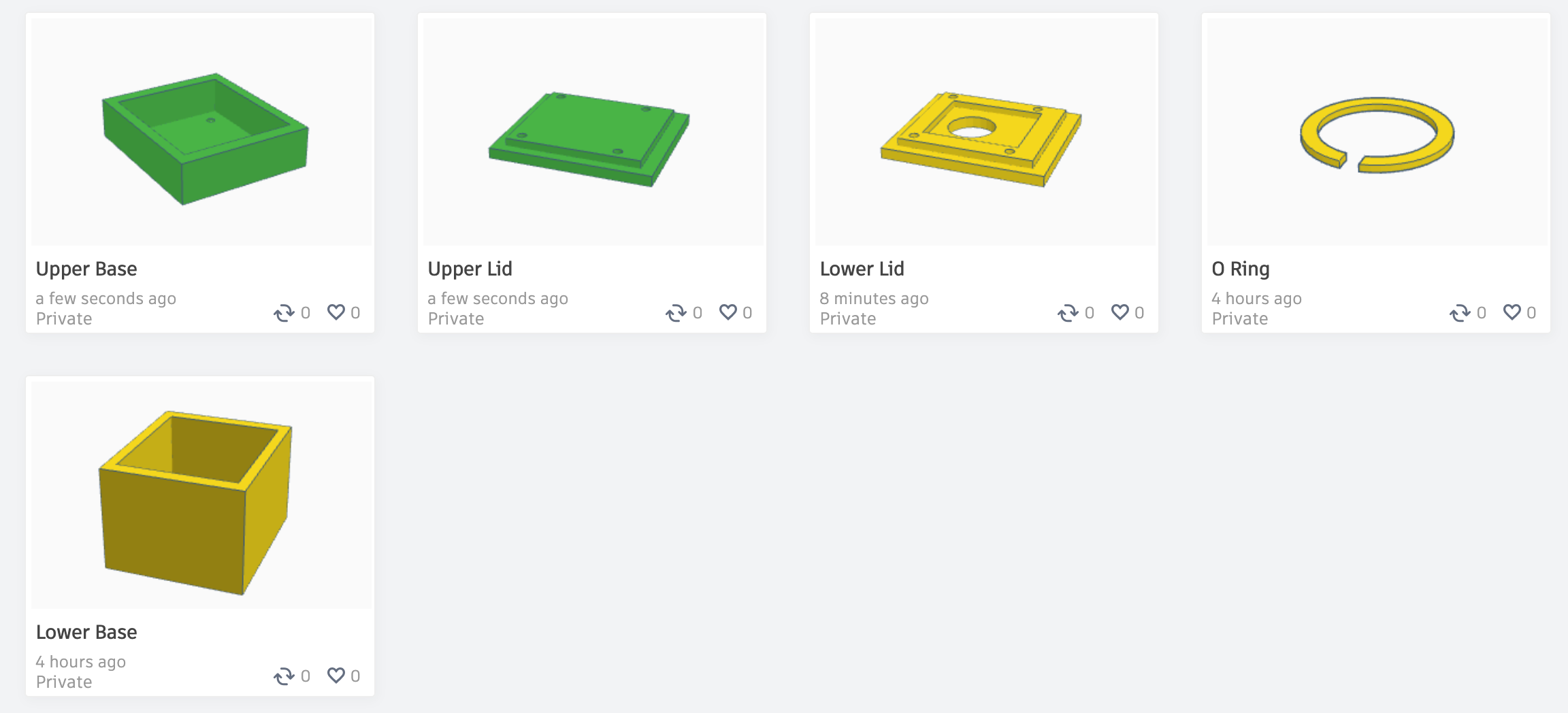

I am expecting to make a mount which attaches to the bosch 600/800 power mount in the bike, which I believe to be standard due to the 600/800 battery, and then connects to the 400 battery, at an offset. I am new to 3D design and printing, so I expect some trial and error. I am going to make it in PLA filament first, and then ASA filament when I am happy with the design.

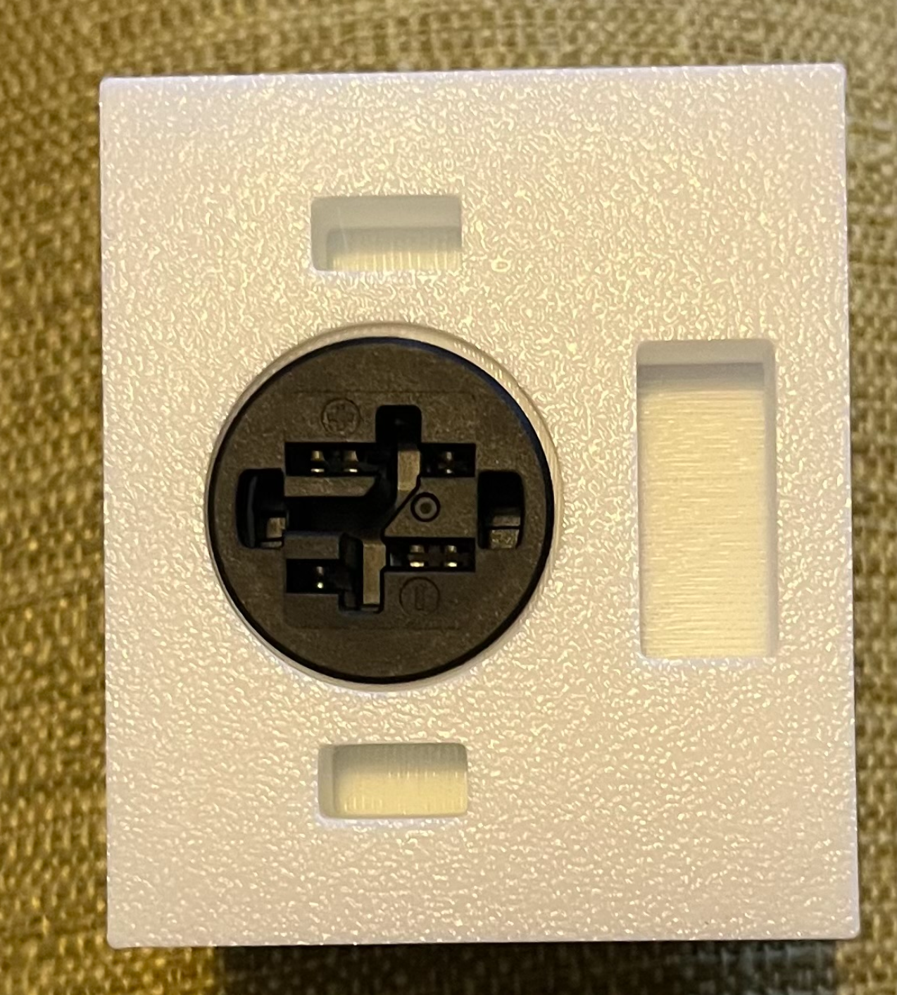

This is a first attempt of the design after a couple of hours. I will need to measure everything, and improve the design, but gives you some idea of my current approach. If I can get a functional design I will be happy, and perhaps someone else will be able to optimize it. The BAD 2 adaptor will go into the lid, and the BCH3901 will go in the box.
Ok, I also think that the solution for the sockets that don’t line up at the same height is the BAD 2 adaptor and the BCH3901. Can’t wait to see if it already works with just the battery + adaptor. And then the 3D mounts

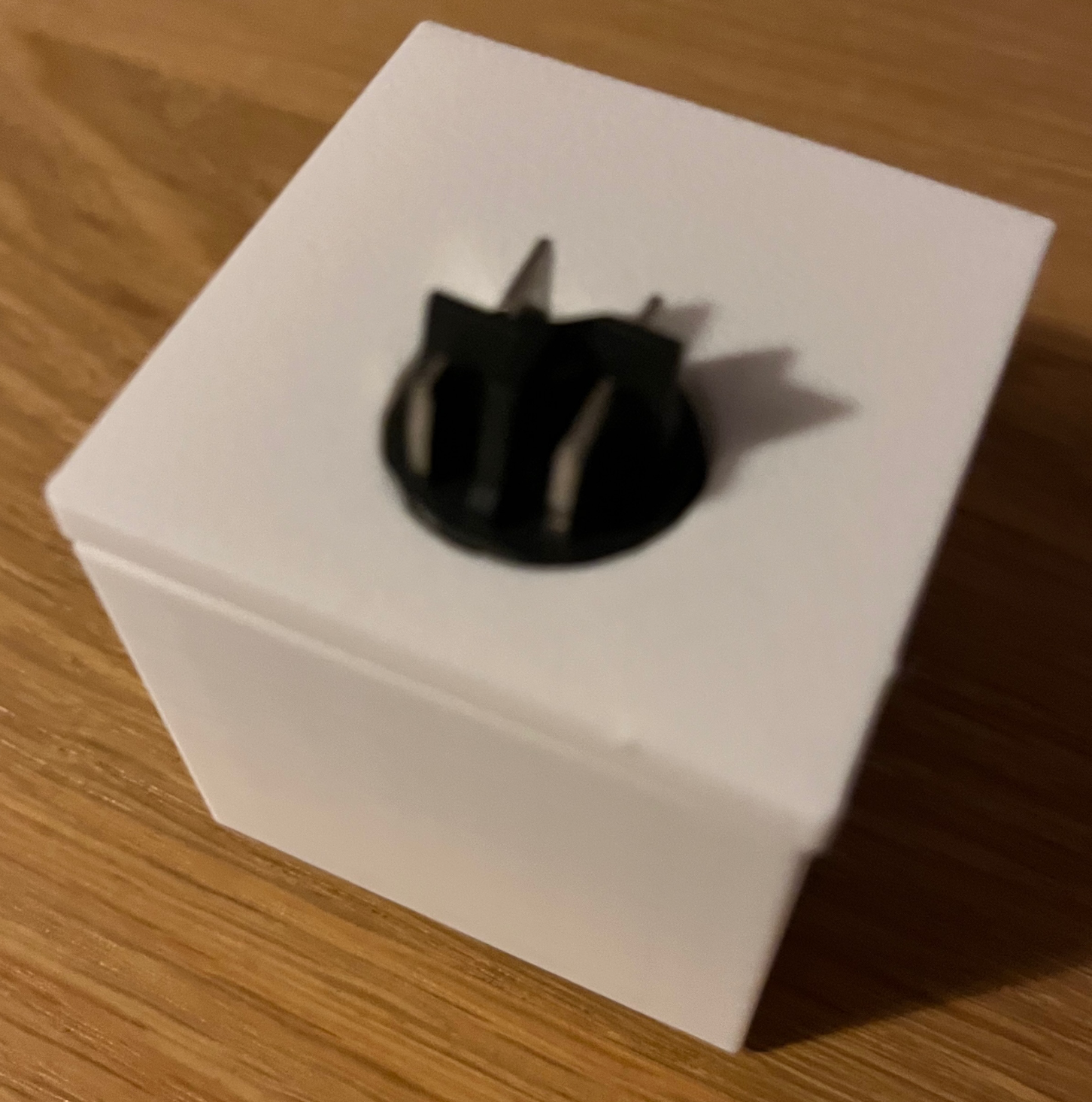

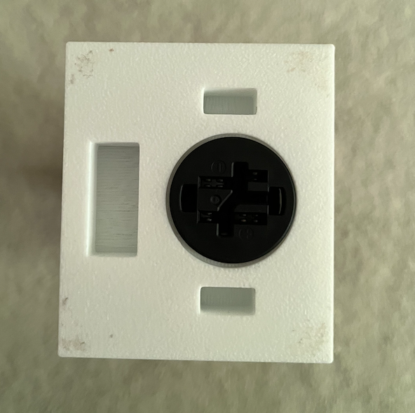

3 hours of tweaking and printing has got me to this concept box.
When the battery arrives next week I will be able to improve the design.

And how are you going to fix the box in the battery compartment?
Thinking I will make the box larger, screw it on to the 400wh battery, and make it so the total length is the same as the 800 battery. Then attach the trek battery cover so I can easily swap between the 400 and 800 battery.
Probably an easier way is to make a hollow box spacer. Wire the plug/socket so you can plug it in separately. Then you remove the tolerance to get the plug exactly right and can focus securing the battery with the 3d printed parts.
That would be easier, and lighter - I might end up with that solution

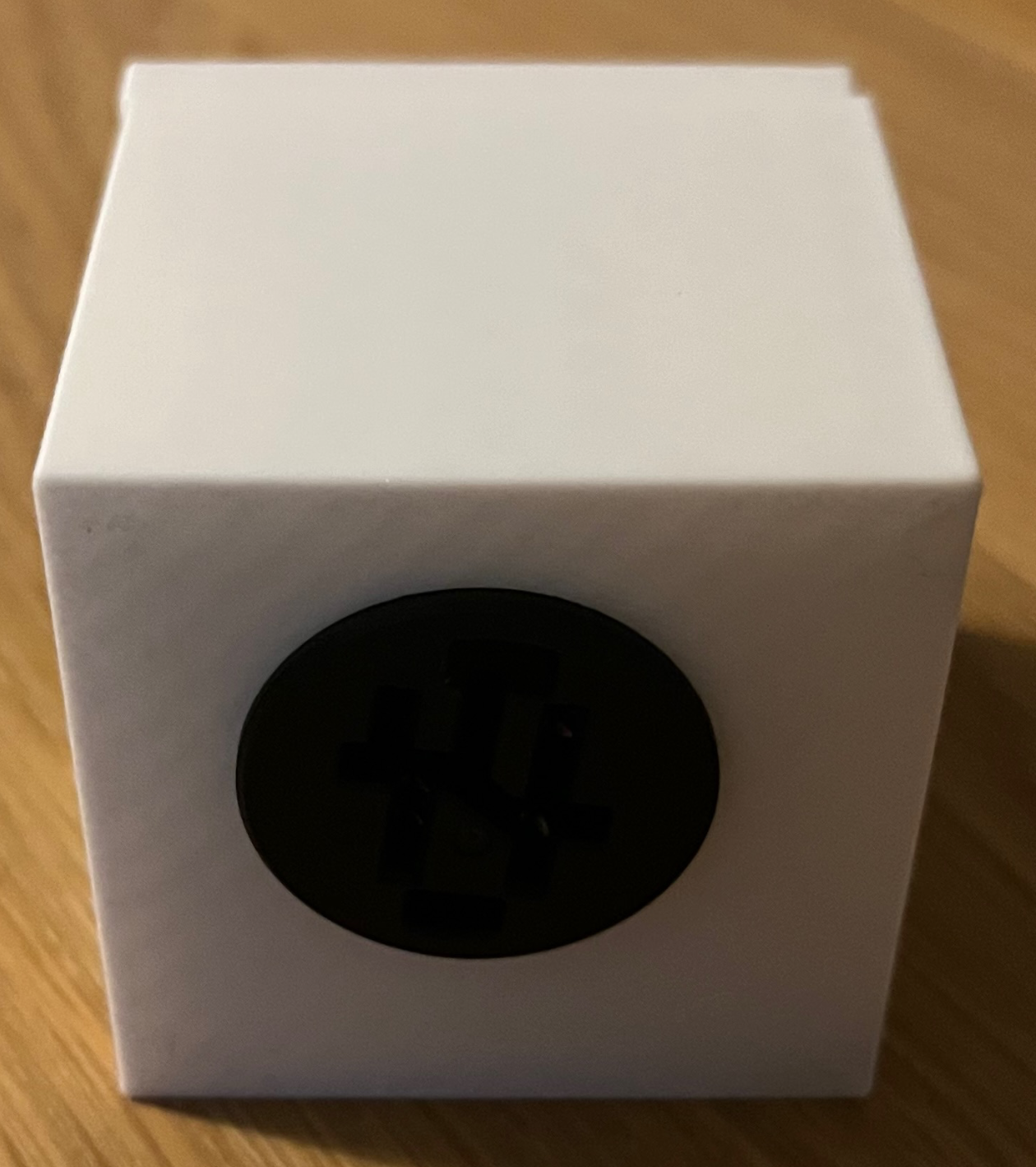

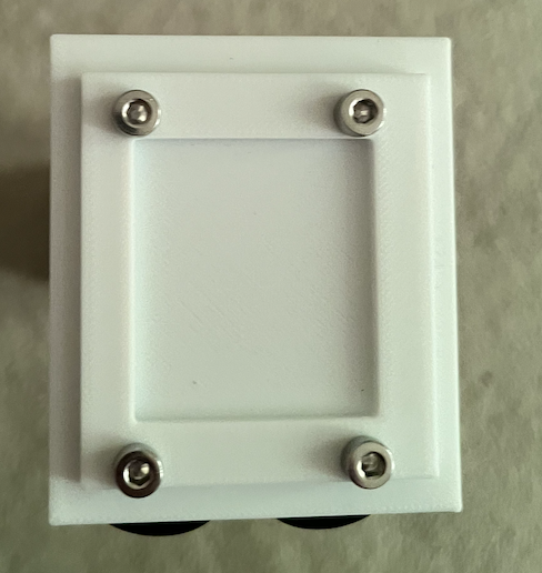

A productive Saturday - just need the 400wh battery to arrive and I can align the holes on the lid.
Screenshot 2025-09-06 at 19.26.04.png Screenshot 2025-09-06 at 19.25.56.png Screenshot 2025-09-06 at 19.25.50.png
Almost completed the design stage - I just need the 400wh battery, and I can finalise the placement of the bolt holes. I have just ordered some bolts, so the design should be ready to test next week.

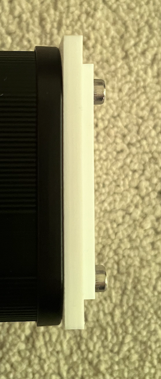

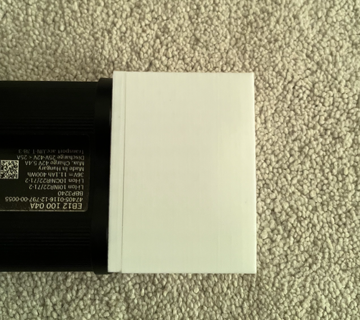

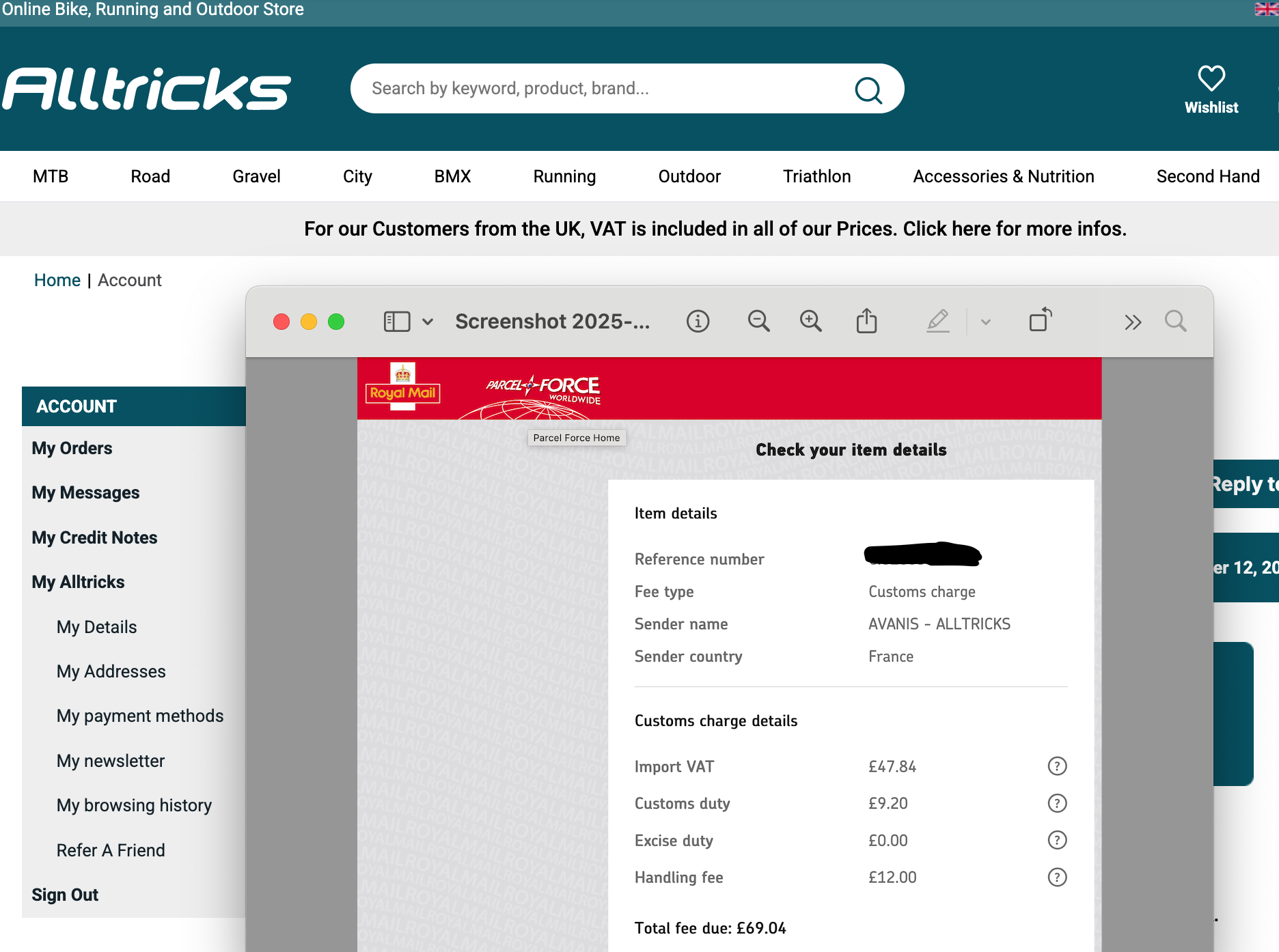

I received the battery from Alltricks - not a great experience - I have had to pay VAT twice, despite the banner on their website. Annoyingly the delay has meant no progress this week, and I am unlikely to be able to work on it until next weekend which is annoying.

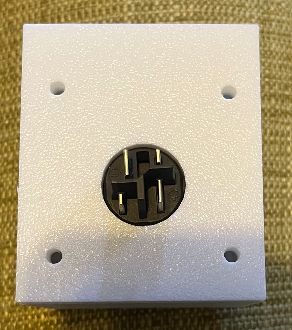

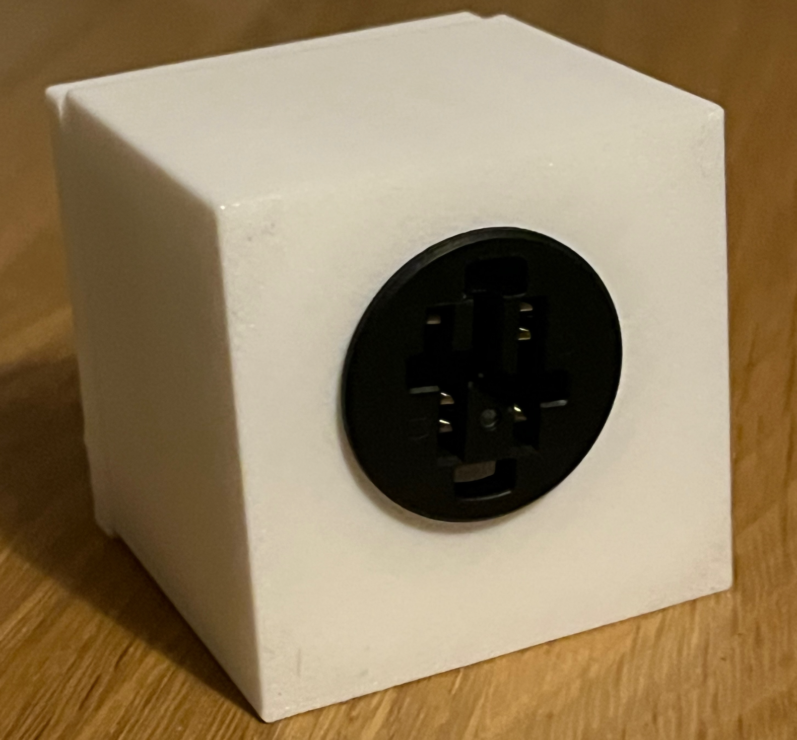

3 out of 4 parts completed
The remaining part is the upper base mount - making it the same as the 600/800wh battery.
I also need to add some holes to the lower base mount to attach the Trek battery cover - these will match the 600/800wh battery, so will work for other brands.
