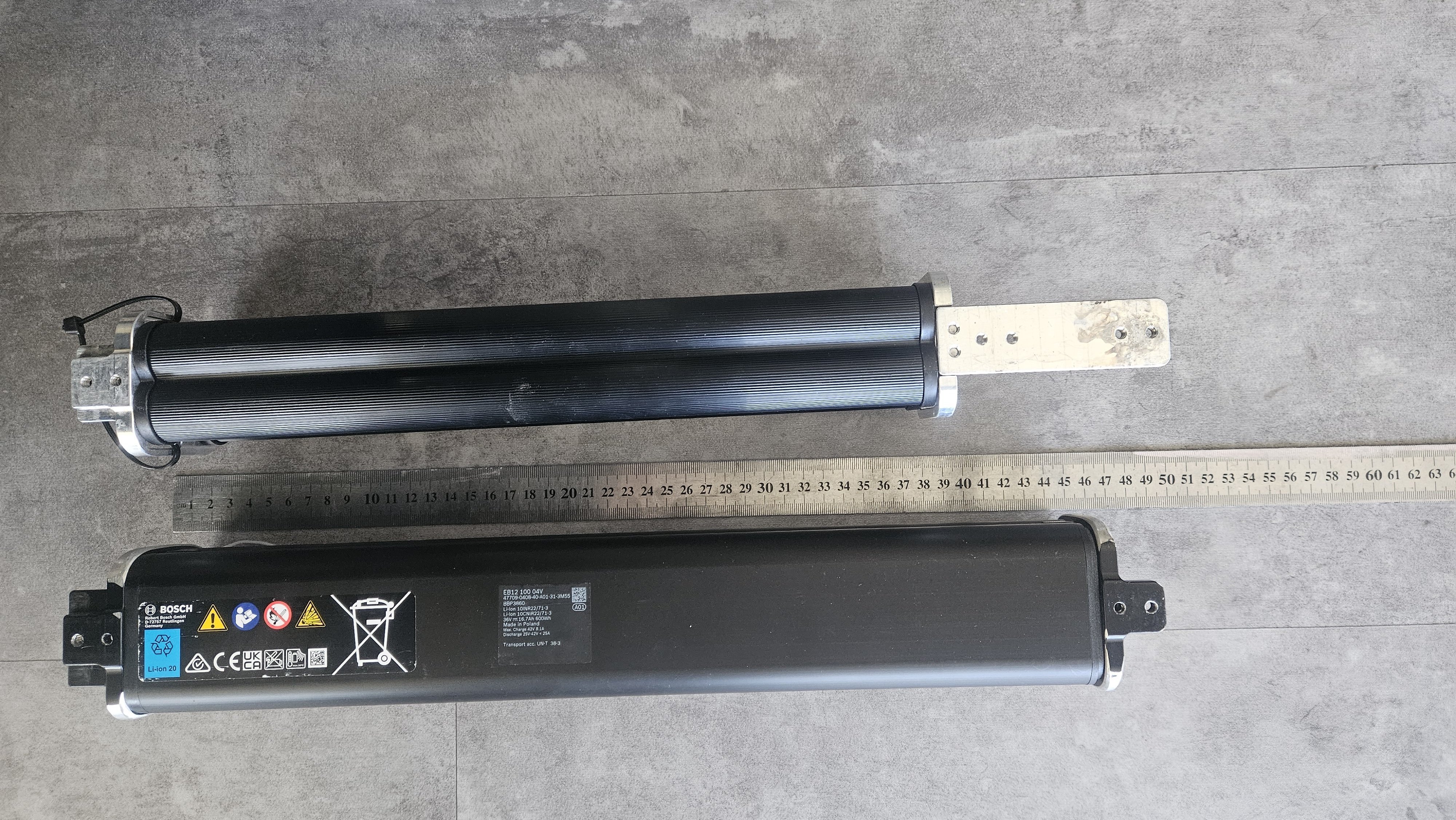

The 400wh is installed now. Ill have to take it and take some photos.
Crestline make and extension for the alloy plates that bolt onto the end of the battery. What im not sure of is if the endplates are Bosch standard or Crestline standard.

There ya go lads. How do your batteries mount in your frames? is it with these black alloy plates? of something else?
If its the black alloy plates with the same bolt holes then yes the crestline option will work. If its a different mounting style then all you need to do is engineer an adapter plate to bridge the gap between 400wh and 600wh/800wh distance.

Thanks for the photos. So, where did you buy the aluminum mount? From Crestline directly? Because I don’t see it on their website.
For my bike, the battery is mounted directly on a cover that can be completely removed from the bike. It’s not the same system as Crestline.
This could perhaps replace part 1 in the plan below, where a replacement piece would need to be created for that section.
I also see a second problem: on the Crestline, it seems that the battery connection to the bike is via a cable, which means it can move.
On the Mondraker, however, it’s a fixed connector.
Since the connector on the Compact 400 battery is not at the same position as on the 600/800 batteries, it won’t be possible to connect it without an intermediate cable.
Plummet is possible to you to take a photo of the 2 batteries on Connector side ?​

It appears that a universal adaptor solution would need to have an extension at each end of the 400wh battery. At the power end, a power connector adaptor, and at the other end an adaptor to make it the same size as the 600wh battery. The adaptors would need screw holes in the same position as the 600wh battery on the outer ends.

Good question, is the battery socket at the top of the battery in the frame or bottom and is the existing power cable long enough for the few inched of length difference. Here is a picture of the business end of a battery.
here is a 800w, Compact tube400 and 600w.
i think the I think the socket is lower than 800/600 battery
In my case, this is a problem because on Mondraker, the connection to the battery is fixed. It's not a cable to connect like on Crestline bikes. So I think I'm stuck, as there doesn't seem to be a linking cable available from Bosch.
