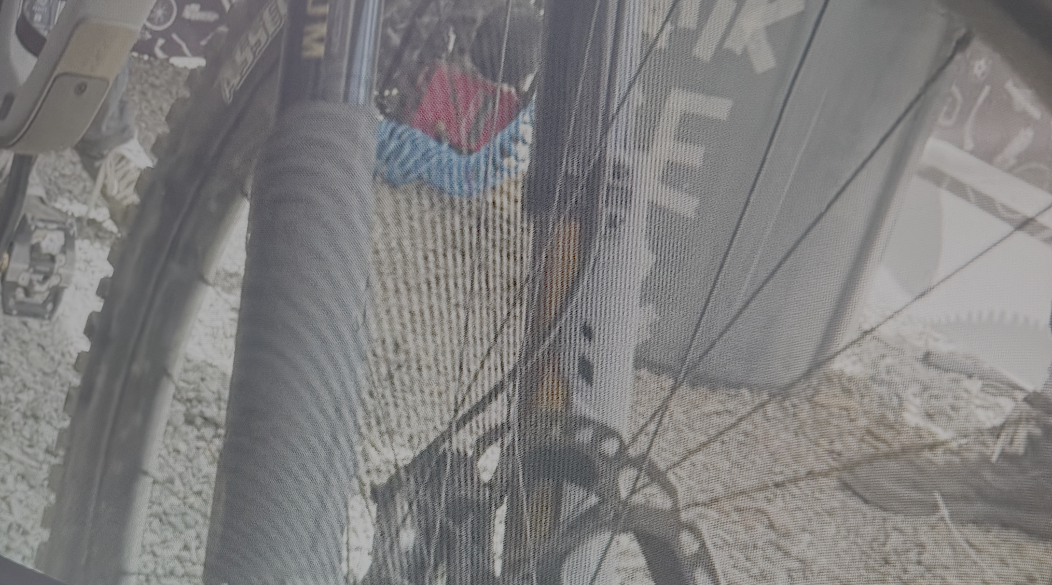

I’ve wrapped my lower fork guards, actually I’ve wrapped the whole fork
i have the podium on my lte. It lossks so beefy. I like that. Makes the bike look so much more sporty
I wrapped my lowers too. Just nice.

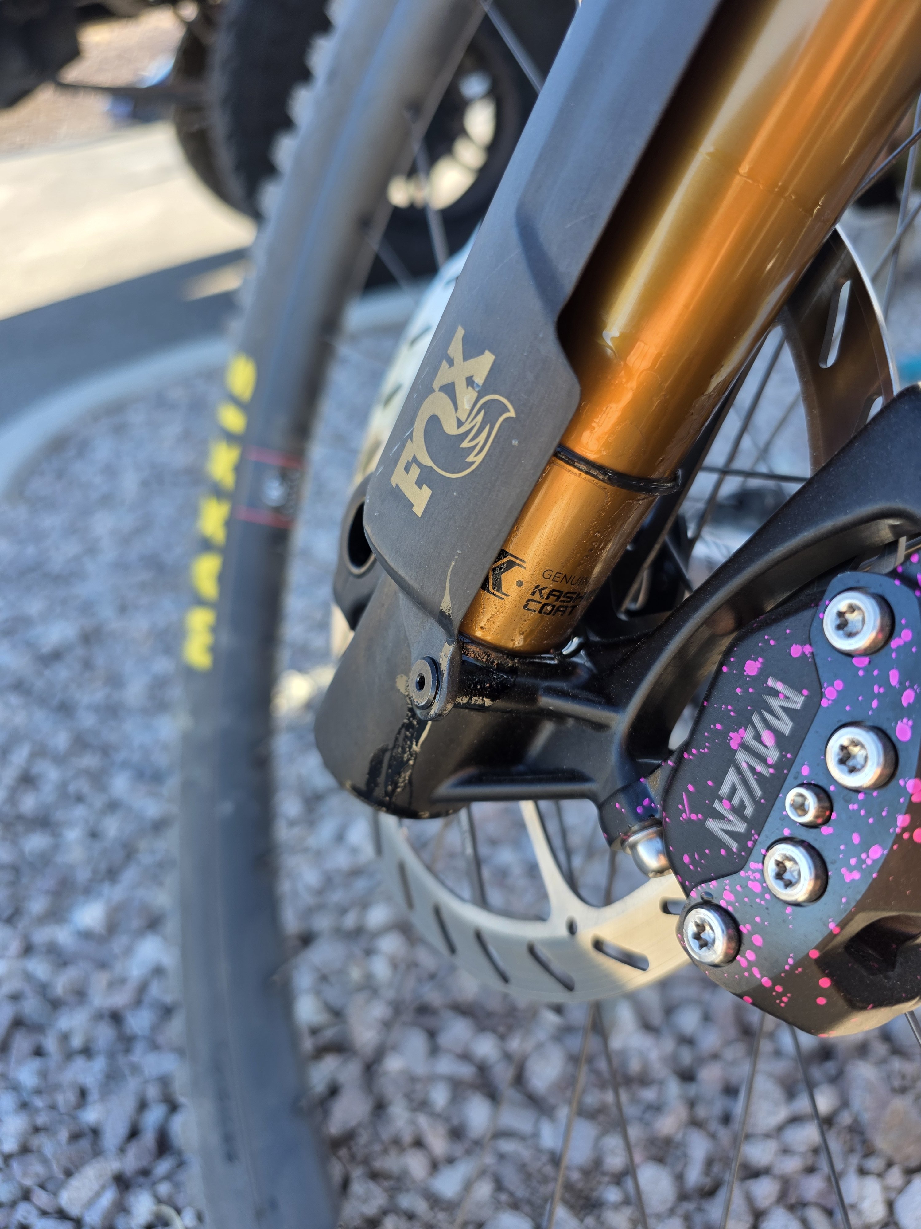

Met a woman at Hawes last week who is a very experienced rider and she swore by her Podium. She said initially her seals leaked, but she brought it to Fox’s western service canter here in Scottsdale, and it has been dry ever since. IMG_2404.webp

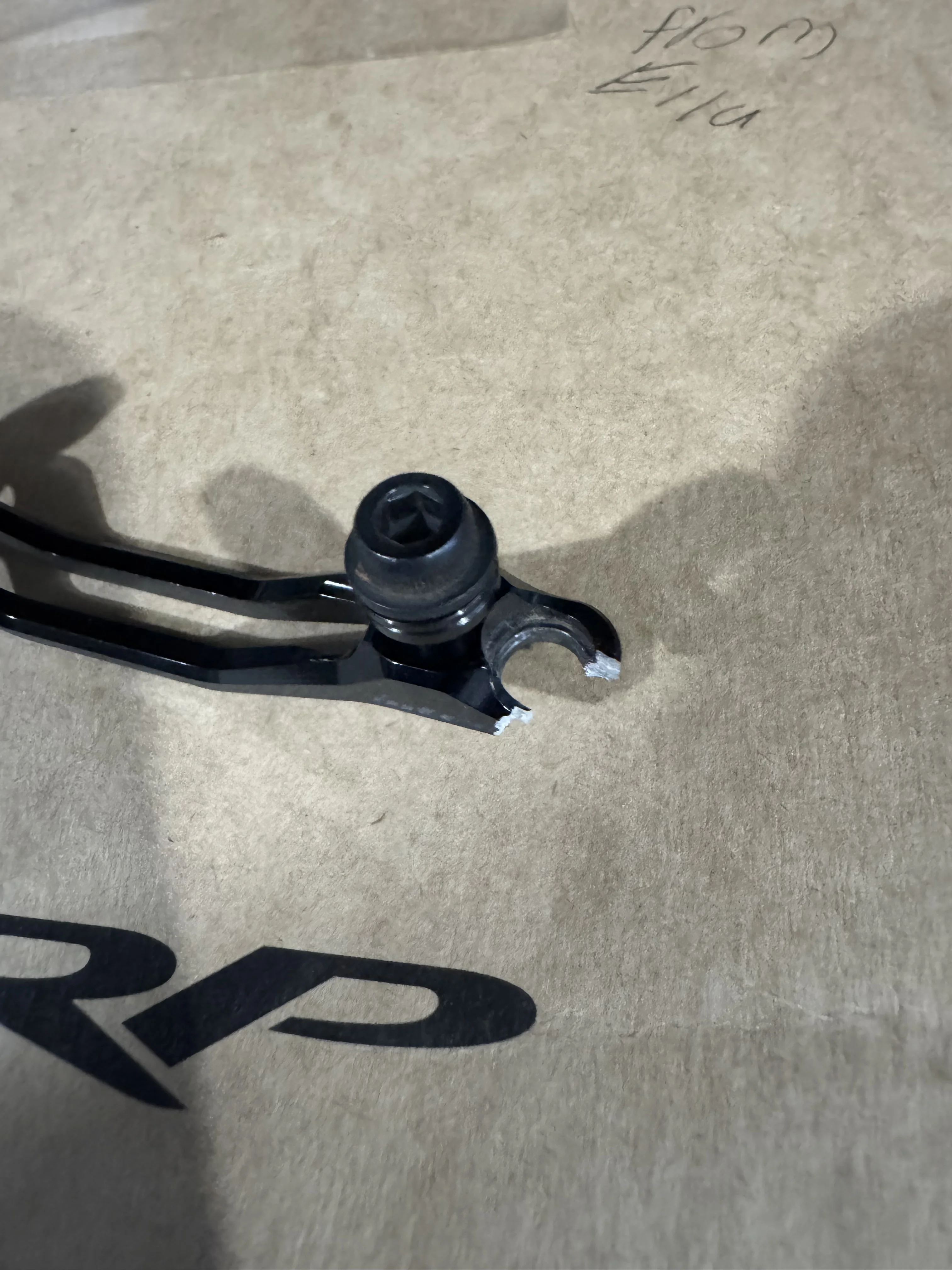

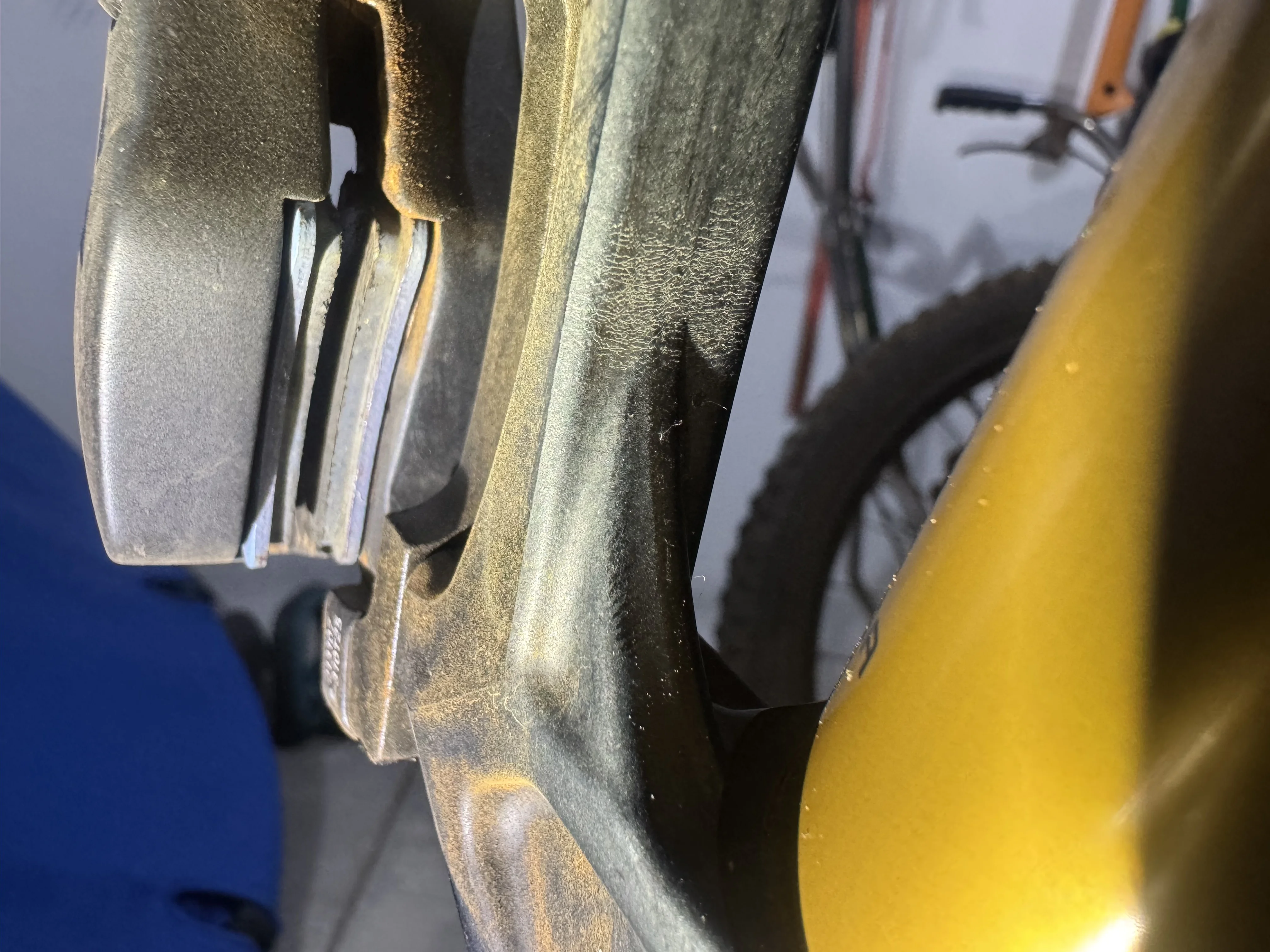

I had an Intend post mount adaptor fail on the podium causing the podiums brake mount to bend badly.
I managed to straighten it while sweating bullets.
As much as I like the intend mounts aesthetics, I’m not risking it again!
Picture is taken after I straightened to show the stress marks.
is your brake compatible with those adapters?
not all brakes are:
(list is under FAQ)
not all brakes are:
(list is under FAQ)
Yeah there were no issues with the compatibility, I thought it might be due to the extra stress the podiums design puts on the adapter.
I emailed Intend but they were only interested in selling me a new fork haha!
Just thought I’d share the info, might save someone a fork tube replacement.
