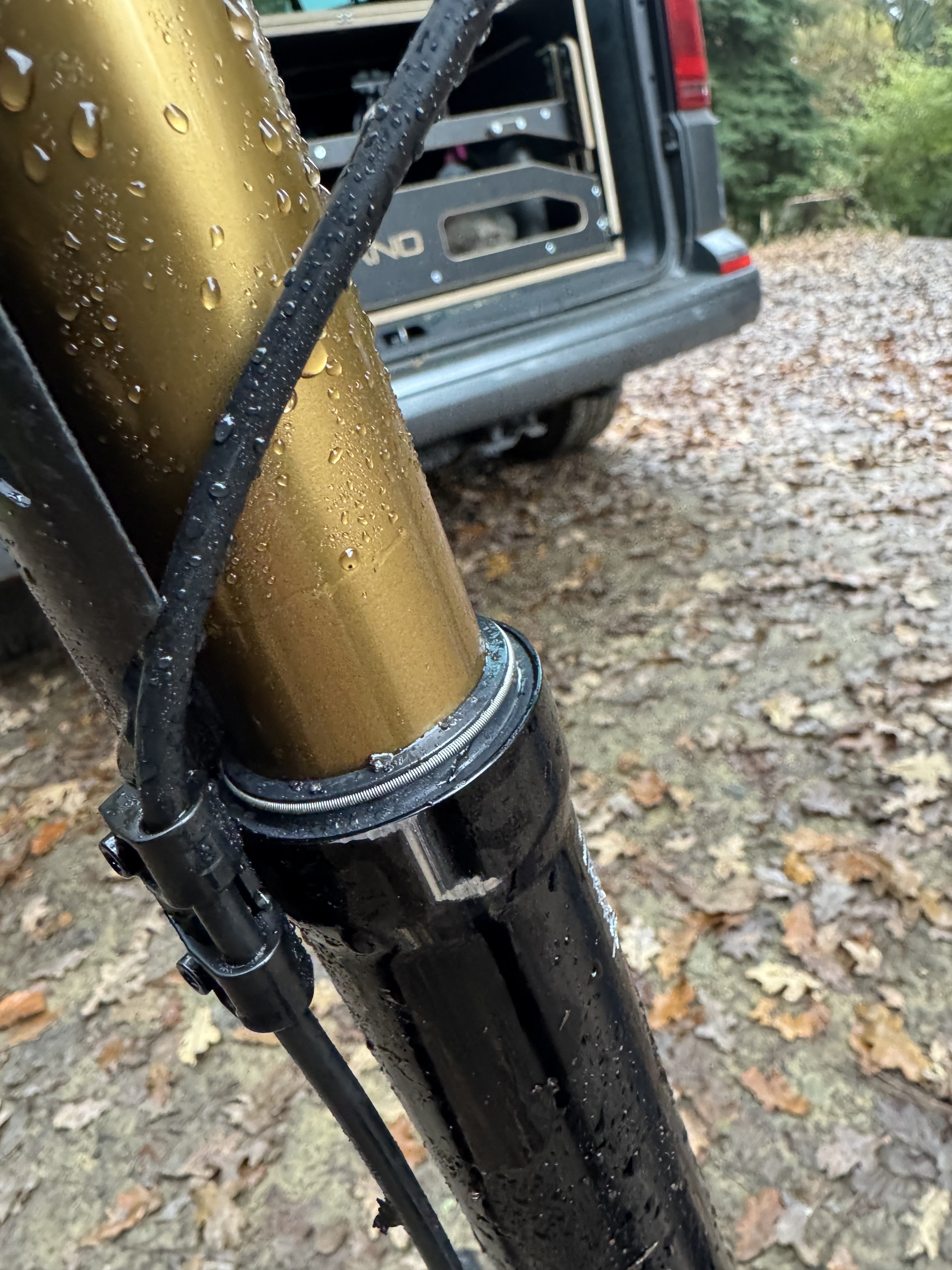

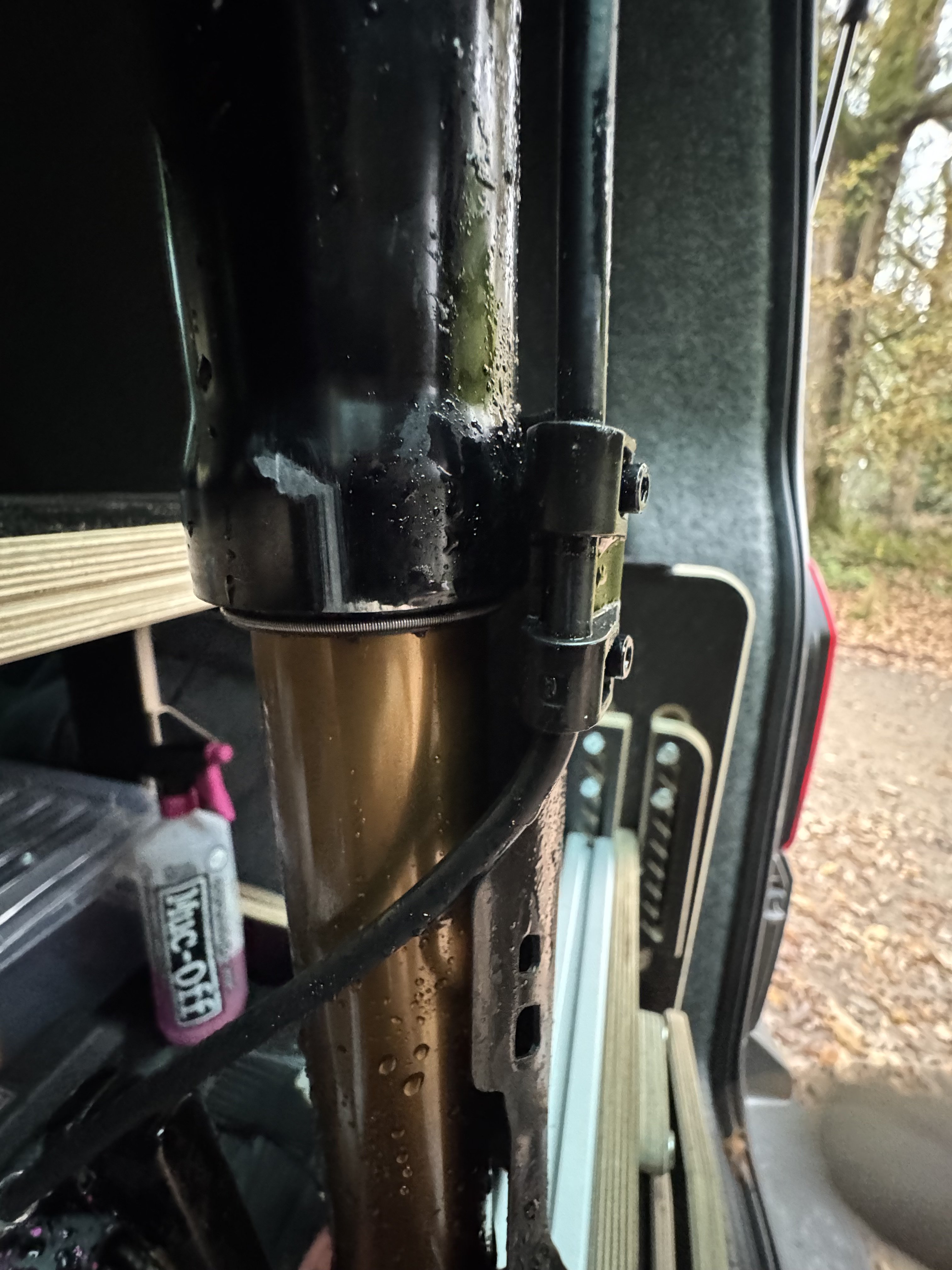

Anyone had trouble with there break hose rubbing.
View attachment 171488 View attachment 171489
No. No rubbing here.
Use the available play in hose to move the hose around. You can add a little twist on the hose then clamp it down.
Mess with it and you’ll find the spot. If you don’t have enough play, you’ll need a longer hose.
I also had to adjust the banjo.

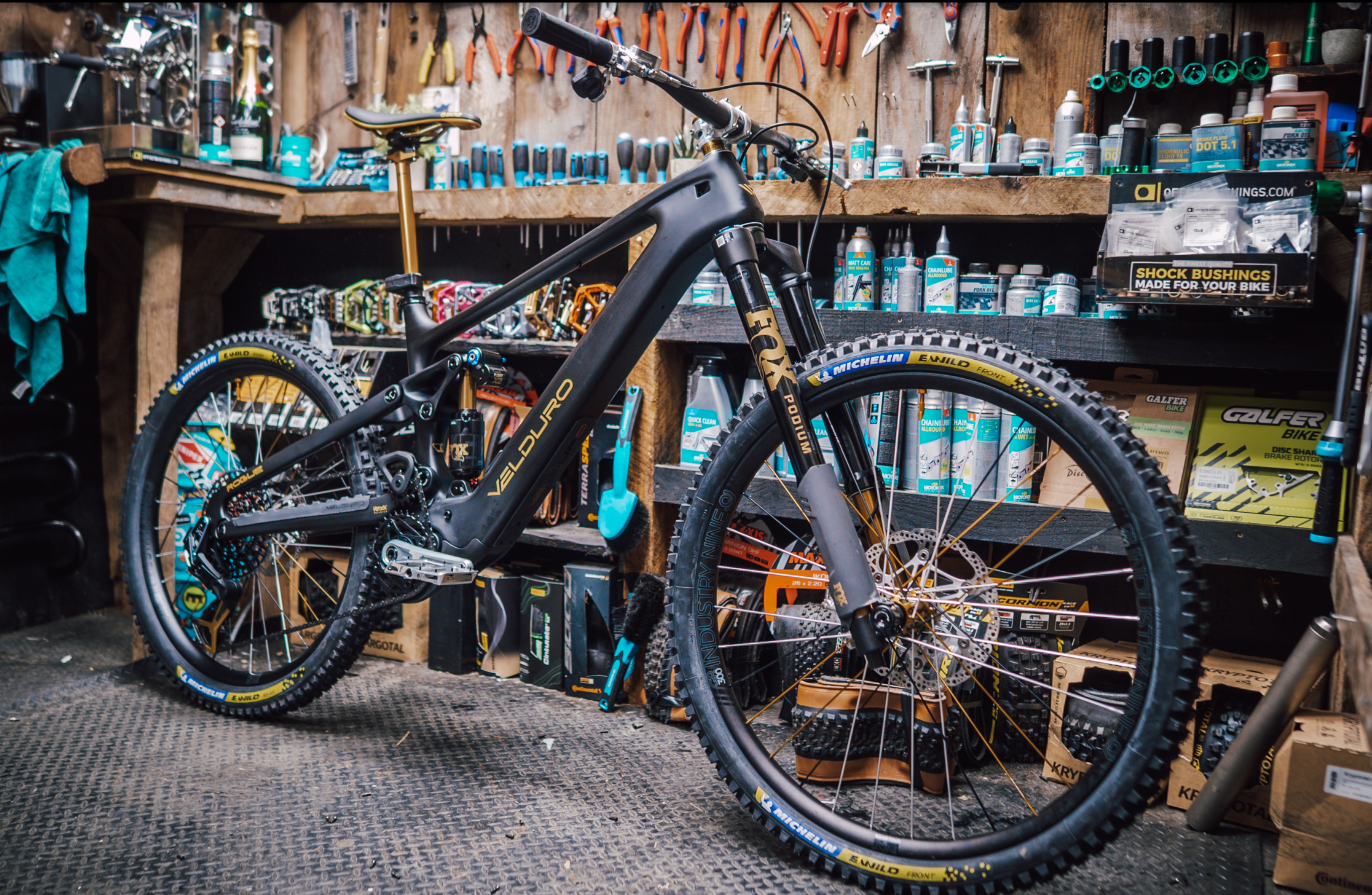

Anyway ....... I just pre-ordered the Velduro frame. Gee Milner put out a Dream Build video of this frame build with a Podium yesterday. It looks great. But I have concerns due to my riding.
I ride in the National Park where the trails are mostly natural trails. There are many technical rock garden climbs, where you climb between large rocks, and if you stall. Before you can get a foot down, the bike leans over and may contact these rocks. This sometimes scratches your, chainstay, seatstay, cranks, pedals, derailleur cage or fork lower. Items close to the ground. I remedy this by running ride wrap on any of these items I can.
As I had this exact experience yesterday, and I saw the Gee Milner video yesterday. I had a light bulb moment and I thought I'd ask in this thread how the Podiums would fare when this happens, as I cannot run ride wrap on the lowers. And I cannot just simply touch up the lowers, like I can the derailleur cage and cranks.
......... Sorry to those that didn't want the full novel. But I'm hoping not to get scolded by Lord Tooks again ....... :ROFLMAO:
Would it be Ok to speak in this thread, if we referred to you as "Lord Tooks" ? Asking for a friend ....... 🤭
Morning hun, you sleep well?! 😘
Looks like a nice bike, and re the forks honestly I think you worry too much.
Just build it and ride it, by the sounds of it you’re going to have some offs and you’re going to damage some things, the mech, the frame, the forks, whatever. 🤷‍♂️ Maybe ‘upside down’ podium style forks aren’t for you, but they ride great and do perform very well from what I’ve heard from people who actually ride with them.
Scratched stanchions can be fixed though, maybe not cosmetically perfect, but functionally. It’s a tube running through some seals at the end of the day, the seals don’t care if it looks perfect.
I have this exact wear. Mine is becoming pretty bad. I have heated up my brake cable and tried to form a bend better as well as moved the banjo to the best angle but it still happens.
It seems like they did not wrap the guard around enough so unless you have the perfect bend and slack in your brake line this will always happen.
