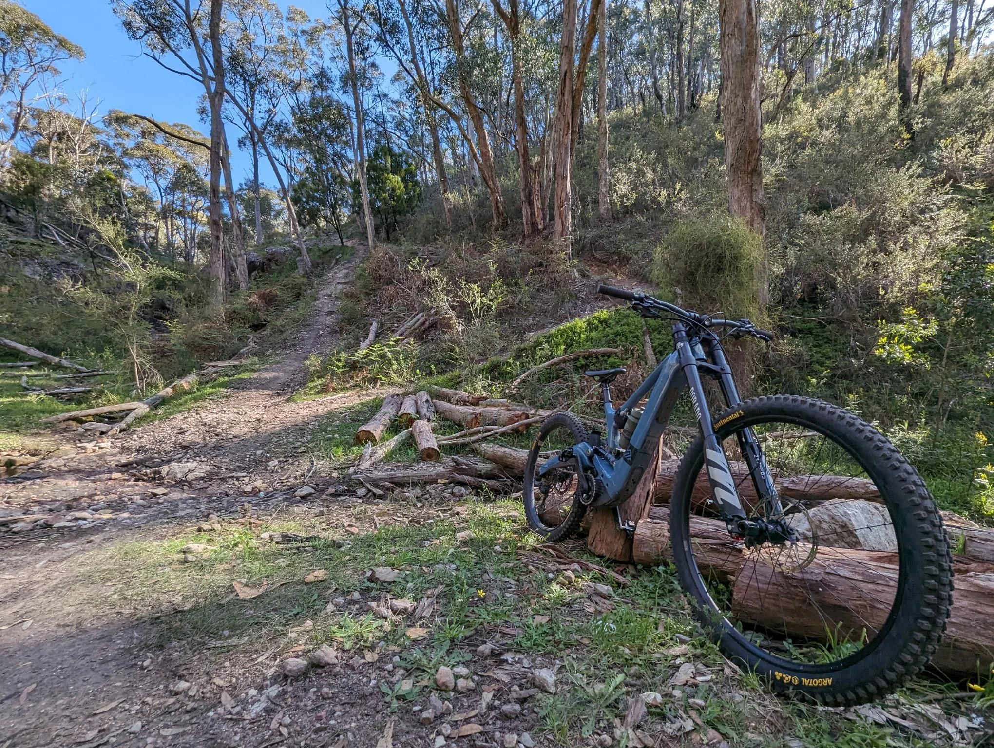

Well that's a coincidence. My Ibis Oso has a 203mm Dorado Expert on it, though a few slight differences between it and the Pro model.
Ridden on trails for nearly 2 years it a bloody good fork and the main reason I went for a USD single crown.
The Expert version is about 3300g so its no lightweight, the Pro version is about 3000g but not 'ebike compatible'... why I'm not sure, maybe Google can tell you, might be the carbon stanchions but its good enough for UCI DHers to ride and hit 70ft RedBull hardline gaps ???
The dual crown is definitely restrictive but even tight uphill switchbacks are easily done with a bit of thought, with the rubber bumpers fitted and a fat carbon head tube on the Ibis, I had maybe had 45°-50° of steering in each direction. This takes a bit of getting used to.
The other thing is if your frame is rated for a dual crown. The Ibis standard is 155mm/170mm, then with a longer stroke rear shock it gets 170mm rear and in my case 203mm front. It does say its rated for a dual crown fork at 180mm max... oops.
Both forks are very plush and excellent forks, I would give the advantage to the Podium for the single crown and weight. With both you will need a 20mm axle boost front wheel. The Dorado also needs a DH stem and 1.5 to 1 1/8 reducer for straight steerer.
The advantage of the Dorado is you can go to 180mm/190mm/203mm whereas the Podium is 170mm max.
Heres a picture of the big boy, its a monster of a bike.
