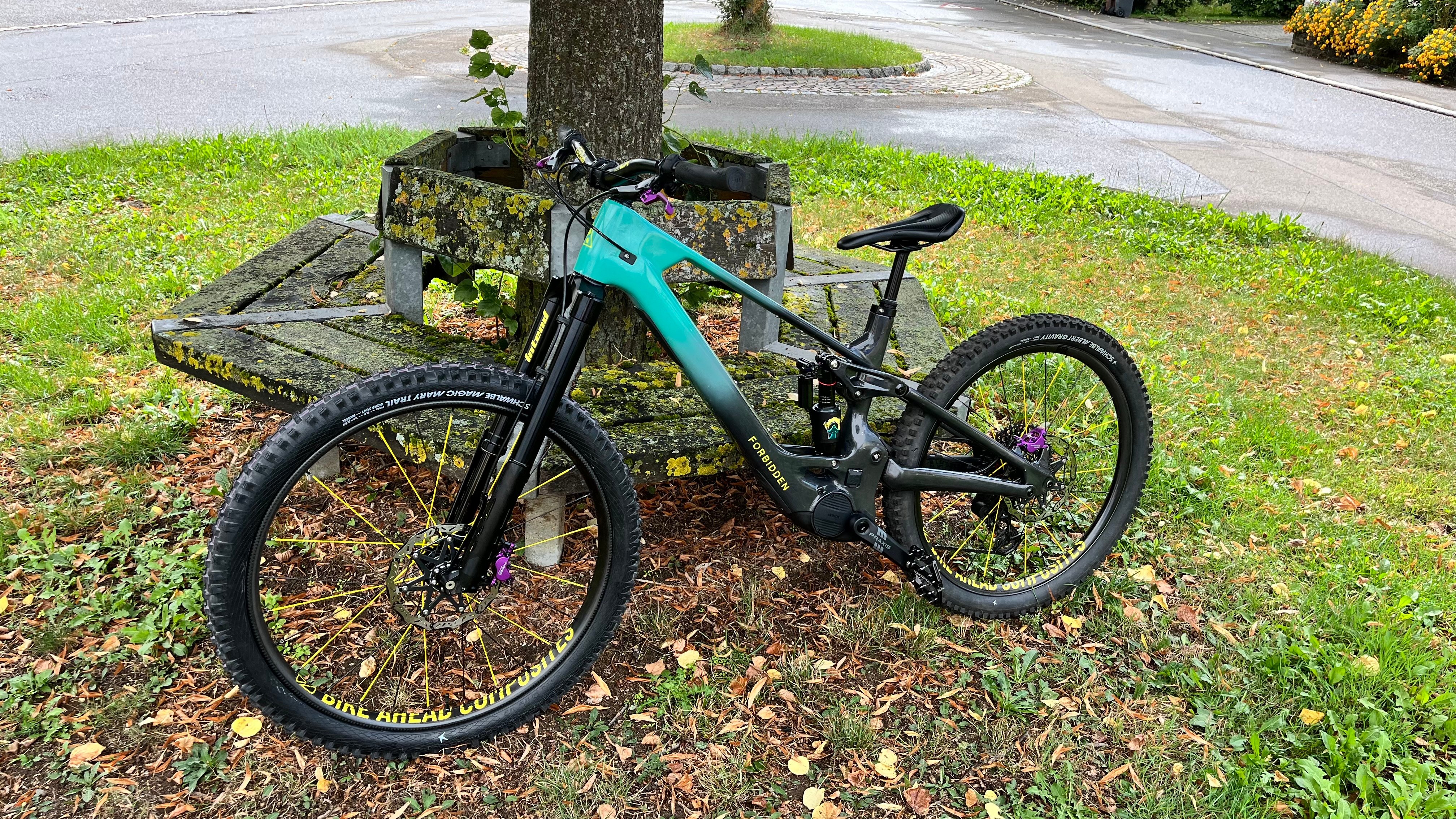

Here are the list with the modified parts
Fork:
Intend Hero Blackline (170mm)
Drivetrain:
SRAM AXS Transmission XO1 with motor cable (SRAM Powertrain Extension)
Chain:
SRAM Transmission XO1
Cassette:
SRAM XO1
Wheels:
Front: Bike Ahead Composites EN 30 rim, Tairin hub, Berd spokes
Rear: Duke Fury Jack Rear rim, Onyx Racing Classic hub, Berd spokes
Tires:
Front: Schwalbe Magic Mary Trail, 29x2.5, ultrasoft
Rear: Schwalbe Albert Gravity, 27.5x2.6, soft
Brakes:
Hayes Dominion A4 purple with Braking Epta Stage 0 rotors 203 mm
Handlebar:
SQ Lab High Riser 3OX Carbon
Grips:
SQ Lab 711 Trail
Stem:
Spank Split 48 mm
Dropper Post:
One Up V3 210mm
Dropper Remote:
PNW Loam Lever V1
Saddle:
Ergon E-Mountain Sport Performance
Pedals:
Wolftooth Waveform

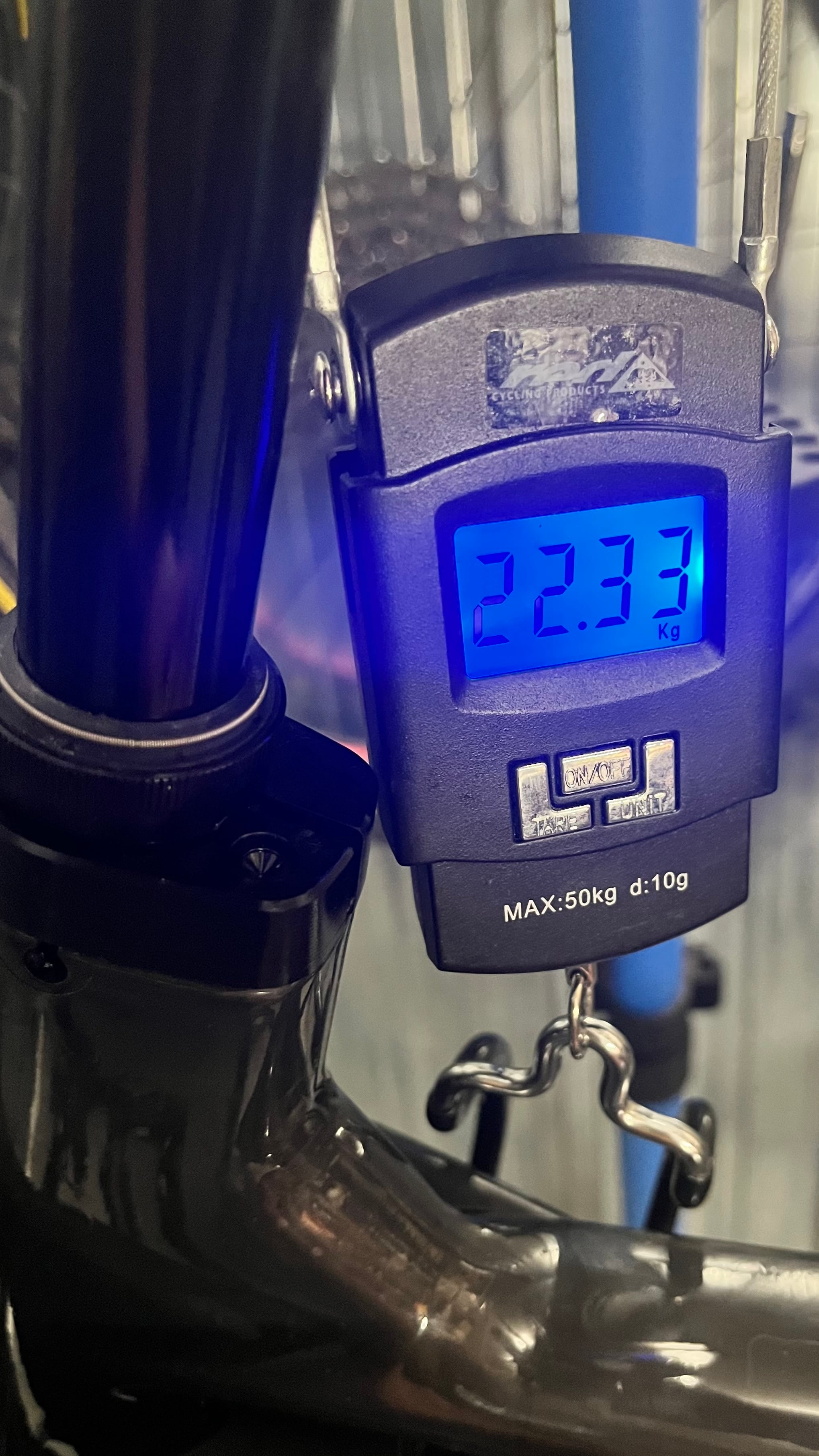

22.33kg with pedals (-398g pedals)

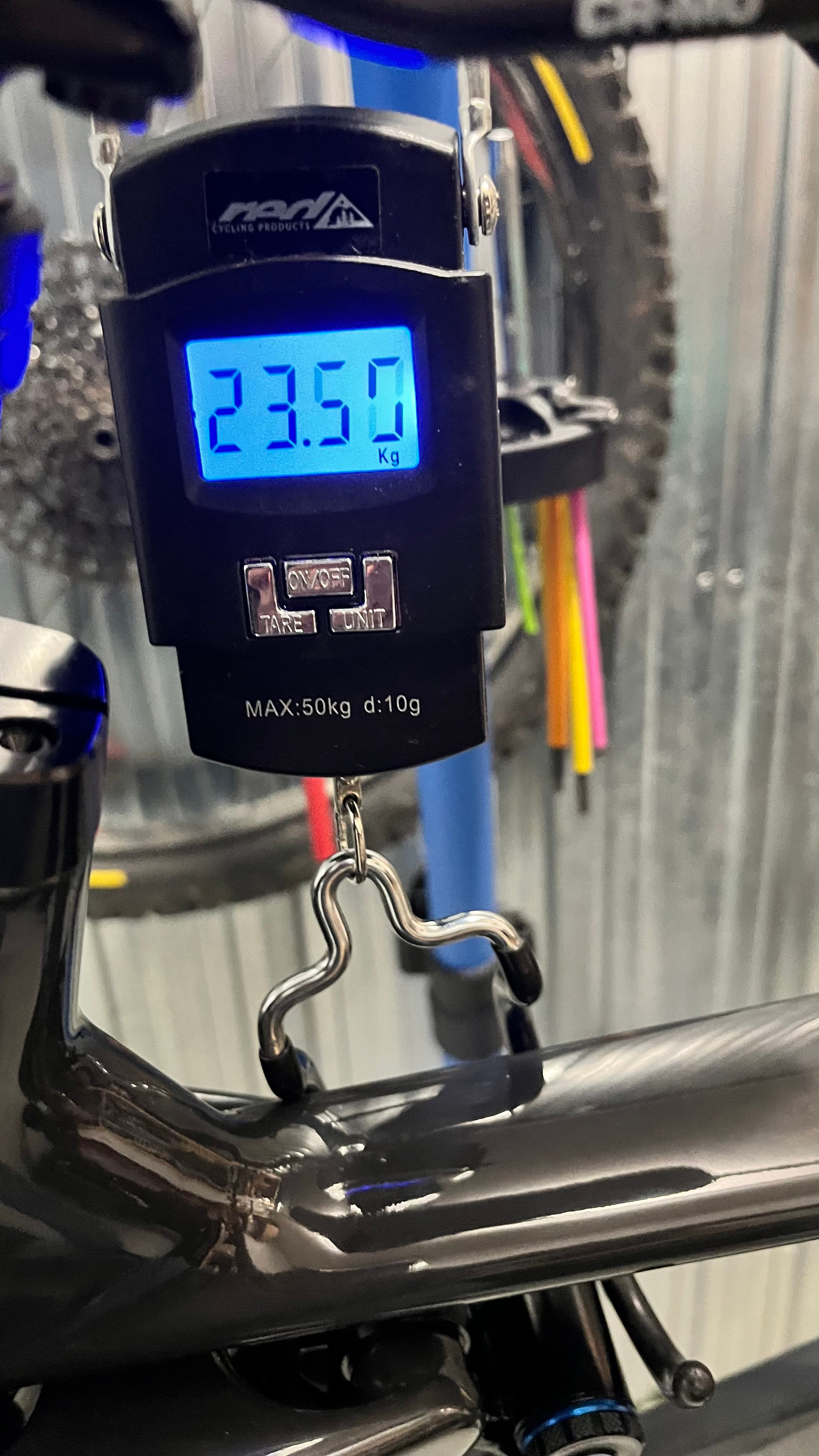

It came with 23.5 kg without pedals in spec. T3

That's actually an insanely good weight considering the spec (800w battery, High pivot frame, heavier fork, not a light rear hub but Berd spokes help, long dropper, electric 12sp, 1 gravity tire). I'm seriously impressed and would have guessed 53#s/ 24 kgs.

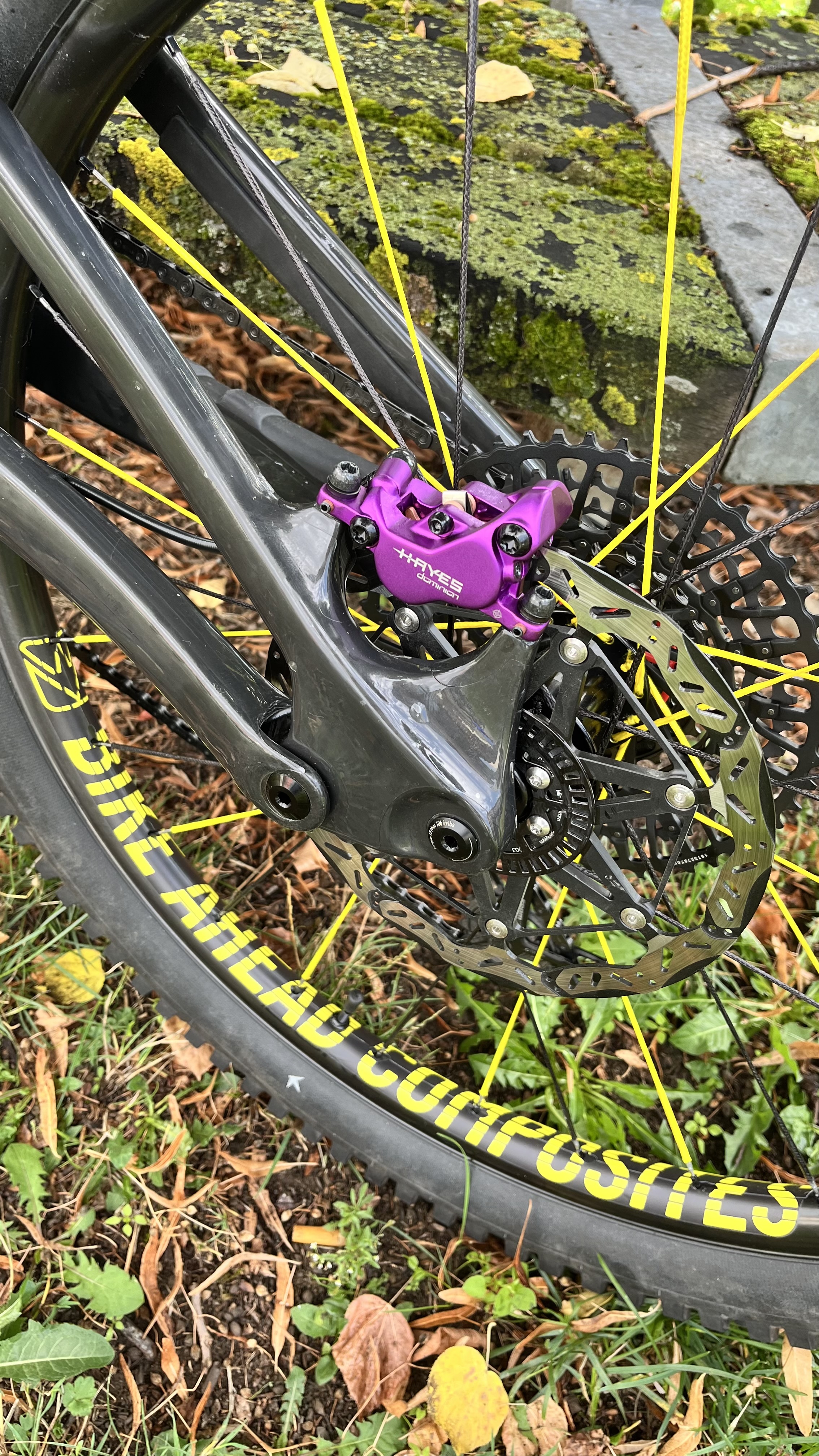

I have 3 sets of Berd spoked wheels btw, and I really enjoy them. But definitely don't love them on the back of my e-bike. They just move too much, and I went back to steel spokes on my rear rim.
Although I'll definitely stick with Berds on my light duty trail bikes, my next e-bike wheels will be steel spokes both front and rear.

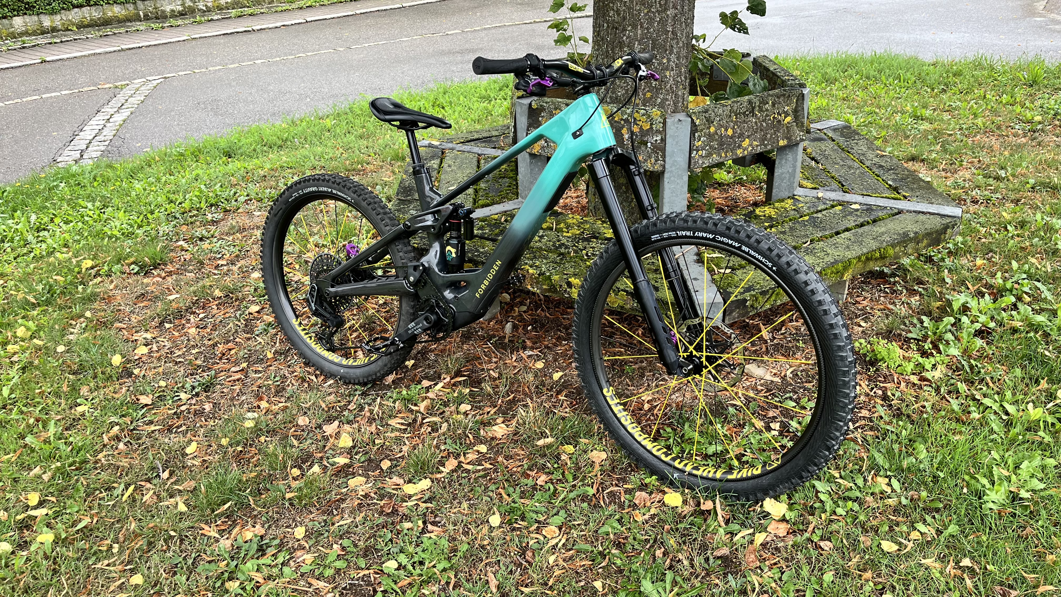

Thanks! It is very light for that kind of bike.
The goal was as light as possible, but still suitable for trail/enduro.
There ist room for another 500g without compromising the trailability😉
Lighter handlebar for example the Bike Ahead Riser
Lighter shock for example the new Intend Hover.
As you said a lighter rear hub or a completely other polymerspoke wheelset for example PiRope Enduro wheelset
Slightly lighter tires
Slightly lighter Dropper (Vecnum Nivo).
Lighter Brakes and Rotors (Intend or Trickstuff).
But that will cost a lot! And I owned most of the Parts already - so I am pretty happy with that build 🙂
