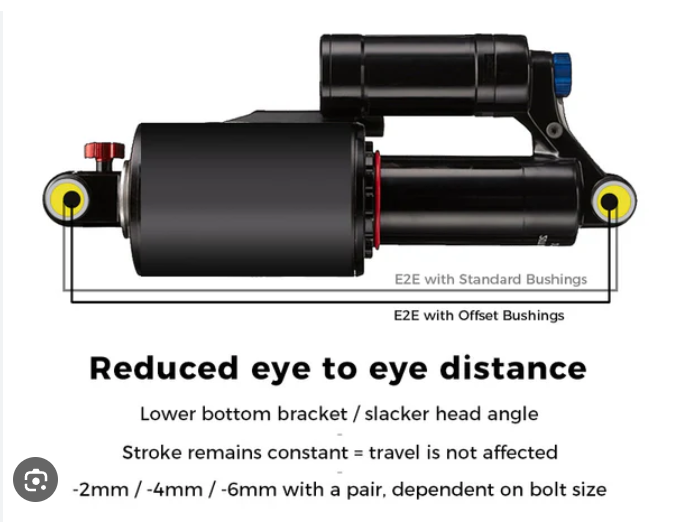

I already have an Avalanche SSD Marz Bomber tuned for this bike in hand, so I'm committed to getting it at this point. It's a custom 210x60mm, with 2.5mm and 5mm stroke spacers to reduce the travel. So can run it at the stock 150mm, ~157mm or ~163mm.
Can you over stroke the druid to 60mm
I'm going to be running two offset shock bushings in the high position cause I think the BB is too low anyway. But that should give more rear travel clearance. Of course I'll put the shock on with no coil and fully compress it to check. If it doesn't work I have the travel reducing spacers available.
I'd be interested to know of this works
If you set it up opposite of the below you would raise the BB.
