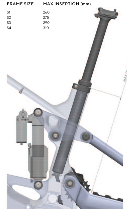

It looks like it has a little more space than stated as the maximum insertion
Hmm, might get away with a 250 Reverb after all, I run one on my other bike and it's not slammed anyway tbh, maybe 25mm from being slammed
If I do some rather funky calculations, 250mm Reverb might just about fit according to their seatpost insertion specs. The seattube length on an S4 is 470mm. Add 150mm of cranklength.. I typically run around 96cm from pedal axle to saddlemounting location on the dropper.. that leaves 340mm above the seatpost clamp plus 310 insertion in the frame to 650 total :D The 250mm AXS has 648.2mm total length.. btw my inner leg length is around 93.5 cm.
The reverb on my Deviate will actually fit the Forbidden as I run a 31.6 with a shim so I suppose the smart thing would be to chuck it on and check before commiting to another one
