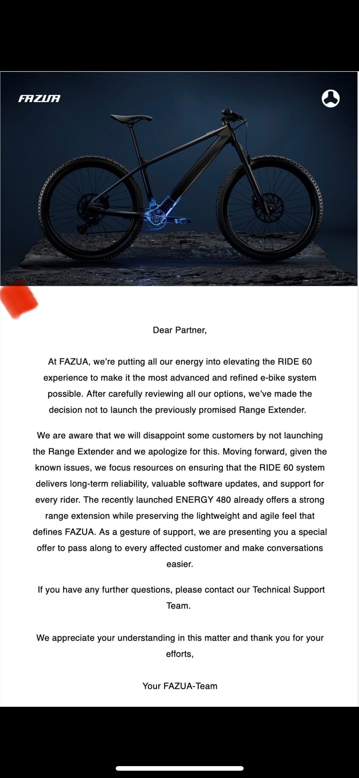

Bad News regarding the REX
I'm still happy with my Ride60 after Fazua replaced my motor and extended the warranty coverage. But I can understand how others have had multiple replacements and long downtimes that soured them on the brand though.
Going to be some unhappy people I think. I wonder why it was so difficult when every other brand seems to manage it?
Heard from Ari just a bit ago. They said this news just dropped this morning and while they don't have specifics yet they expect it'll be a discount or trade-up to the 480W battery. We'll see....
Think they are prioritising addressing the reliability problems, but not sure it screams commitment to the system. Can't see many companies wanting to spec Ride 60 on their shiny new models, so not sure what the future for Fazua is looking like?

Surely they can do two things at once? The range extender was promised at launch (?) years ago. Fazua have been owned by Porsche for several years since then, you'd think they'd have the resources to do something everyone else seems to do fairly easily. Orbea are fairly small yet have their own unique take on a range extender.
My guess is that the connection they planned turned out not to be suitable and the prospect of recalling all the bikes to fit a new charging socket (and possibly replacing all the chargers too) was just too daunting.
The step up from 430 to 480 doesn't seem like enough to be worth buying a new battery (unless it is a really good discount).
