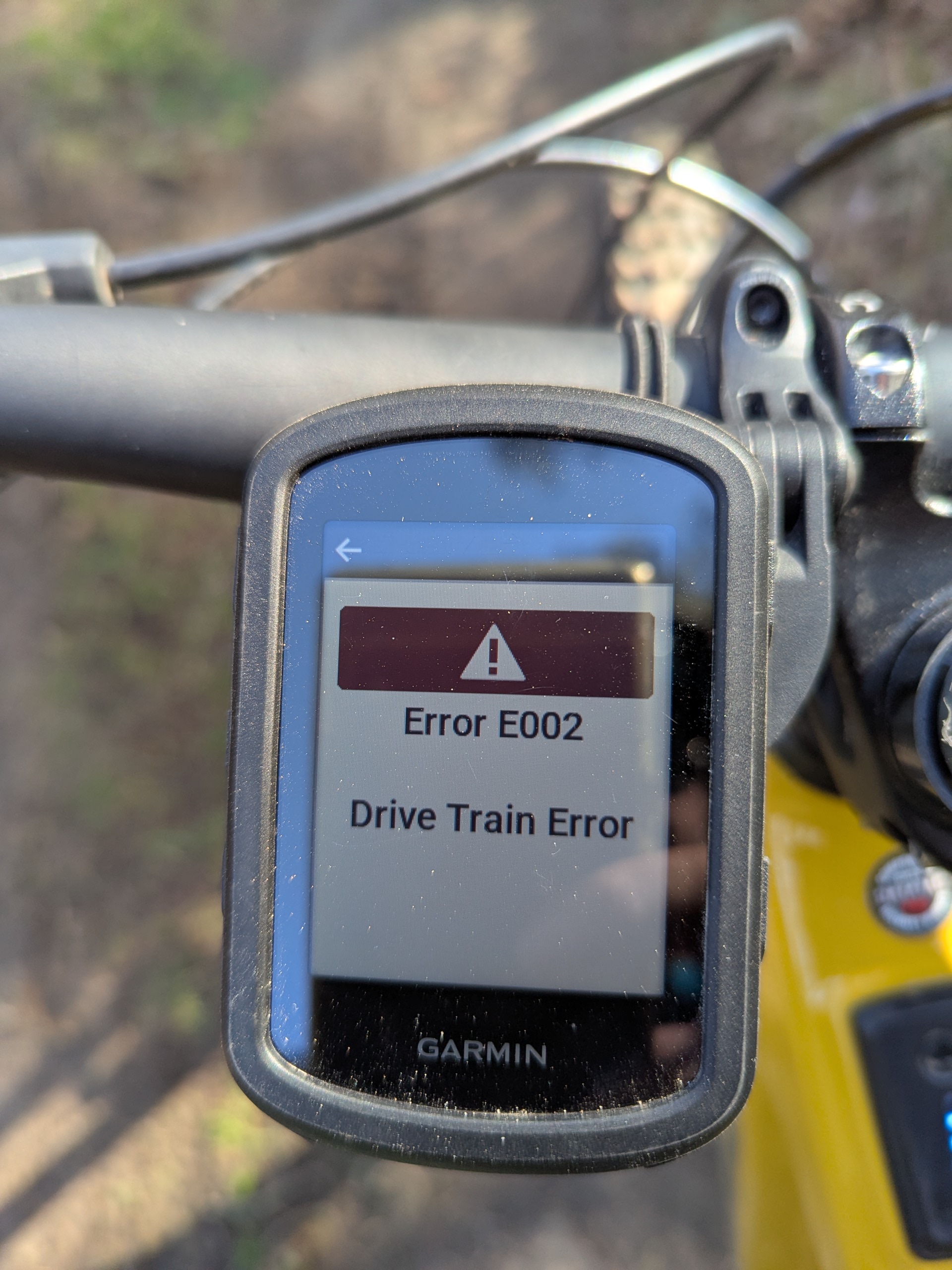

So, after just 3.5 months of good functioning without any issues, in typical UK muddy winter weather, I got an E002 drive train error, out the blue and the motor started cutting power in any mode selected, on my 2025 Santa Cruz Heckler SL, with FAZUA Ride 60 motor.
Usual FAZUA troubleshooting suggested, did not fix the issue. Yellow blinking lights suggests a soft error, apparently.
I was hoping this being a newer production motor would not have such issues... 😒
Now bike is with my LBS to try and sort it out, so no riding for next 2 weeks. 😭
Wonder if I should cut my losses now and sell this bike or persevere using FAZUA's 2 year warranty?
The Heckler SL is an amazing riding mid-power e-mtb, nonetheless, especially as it is my first e-bike, and has been stellar up until now.
But what to do?!!! 🤔

Sorry to hear. Sucks if you can‘t ride it until the replacement arrived :(
Most of the fazua failures are fortunately strange motor sounds or sporadic issues that you can still use the bike until the repair.
Used ebikes are hard to sell and other motor systems also have their issues (most likely not as much as Fazua, but they have).
Plus the warranty is always reset to 2 years from a motor swap for Fazua (usually this is not the case).
So i would stick with the bike since you enjoy it.
I will also keep my Transition Relay, also like it, and take the life time warranty of Fazua, because I can‘t imagine the motor holds up more then 2 years by my frequent riding 😅
Btw: interesting you have the hw version 5, i guess because it‘s the stock motor. I assume your next will be HW version 2, should be the same :)

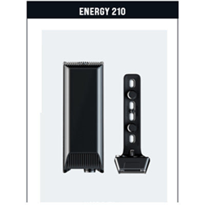

Some good news regarding the new Fazua stuff incl. REX:
Looks like the REX Bracket is a REX and a fidlock mount in one.
As expected no cable needed and the rex is directly plugged at the bracket.
That's going to be a game changer for me when I travel far with my Relay.
