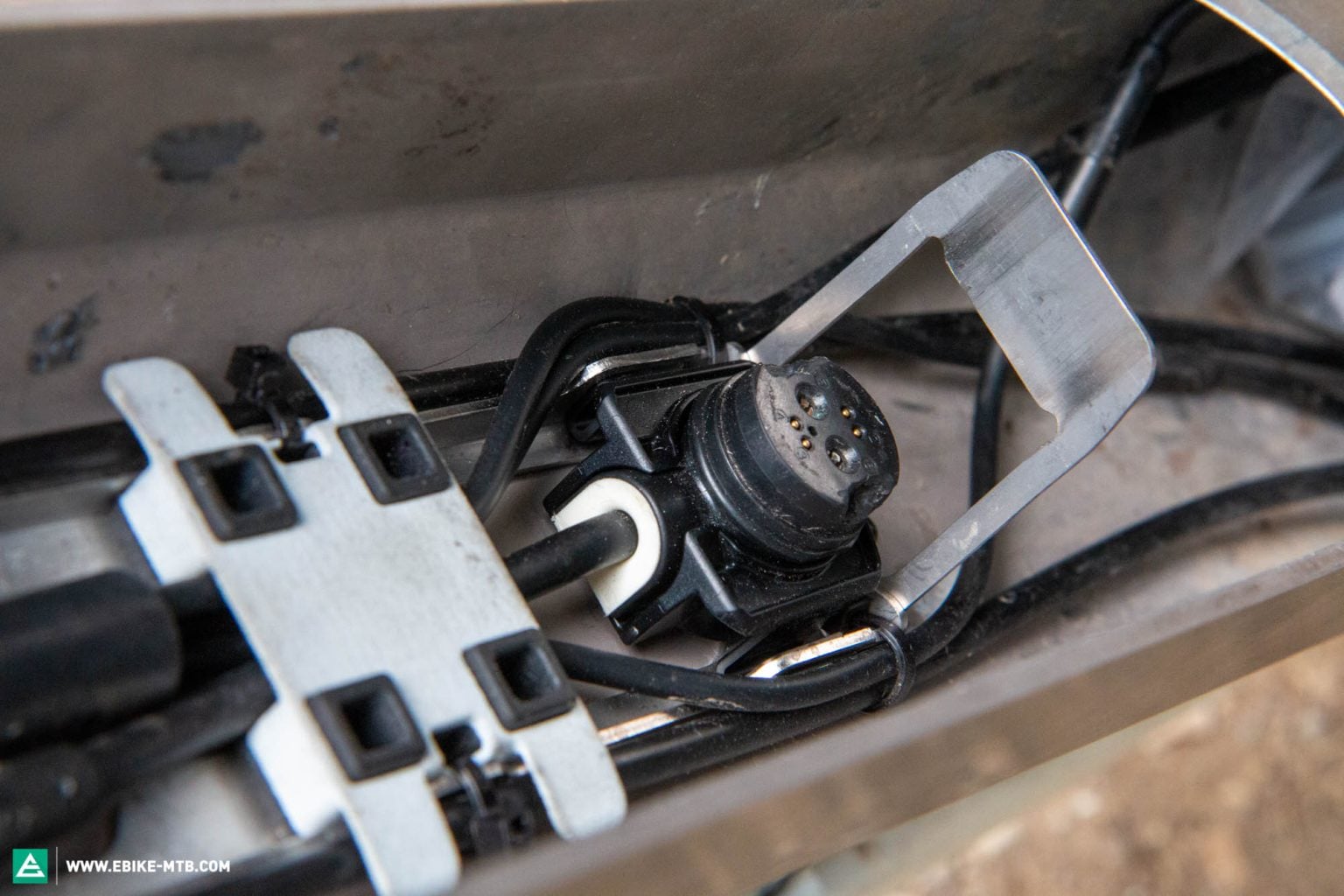

explaining to pissed of customers that their bike needs a new part right after buying? we talking about commuter bikes here, not mountainbikes. these people just want a bike that works. not a bike with a removable battery where the lid is loose. not a bike where the battery connector in the frame is not on one of the ends of the battery, LIKE WITH EVERY OTHER MOTOR, but right on the side, build from some flimsy plastics that can move in the frame.
shit design, can‘t be fixed properly.
bad spot for the connector, can get loose.
when loose, customer can‘t commute to work, gets there late. you ARE NOT LATE FOR WORK in switzerland.
whoever designed this POS should be hit with a stick till he yells. and then some more.
cykelk
May 15, 2023
103
138
Cascadia
You are posting this in the EMTB discussion section of the EMTB forums, so we care specifically about how the mountain bike integrations hold up. Is this a problem Relay owners contend with?
I love me some fast, rough trail and have had zero battery connection issues on my Heckler SL but it uses the integrated battery with a different connector.
Desert_Turtle
Mar 1, 2022
136
174
Palmdale, CA
I was skeptical at first but the design works fine on my Relay. You just need to make sure that all cables, zip ties etc are not in the way. The system is probably not for people that aren’t mechanically inclined. When you meet some very basic conditions it’s flawless. As far as my two other bikes without a removable battery, it’s the best SL system I’ve tried. I do admit that early motors had a high rate of failure and didn’t feel great but the latest versions and software are excellent. The Fazua is the most natural feeling motor that I’ve pedaled..
Santa Cruz, Transition, and Fazua make warranty repair quick, easy and repair/replace anything questionable. I have never heard of them turning down a claim and they are really lenient about who owns the bike etc. meaning that as long as you have a proof of purchase, regardless of the name on it, they fix it quickly. They don’t give you any BS run around like Bosch and Shimano do.
