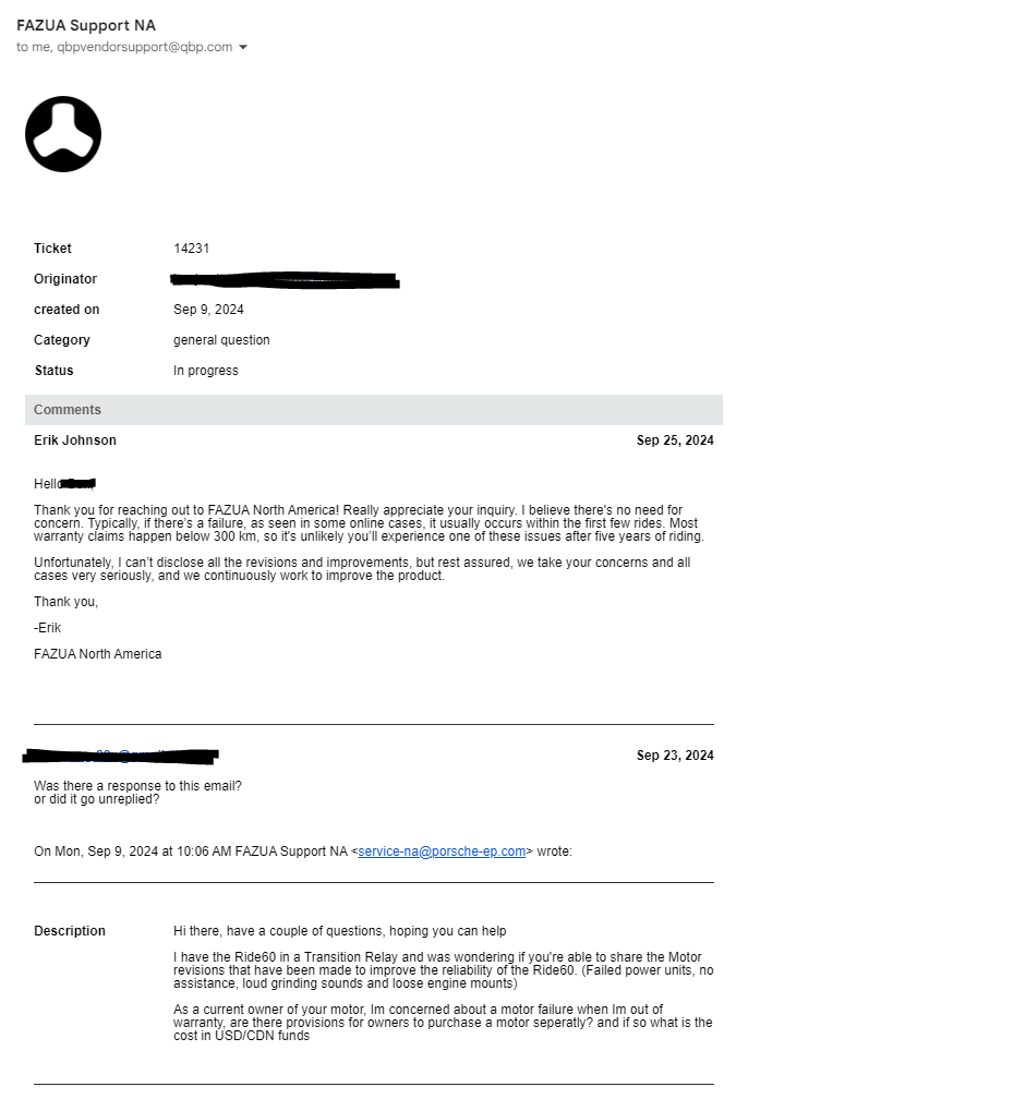

Will come as no surprise us here, but thought you'd find the responses from Fazua C/S laughable
The CS rep implys that I dont have to worry about the unsubstationed claims of failed motors, but then lets me know that Fazua is hard at work improving the motor
Still waiting to find out how much a motor costs out of warranty....
Heres the response back, when I had to reask for the cost of a motor

As a current owner of your motor, I'm concerned about a motor failure when I'm out of warranty, are there provisions for owners to purchase a motor separately? and if so what is the cost in USD/CDN funds"
Our Ride 60 Motors are available for aftermarket purchase through our North American distributor Quality Bicycle Product's partners. These are available for purchase at an MSRP of $904.76.
"Based on your response, you imply that I have 5 years of warranty from Fazua?"
Porsche eBike Performance GmbH offers a 2 years voluntary manufacturer warranty in accordance with the Terms and Conditions for Voluntary Manufacturer's Warranty available for review and download here (hereinafter "Warranty Terms"), subject to registration. You need to register your personal details and your FAZUA product within 3 months of purchase using the form below. You will then receive a confirmation with all key information which will create the warranty agreement between Porsche eBike Performance GmbH and you based on the Warranty Terms.
Please feel free to reach out with any additional questions.
Thank you,
-Erik
FAZUA North America
ehfour <XXXXXXX@gmail.com>Sep 25, 2024
Hi Erik
Thanks for the response, while your response are words, you missed the main part of my question
Based on your response, you imply that I have 5 years of warranty from Fazua? if that isnt the case, please let me know what the cost of a motor replacement is beyond the stipulated warranty peroid
Cheers
ehfour
