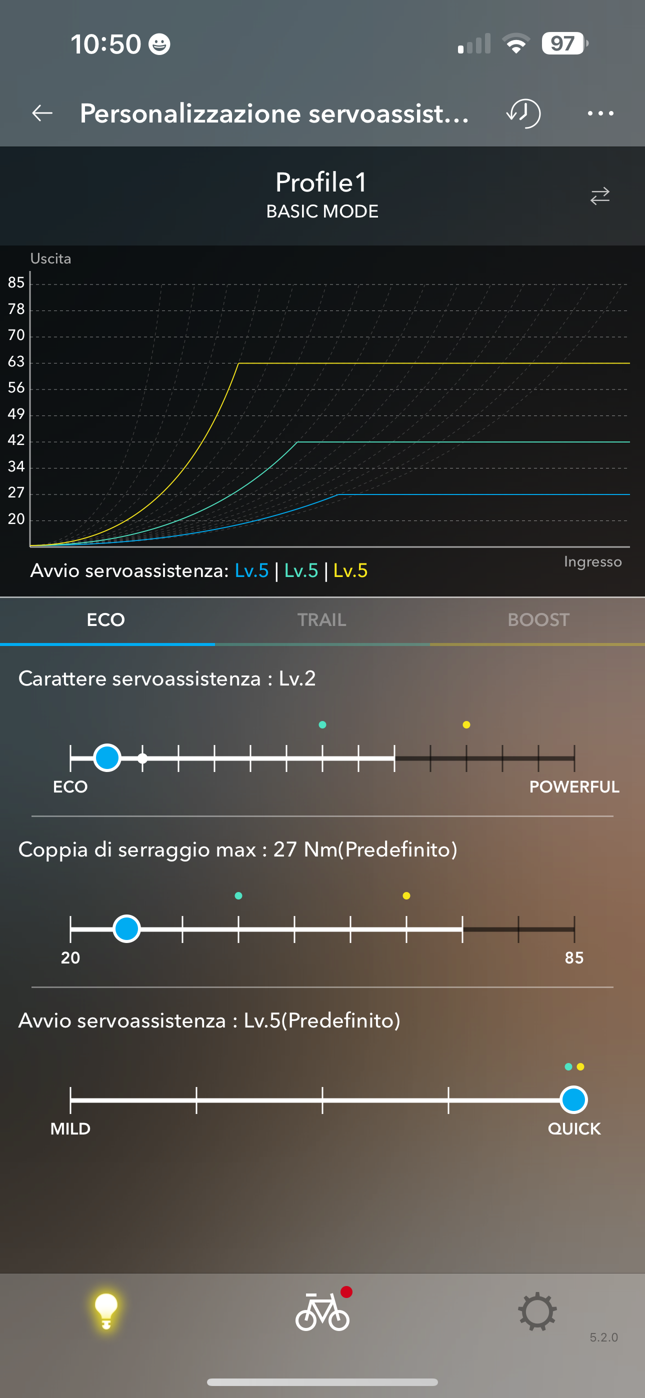

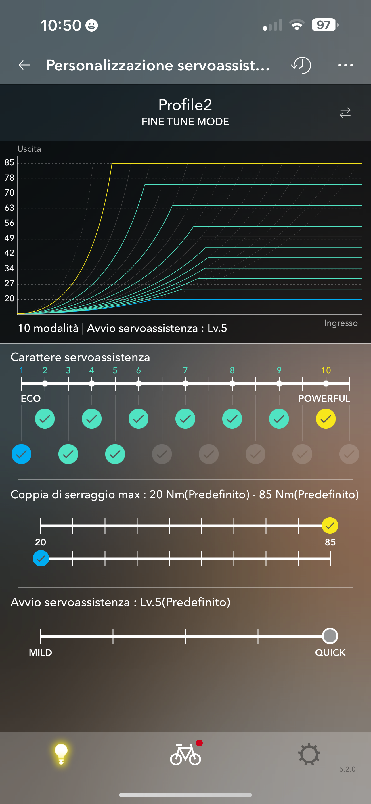

Setting done on myrise 2023 profile ep801 RS and profile 2 Ep801 full power
View attachment 126125 View attachment 126126
